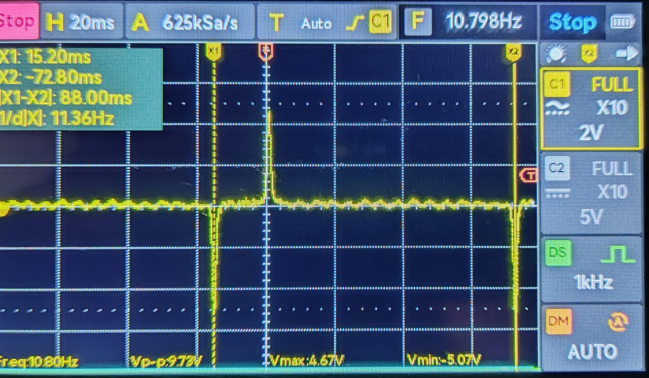

<p dir="auto">Before buying a new CDI I decided to measure the outputs of the stator, pickup and the orange cable (CDI) against mass with an oscilloscope. The stator and pickup signals looked fine to me but maybe they are to low?</p>
<p dir="auto">Pick up looks like one negative followed by a positive pulse with a 5v peak each (10vpp). The stator signal looks like Sinus with 30v peak (60vpp). Both were measured open with the plugs unplugged. The CDI output looked a bit off to me. A negative pulse cut off at -18V and some ripple with the stator sine frequency. More like spikes.</p>
<p dir="auto">Does anyone know how it should be? I could provide the images of the measurements once I found out how to upload them.</p>
