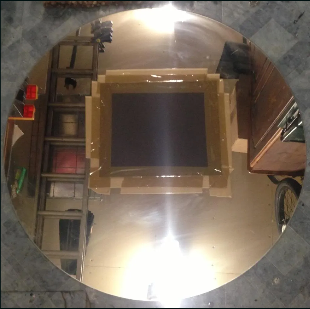

    Firstly find a suitable flat surface to mount the wet and dry paper to. You want to start with the coarsest first and work your way down to the finer grade.
    Remember if the surface is not completely flat you will not be able to skim the item.
    I don't have access to a flat workbench that has been CnC perfectly. The next best thing is a sheet of glass, which like most, I do have!
    alt
    Place your sheet of wet and dry to the glass. Make sure it is completely flat onto the glass and tape it down.

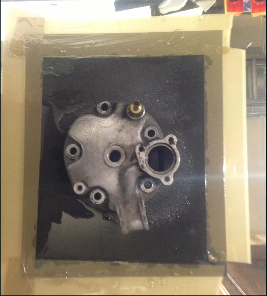

    Grab the item in question:
    alt
    So this is a spare 3BN head that Andy sold me. As you can see it's in a right old state and this method works really well to tidy it all up.
    By Placing it face down start to rotate in circular motion over the wet and dry paper.
    alt
    ^^^^^^In this photo i'm using my 4DL head^^^^^^^

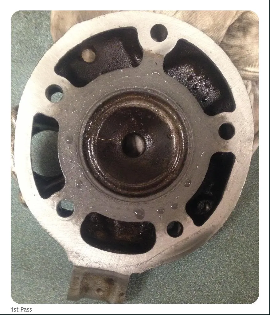

    This is the 1st pass of the wet and dry and remember this went after the 4DL head and Barrel had used the same wet and dry. So you should be seeing better results.
    I didn't even wipe it in this photo but you can see it's already looking better.
    Lay down your next sheet of wet and dry REMEMBERING to now use the next grade up (Always going finer and finer)

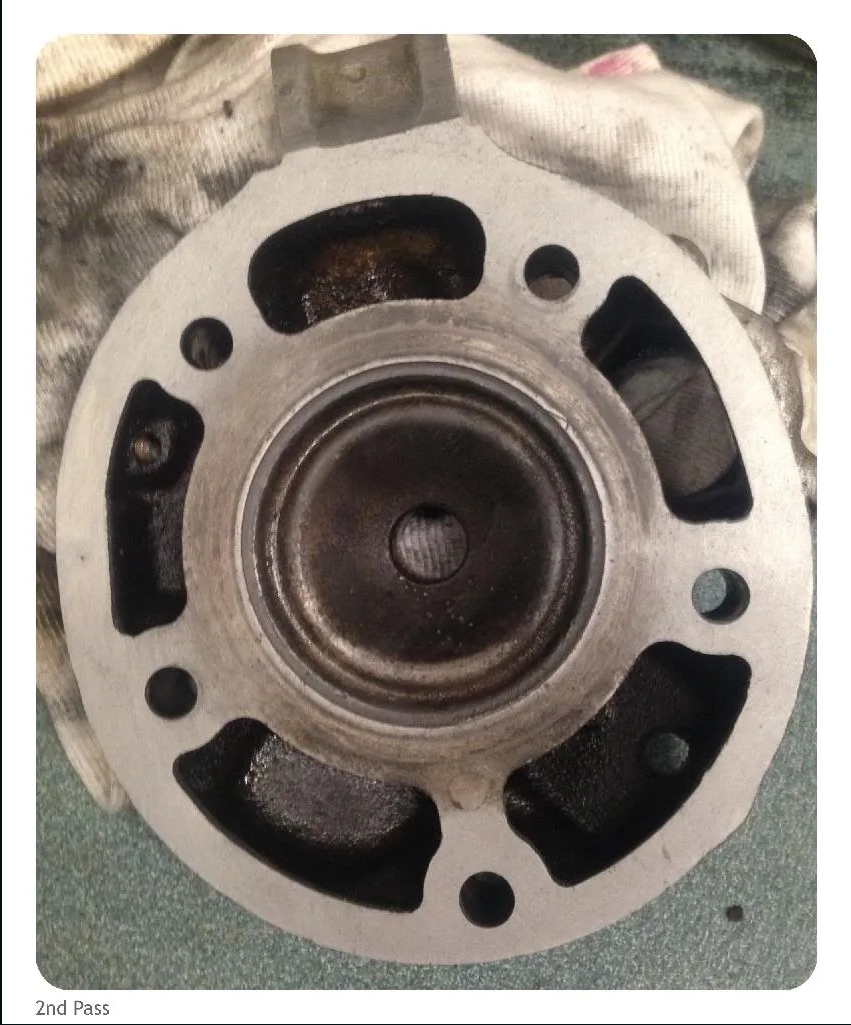

    This is the second pass. I gave it a little wipe before I took this photo. Just so you can now start to see how much it's cleaned up by.

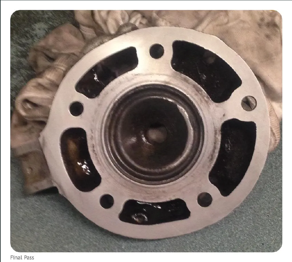

    Again go the next grade up on the wet and dry paper (You should now be at your FINEST grade of wet and dry paper)
    Apply some water to it like you did in the previous passes.
    alt
    ^^This is the FINEST grade ^^
    Again rotate in circular motion

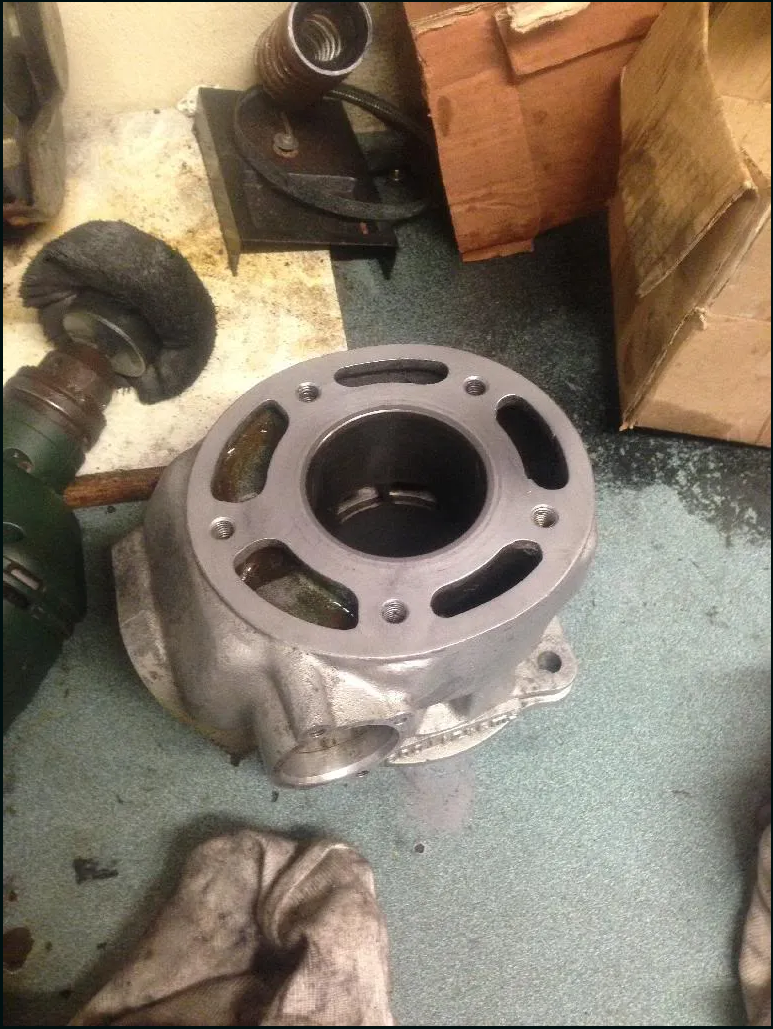

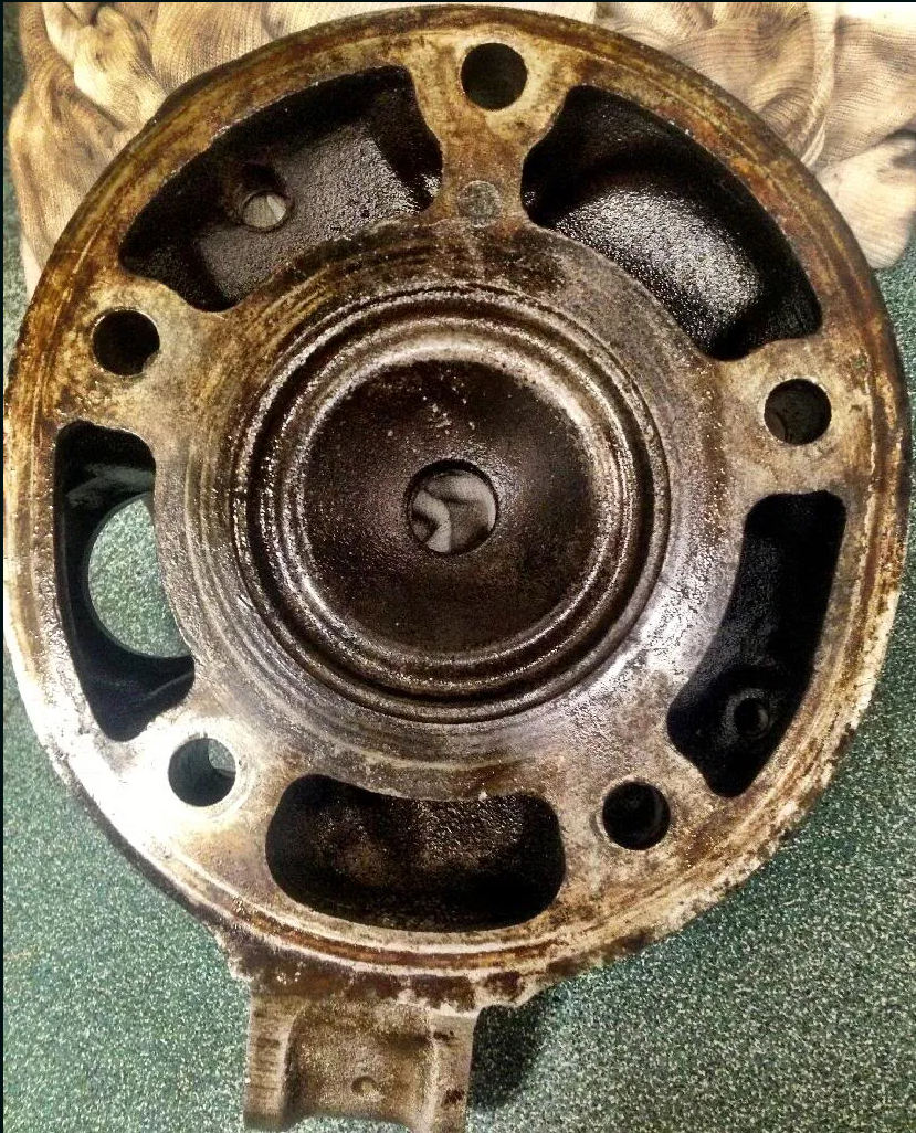

    This is what the cylinder finished up like...
    alt
    That ring of dirt by the water jacket HAS to go. Yours should have but because I had already used the same wet and dry paper to do a Barrel and a Head it was worn down by the time this one came to use it.
    You should now have successfully skimmed your item. It ought to look better than that 3BN cylinder and I do have a photo of what the 4DL looked like after I finished. (The 4DL went first on the wet and dry so came up much better)

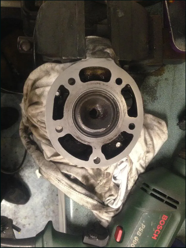

    Place the culprit into a vice and clamp it down using the engine mount and a rag to protect it. It's a good idea to place an object for the head to rest on whist you work on it.
    alt

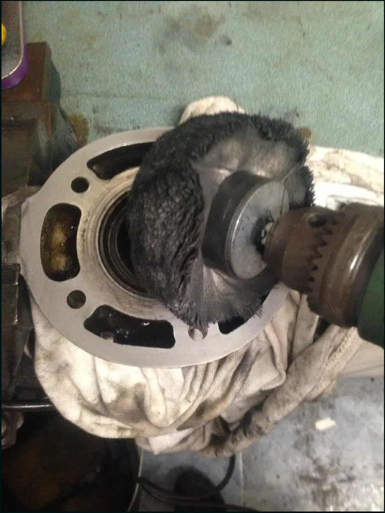

    Using a cheap polishing tool off ebay for about £5 you can begin to get rid of the surface carbon build up.
    To aid this I applied some WD40.
    alt
    This is a soft polishing tool that I've used on many cylinders and for £5 it seems to do the trick.
    Remembering to be gentle at all times. Let the Drill do the work not you. Keep applying more WD and you should get there.

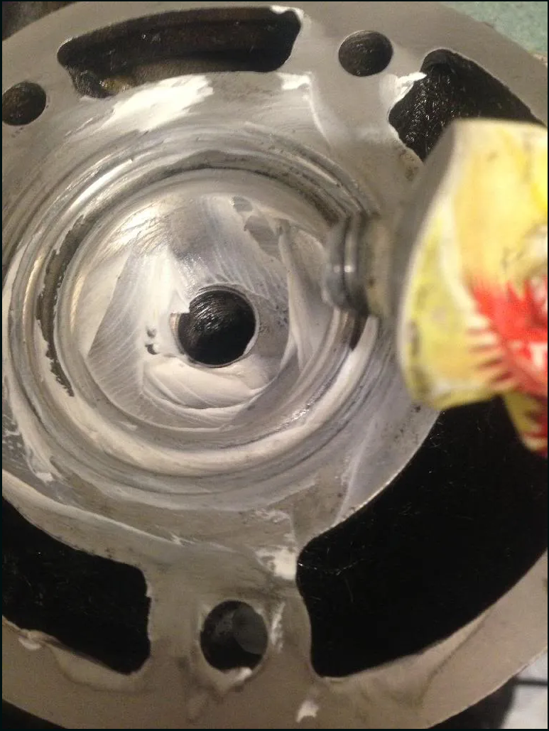

    You now want to begin polishing this combustion chamber.
    Apply thin layers of Autoglym metal polish (or something similar)
    alt
    And the again begin with the drill. Remembering at all times to be gentle and let the drill do all the work.
    Once that layer of polish is all gone you can wipe it clean and apply some more and repeat the process. If you work hard enough you can end up with a mirror finish.

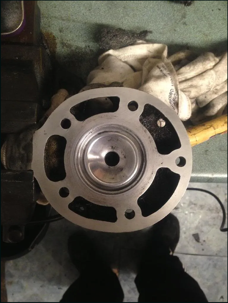

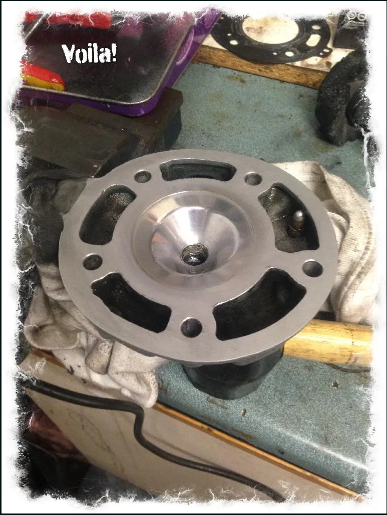

    I didn't do it too much on the 3BN as it is not in my interest too. But here is the 4DL that I was working on at the same time...
    alt
    If I was really bothered I could work even harder and get that a mirror finish.

    Of course REMEMBER if your head has warped then chances are the cylinder has too. MAKE SURE YOU DO BOTH THE CYLINDER AND THE HEAD!
    alt
    Get them both cleaned up and flush and that should see you a goodun.
