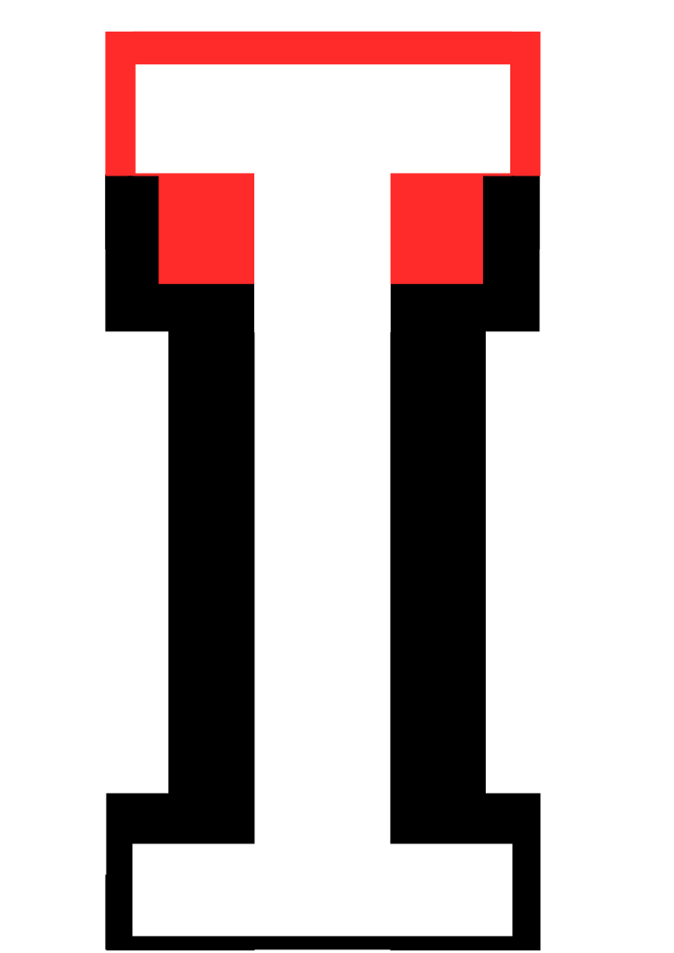

    Let's examine a 2D representation of the DT Headstock.
    Imagine that's the tube that the stem runs through. Your triple clamps are fixed to this. Bearings sit inside the frame to allow you to rotate the wheels.
    What you want to do is to create an extension to this frame to enable you to run bearings suitably big enough for your stem.

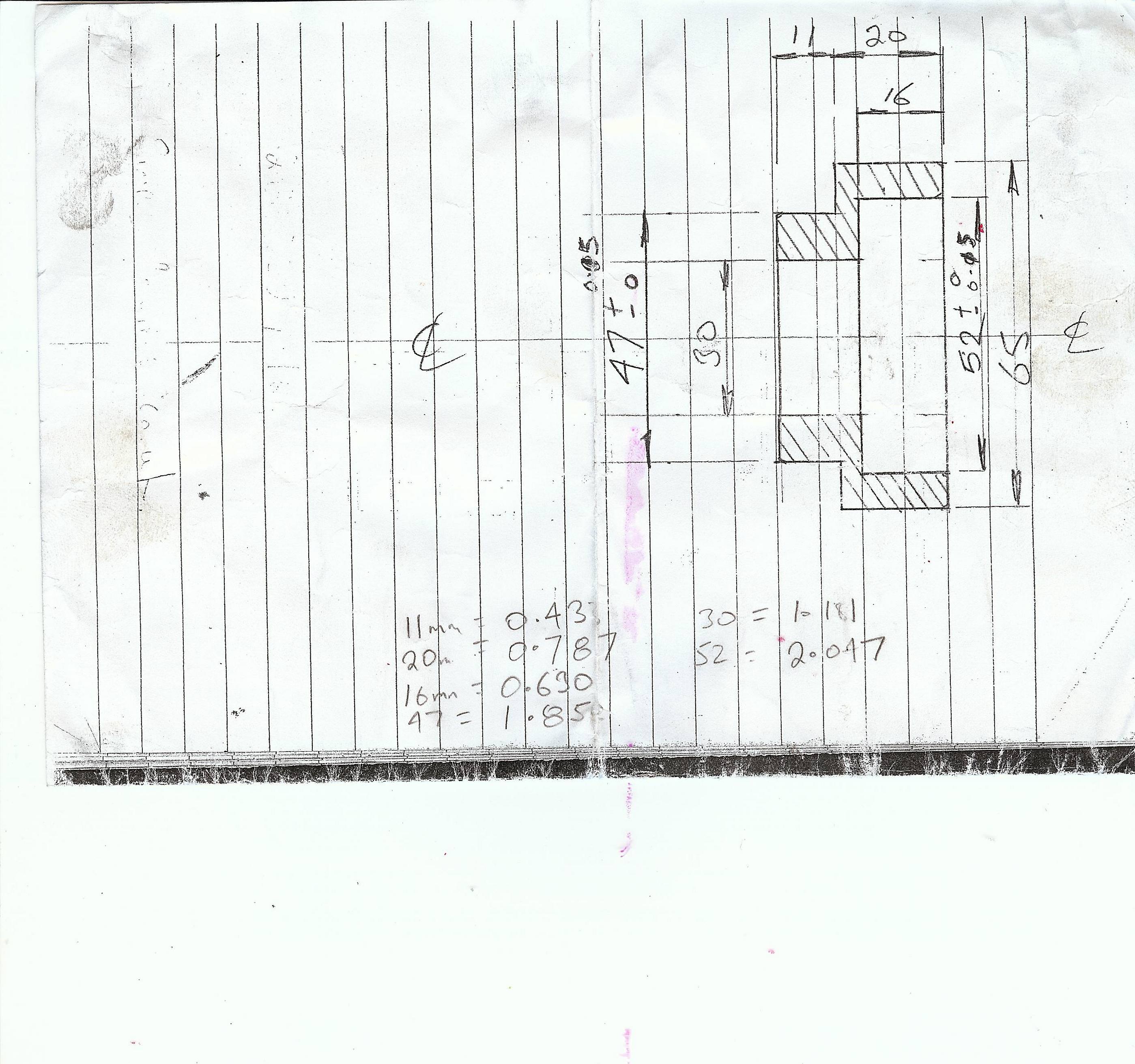

    The bearings you are going to fit only need to be big enough in the internal diameter. I once had someone tell me this method wouldn't work for them due to the lack of availability of bearings for their forks. Which is rubbish. You design the size of the cup to take whatever bearing you want to fit. In other words, so long as it fits on the stem, the width and depth can be whatever your cup designs account for.
    Eventually you will design a cup to sit inside the frame (Where the old bearing went) ensuring you remove the race before hand.
    In this picture, notice how the internal diameter of the frame has been enlarged to allow the new bearing to sit inside here. The red will fill the space of the old headstock housing. Your triple clamps should now be at the right height, with enough space for the bearing to sit inside. It should be able to rotate freely.
    Here was my exact dimensions for 2001 WR450 Forks.

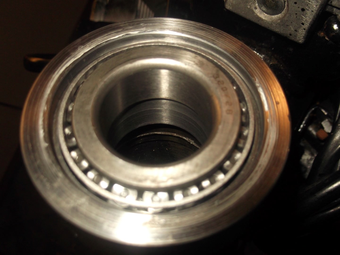

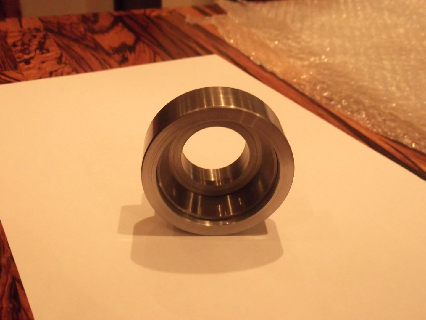

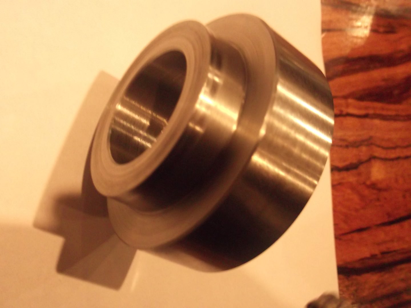

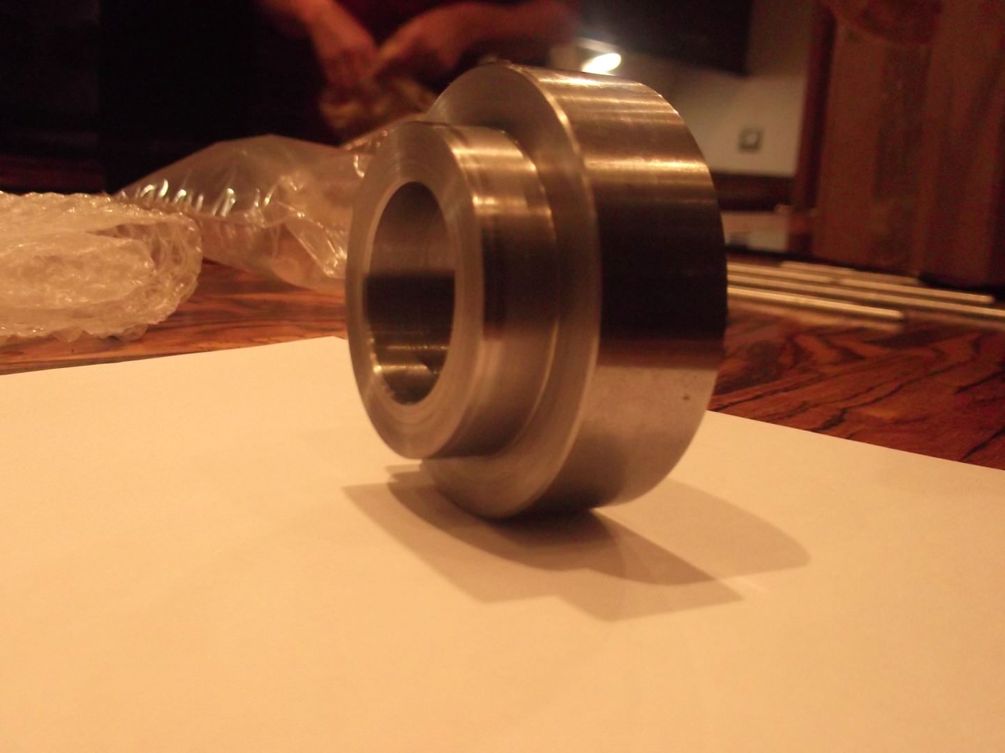

    Here is the product you will aim to make.

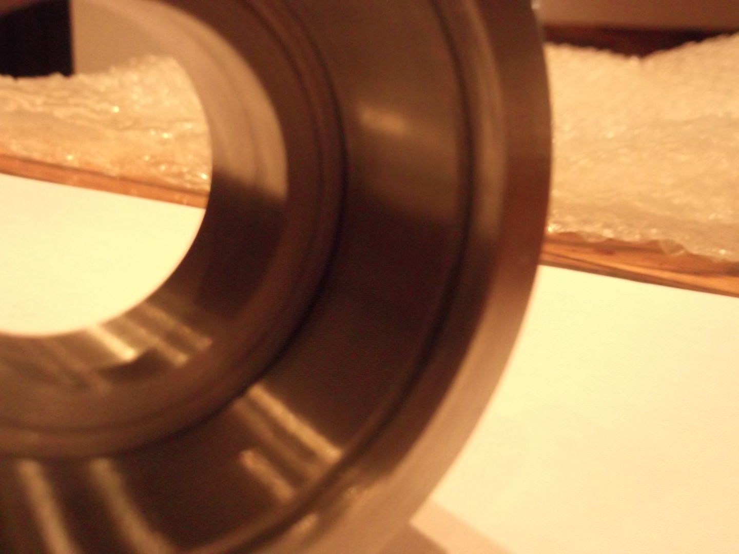

    With the new race for your bearing installed.
    With the bearing installed

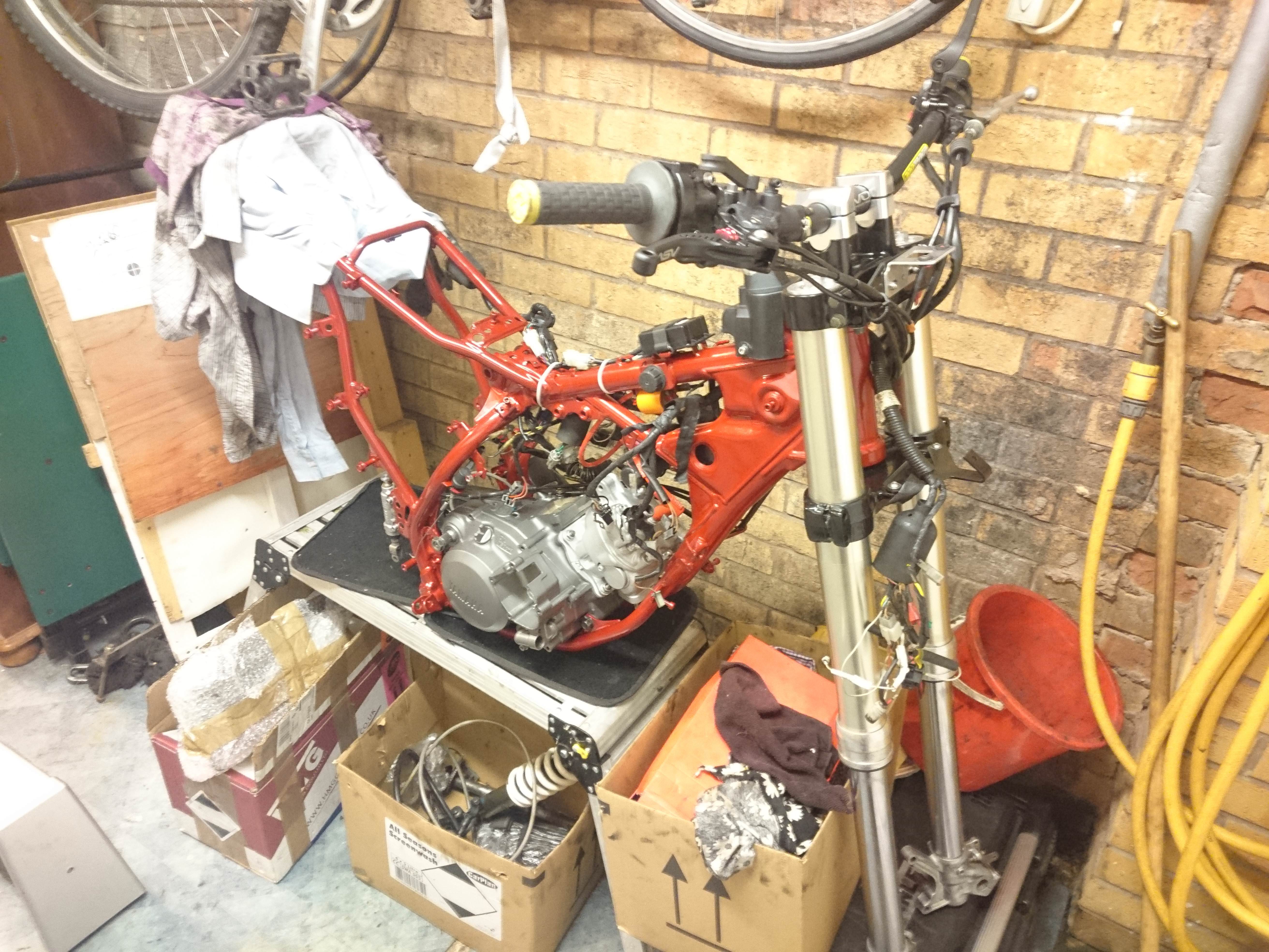

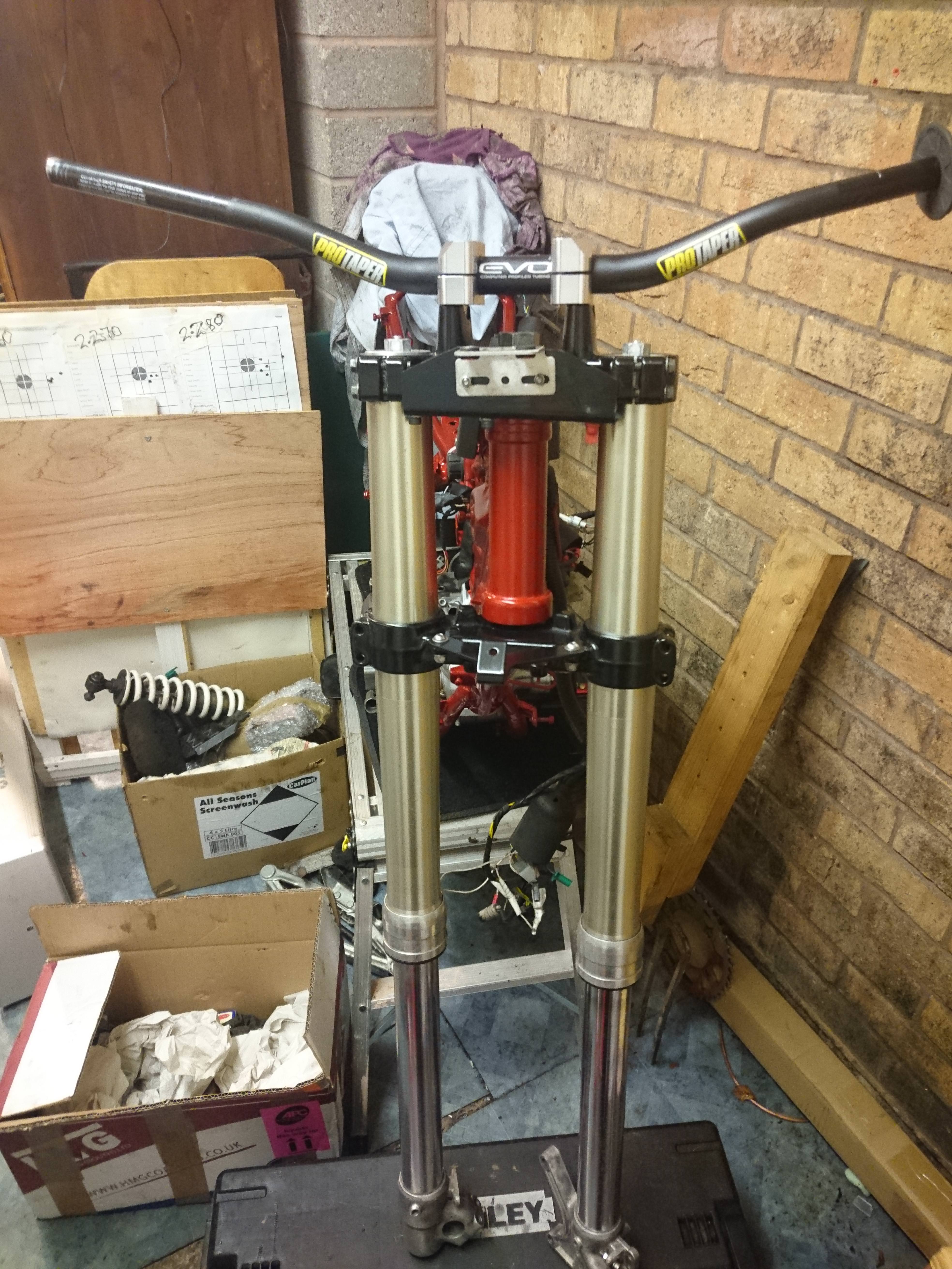

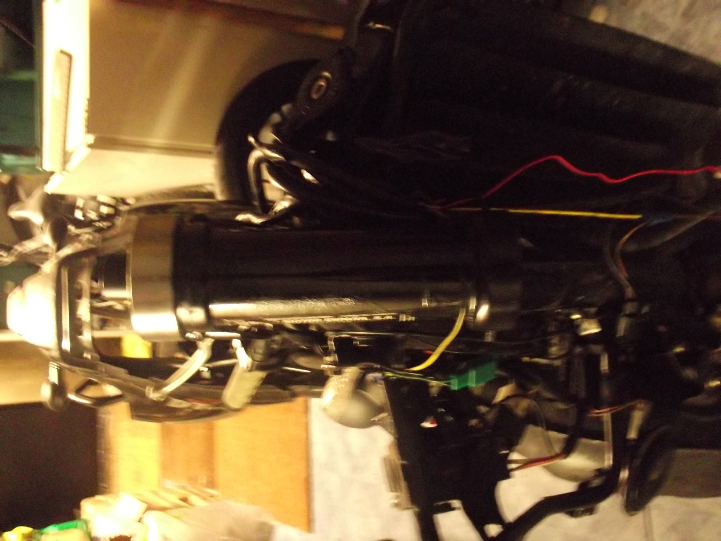

    How it compares contrast to the existing frame.
    Get it painted to match your bikes theme and enjoy fabulous suspension!
