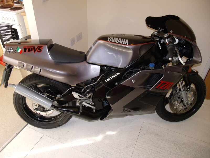

            @calum what's an SP?
            • Irongamer727I Irongamer727
              @irongamer727
              As said, good luck finding one. And it would be criminal to remove it from such a sweet chassis for a DT....
              Irongamer727I 1 Reply Last reply
                @irongamer727
