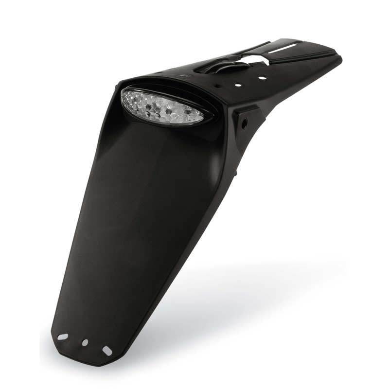

    hi all I was wondering if anyone had a link to an affordable and simple LED tail tidy for a '99 dtr I'm confused if I can use a normal one as it is ran of the engine instead of the battery
      I run this one on my bikes.
      https://www.fc-moto.de/epages/fcm.sf/?channable=020990696400343334333934323997&ObjectPath=/Shops/10207048/Products/Acerbis-30-LED-CE&Locale=en_GB

        @Calum is it pretty much plug and play ?
          Do you mean, do Acerbis make a wiring loom adaptor for a 20 year old + motorbike.
          It's pretty much plug and play in the sense that there are three wires to connect.
          +5v, ground and brake light.
          It's pretty simple, it's a light.

            @Calum That one fits the shape of the DTRE well 👍
