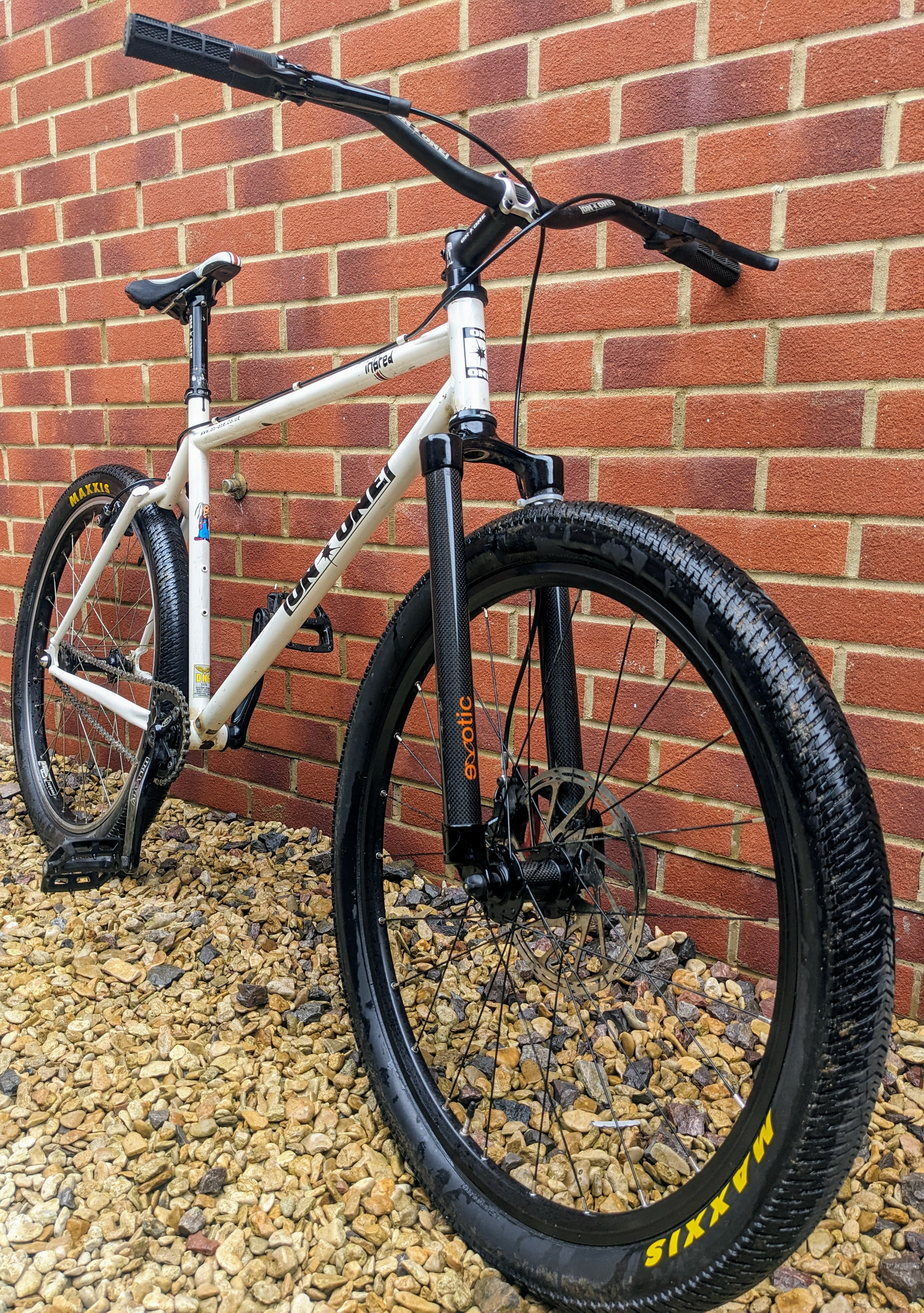

Single Speed On One Inbredhung up in his garage for the past ~15 years. He generously donated me the bike and it's so simple that it can be relied upon due to the minimal amount of things that can go wrong. It's a cracking bike, but not content with leaving anything alone, I decided to dismantle it and throw some money at it.
Having it in a damp garage done it no favours and the frame suffered some minor surface corrosion and was generally a bit tatty.

I reassembled the
Inbredbike, threw a set of rigid carbon fibre forks and SRAM hydraulic brake and Magura rear hydraulic rim brake and did countless miles on it.On-One Ti29er Inbred Lynskey

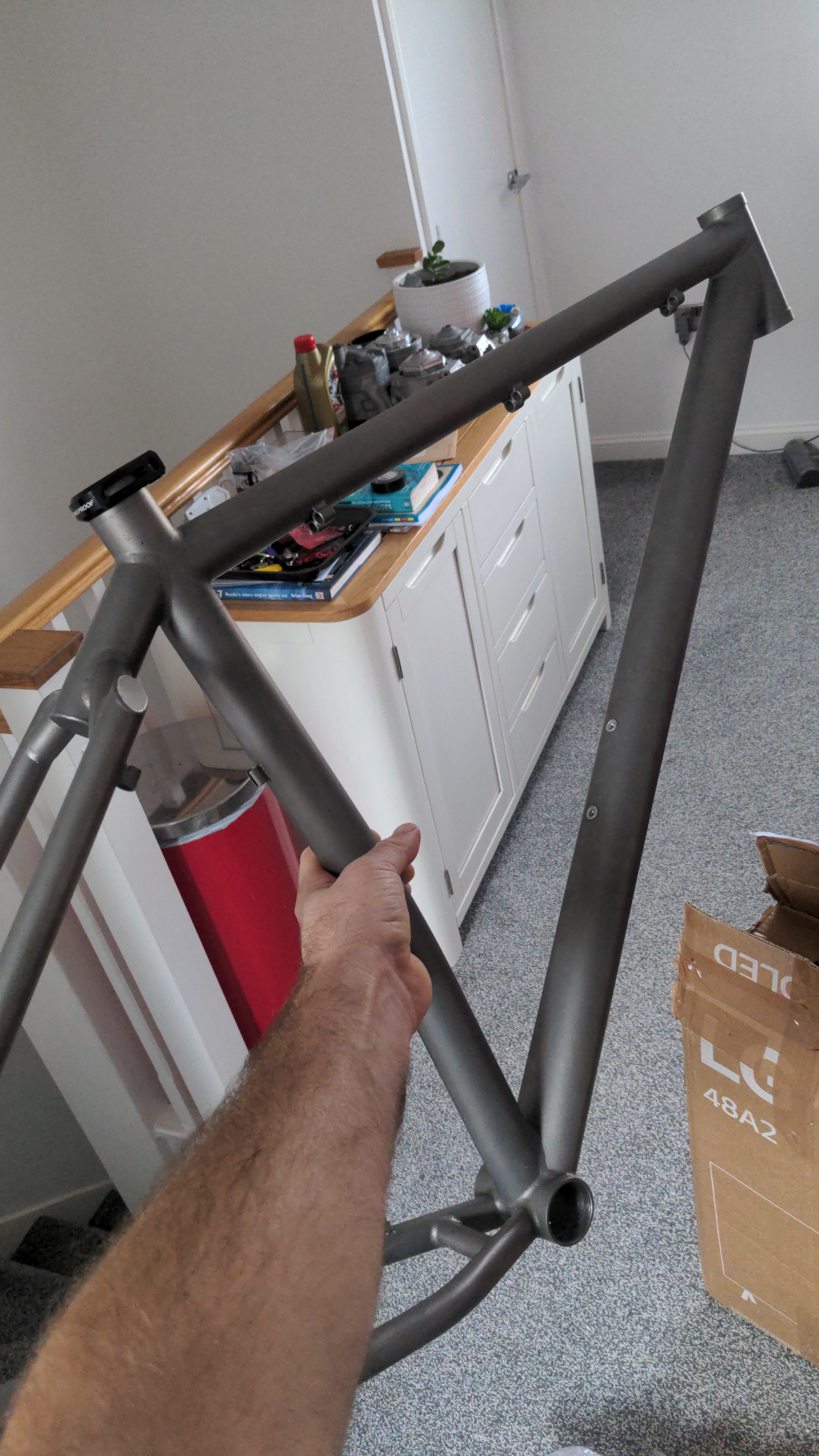

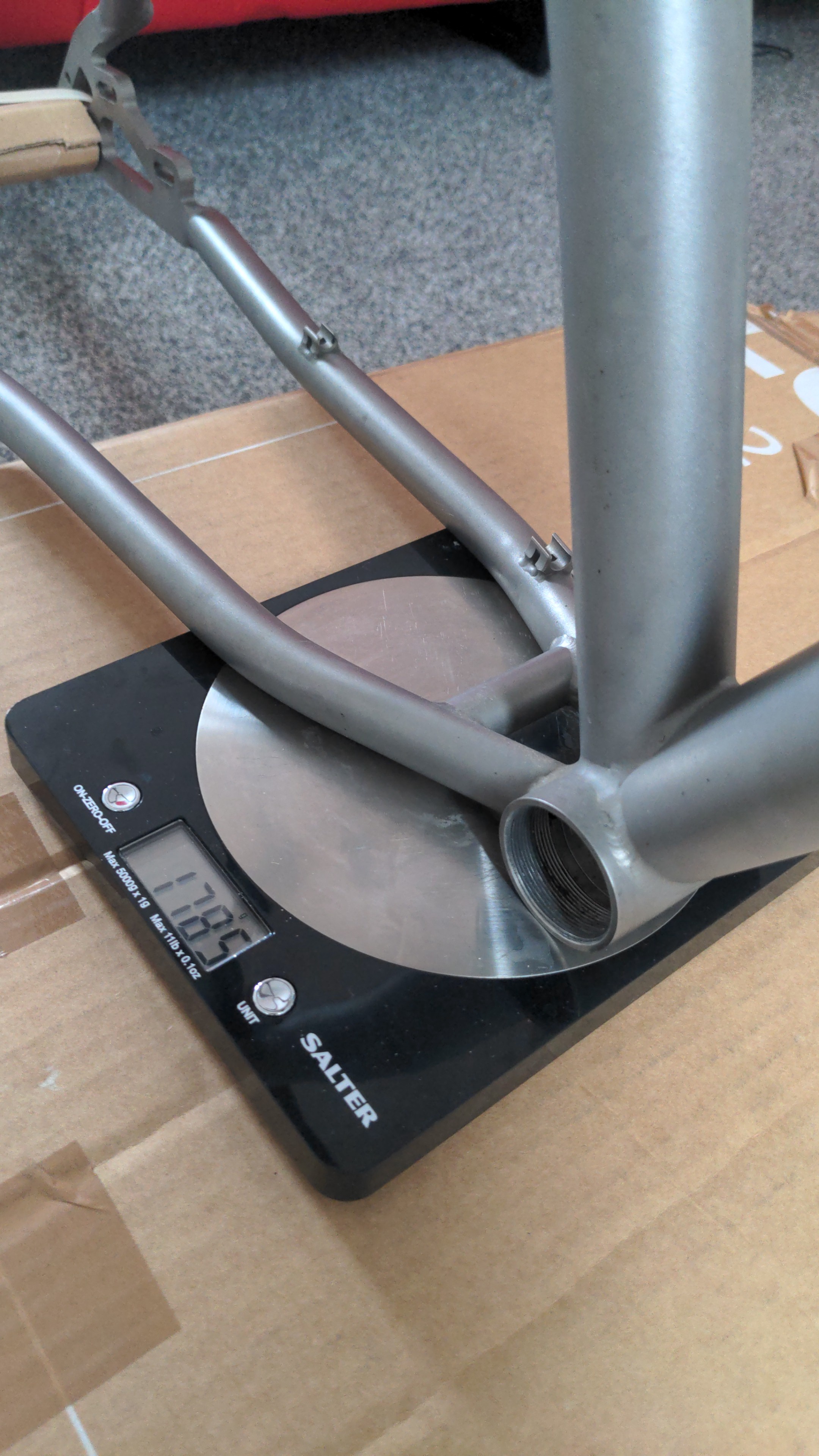

And then it arrived, light enough a baby could lift it, rigid enough it won't fold when my fat arse sits on it.

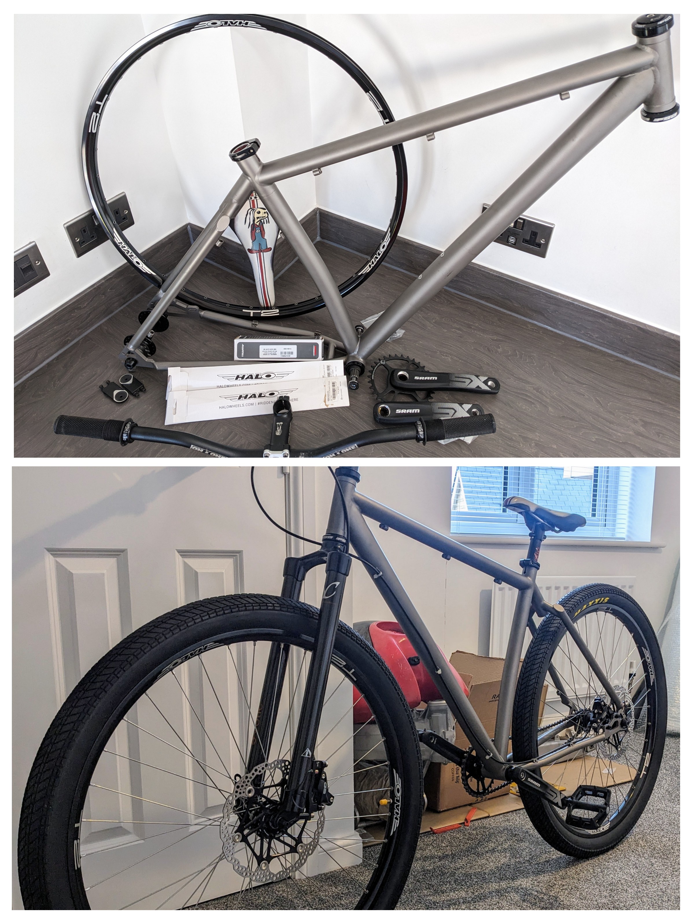

Assembly

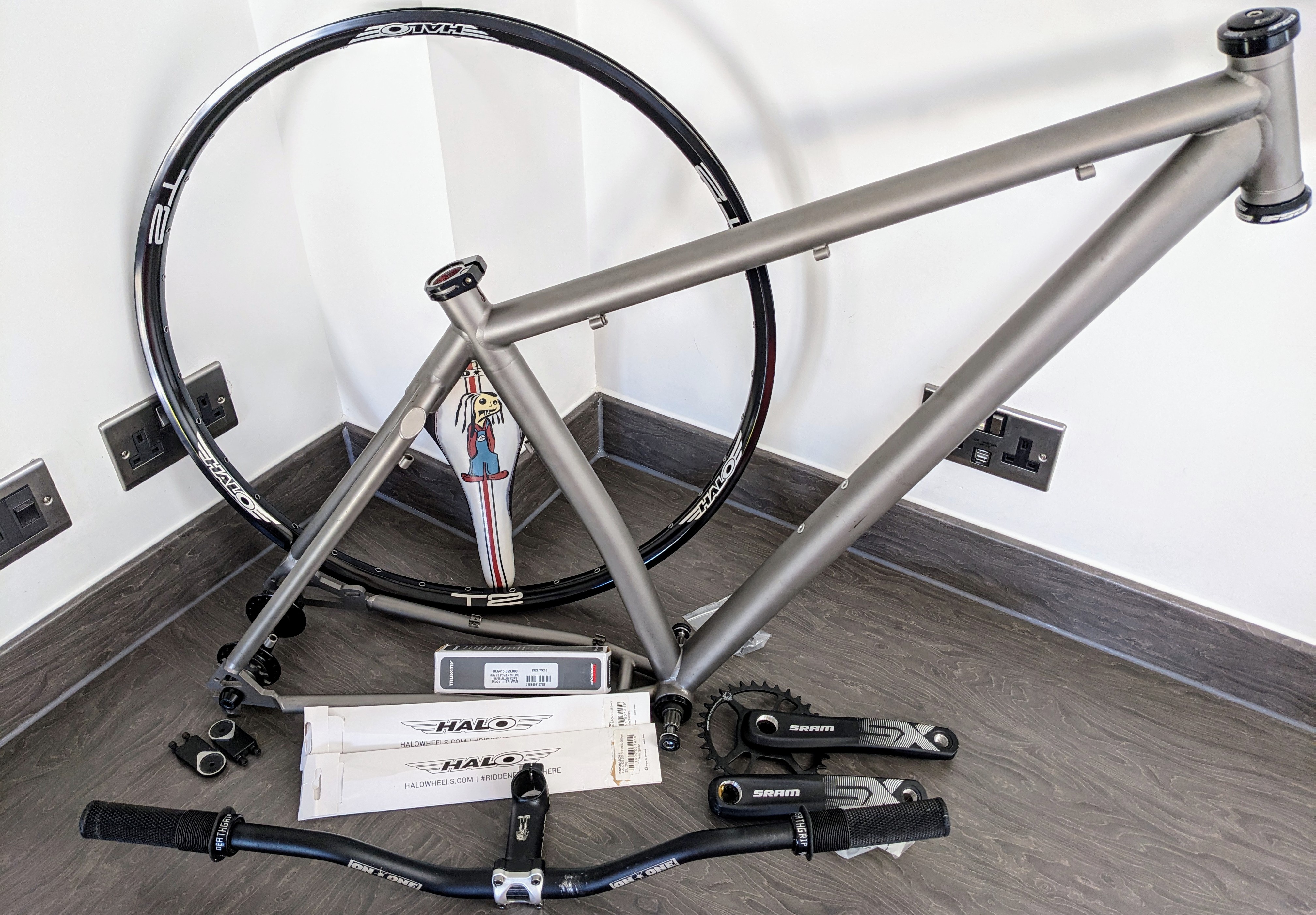

It would turn out, finding a rear single speed hub proved to be a little challenging so I just decided to build the wheels myself and that way I can have matching hubs/rims/spokes and build it exactly to specification.

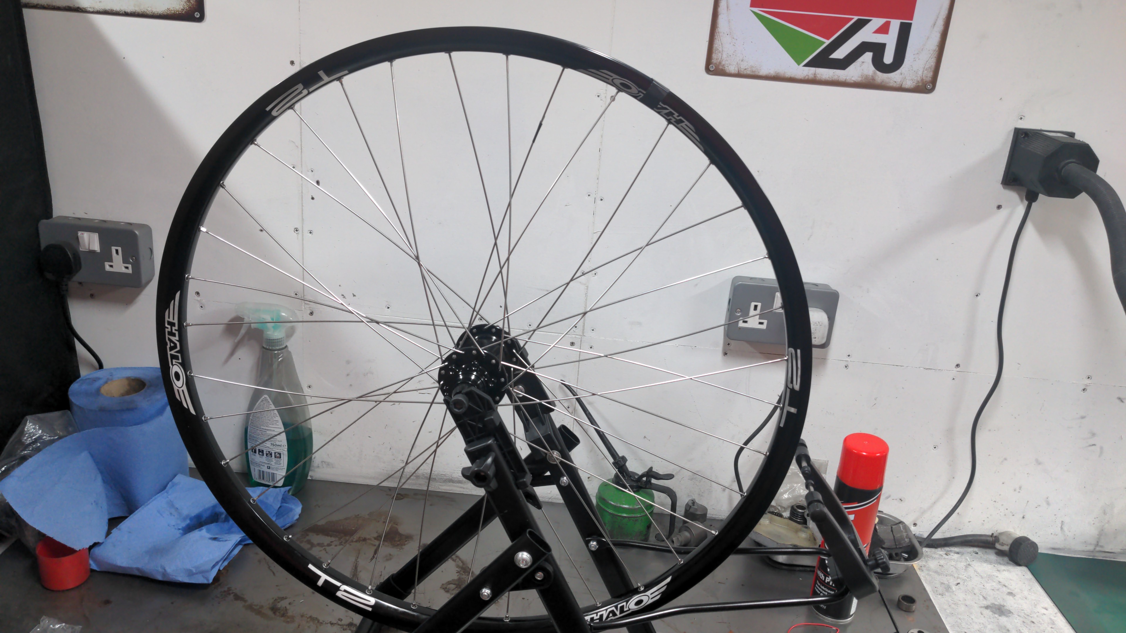

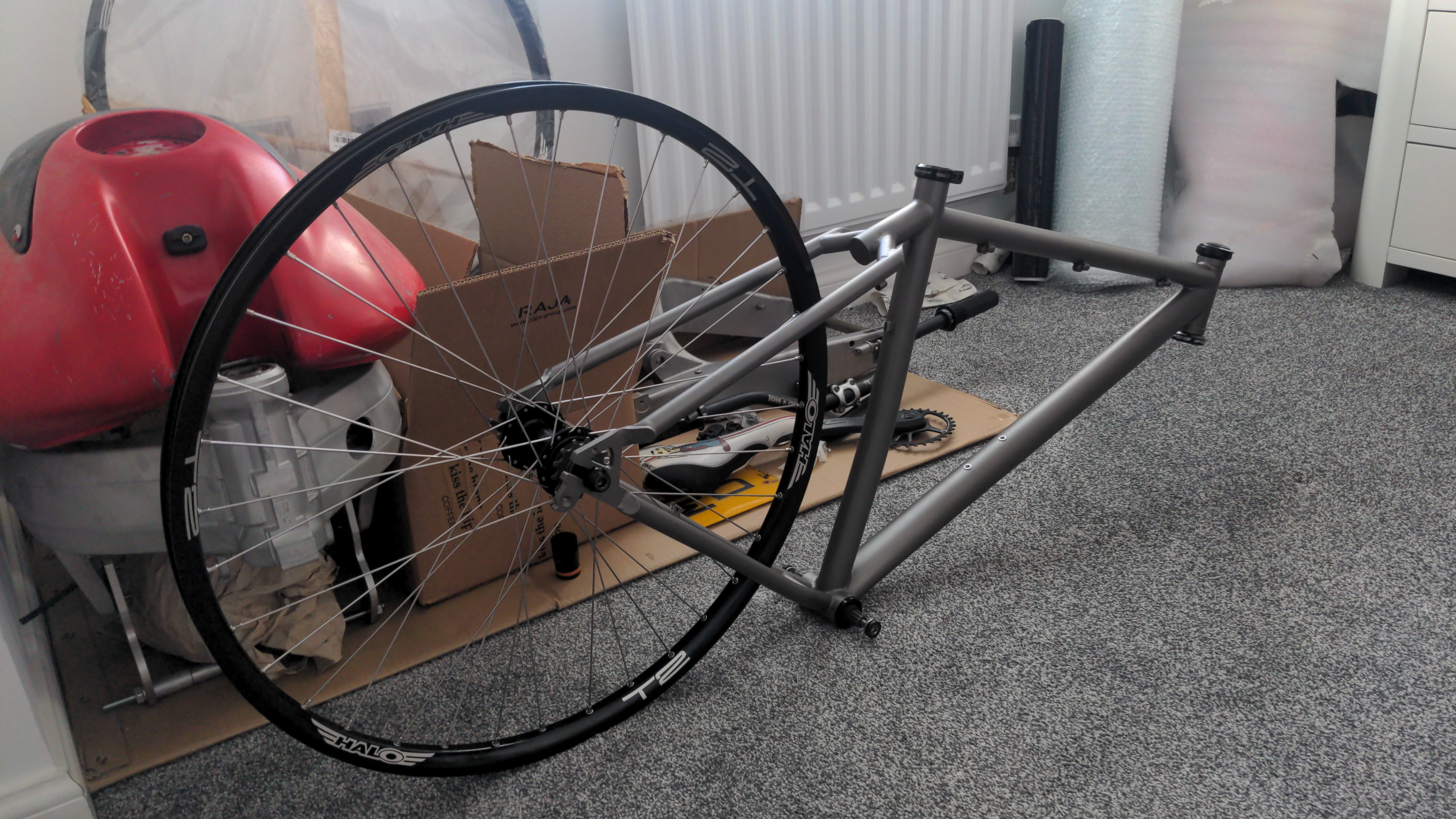

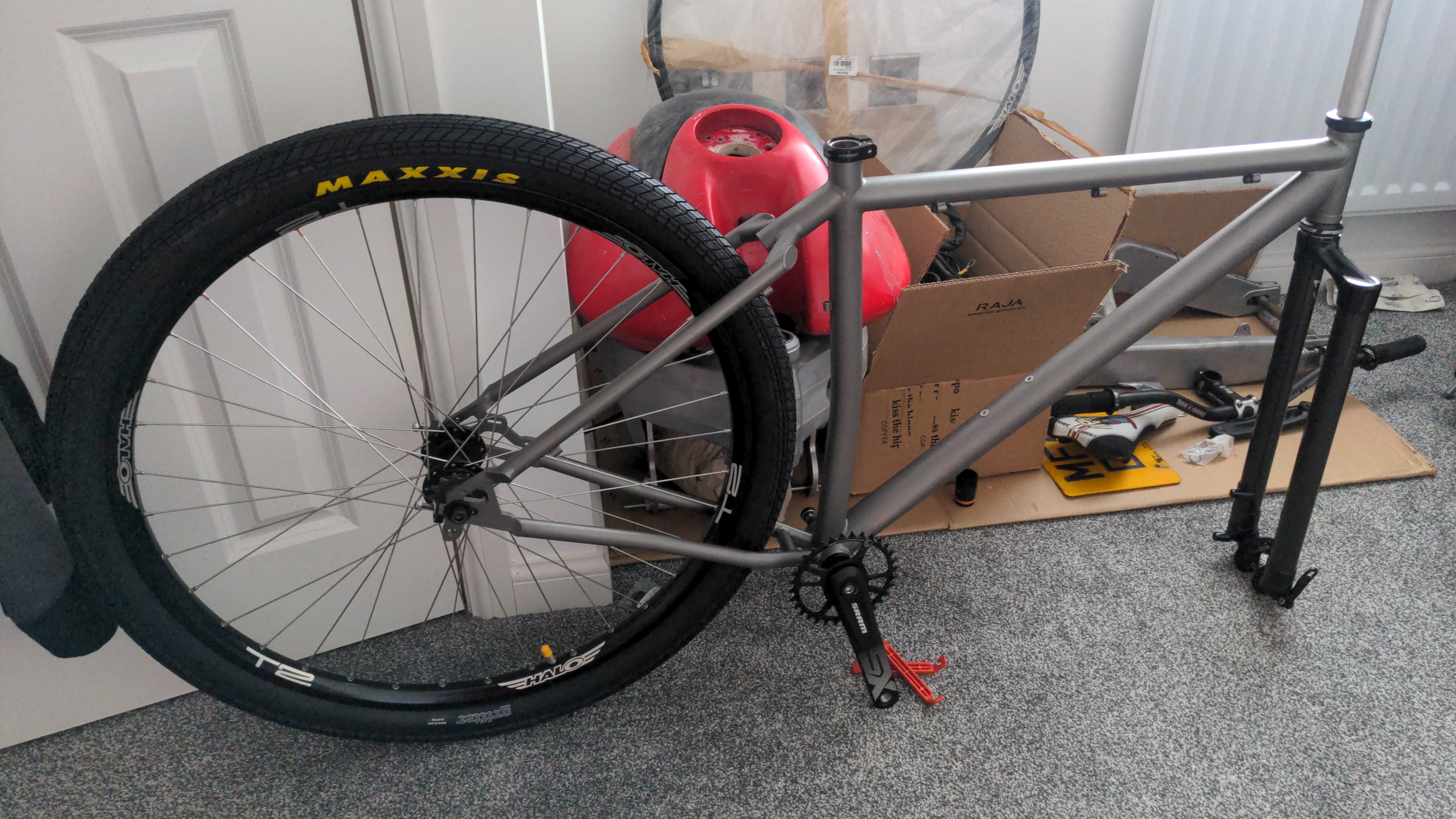

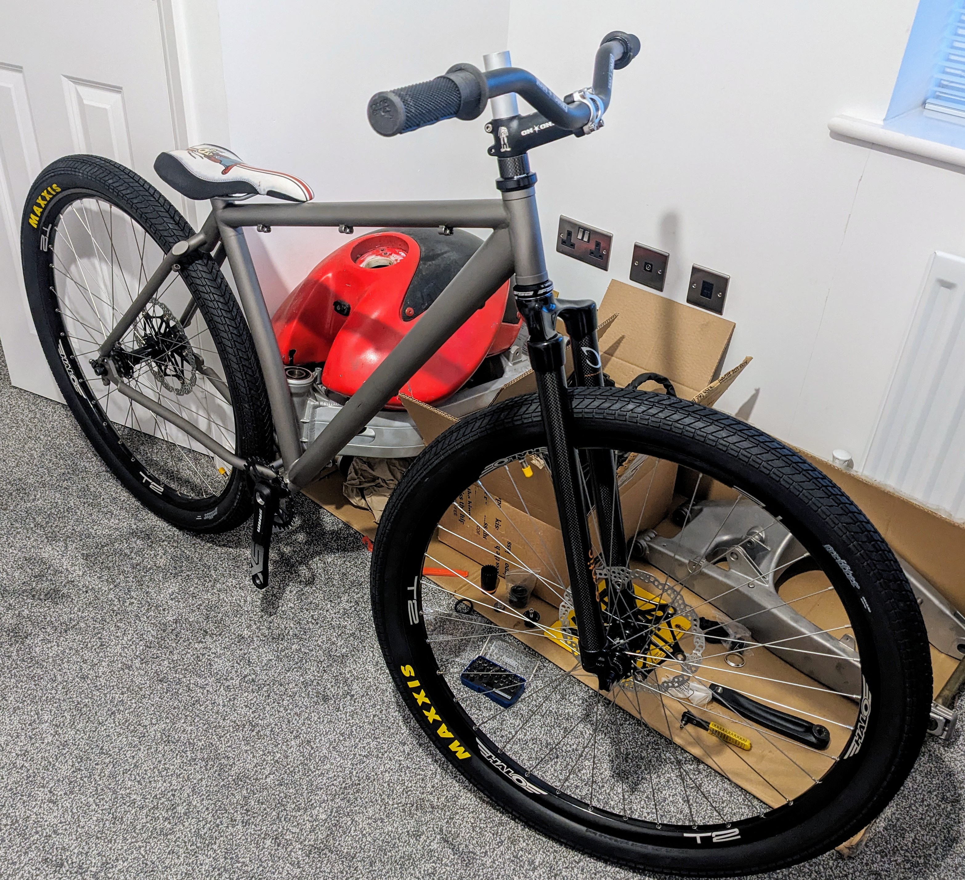

With the parts arriving thick and fast, I began first by building the wheel.
£20 for this little wheel truing stand off of eBay I was ready to build the wheel. Probably took around 3 hours per wheel as I like to take my time and fully lubricate things.

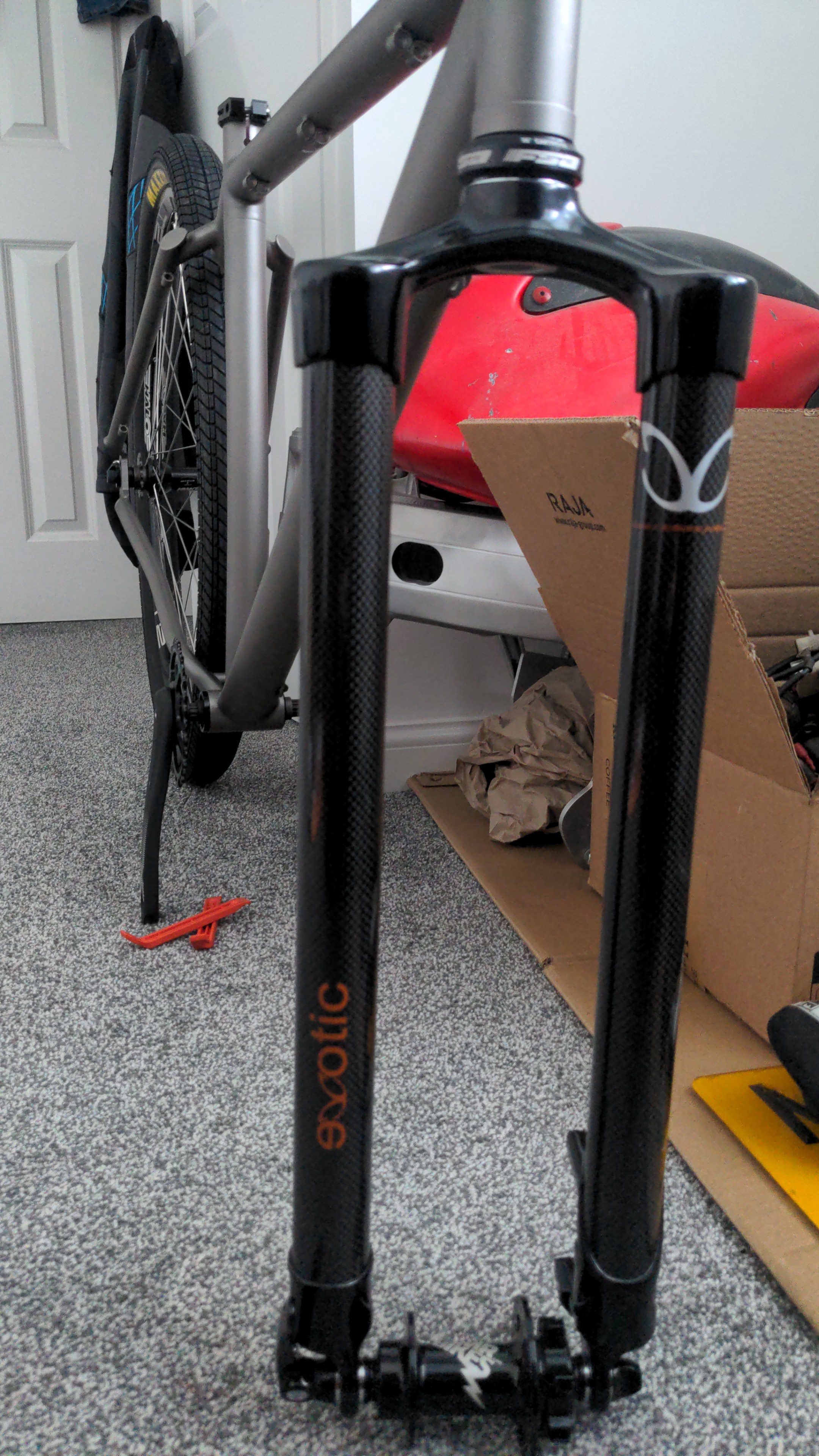

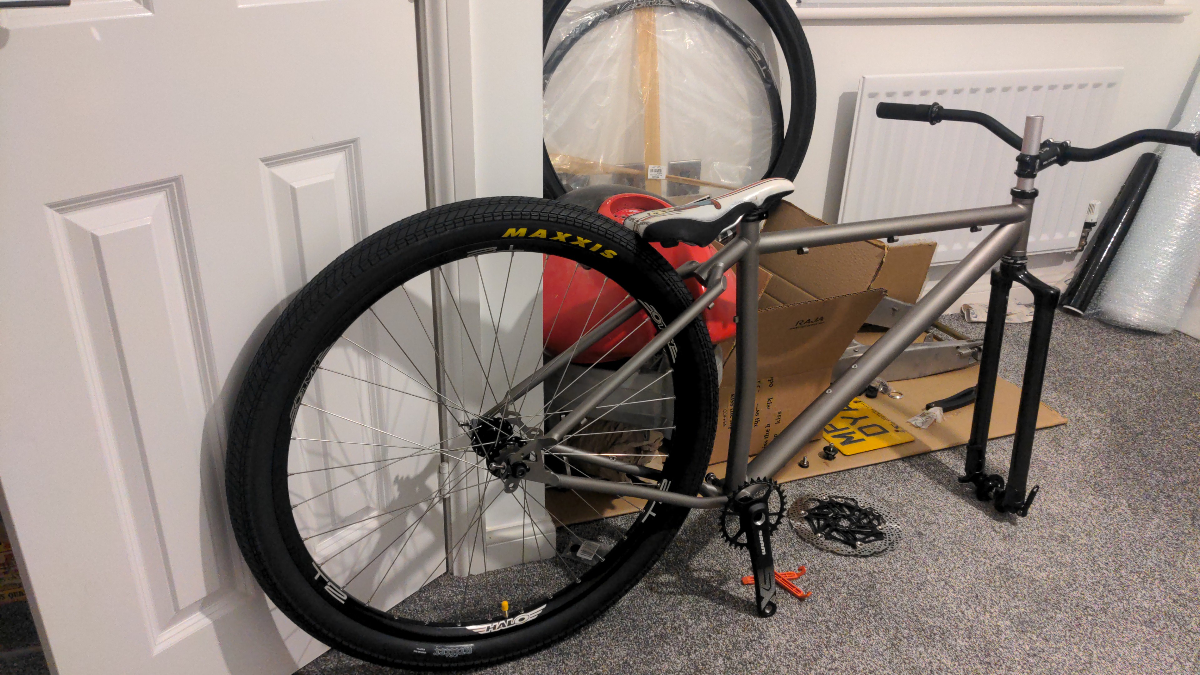

I could place the forks in situe but not ready to cut the stem.
I've been running a set of these forks on my steel frame and they've held up to the tasks that I'm going to put them through. I dislike suspension as I'm relying on this for commuting in emergencies and it's annoying having the energy zapped out of you!

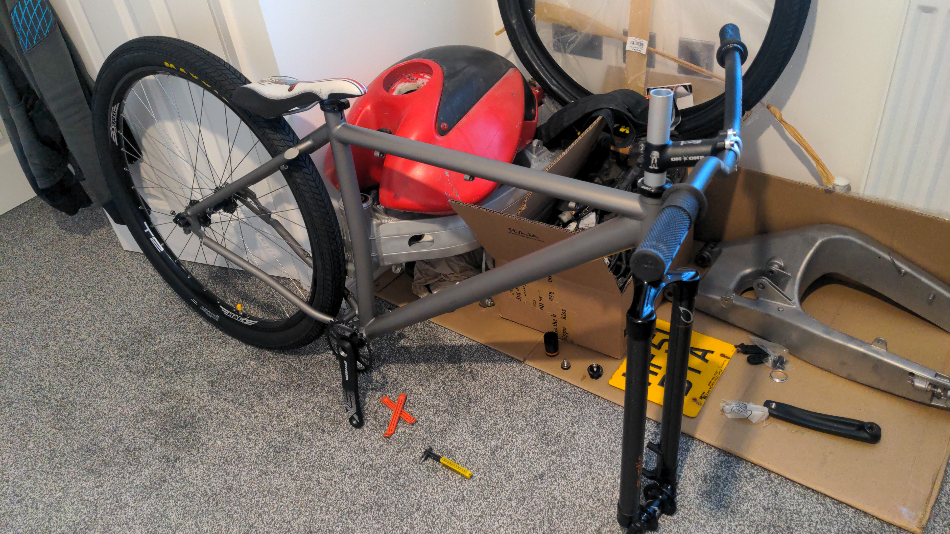

I could lightly place the other components on and get a feel for how it's going to hang together.

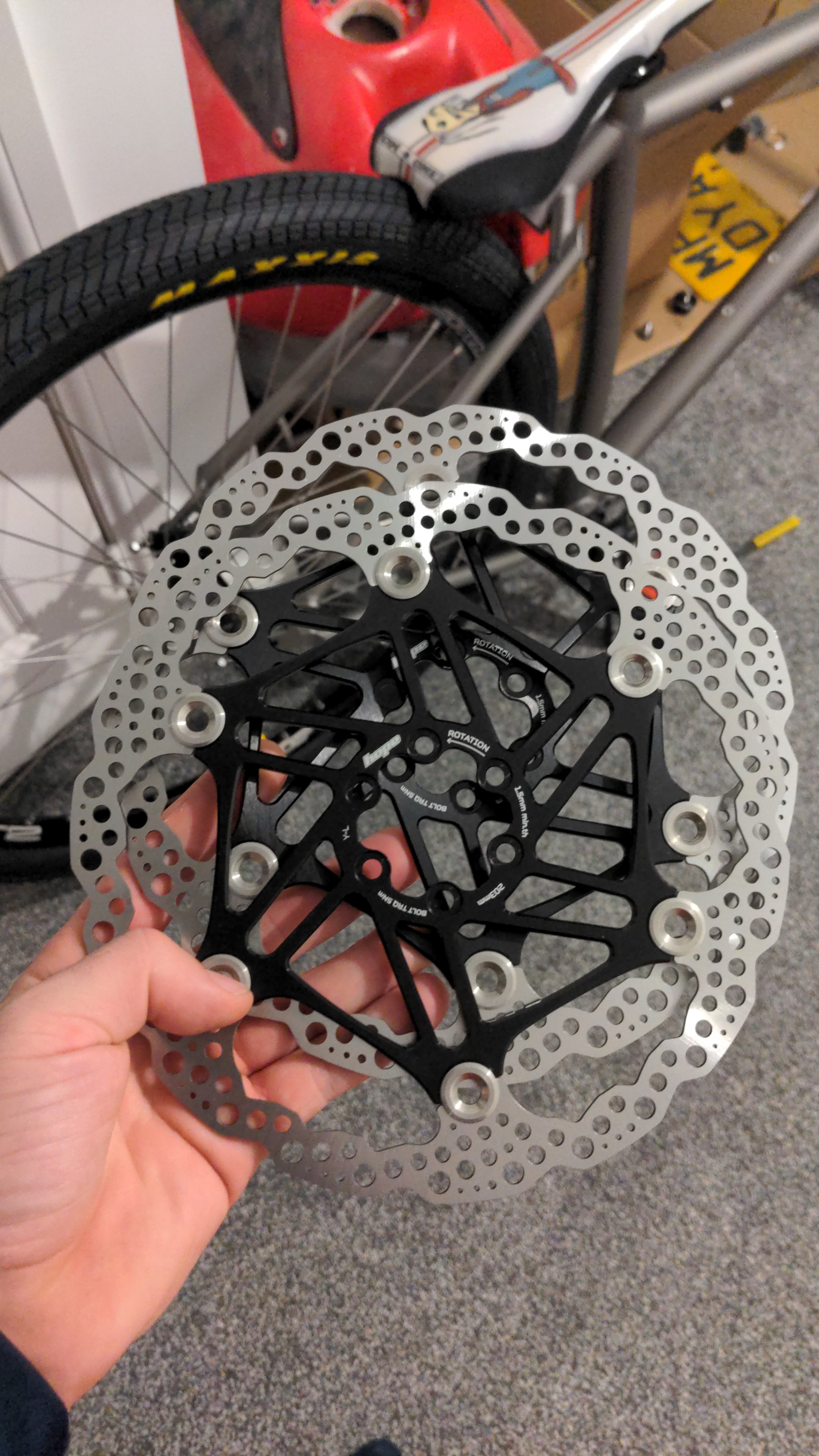

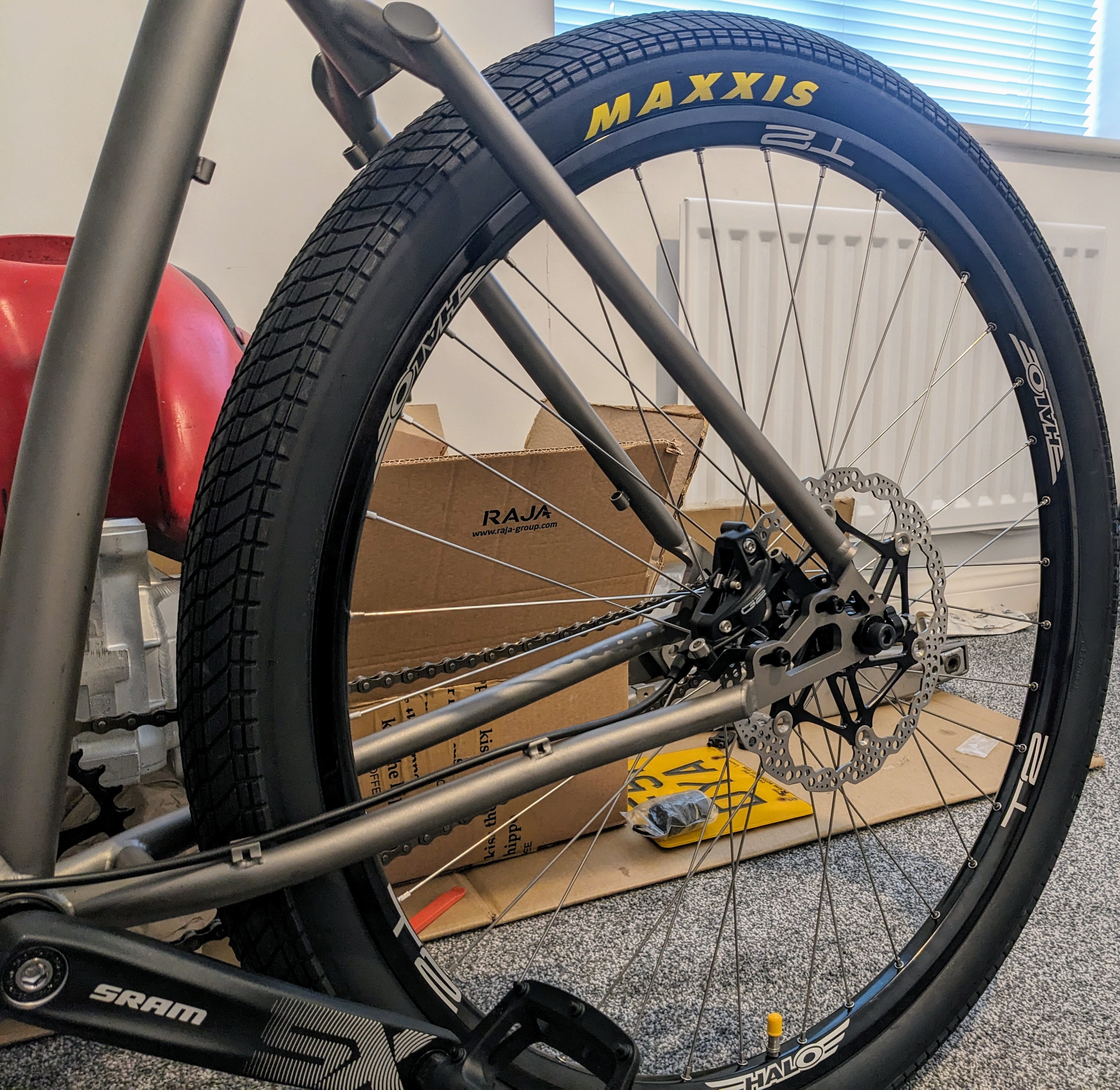

I'm building this a bit of a joke on myself really, so a set of 203mm Hope floating discs (pretty sure these are better spec than ones fitted to my motorbikes).

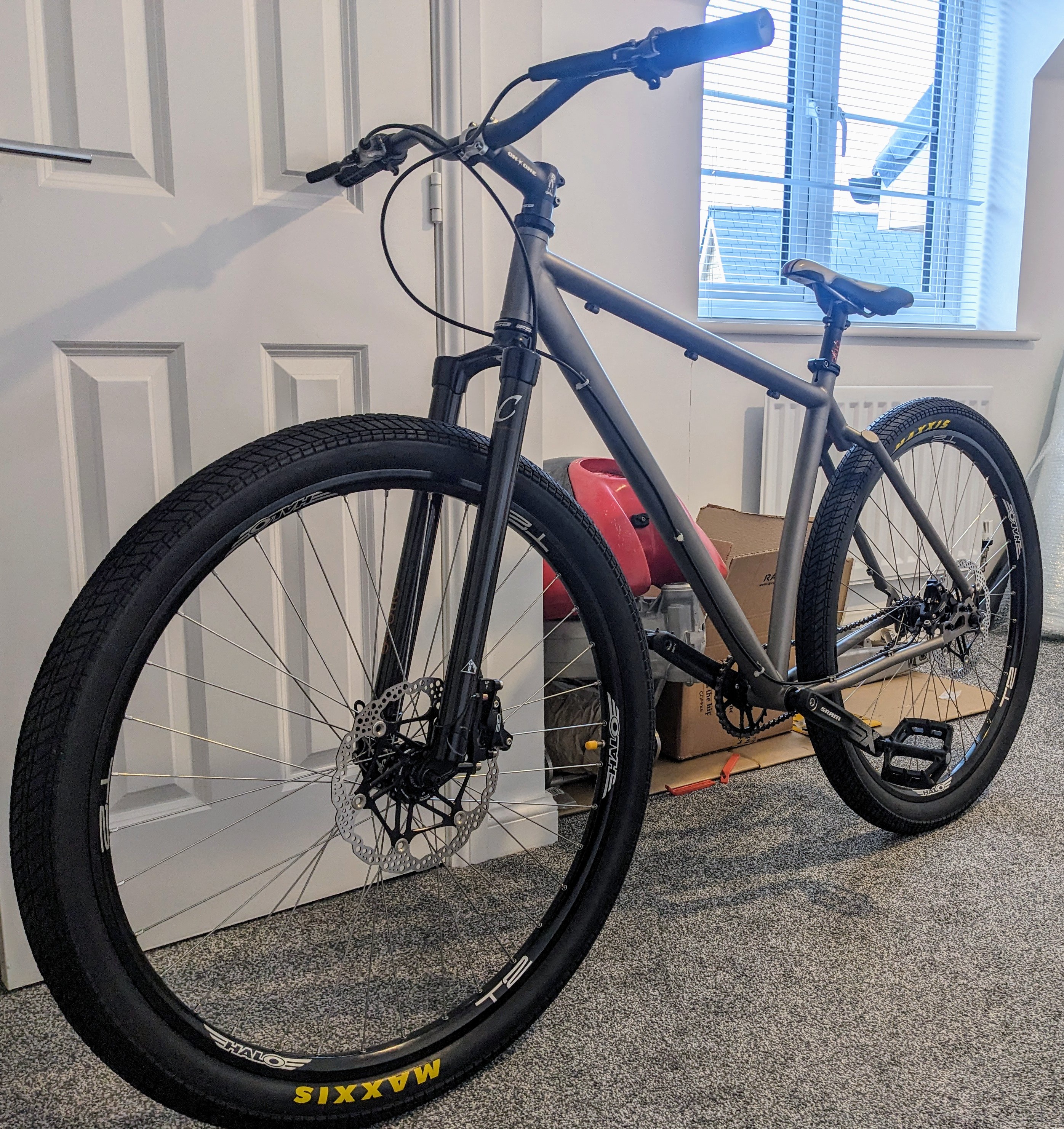

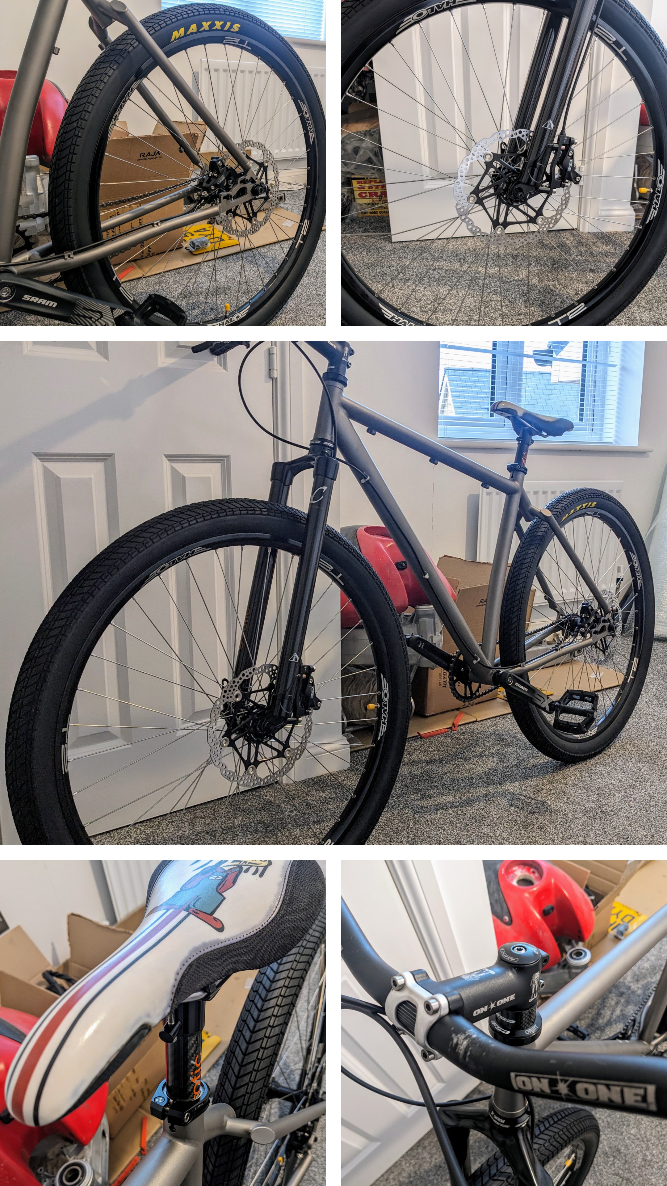

Start throwing the setup together now.
Stem cut and awaiting seat post.

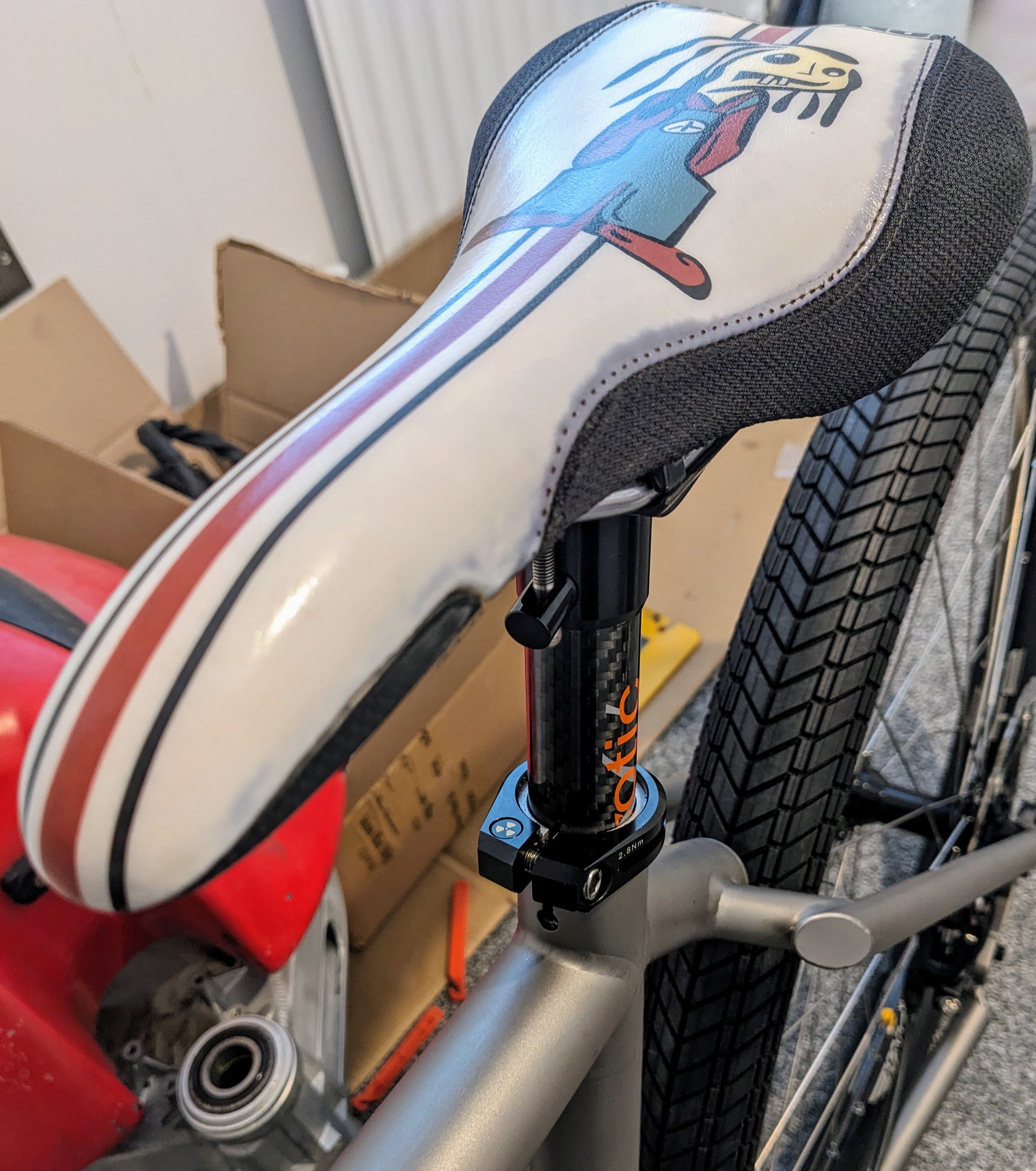

Seat height adjusted and saddle fitted.
The saddle is well worn, but turns out people want like £100 for these used on eBay

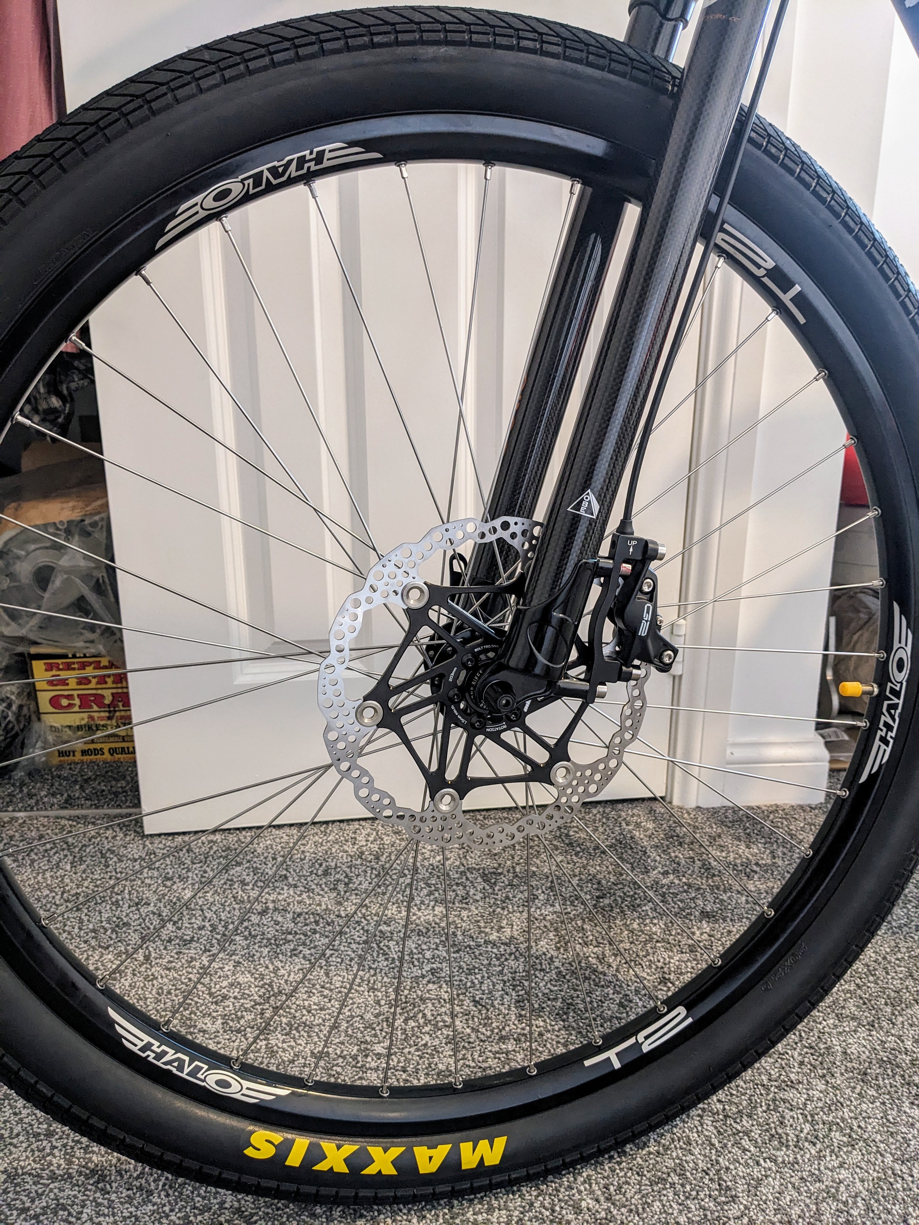

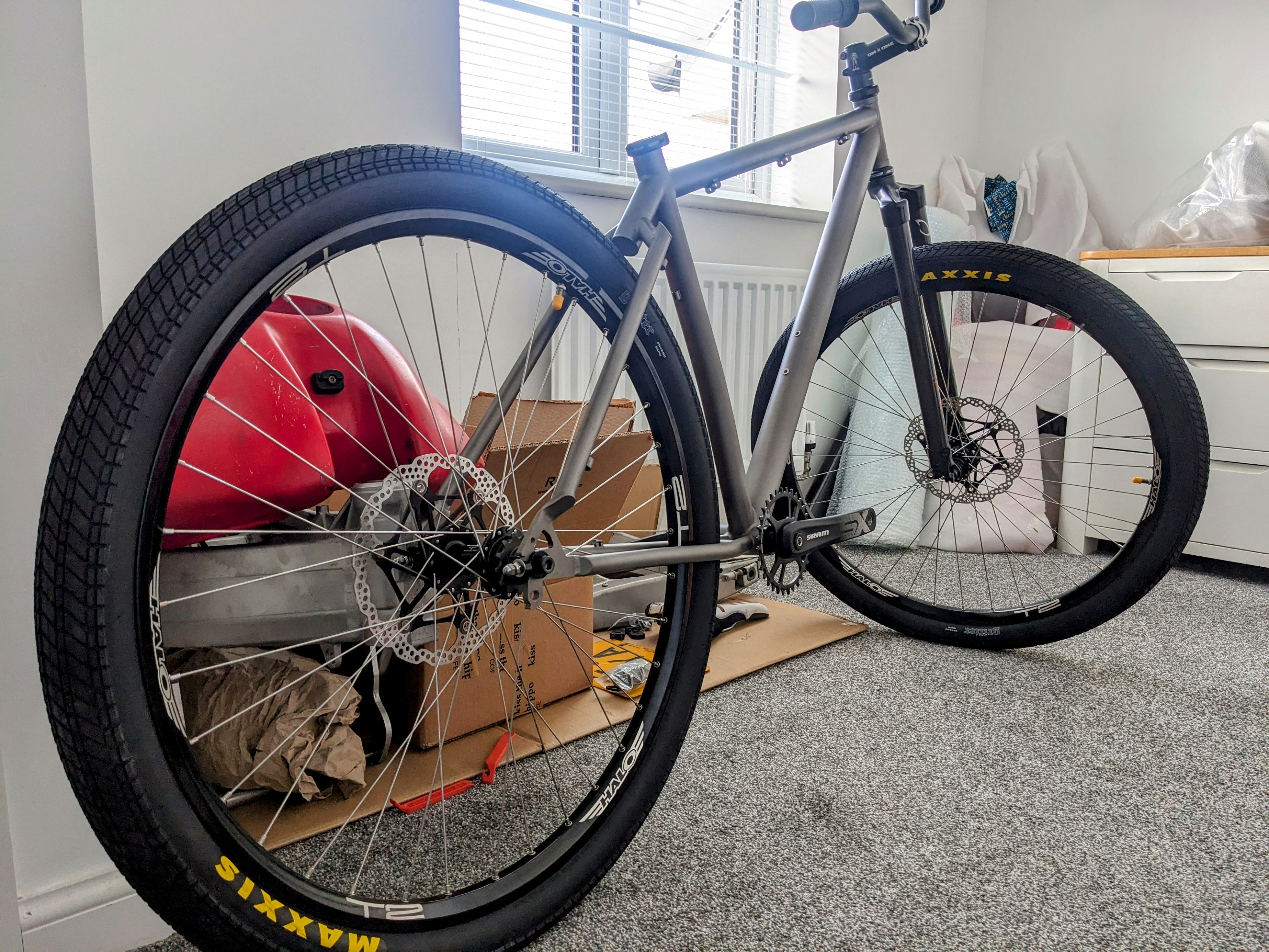

SRAM Glide2 brakes arrived this morning so I've slapped these on.
Not silly expensive brake setup, I shouldn't be going fast enough to even need them. The steel frame was rear rim and that was fine.

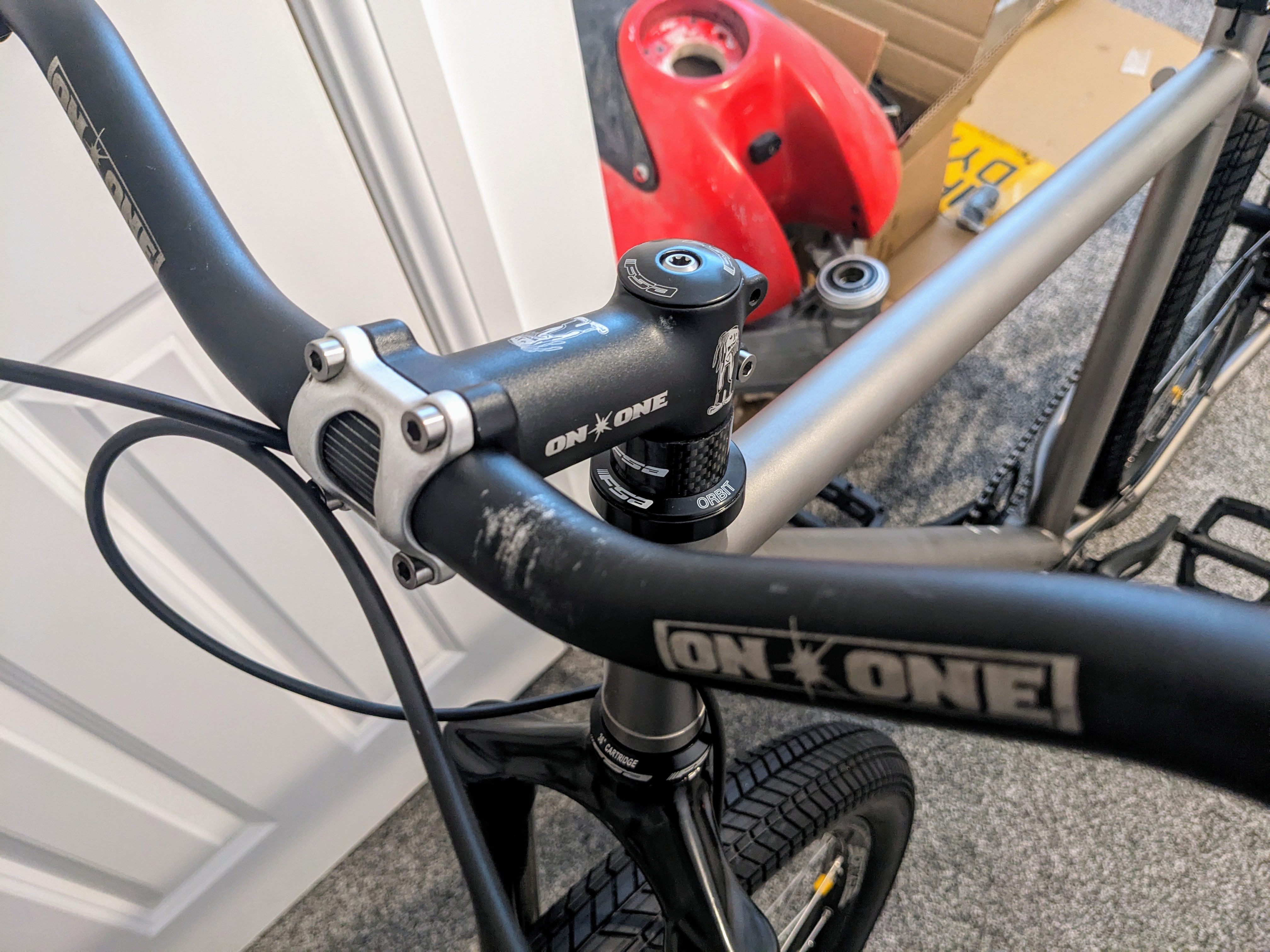

And throw on some of the original
On One Inbredparts for good measure.
Concluded
Which brings the project to a finish.

Assembly

That's the saddle and they want £110 USED.

Few teething issues just snagging the bike yesterday morning and then went to go ride the bike and came back to a flat tyre. Not sure if it was a defective inner tube as the puncture repair kit just melted the inner tube.
So I've ordered some more inner tubes and if I can be bothered could cycle over to Halfrauds and buy one so I can use it today.
The floating parts of the disc were fouling the bike/caliper so some minor adjustments needed and setting the chain tension etc. But it's basically there. Went around the block and I probably need to drop a few teeth on the front chain ring as I won't be doing any uphill cycling with it as it is. Fast on the flat though

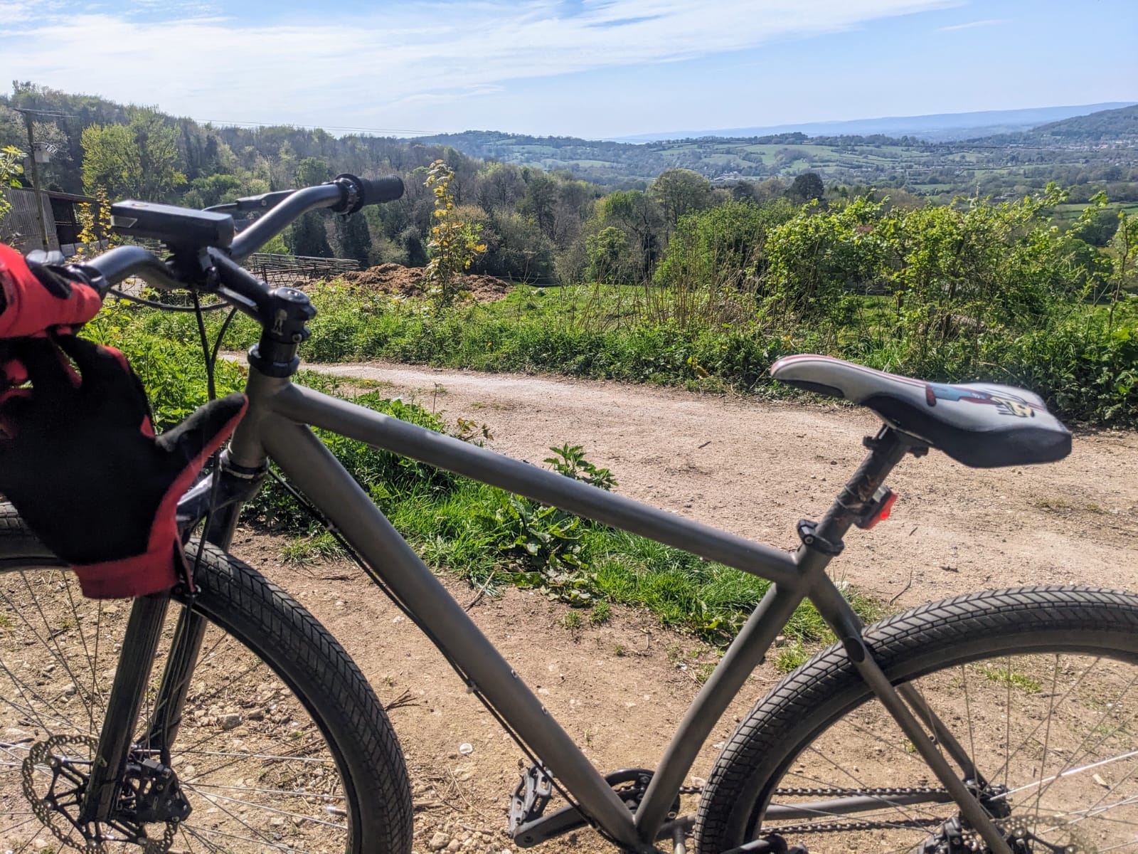

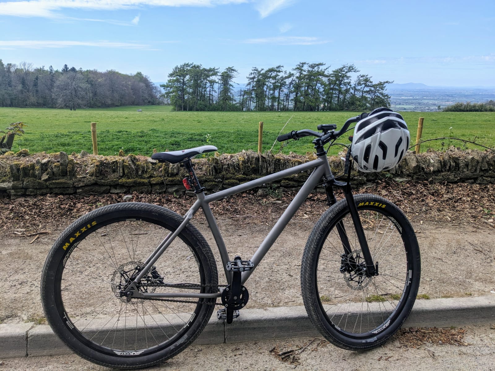

Finally!
Actually found some time to go out on this thing!
The original gearing I bought for this was a no-go and I ended up chucking it in the bin.
Instead, I found a Trail Tech crankset made for an E-bike, had to swap out the bottom bracket, but the result is something which gives me the ability to go up a few teeth on the front (currently rocking 24t), blitzes up moderate inclines, but lacks real top end.
I managed my usual route easier than the 26er, both up and down hill. It just felt like it handled the rocky sections better than the 26er, the lower gearing made it easier to climb some of the hills I had to get off and push, overall I'm very pleased about how this one has turned out, hopefully get a lot of use out of this over the coming years.
