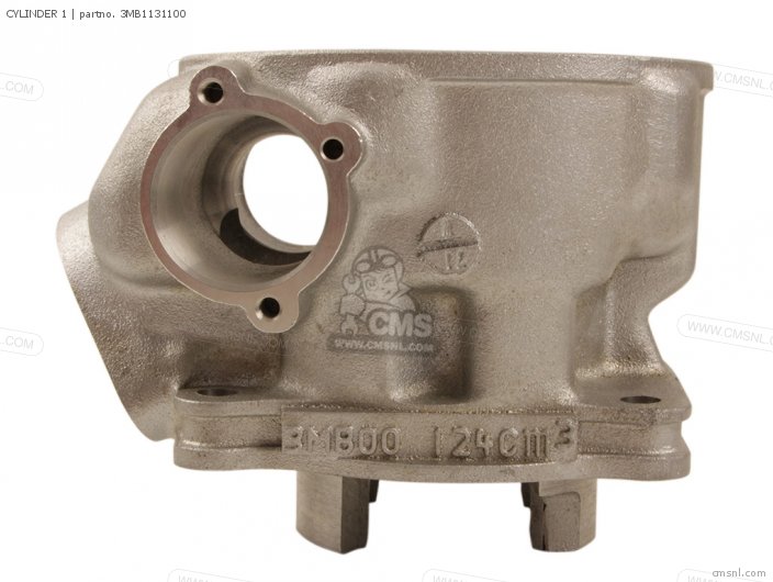

                Here is a 3MB cylinder.
                You'll see the crankcases are stamped 3BN
                For the most part you don't need to worry about it, it'll be rare that you'll find a DTR with a 3BN crank/cylinder and most of them will be 3MB cylinders. But it's just worth bearing in mind.
