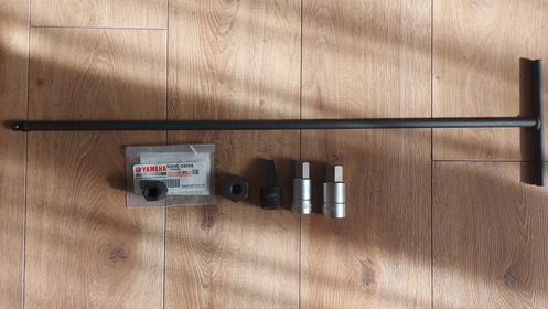

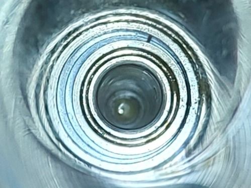

    Hi, i hope someone can advise me as to what tool is needed to take the front forks apart. The older DT's have a hexagon visable where the tool seats. Looking down the fork tube on the DTX there is no hexagon. It is extreamly puzzling...

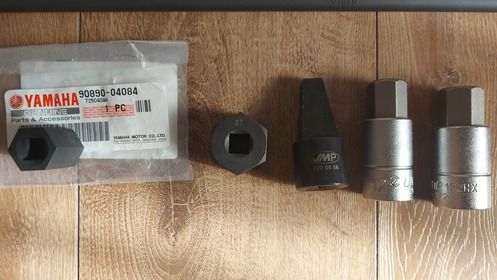

    These are the tools i have...

        @Calum Thanks bud, yes I still have that tool I made somewhere. Been following this thread and it's puzzling there's no visible means of holding the damper rod like on DTR forks. Possibly someone on a WR125X forum or Facebook page might know?

          WR125R Front Fork Damper Rod Tool.
          This 3/8"sq drive extra-long 8mm Allen key socket is ideal for removing and refitting the damper rod in the front forks. The extra length is required to reach the bolt beyond the spindle hole. As the bolt has a shallow opening, this tool is perfect for a damage free job!
          Im guessing this is what i need. I have one on order so will update if it fits.

            Update: That tool didn't fit. If anyone knows what tool i need do please share.

              @Mekoz To get the forks apart, a lot of bike shops buzz gun the bottom bolt out. It can help to get an assistant to compress the fork somehow while you do this so the spring pushes harder against the damper rod and makes it even less likely to rotate.
              You would then at least have the forks apart which will make it a lot easier to examine the damper rod and see exactly what tool you need to make/buy to securely hold it when re-tightening the bottom bolt after replacing the seals etc.
