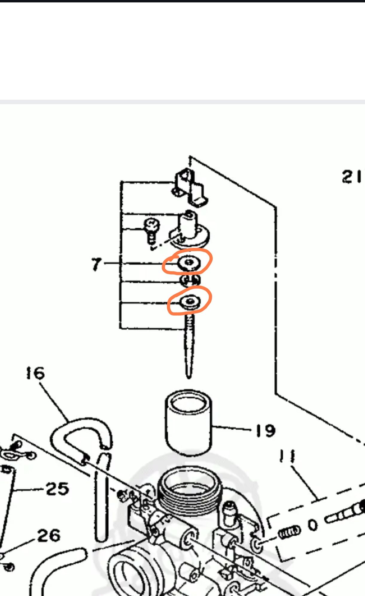

    Hello! I have a 1988 Yamaha dt 125r, I've had problems with it but nothing major.
    One of the problems is with the carburetor: the needle is missing two washers, one under the clip and one over the clip. As they don't sell those washers individually I decided that I'd make my own washers. The only problem is that I don't know that size they're supposed to be, so if anyone has a 1988 Yamaha dt125r or even a Tzr125 (they had the same carb I think) I would appreciate the sizes of those washers, especially the thickness.

          Do you think the washers are compatible with the later models? I've looked at photos, they seem to be identical. Even if they aren't, It would be at least a great starting point to know the later model sizes.
            Yeah, I certainly think it's worth a shot. I can't see it making too much difference one way or another

                After some research I did manage to find the sizes, and some more detailed photos so now I can actually buy some. I do think that it's rather a stopper or something than an adjustment tho obviously it changes the needle height, either way I'm sure they're important. Thank you all for the help!
