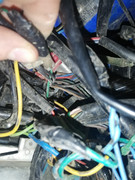

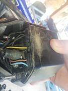

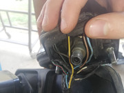

    Hello! I have Yamaha DT125 1999 and I want to derestrict it. It has 16t front and 57t rear sprocket and top speed is just around 80km/h (50mph) and in 6. gear it revs up only to 6k rpms.
    I have a problem with derestricting. I choose the method with black/green wire that is behind a speedo because I found it easiest, but I can not find any wire that looks like that... There is a mess with those wires and it has anlaser starter so that might be the thing why it is so messy...
    https://i.postimg.cc/D8pRrbCy/1.jpg
    1. wire that is going from speedo has 6 wires on top (not 3), and the same is on the bottom, and it has some wires that are not in that white block but none of them is black/green...
    https://i.postimg.cc/SYyHrLFj/2.jpg
    https://i.postimg.cc/SjyPHG3x/3.jpg
    https://i.postimg.cc/tYRHtbpD/4.jpg
    2. one is messy asf
    https://i.postimg.cc/sQzLjP2K/5.jpg
    https://i.postimg.cc/dDBb0frC/6.jpg
    1. which I think that is supposed to be the one with black/green wire, have 5 wires on top and the same on the bottom and neither of them is black/green one…
      https://i.postimg.cc/946xxdTC/7.jpg
      https://i.postimg.cc/QHJRHy75/8.jpg
      https://i.postimg.cc/FY854Jcn/9.jpg
      https://i.postimg.cc/gwXSqSxg/10.jpg
      And there is also this thing...
      https://i.postimg.cc/phQgzGSg/11.jpg
    Its quite a mess so can't really see wires...If anyone knows how to check which is rev limiter wire or something please help...

      @Lukas55 the black green wire restriction is on later dt125re and dt125x models only. Yours may have the read switch behind the speedo that needs moving away from the speedo but left connected.

                                @DTR-NSR I am not sure but I think that 3 wires are coming out of servo...Markings on CDI are a little bit erased so it is not clear what does it say...
                                https://i.postimg.cc/vDXz2TwH/cc.jpg
                                https://i.postimg.cc/NK2k0x95/ccccc.jpg
                                https://i.postimg.cc/ns8Y9QBT/cdi.jpg
                                https://i.postimg.cc/RNDT9Y0k/cdii.jpg

                                  @Lukas55 bitsa = bike made up from parts from several different bikes.
                                  It sounds like your bike might have early wiring and cdi. I'd be checking the powervalve is in the open position and the exhaust has had the restrictions removed if it's a original yamaha one. Hard to make out much out from your pics.

                                    @DTR-NSR Yea I know pictures are not great but I can not even see better with my eyes xD. It has some different exhaust I would say that it have yz 125 silincer... Okay so if the black/green wire is going into the speedo it must come from somewhere...

                                      Btw that is 3MB cdi.

                                        DTR+NSR
                                        @Lukas55 the black green wire comes from the cdi, but your bike will not have the black green wire. It's only found on later bikes 2004/5 onwards. I've got a feeling yours is running about 1998 wiring and cdi. The restrictions in the exhaust are in the front expansion chamber part.

                                          @DTR-NSR So it has only exhaust restriction?
