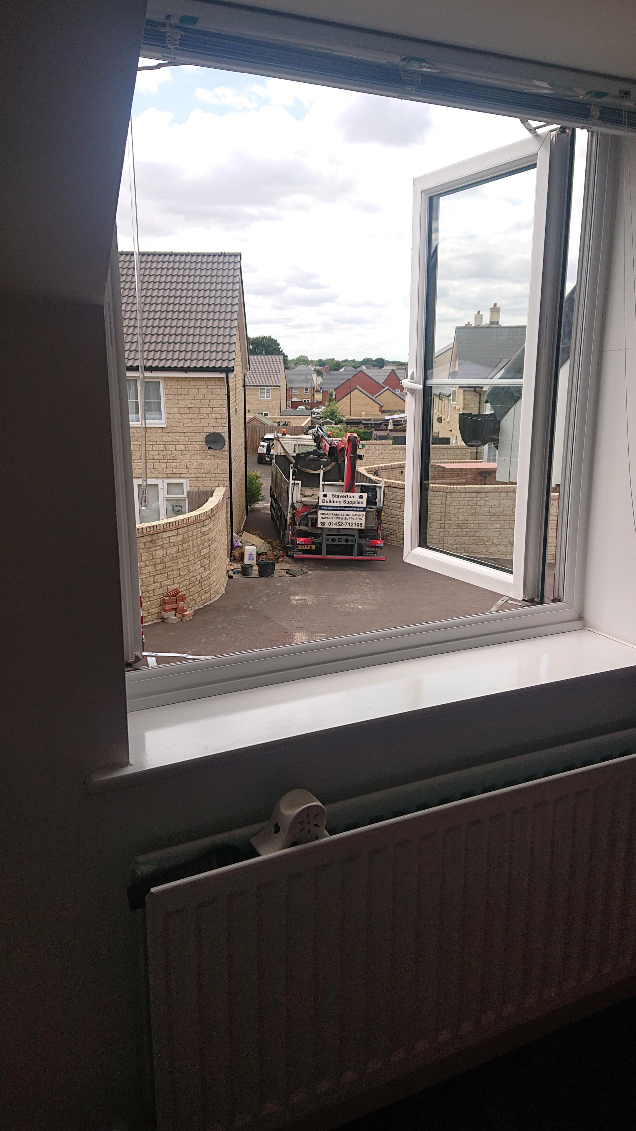

    With a plan ahead of ourselves, we set out ordering £2000 worth of timber to be delivered up my private drive...
    alt text
    Hats off to the HGV driver reversing the ten ton lorry up the drive from a "New Build" road, considering how narrow roads on new estates can be, this was an impressive feat.

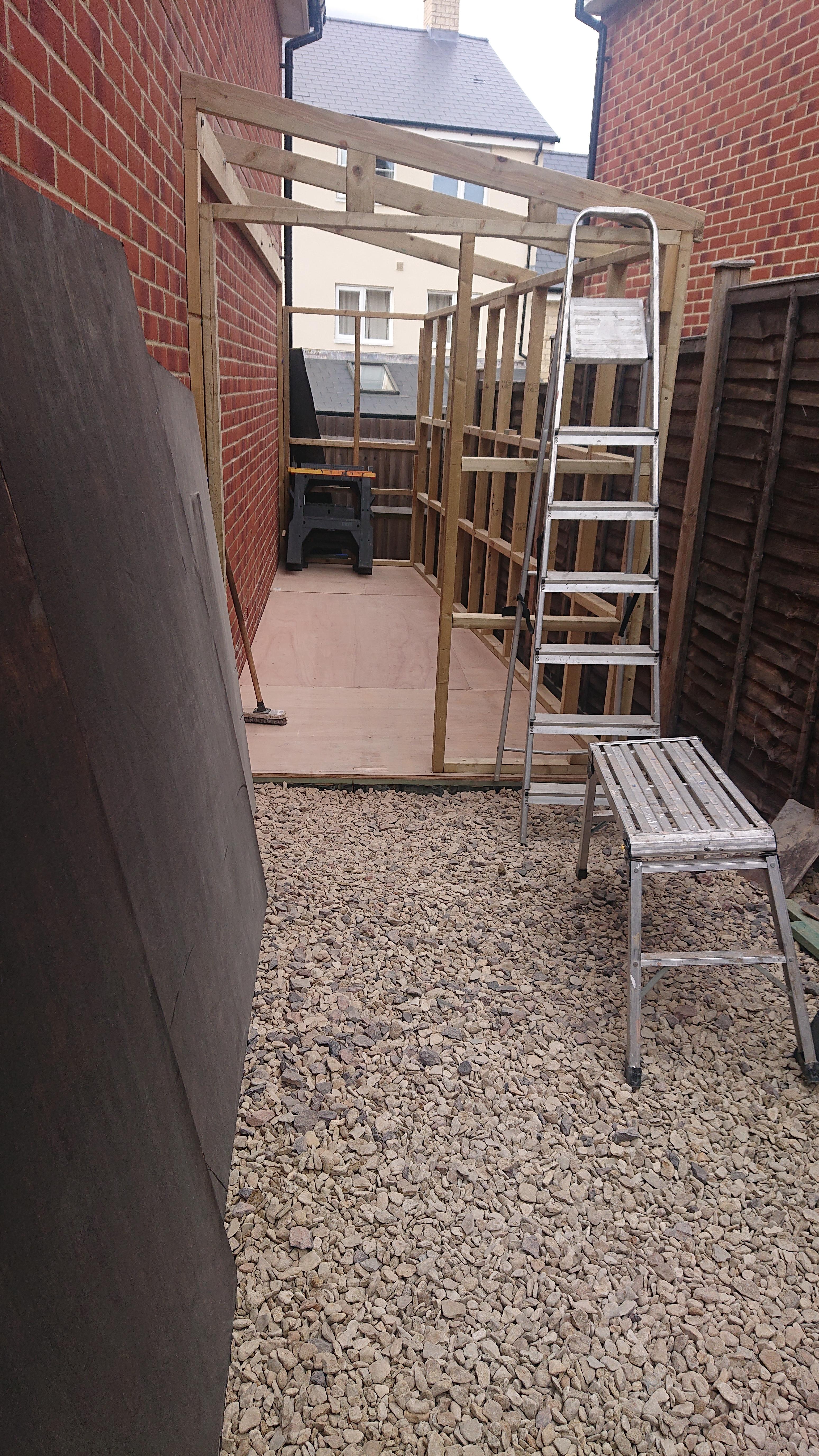

    Constructing The Floor

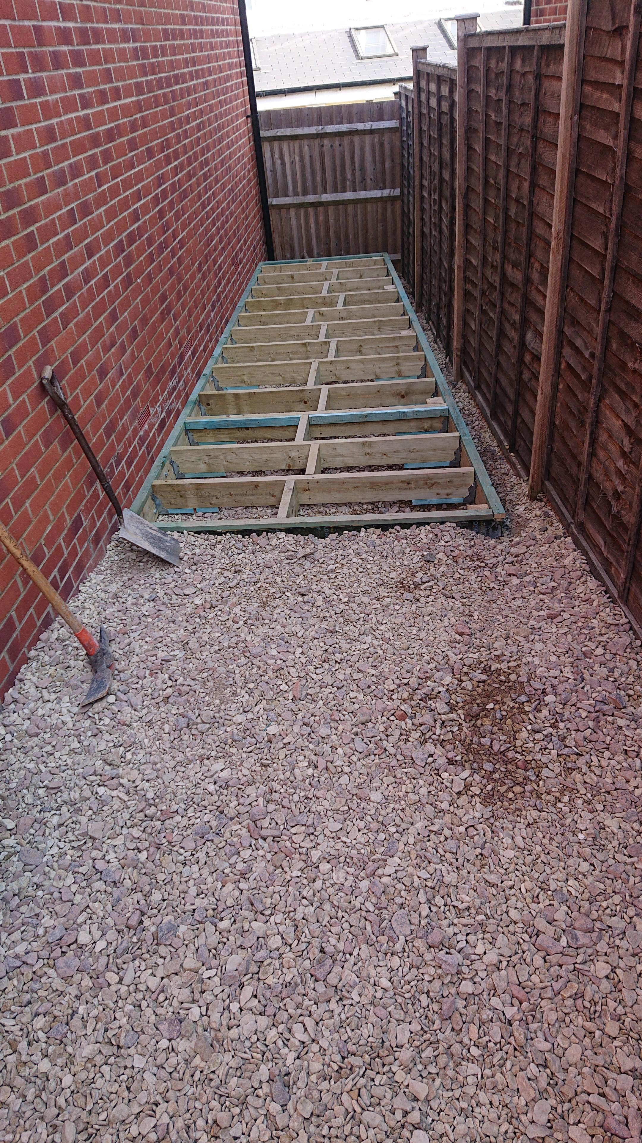

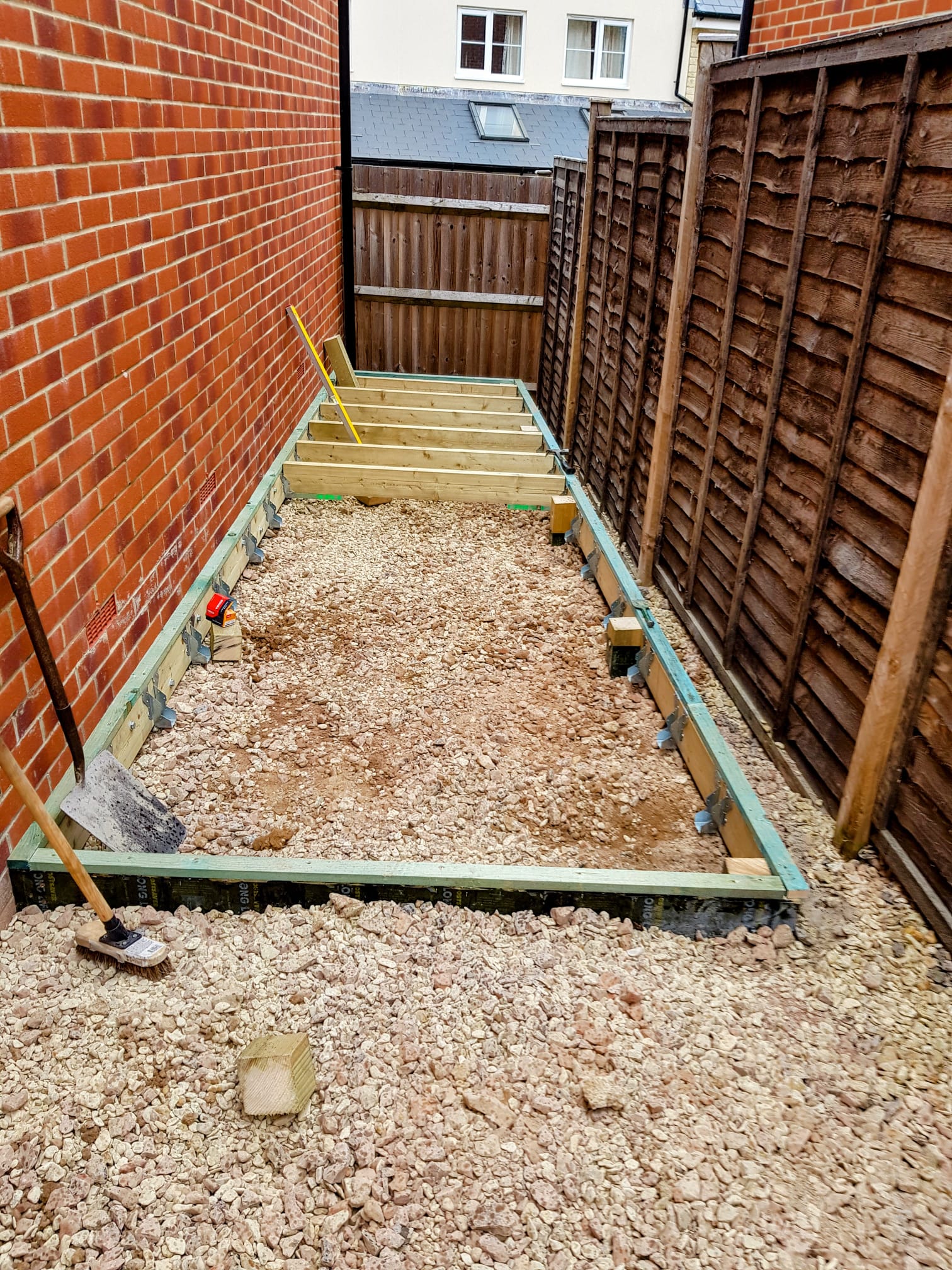

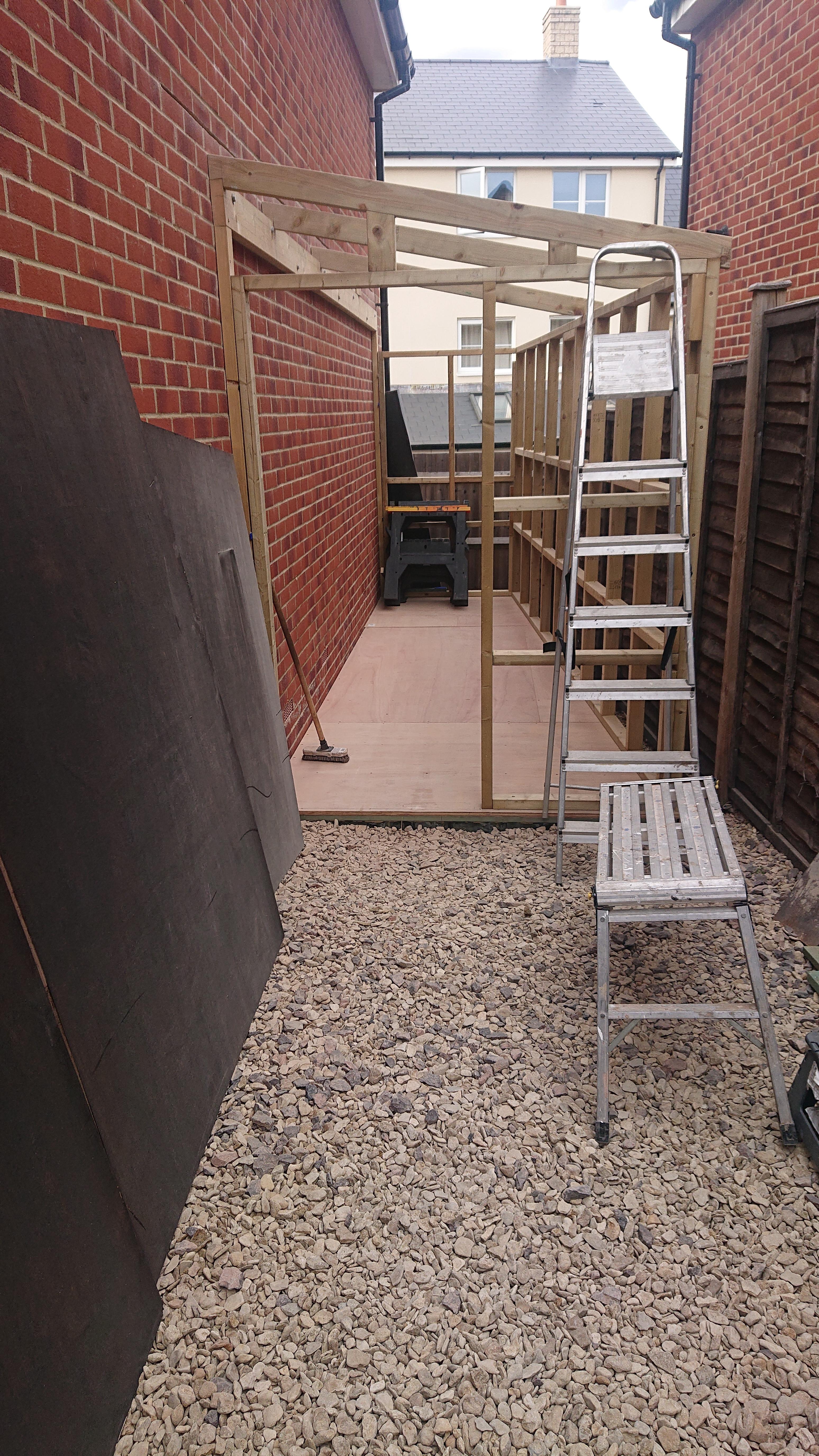

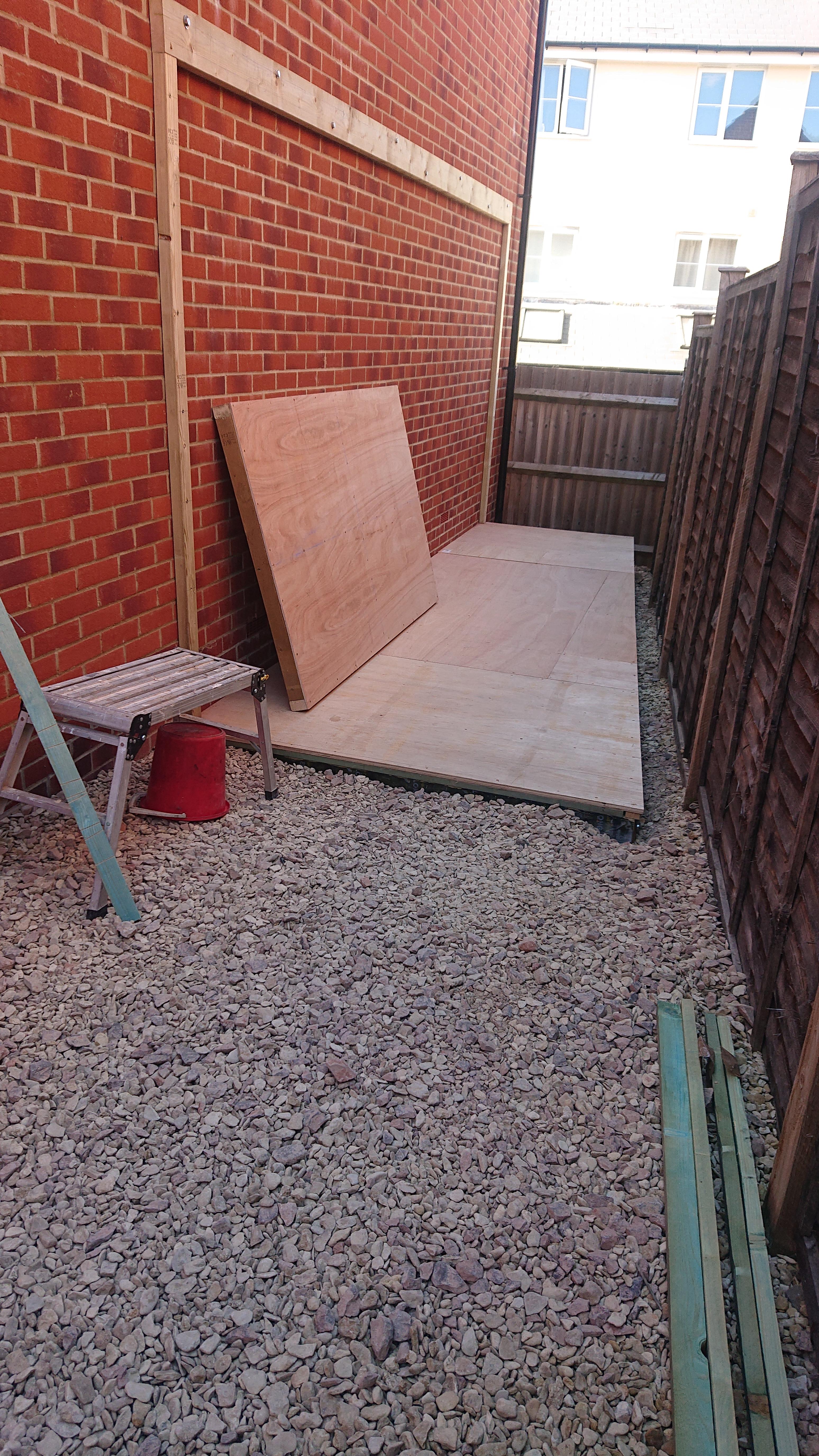

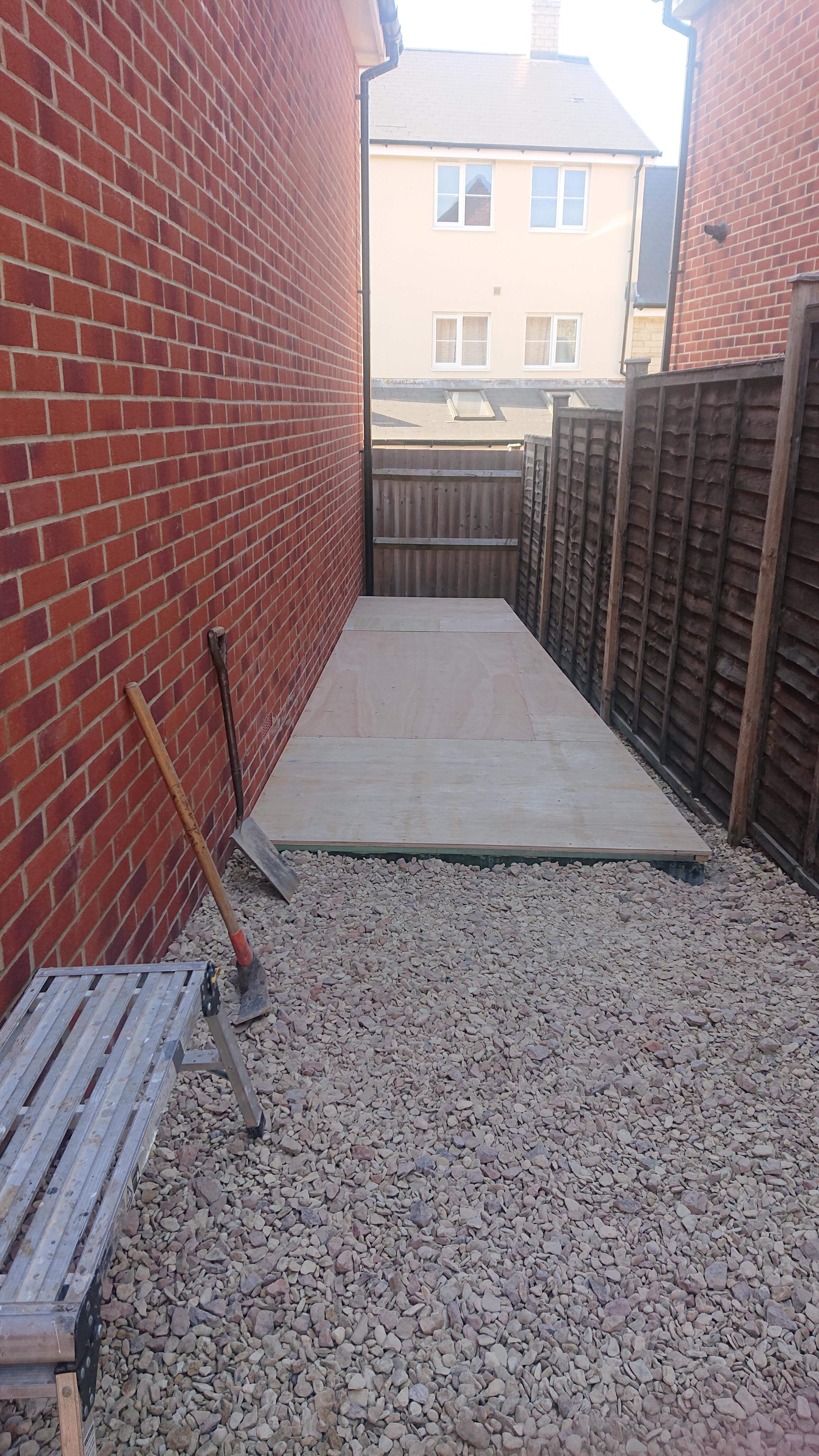

    We started on the hottest day of the year, working relentlessly to dig out the earth and affix the floor joist to the side of my house, as well as dig out the earth for the adjacent posts.
    alt text
    alt text
    It may not look like much, but this culminated a couple of weekends work to just get a decking of sorts for the floor down.

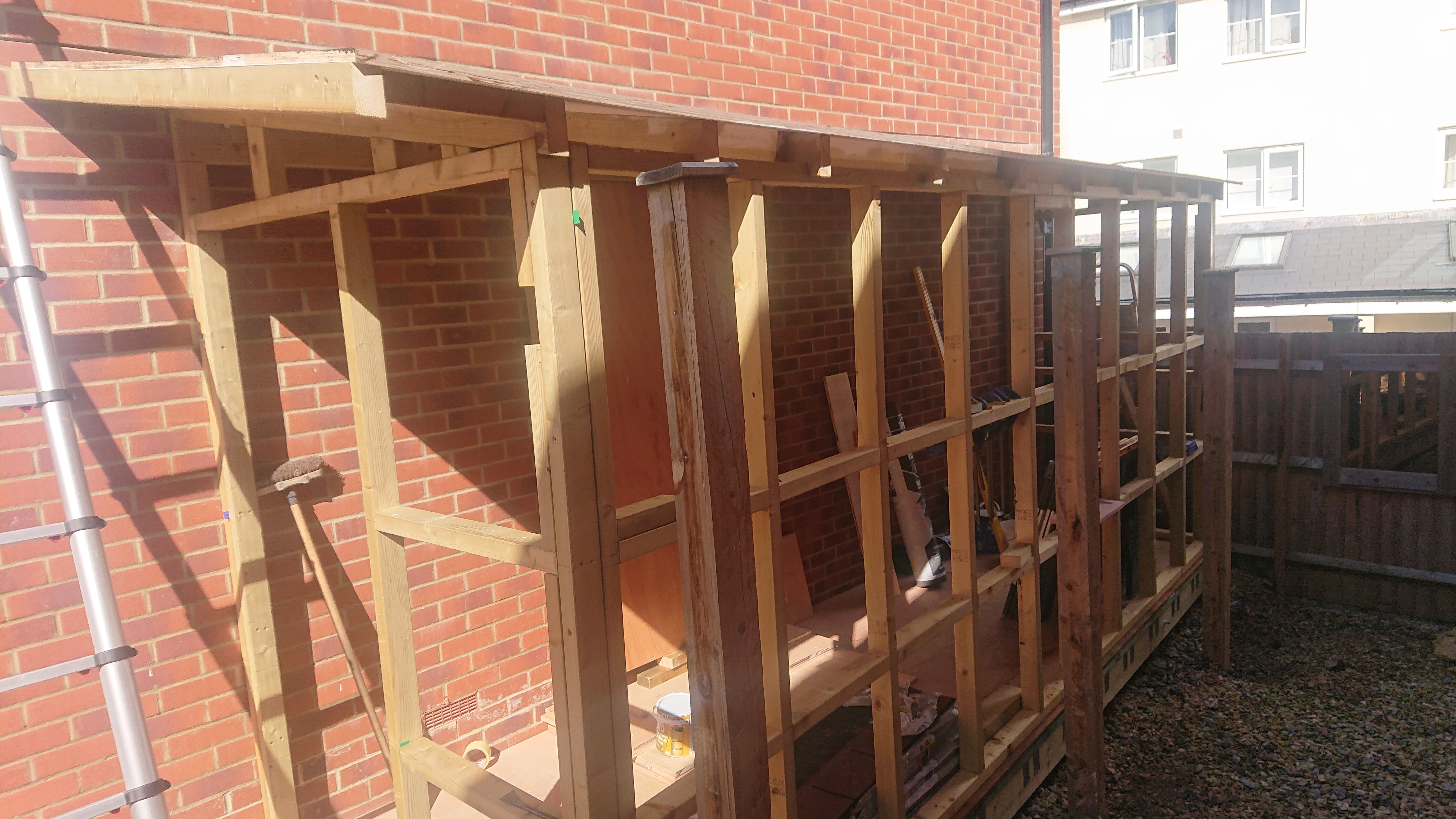

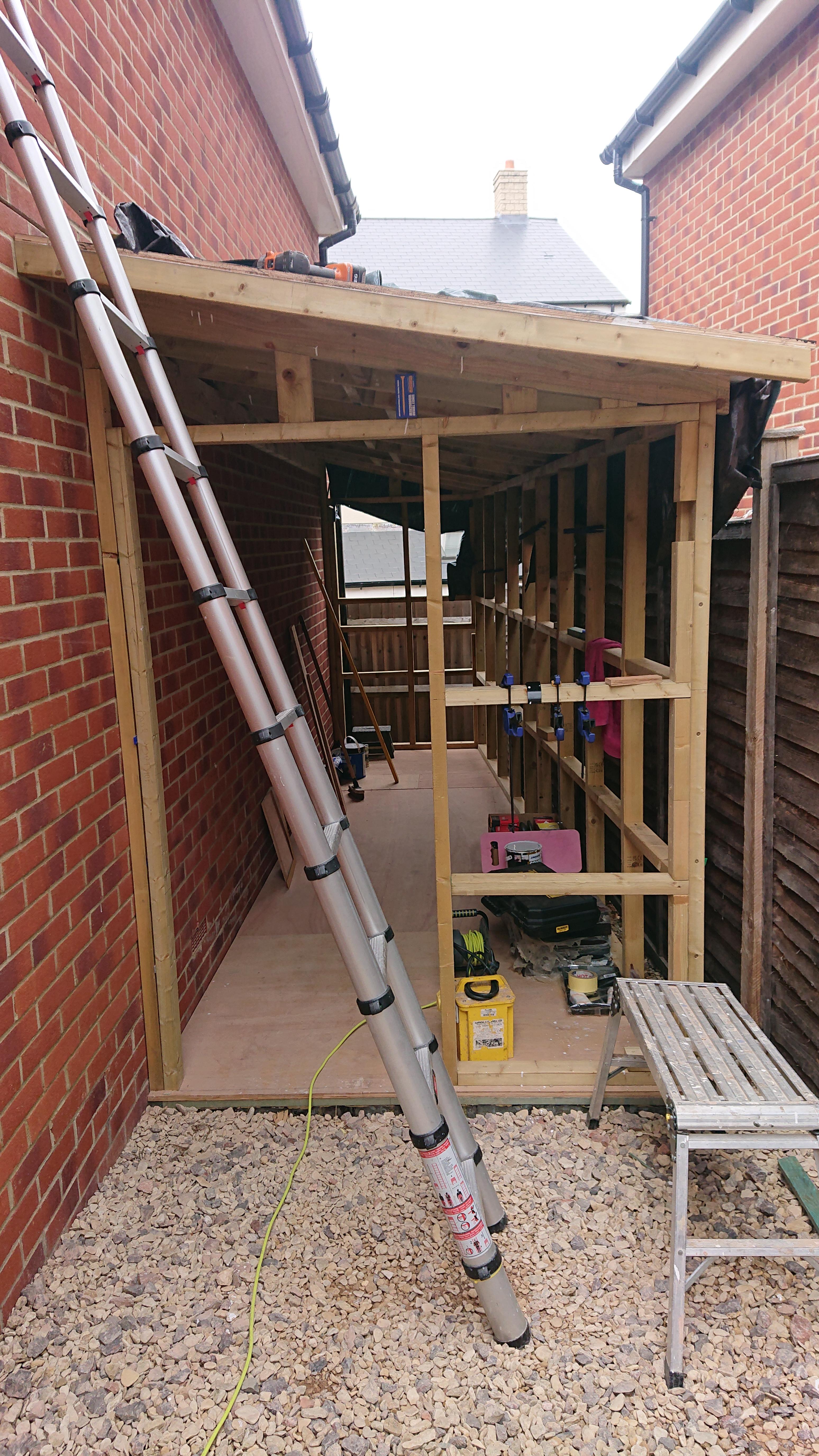

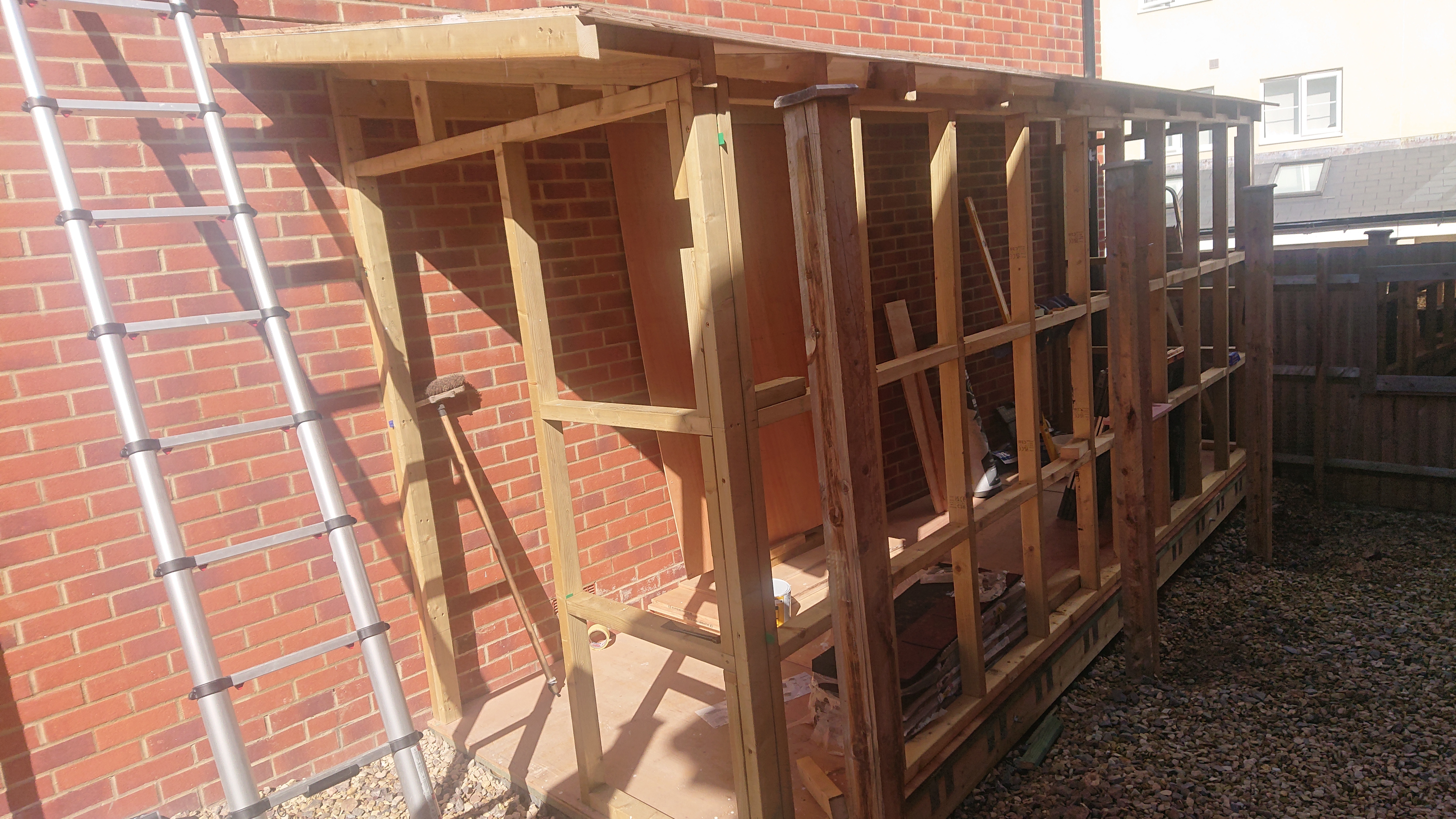

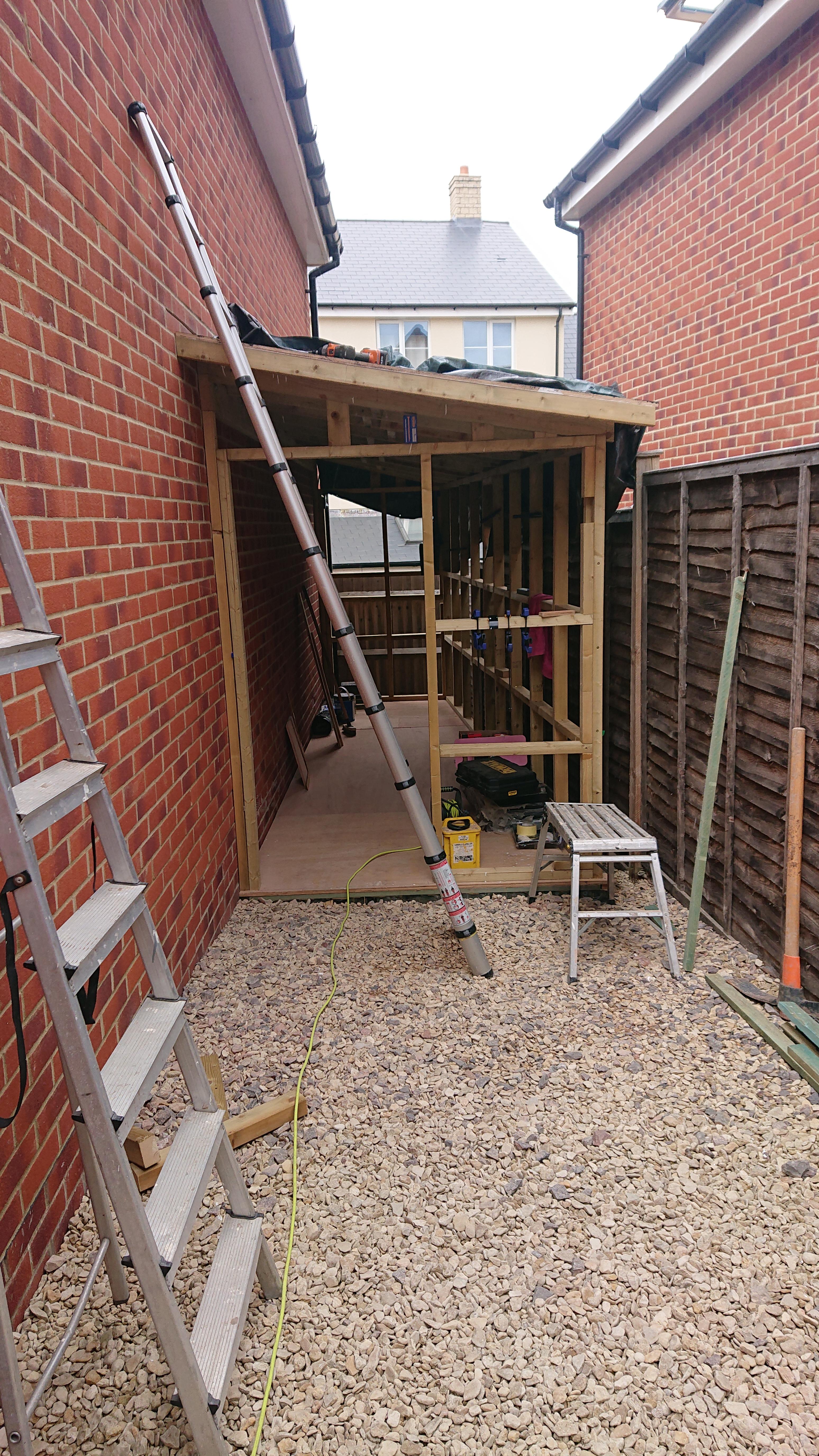

    With a sturdy floor, we could begin constructing the walls and the ceiling joists. Again the 5.1m floor joist is Thunderbolted to the side of the house to allow the roof joists to fasten to.

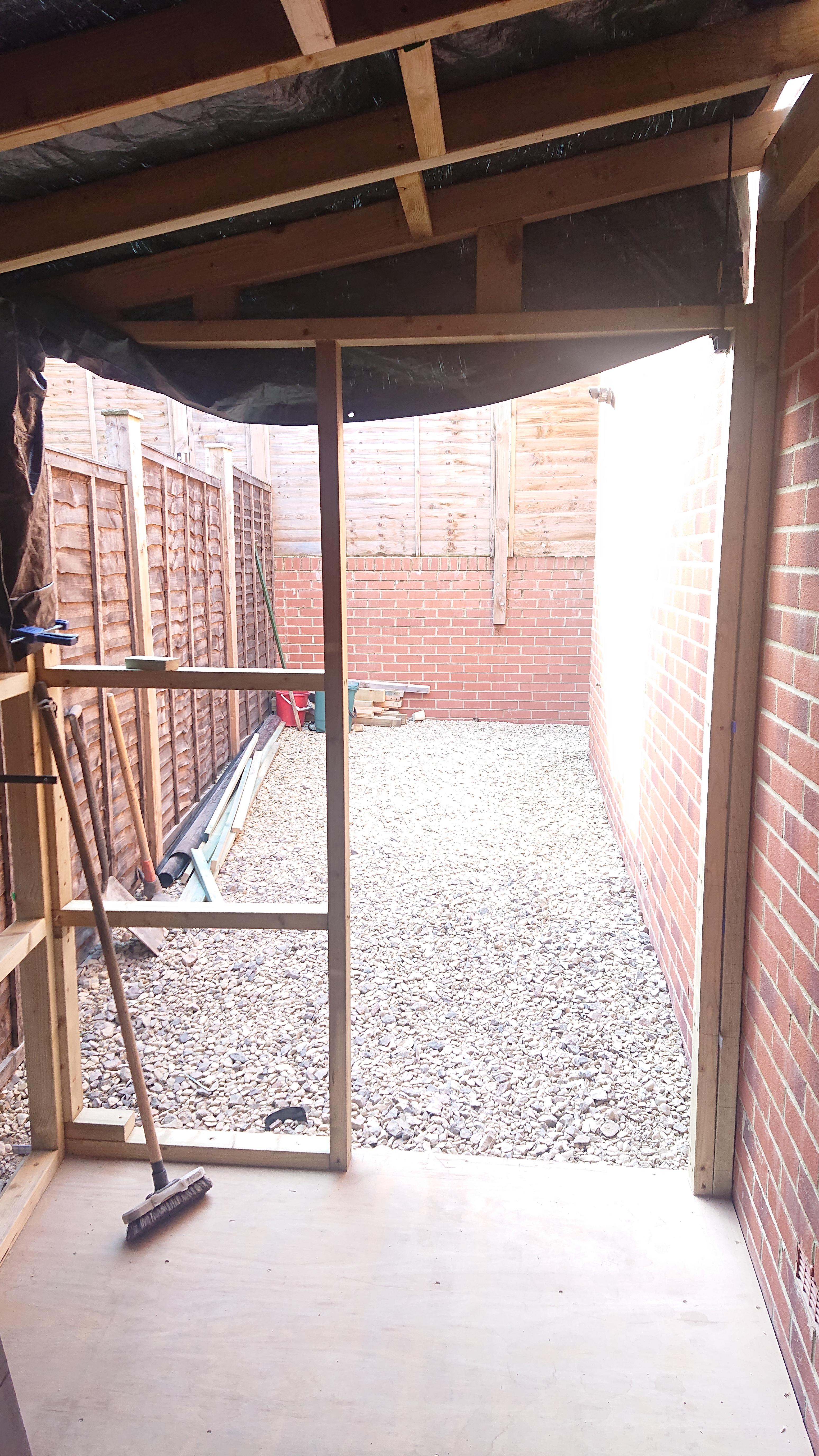

    Wall Framework
    alt text
    alt text
    Roof Framework

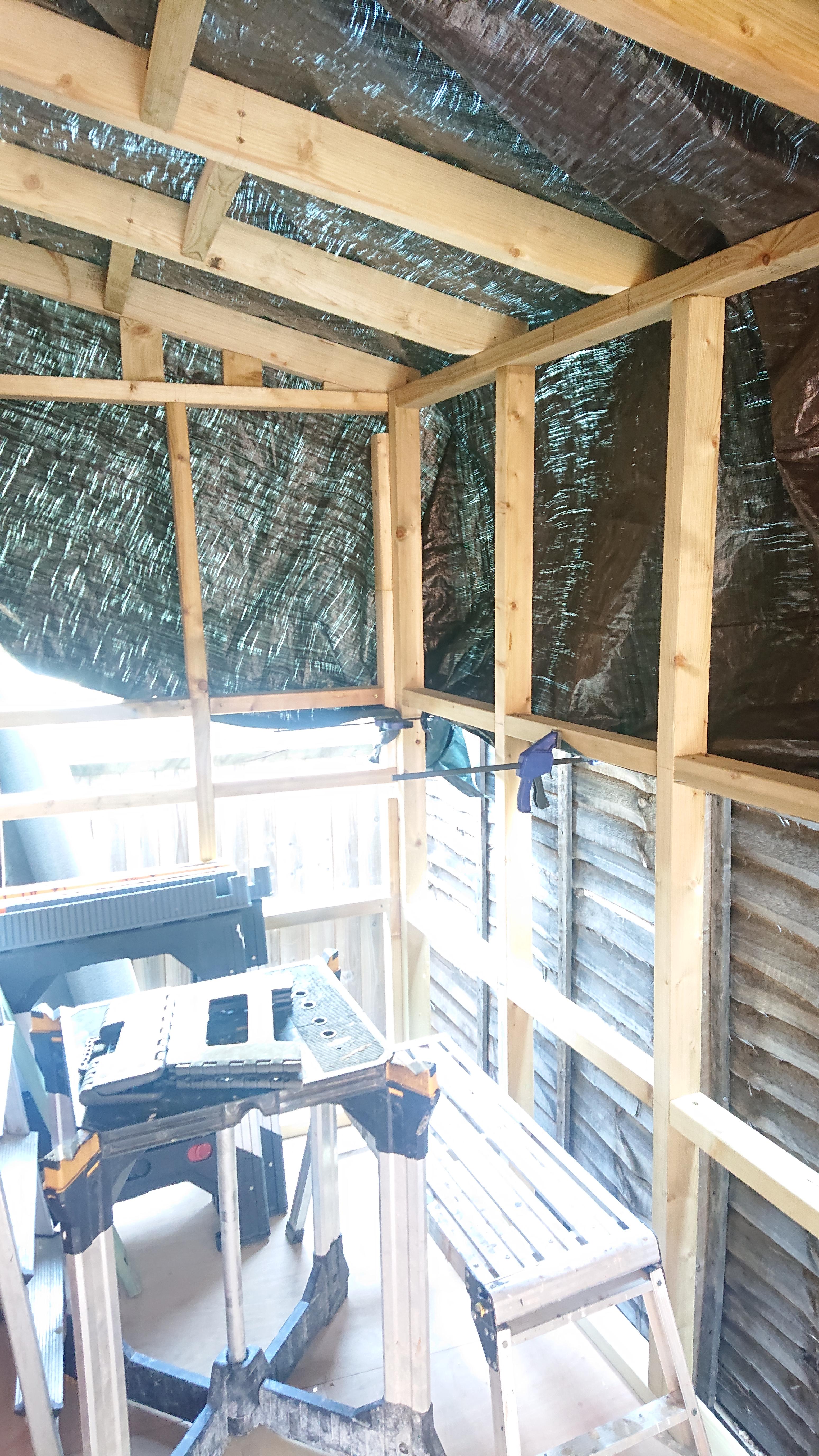

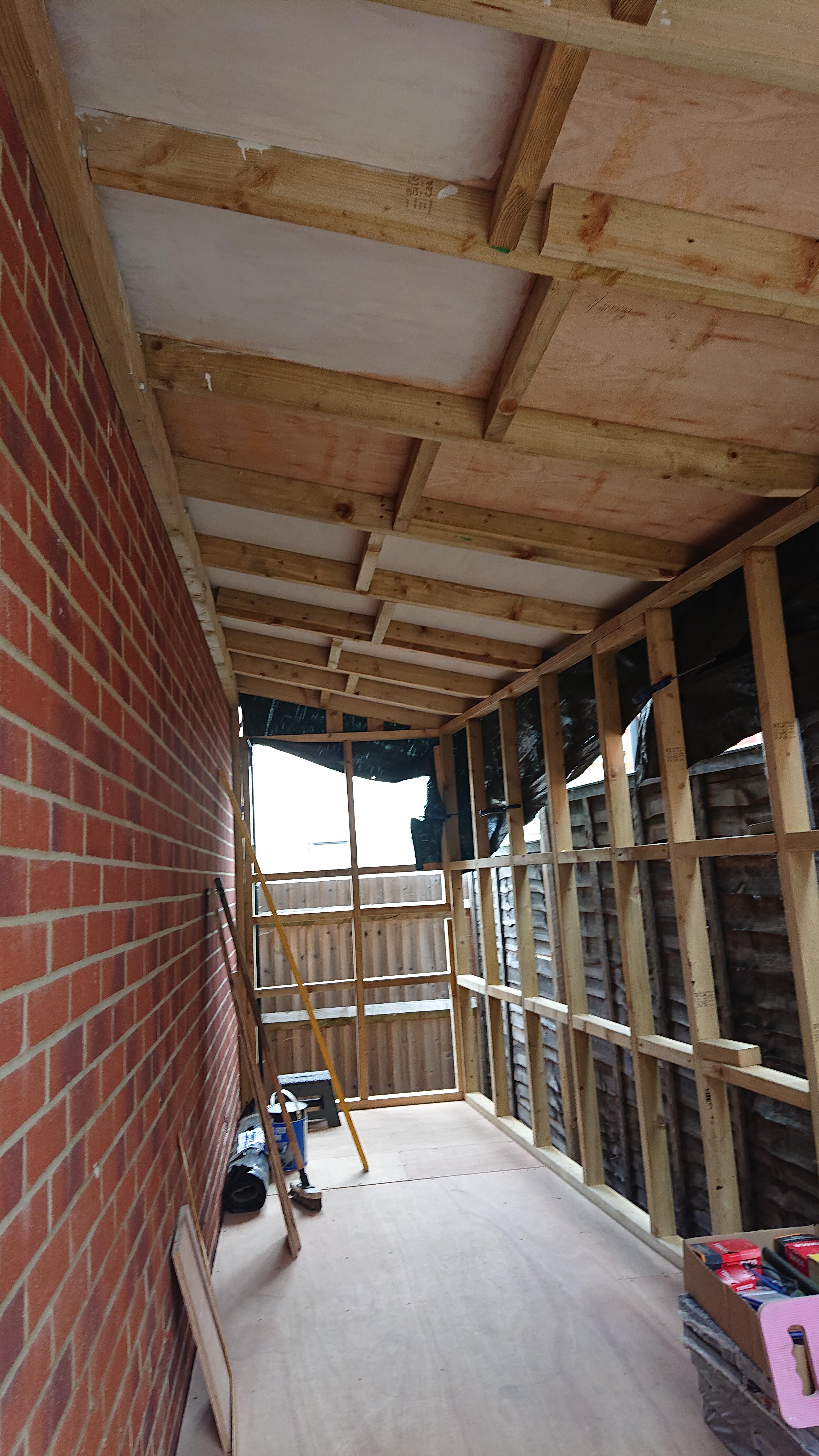

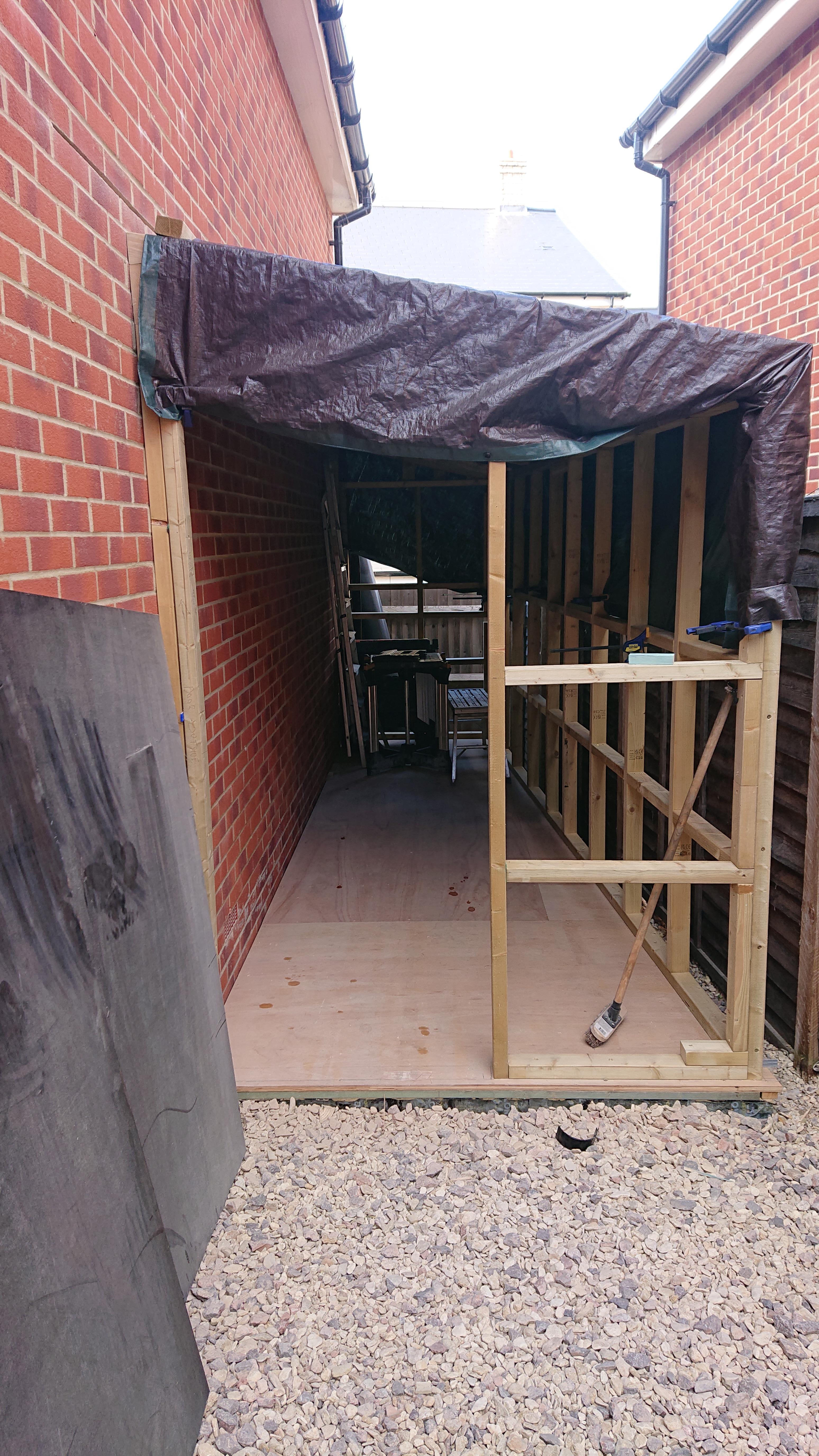

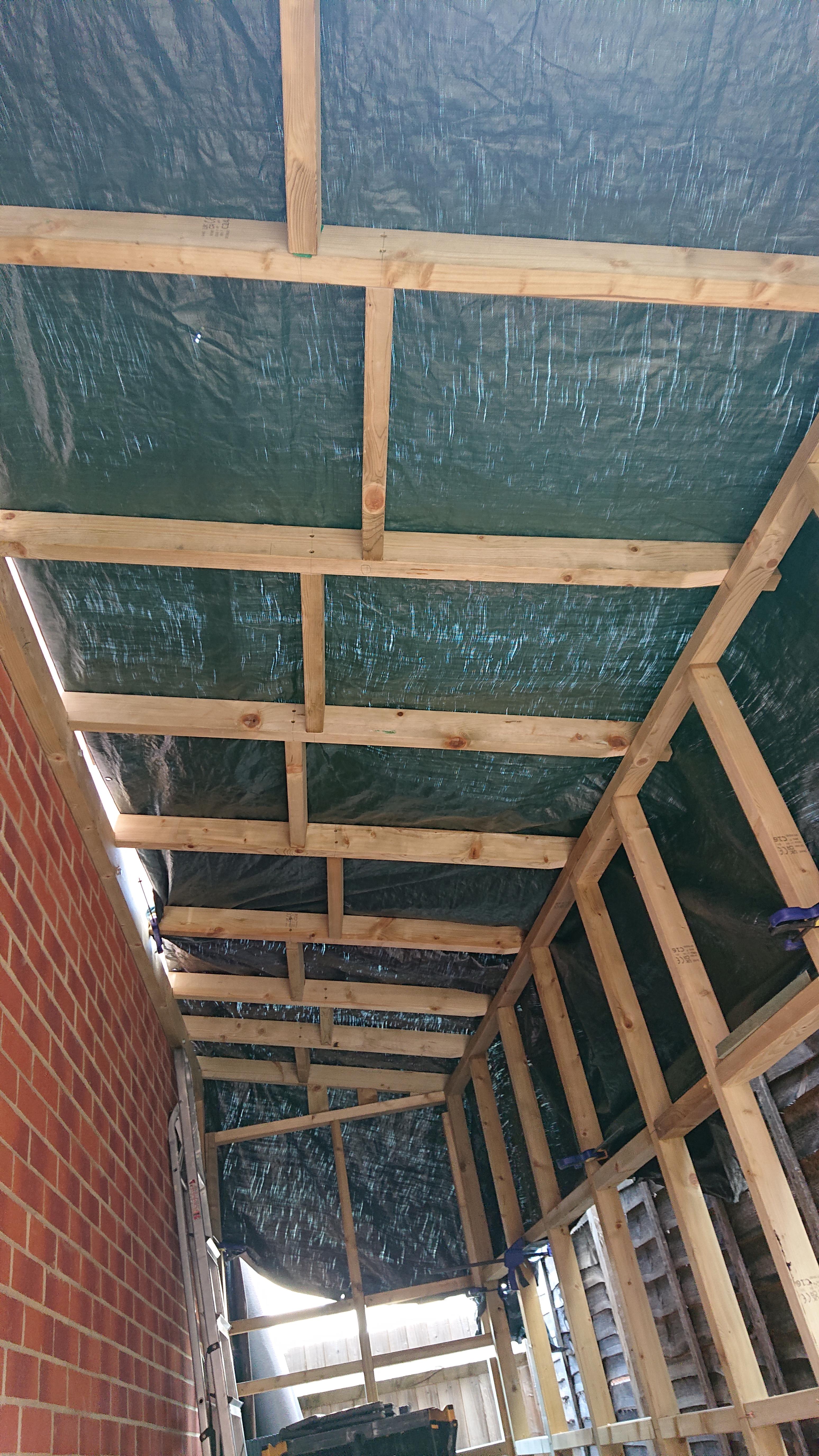

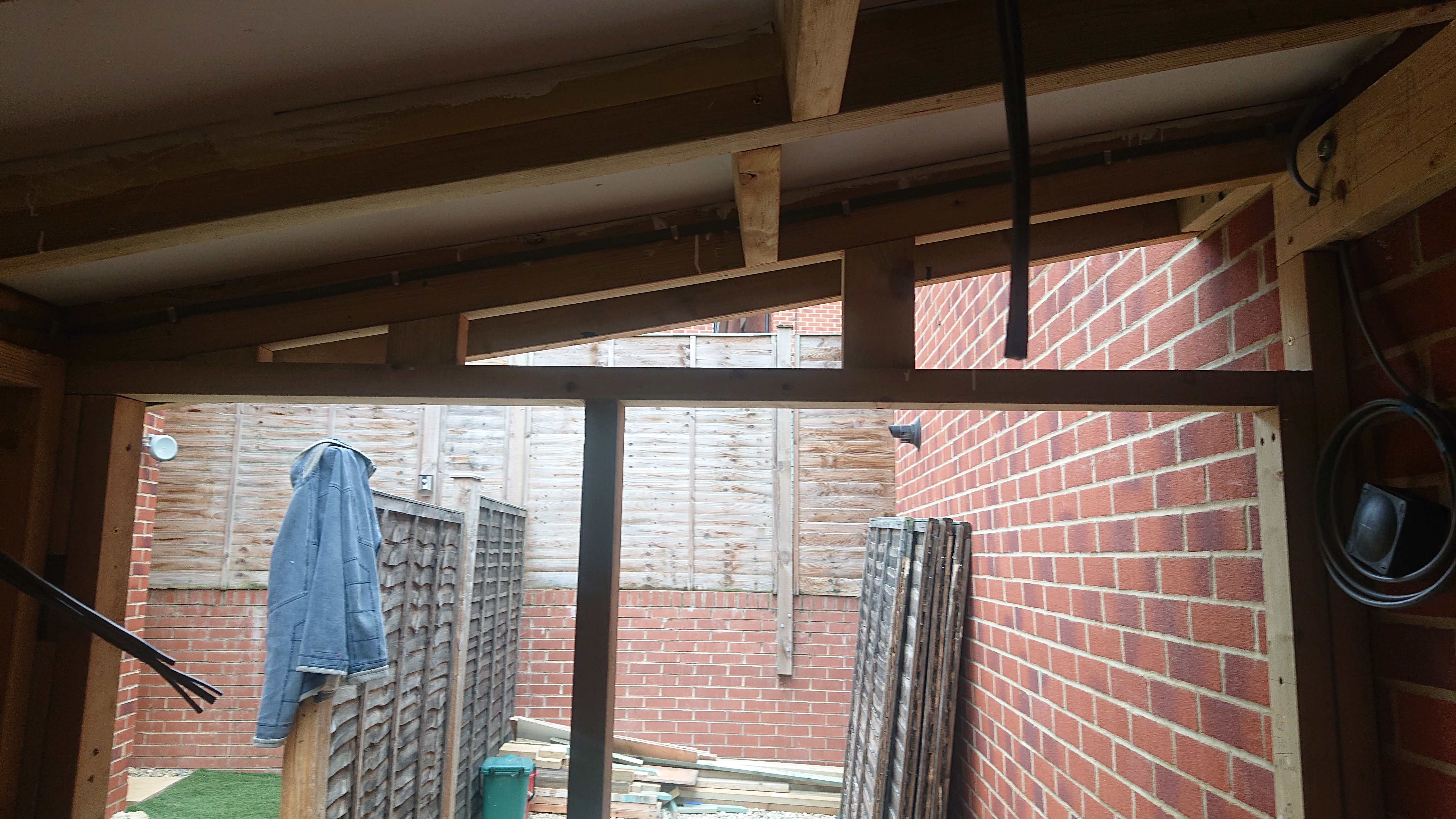

    With the walls up and the roof joists on we could construct the ceiling of the workshop.
    alt text
    alt text
    Keeping it wrapped up to protect the flooring in the event of any bad weather.
    alt text
    alt text
    alt text
    alt text

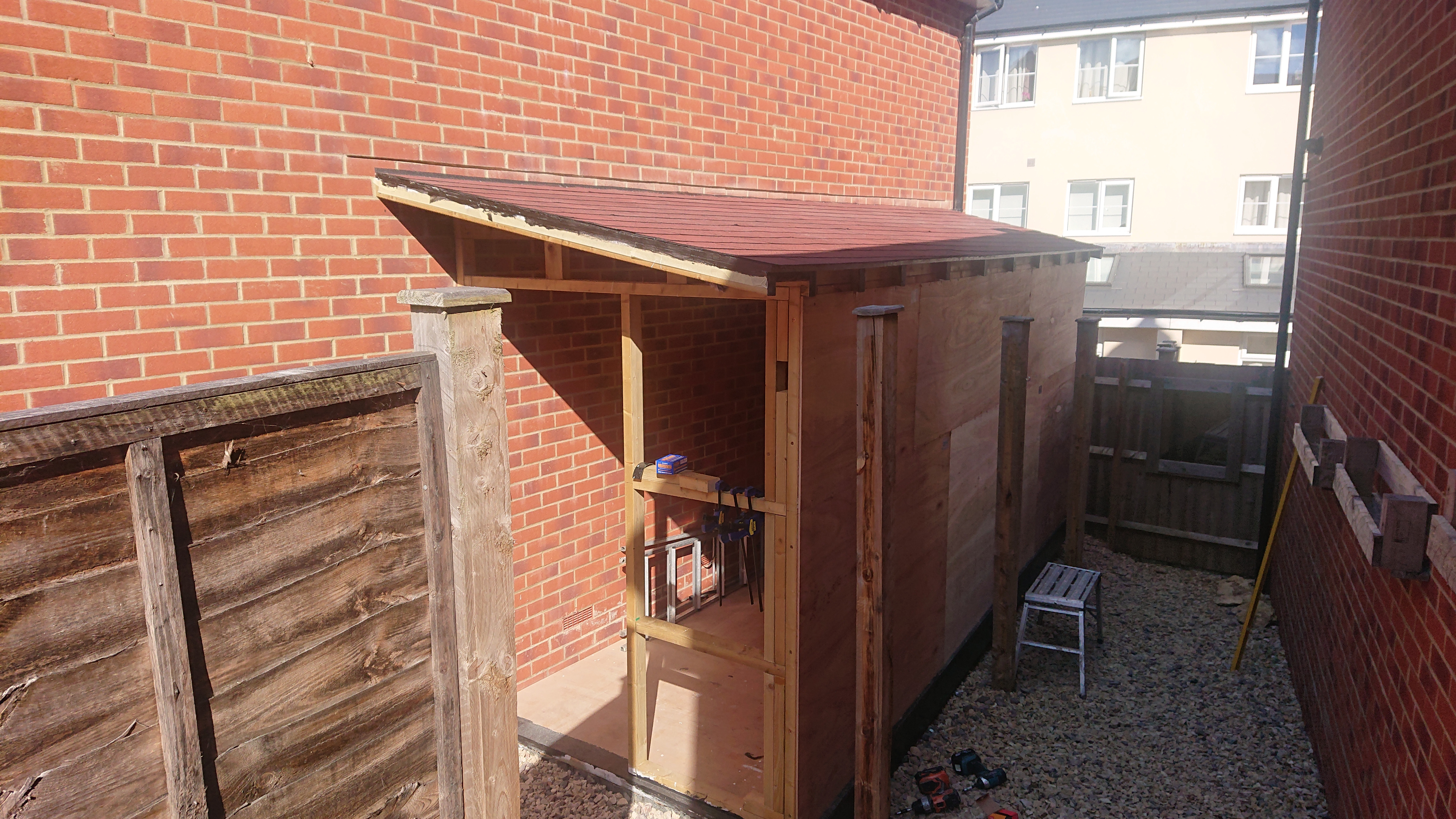

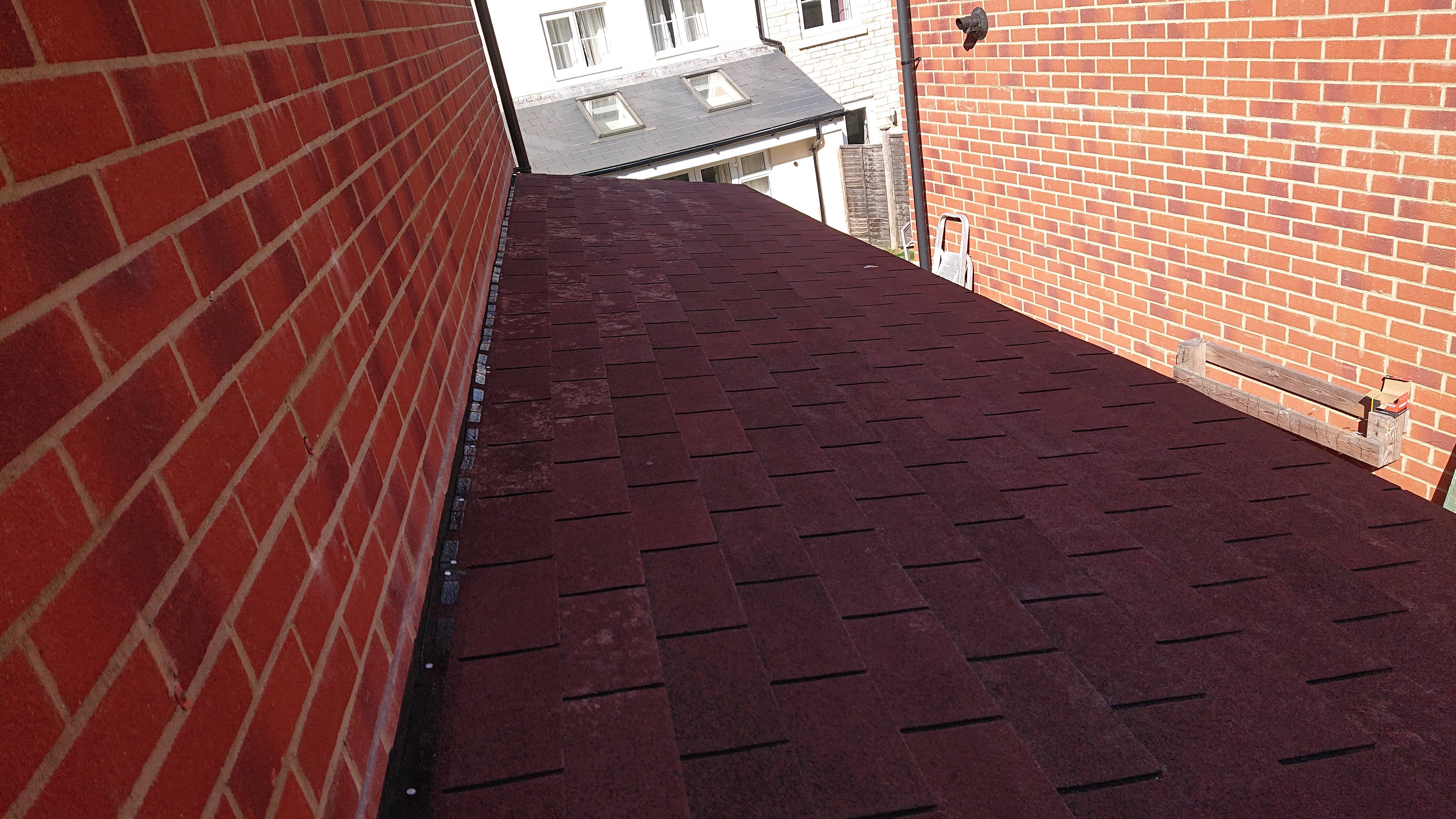

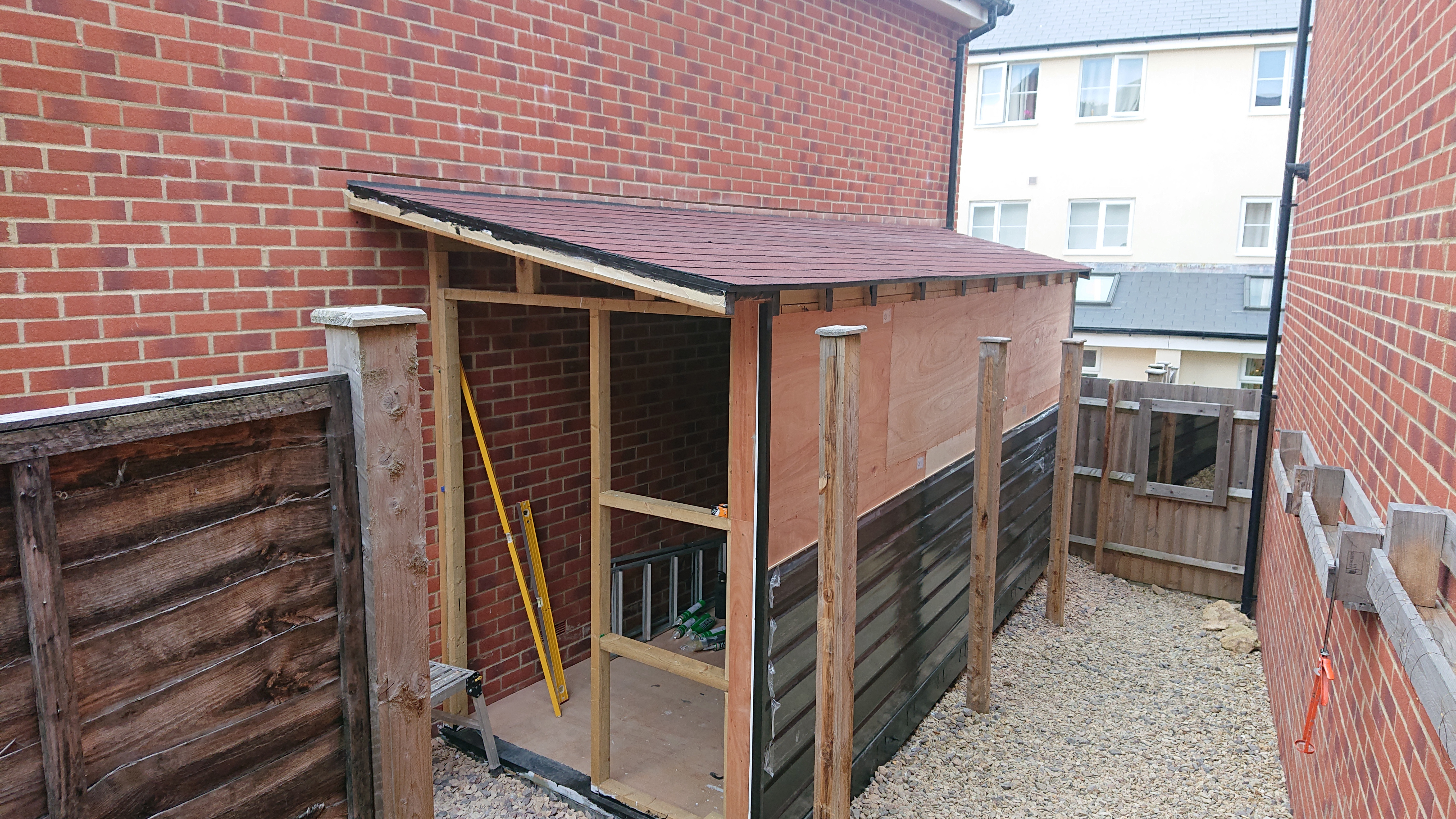

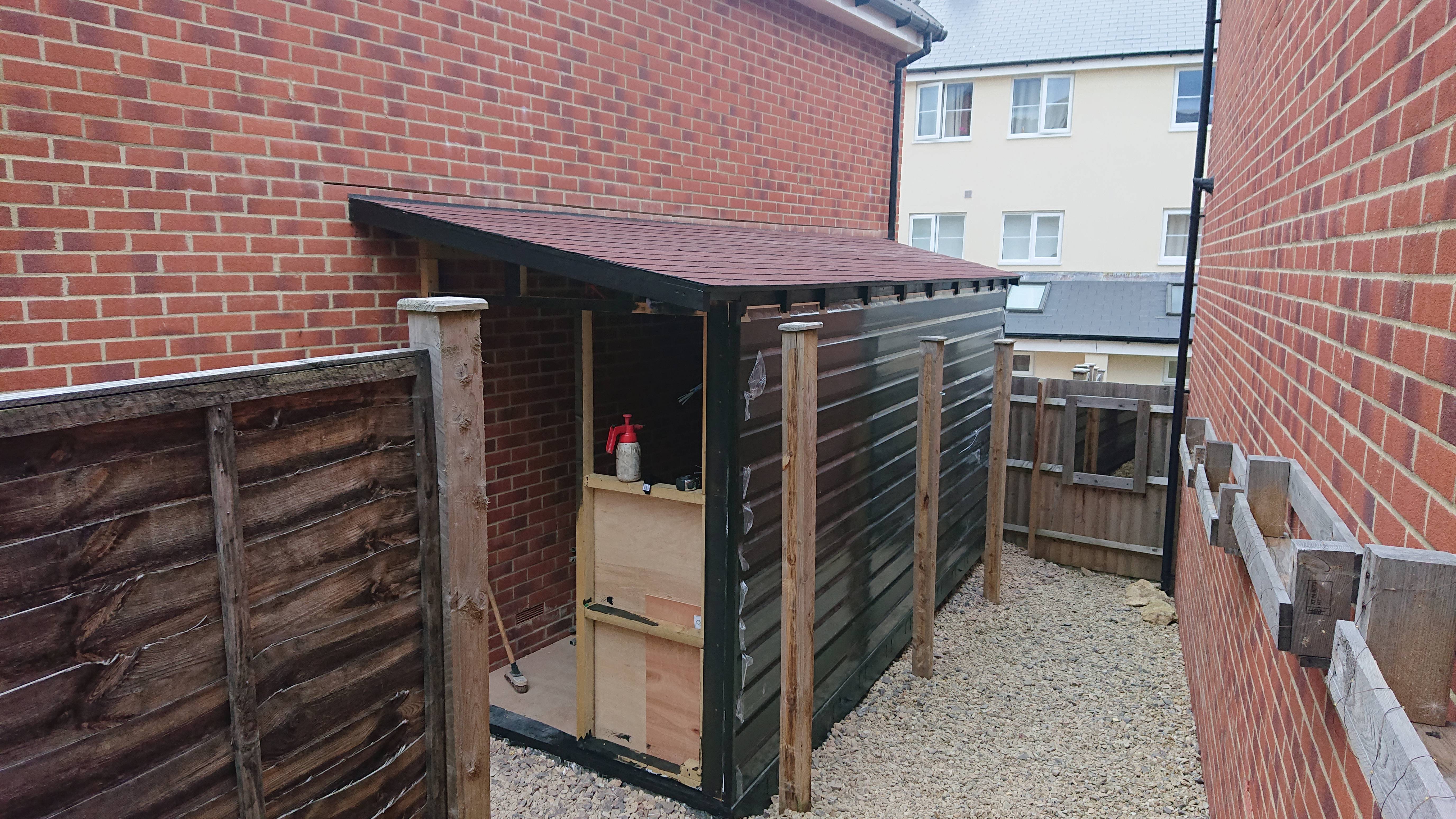

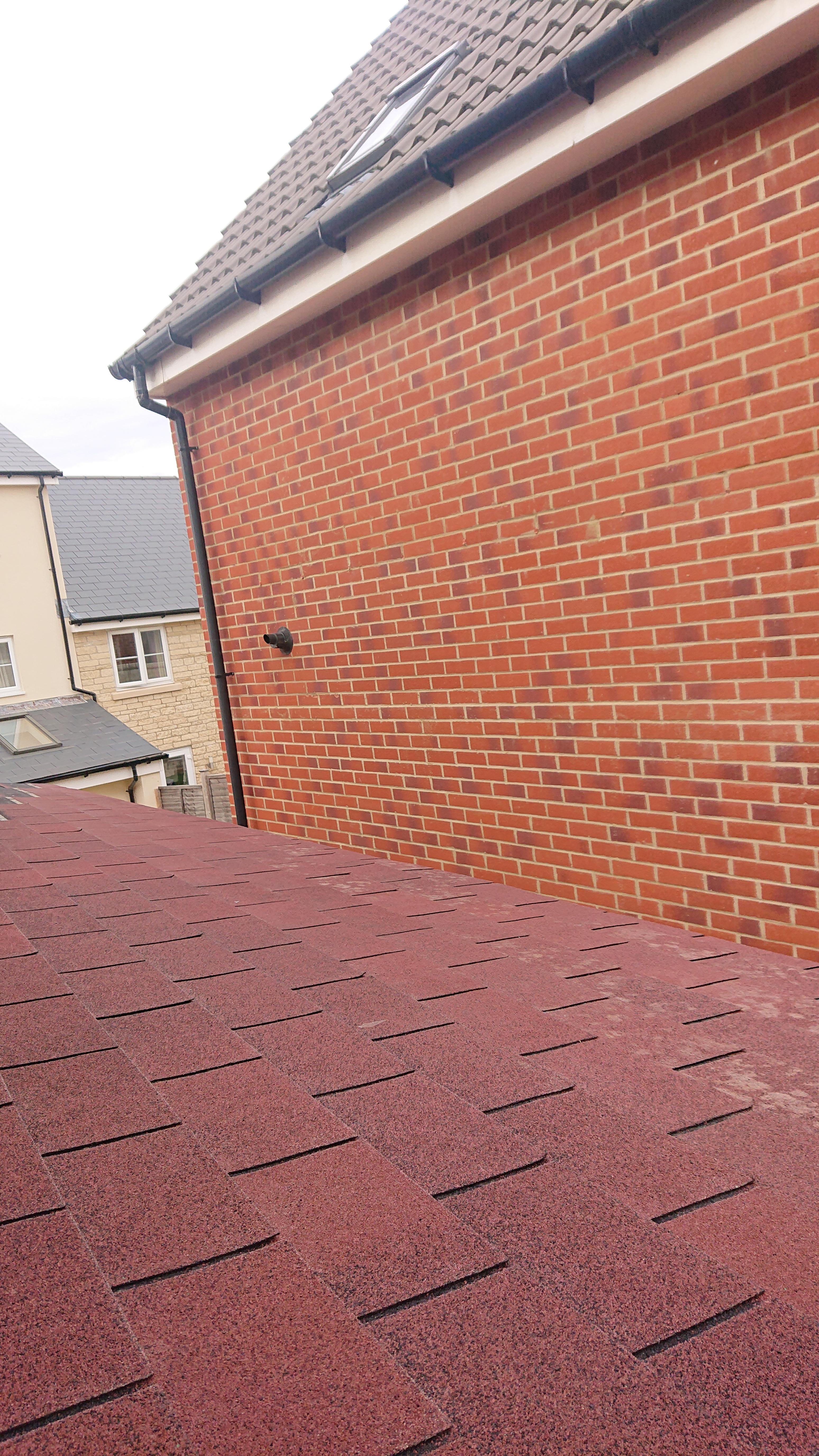

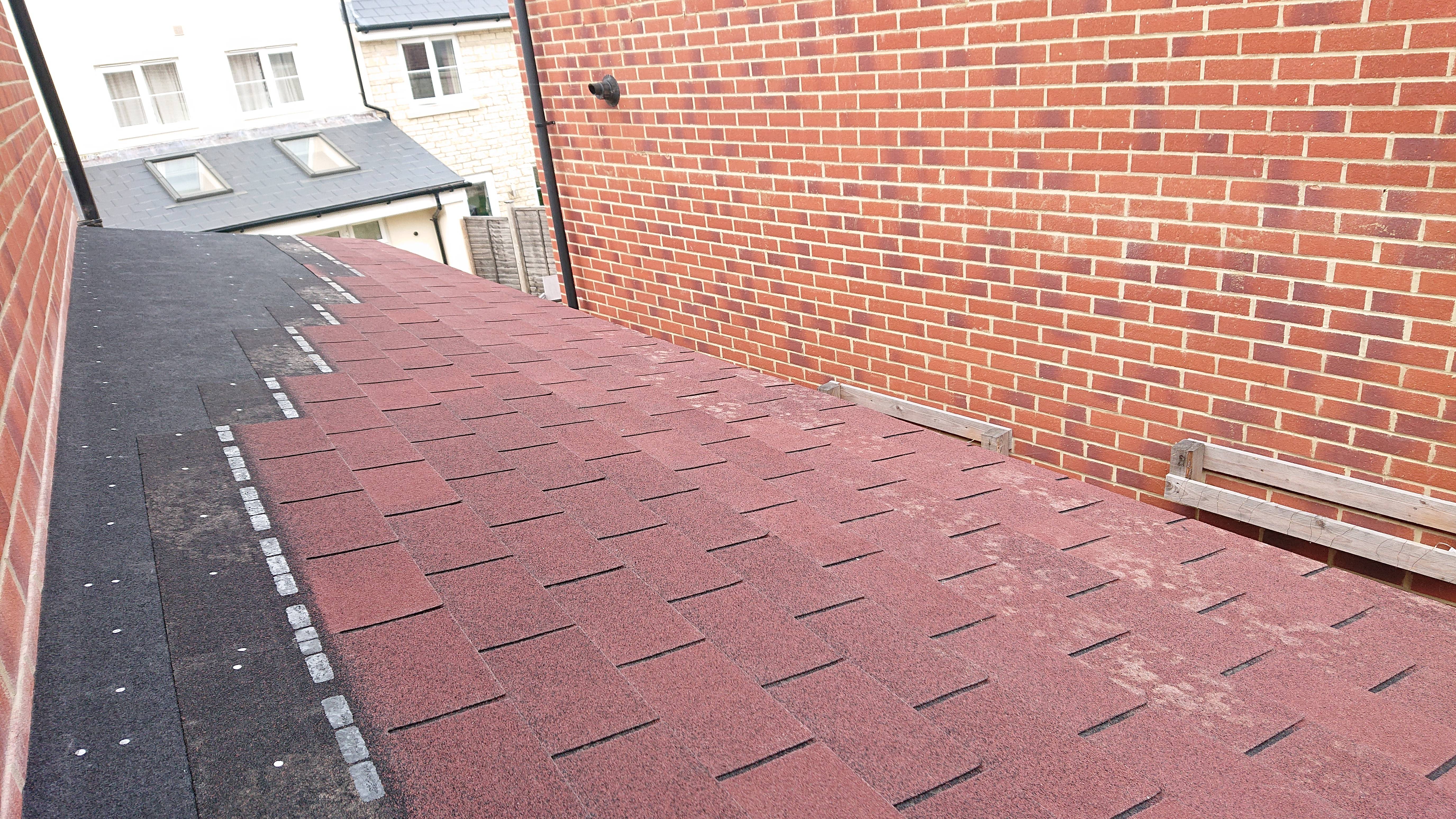

    Once the roof was fitted the project became a whole lot more straightforward. No longer strictly worried about averse weather, we could crack on with plying the walls and fitting the roof shingles.
    alt text
    alt text
    alt text
    This was total overkill, but I'm a sucker for anything red 😛

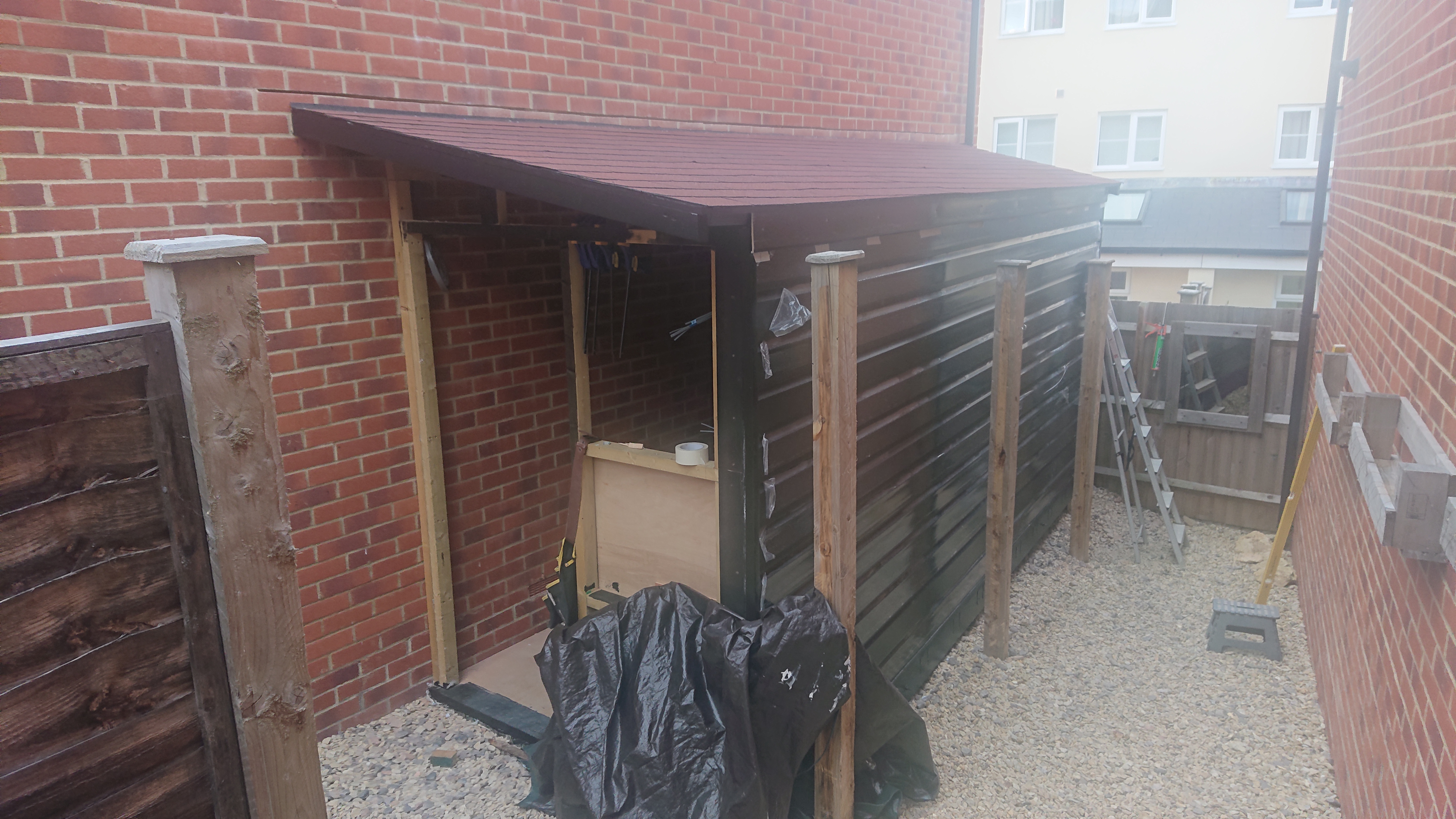

    Affixing The Walls

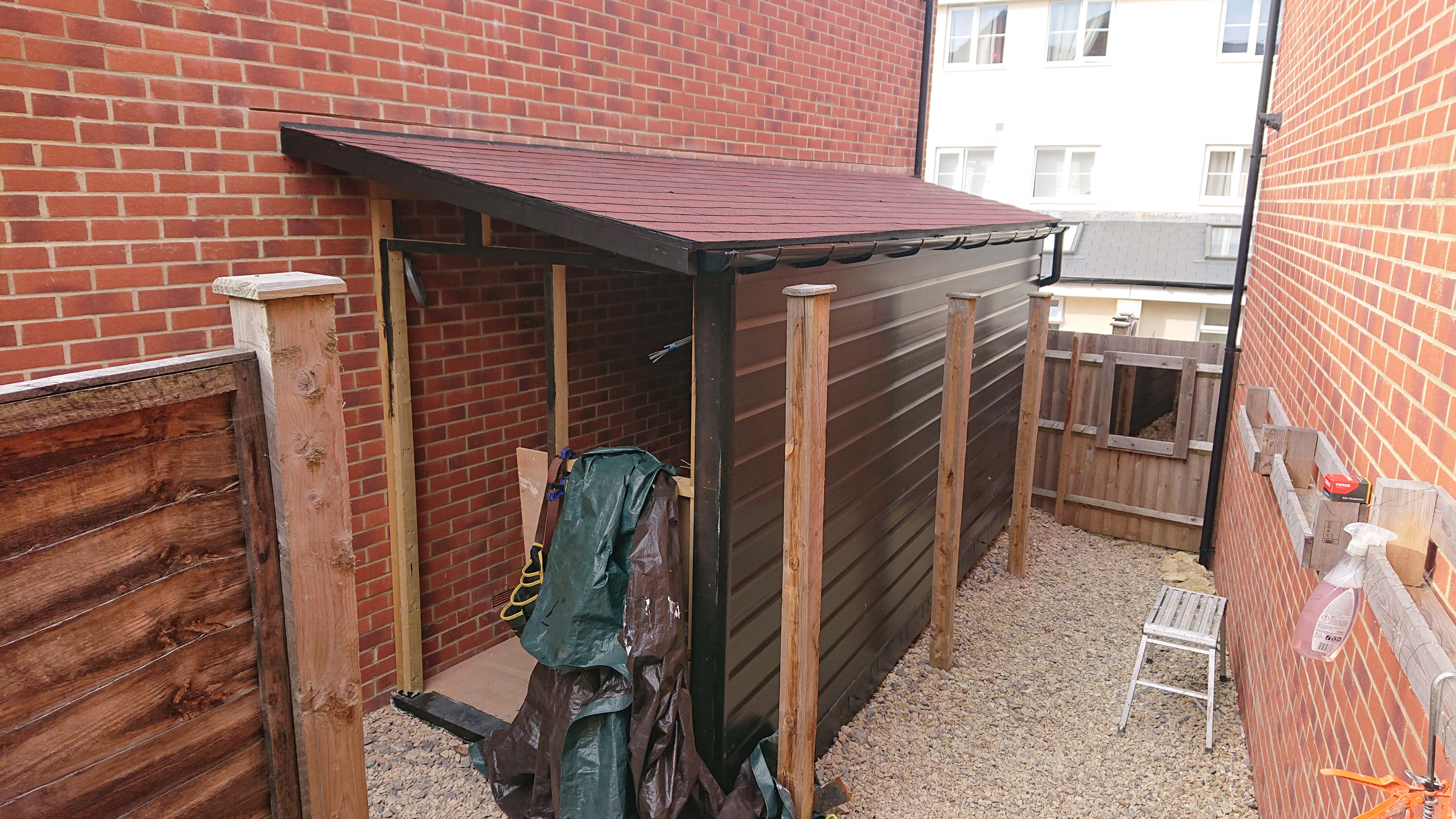

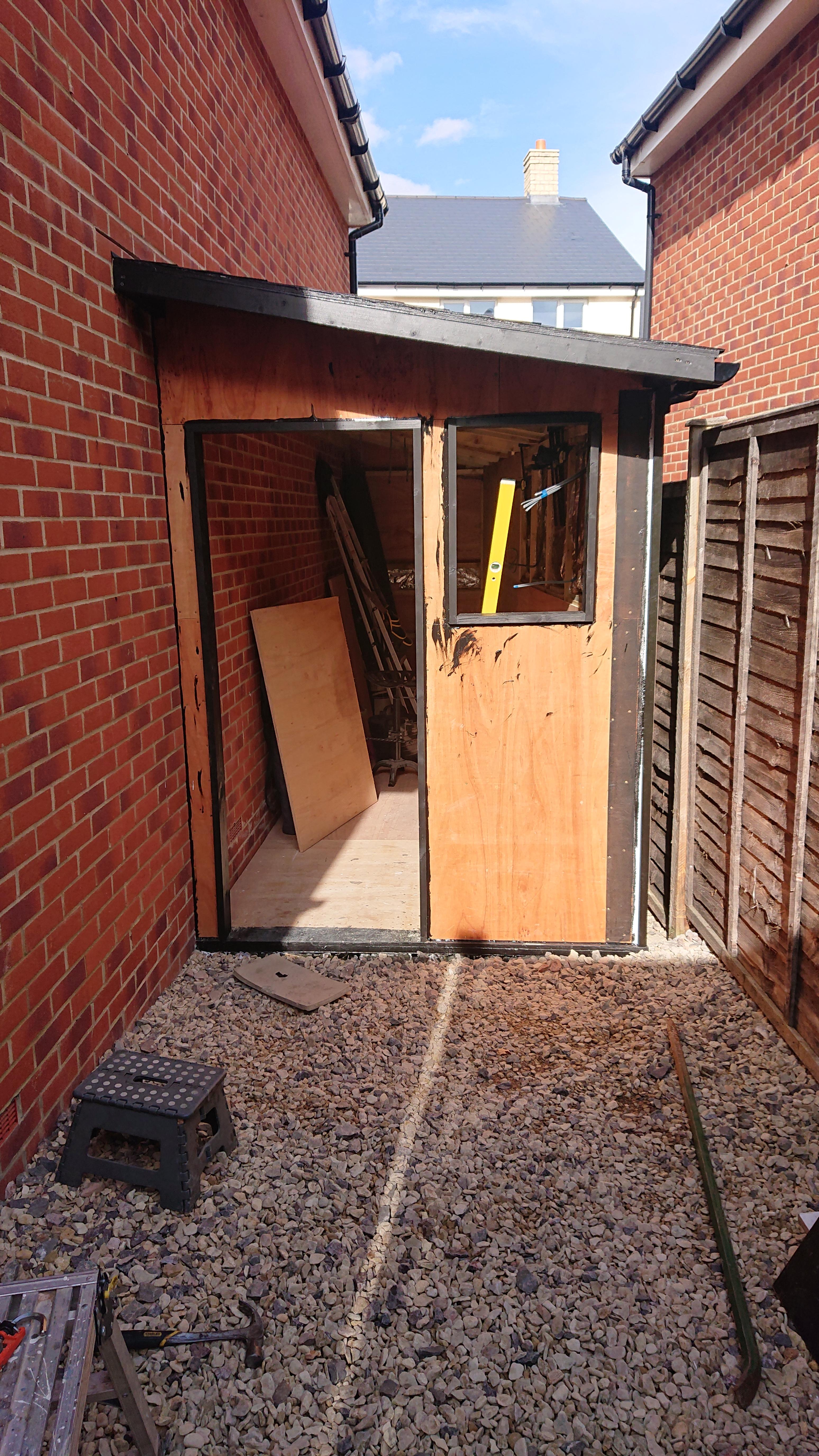

    Although this wasn't my intention at the start of the project, I thought it would look smart if I cladded the workshop. This came in to be a very expensive option, especially considering I can't even see most of it since it's obscured by the neighbours fence, but I felt it would give a more professional look to the build.

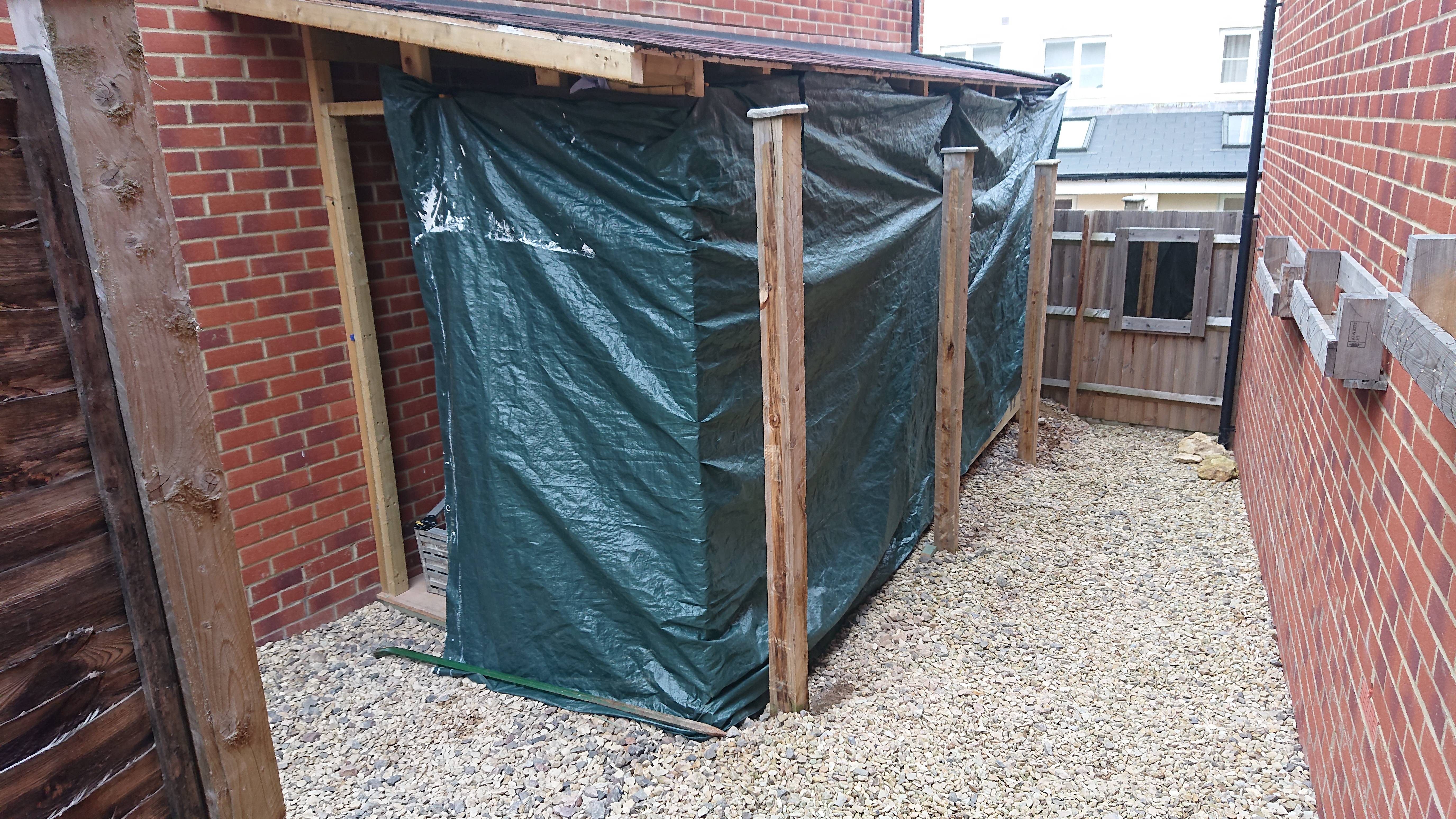

    After taking the neighbours fence down temporarily, I was able to fit full length UPVC Woodgrain cladding to the 9mm ply of the walls.
    alt text
    alt text
    With the neighbours fence down, it became very easy to wrap and unwrap the workshop to protect it from the elements. It also meant that the UPVC cladding could go up as once complete piece instead of having to cut it.
    alt text
    Making the walls for this was an absolute breeze thanks to prior planning and having the right tools. We managed to get all the walls up within the weekend and the next weekend we could mess about with the cladding.
    alt text
    alt text

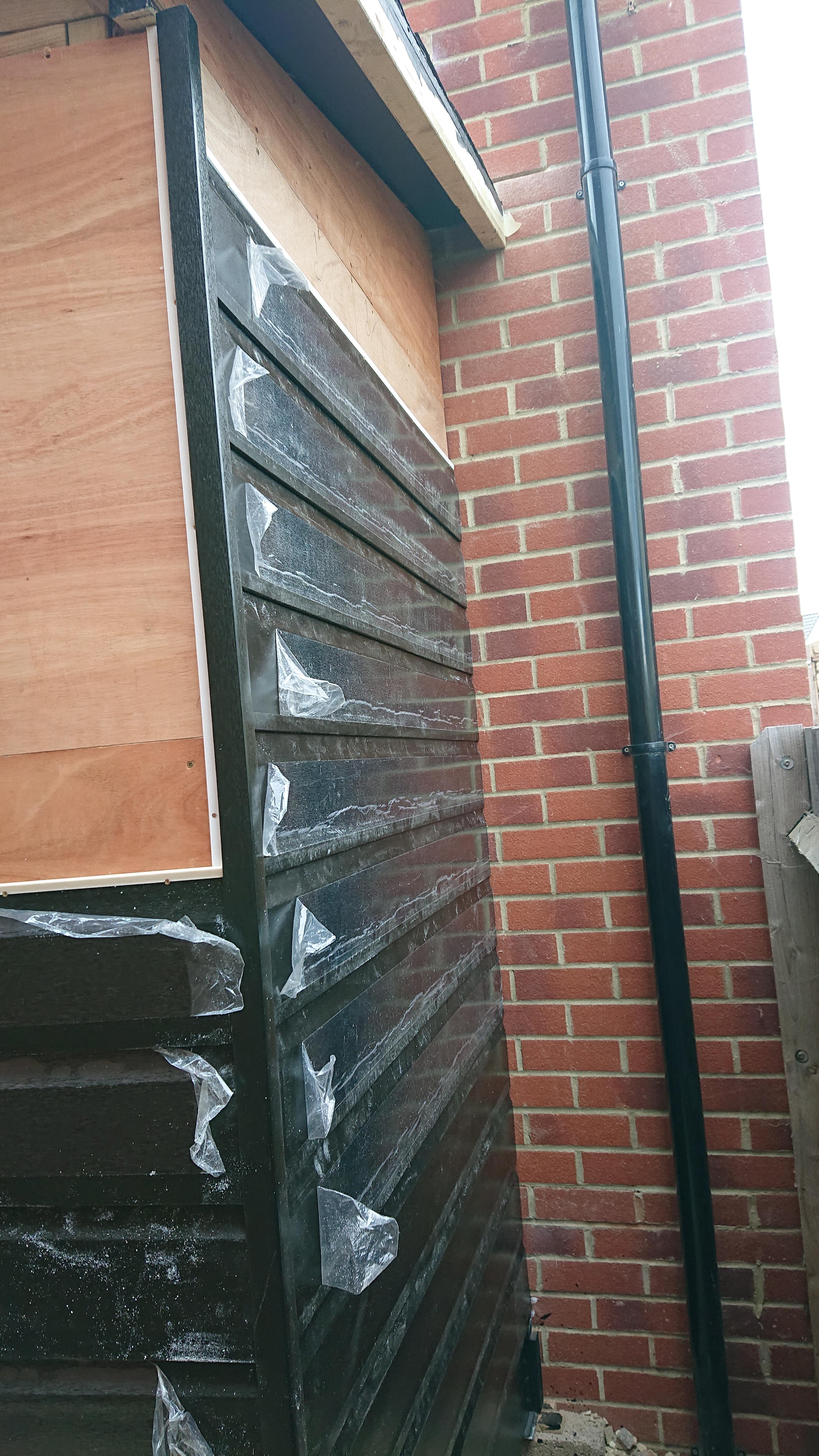

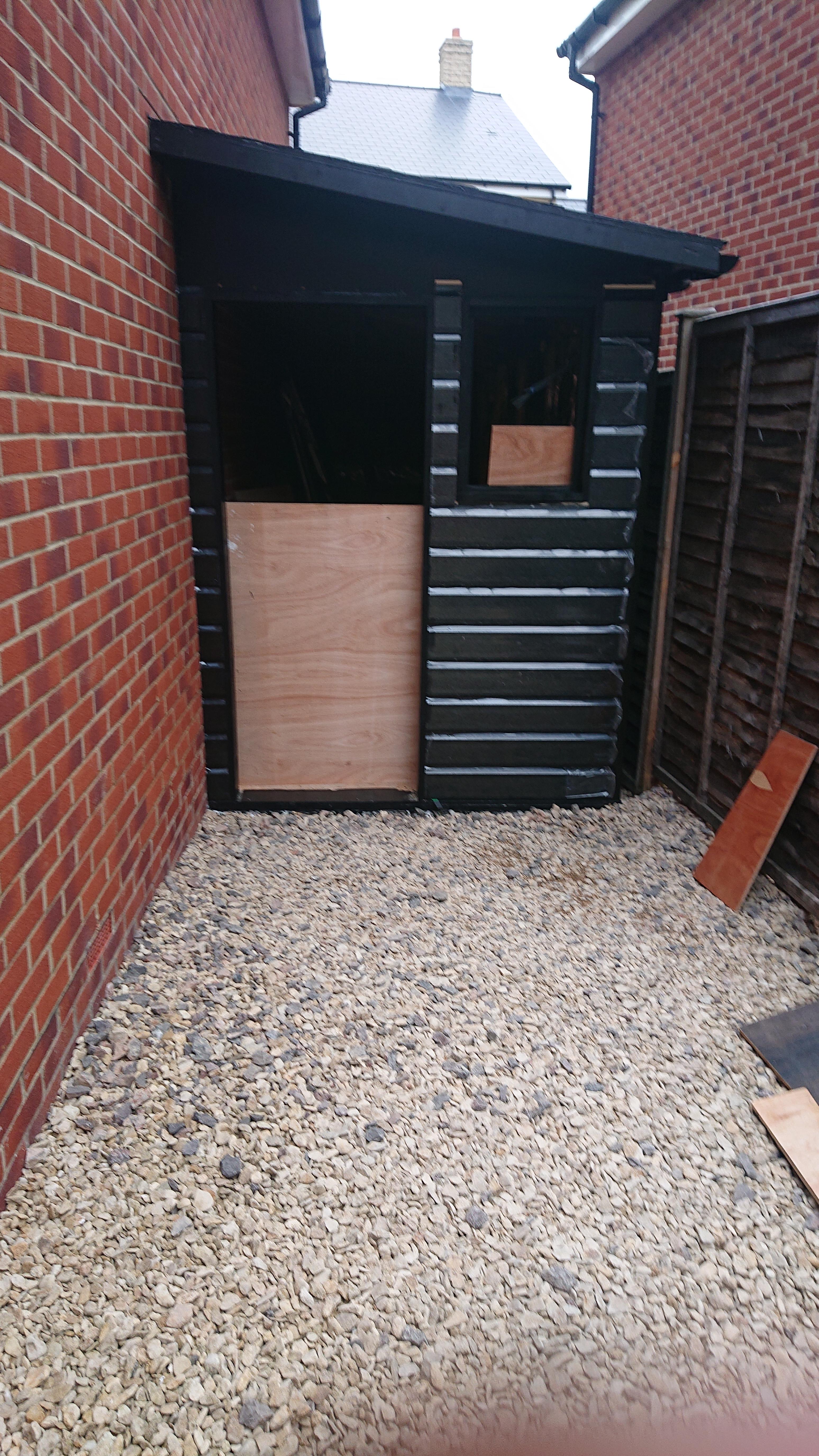

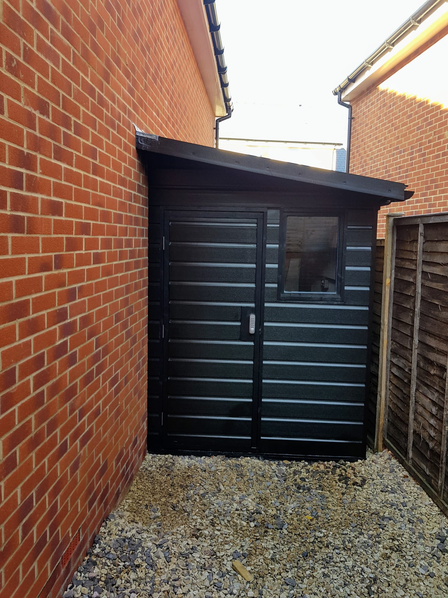

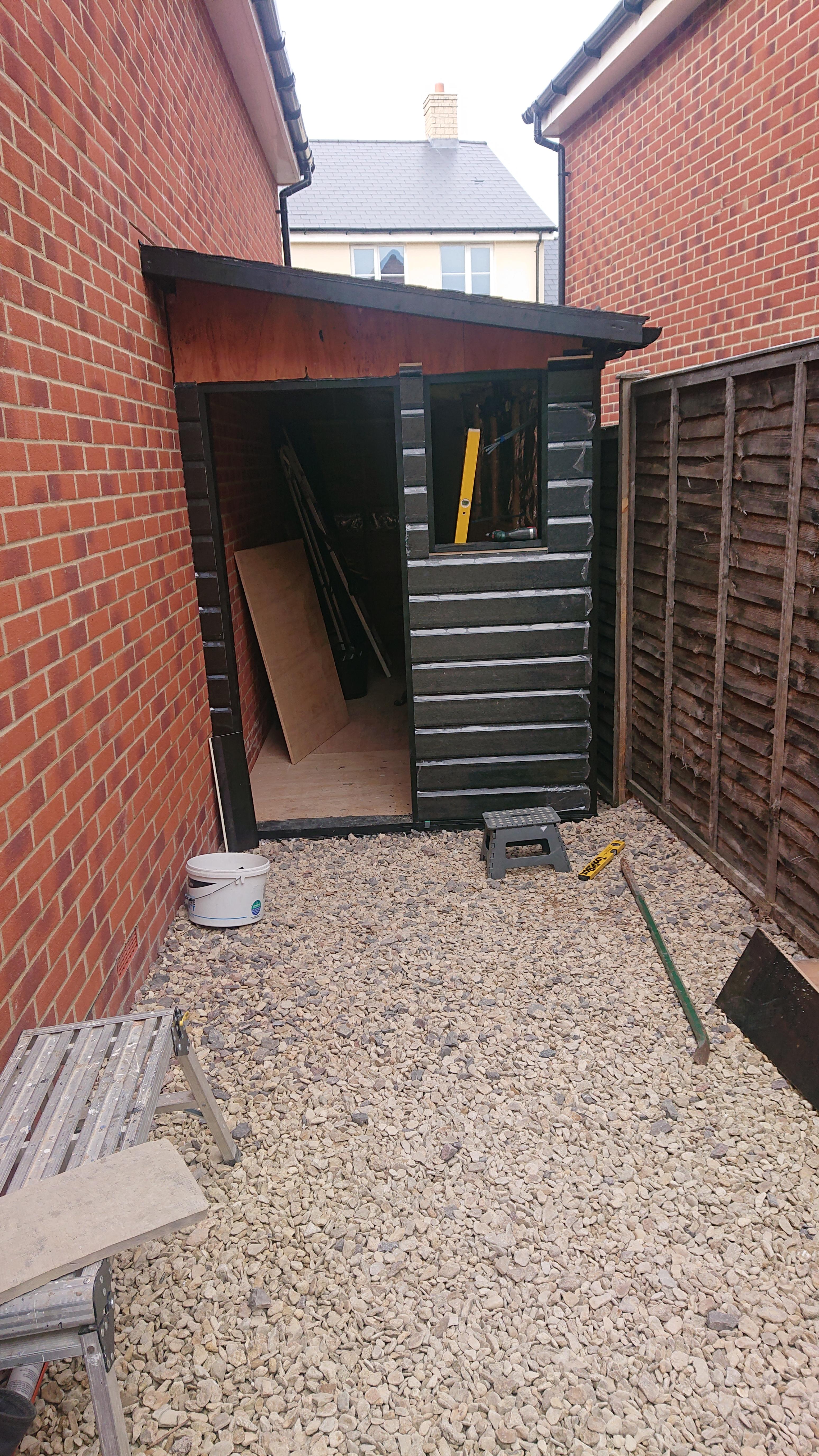

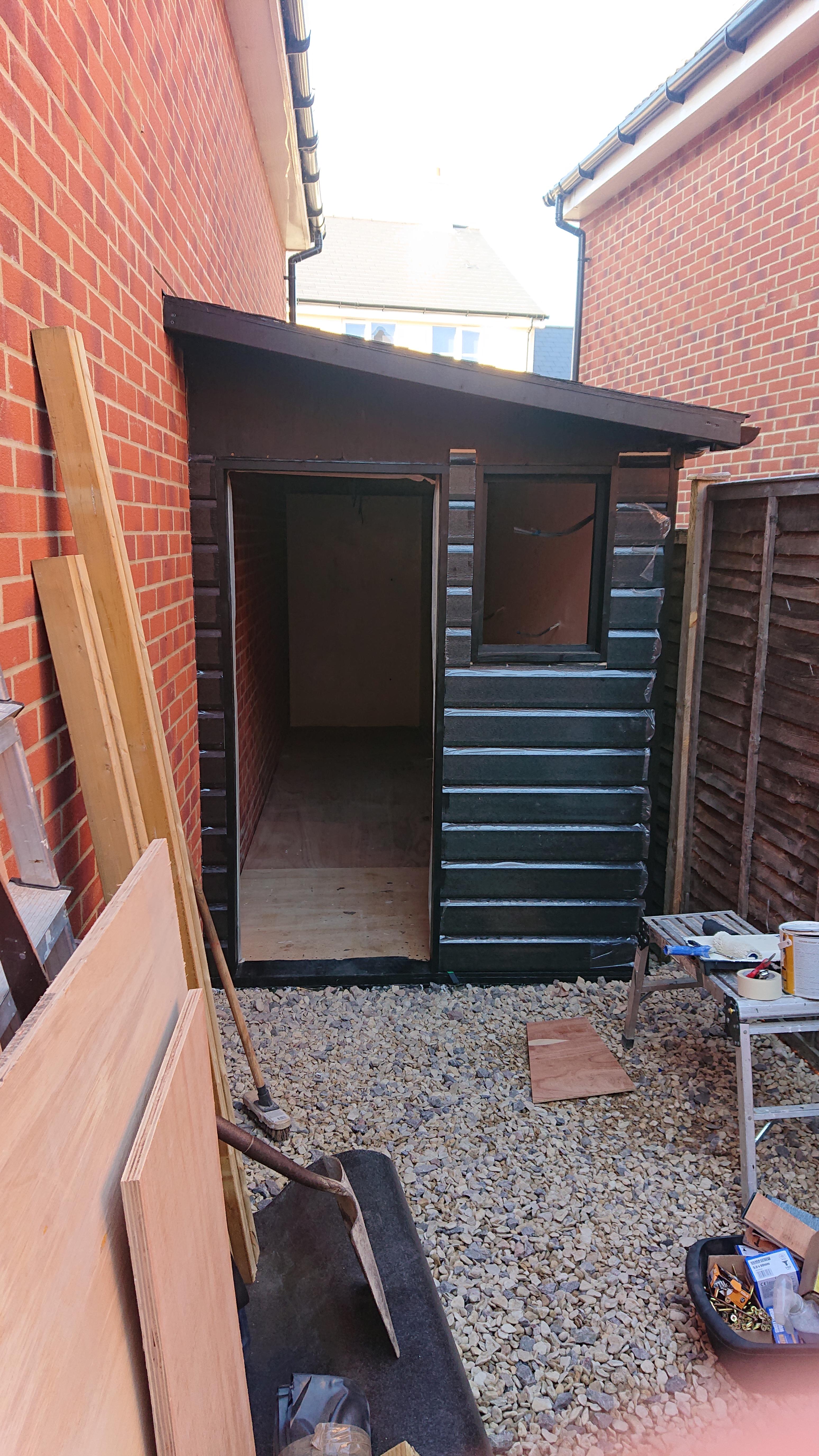

    It may not be to everyone's taste, but i went for black woodgrain UPVC cladding as this matches my front door and garage door. I think it looks the dogs!
    alt text

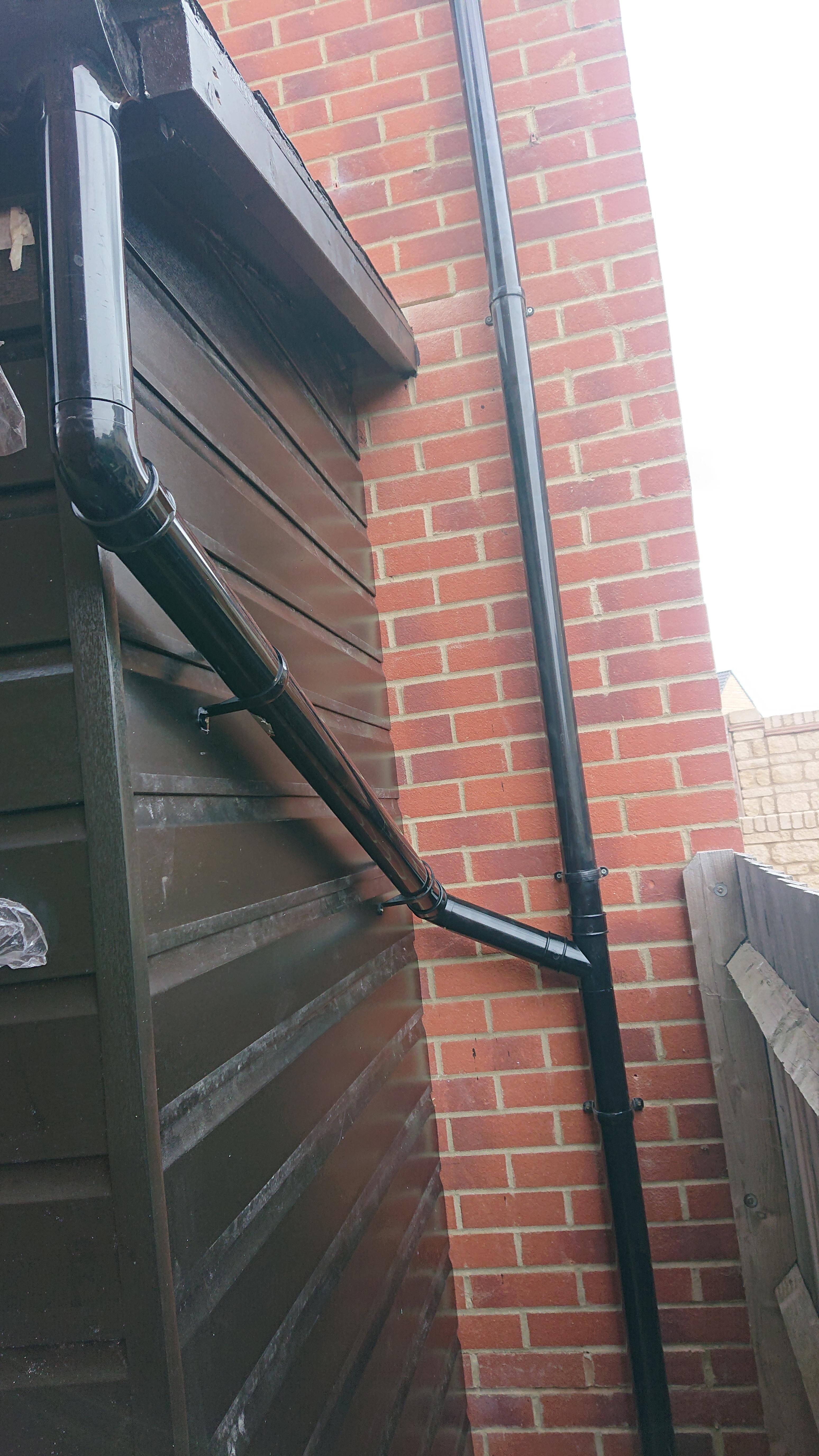

    Once the cladding was on we could install the guttering, plumbing it back into the waste water from the house.
    alt text
    alt text
    Then that was that, neighbours fence back up and we can crack on with the interior.

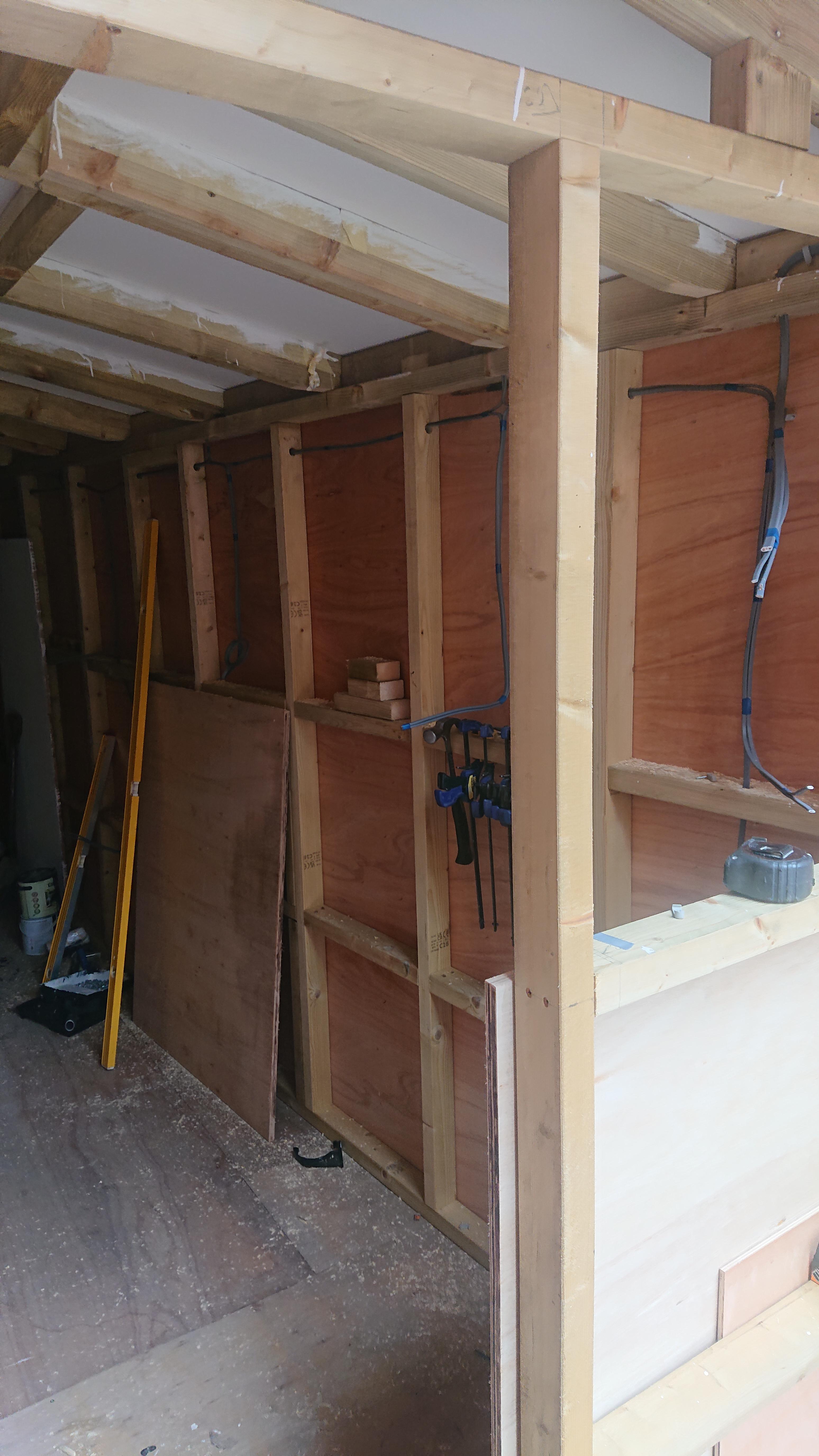

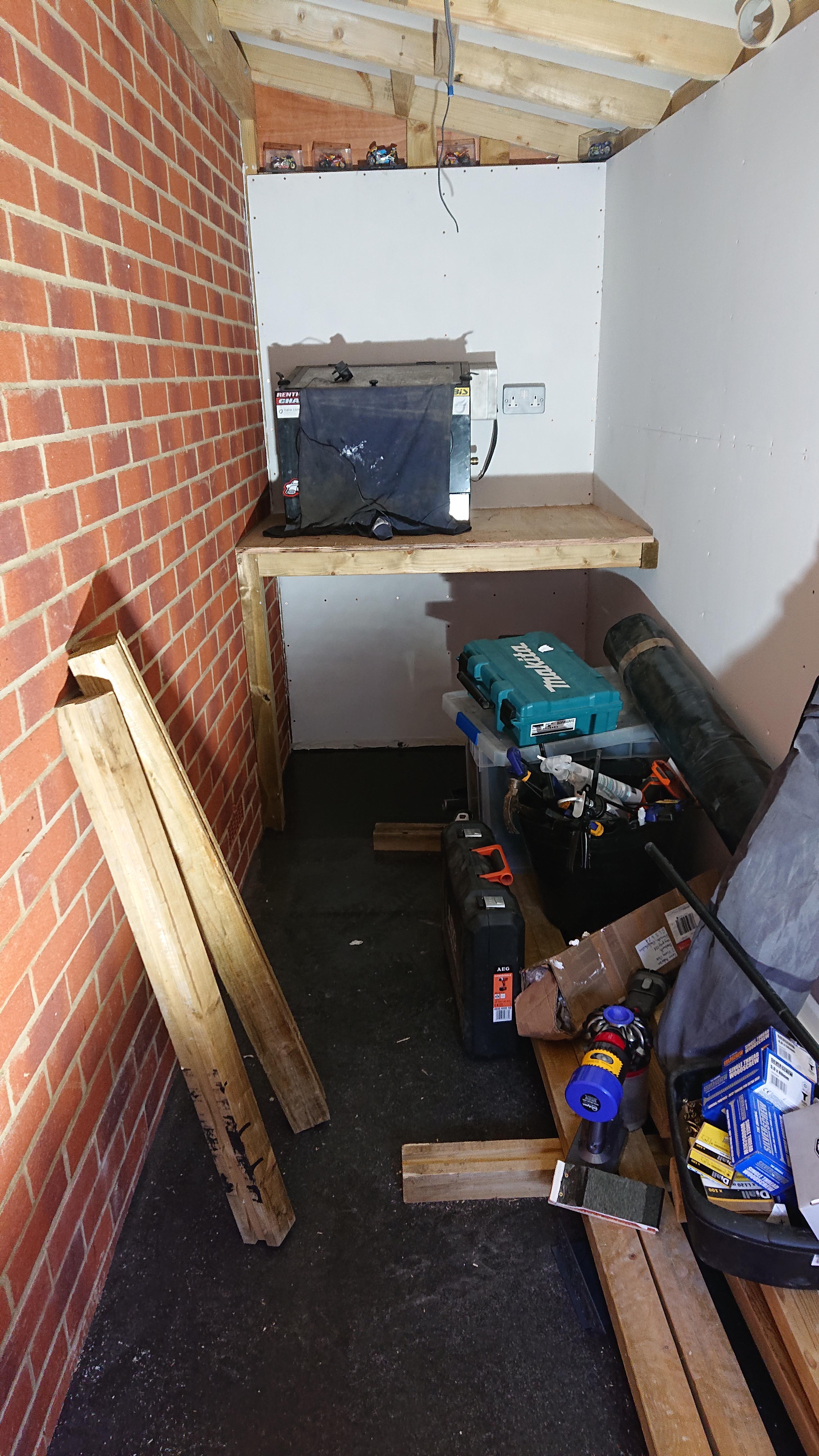

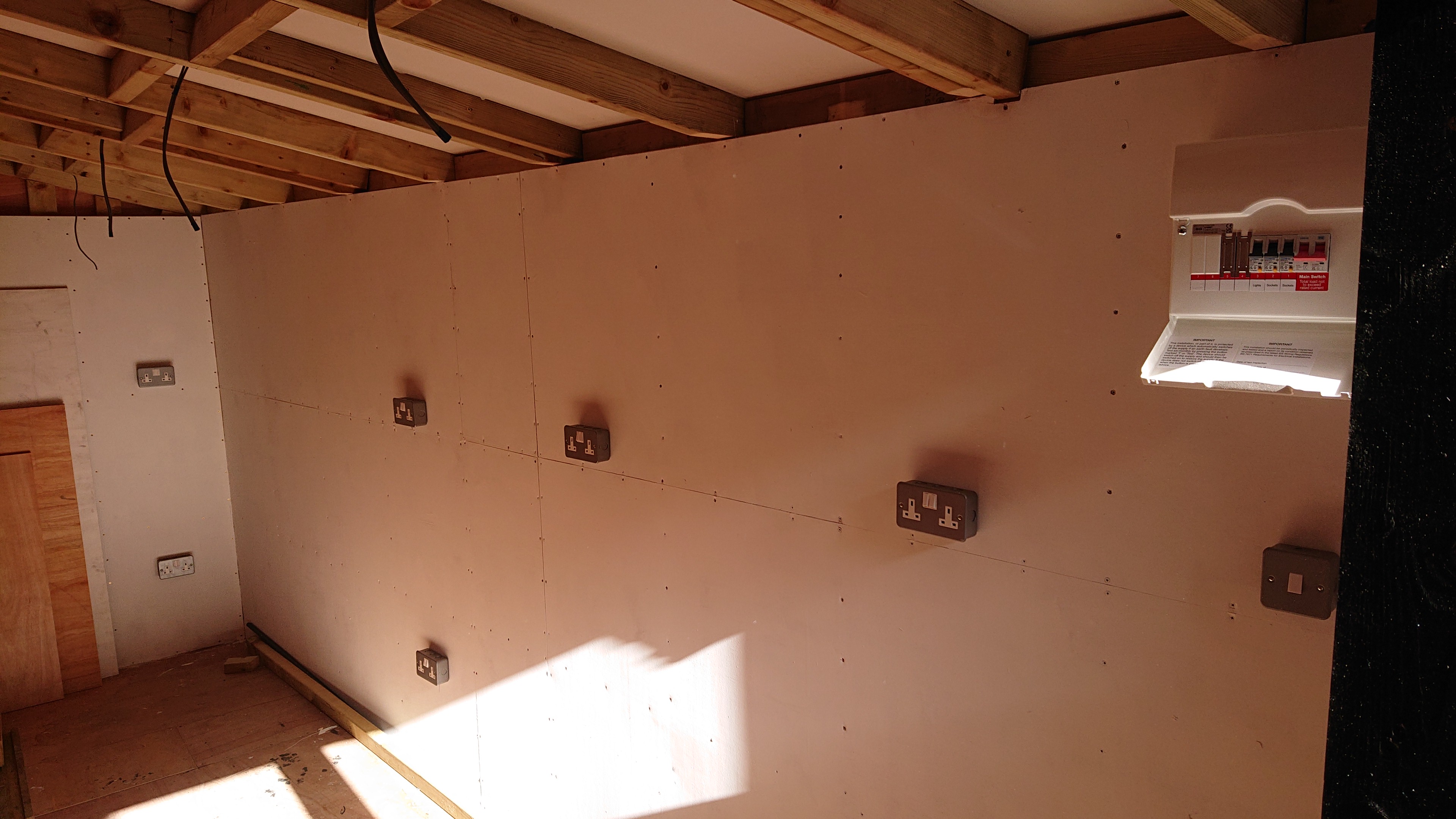

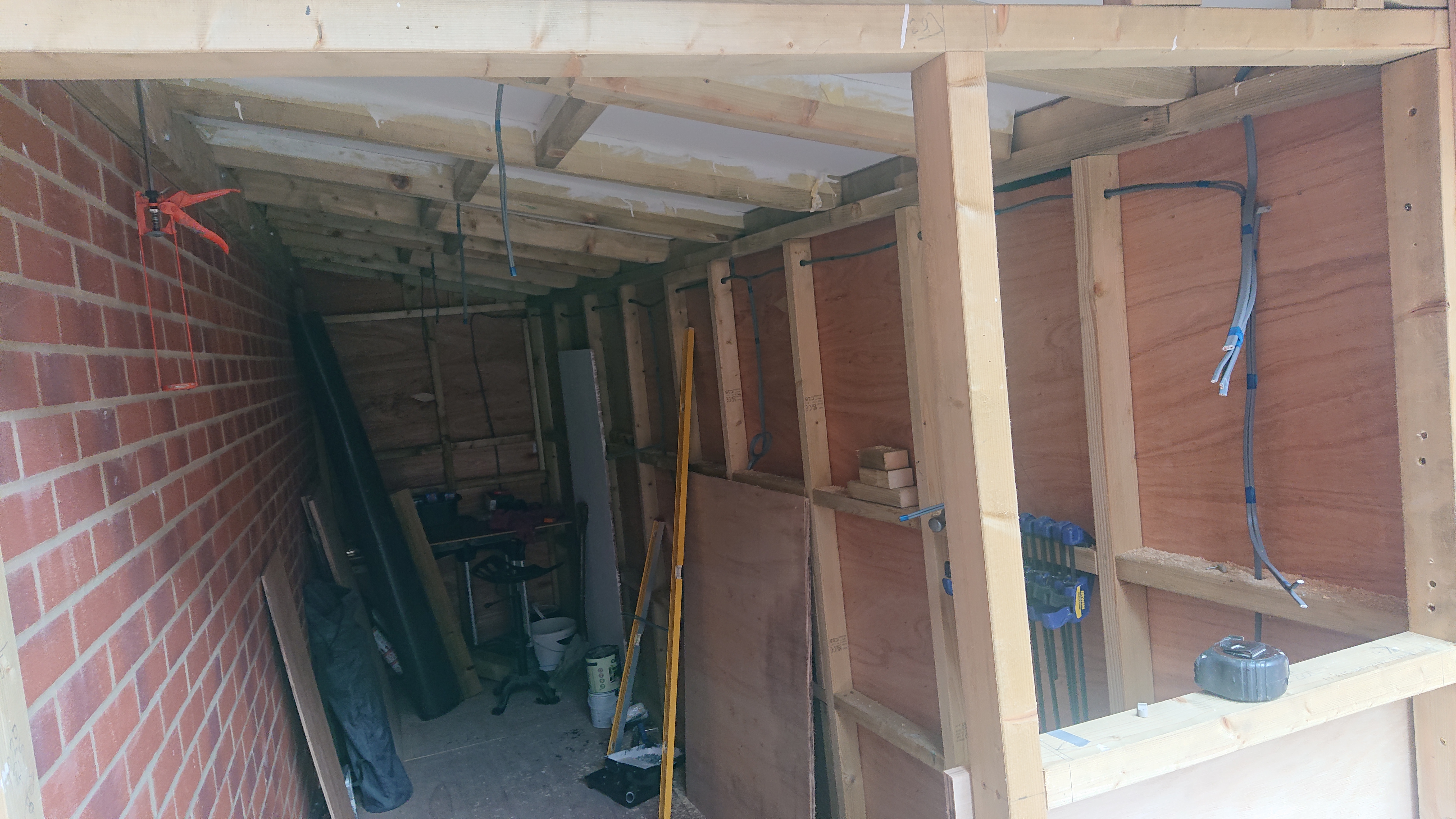

    It was important for me that the power to the workshop could be isolated independently from the house. I didn't want to be able to accidentally leave the soldering iron on and cause a fire. I also decided early on that I wanted all the wiring hidden from view so it was important that we cracked on with the wiring. Thanks to my big bro for giving me a hand with with this, he's done a pucker job and I'm chuffed with how it's come together!
    alt text
    alt text
    alt text
    We've decided on 4 2" LED batons to be affixed to the ceiling, giving more than enough light.
    alt text
    Armoured cable from the house and into the bottom of the workshop.

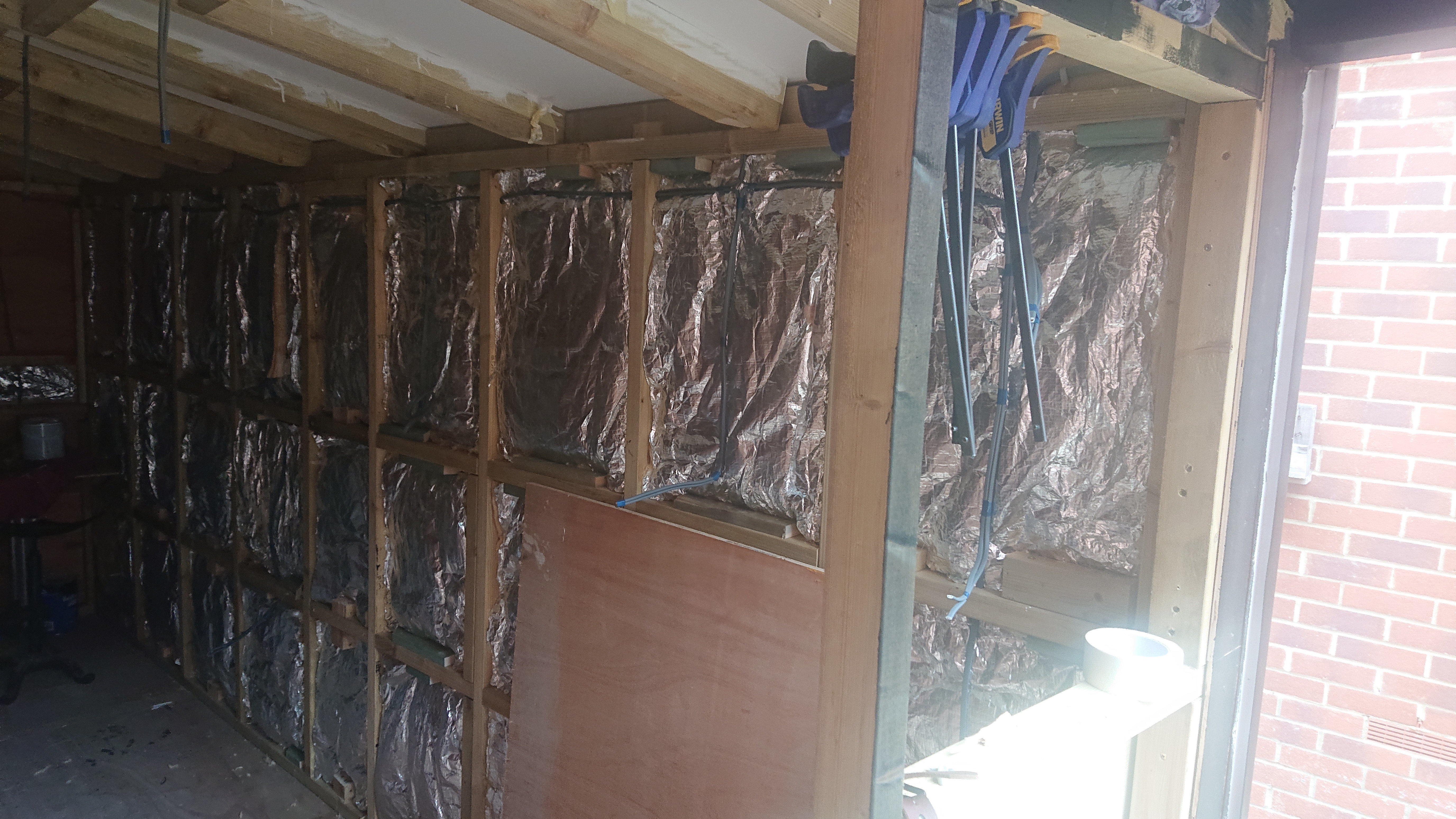

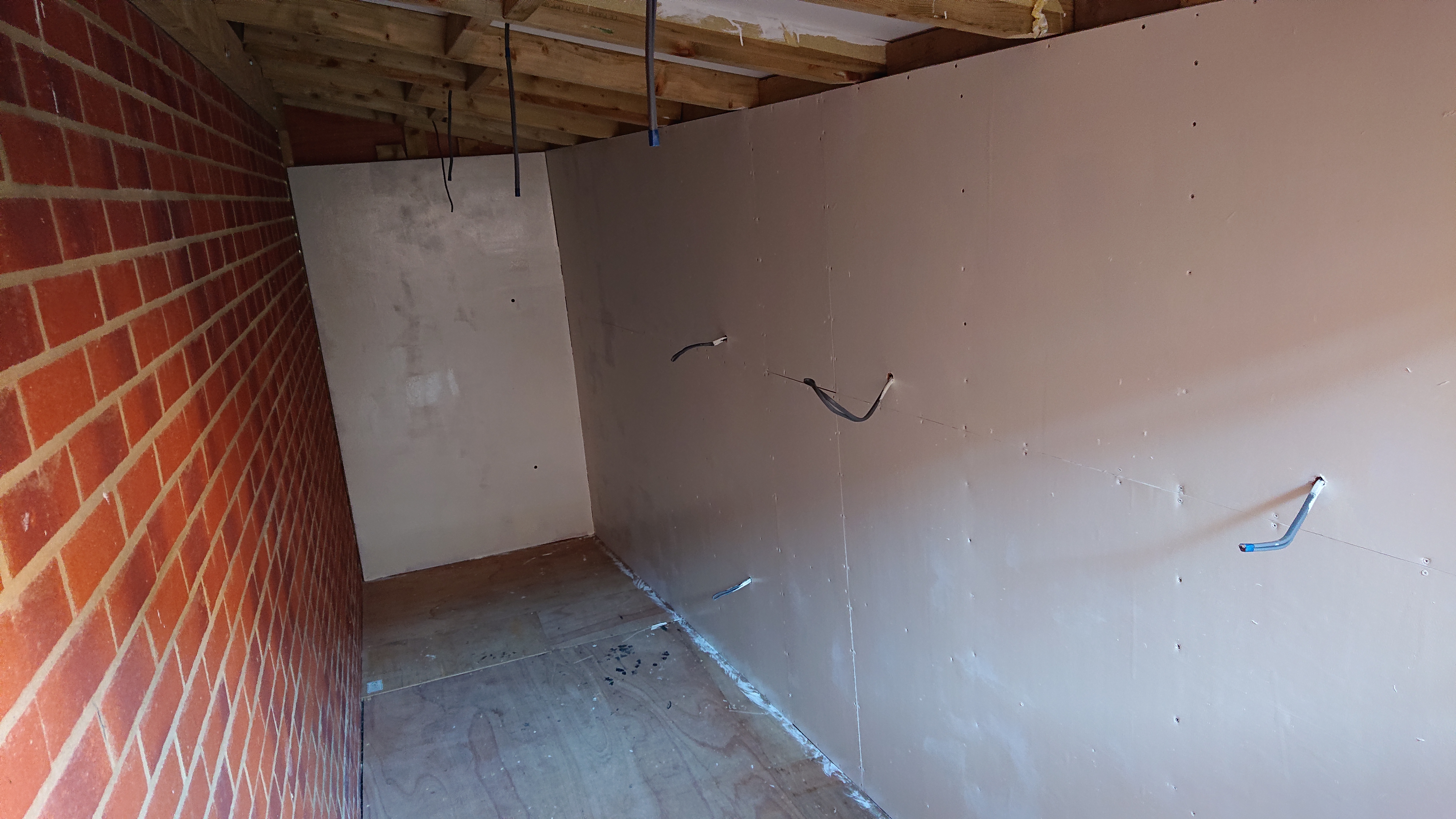

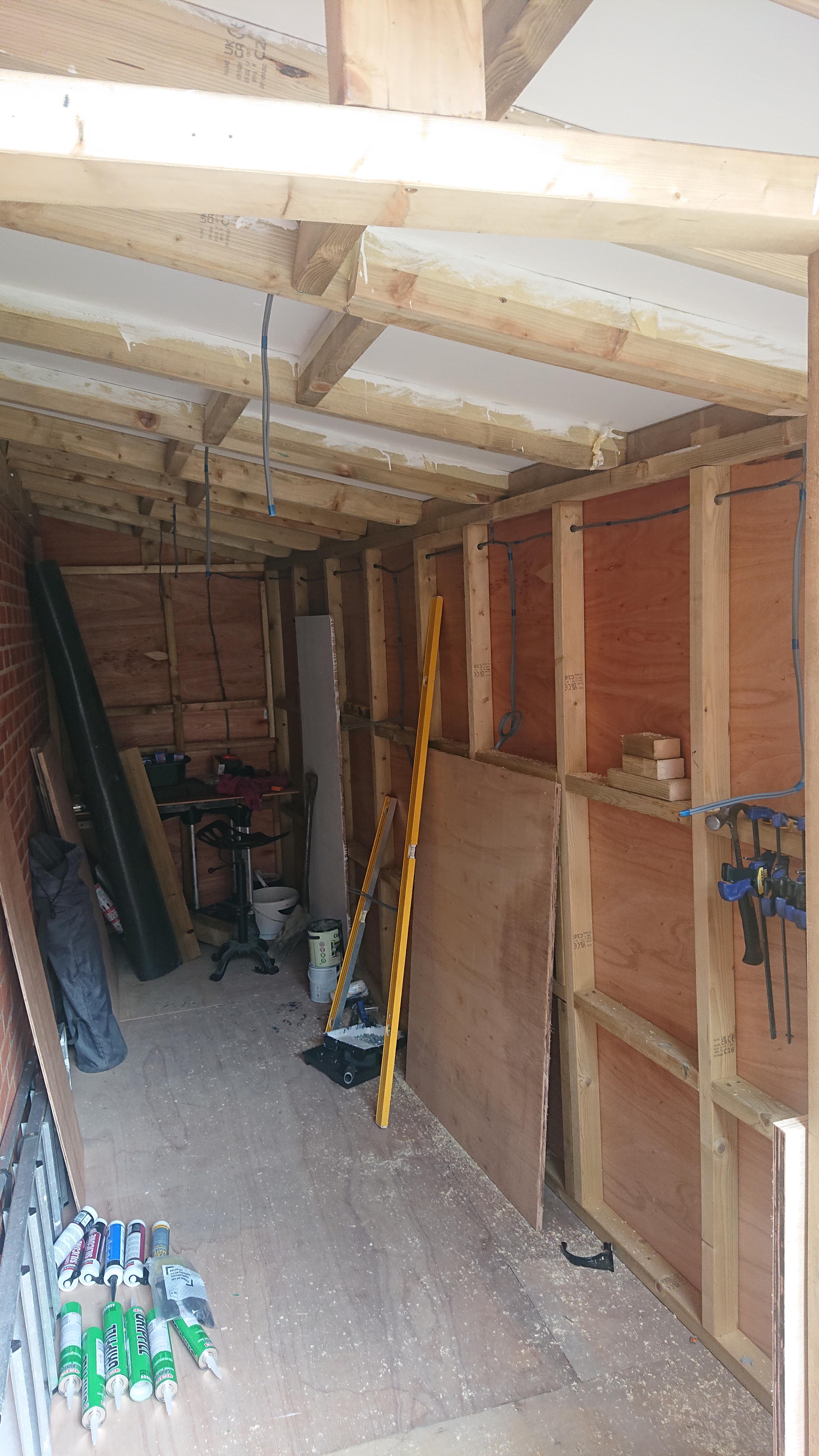

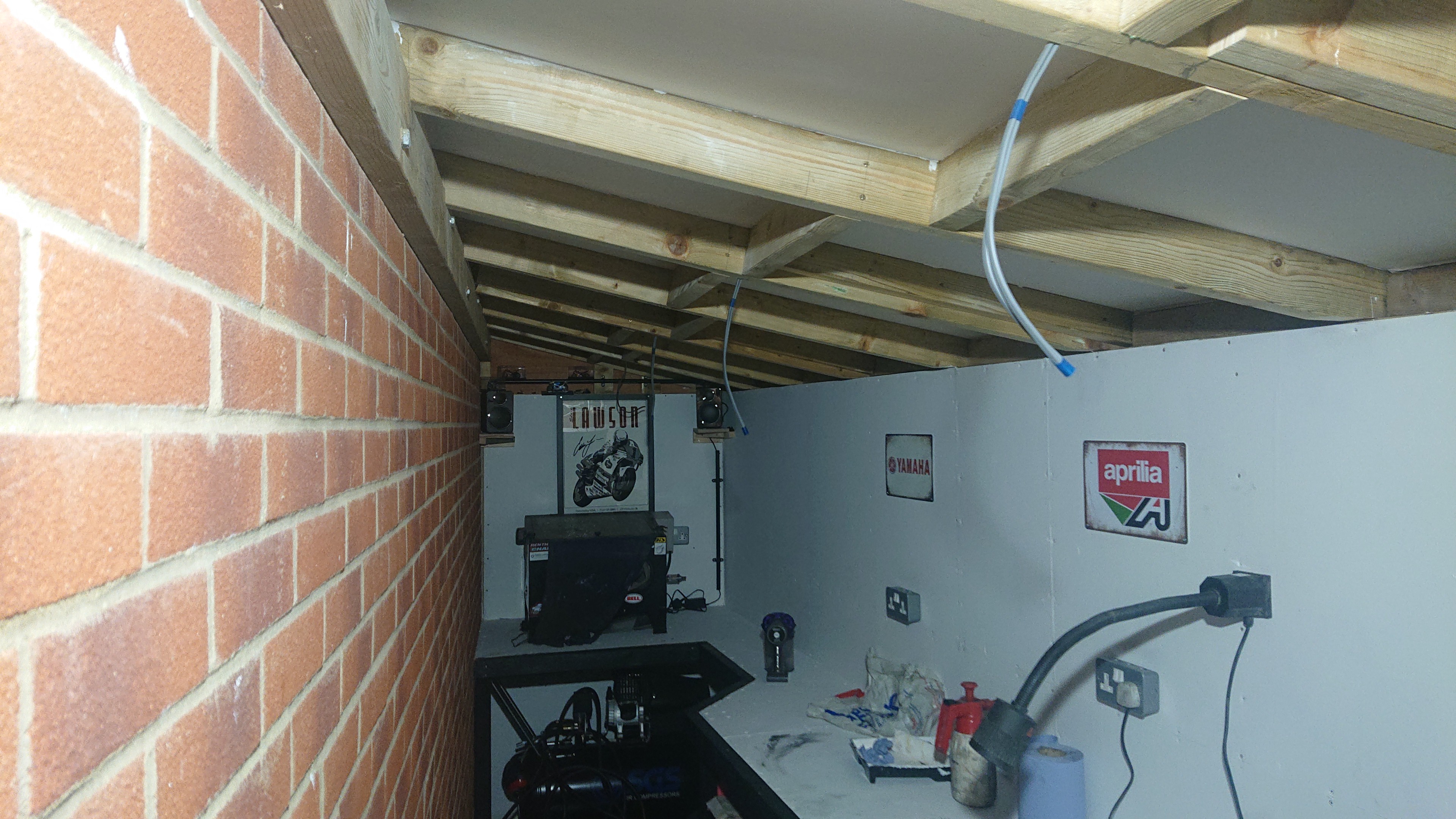

    Once the first fix was done I could plaster all of the insulation in and make the inner walls.

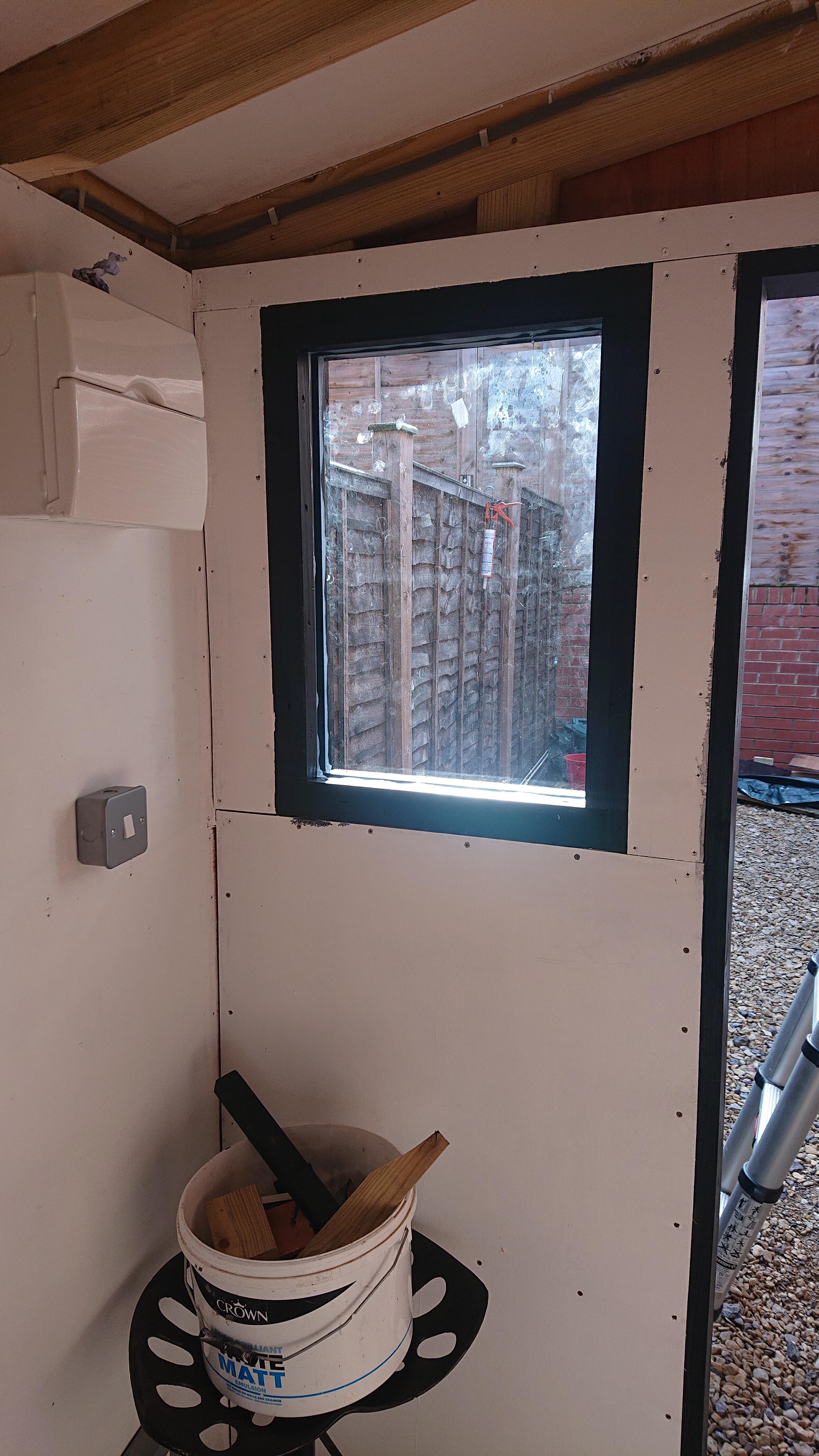

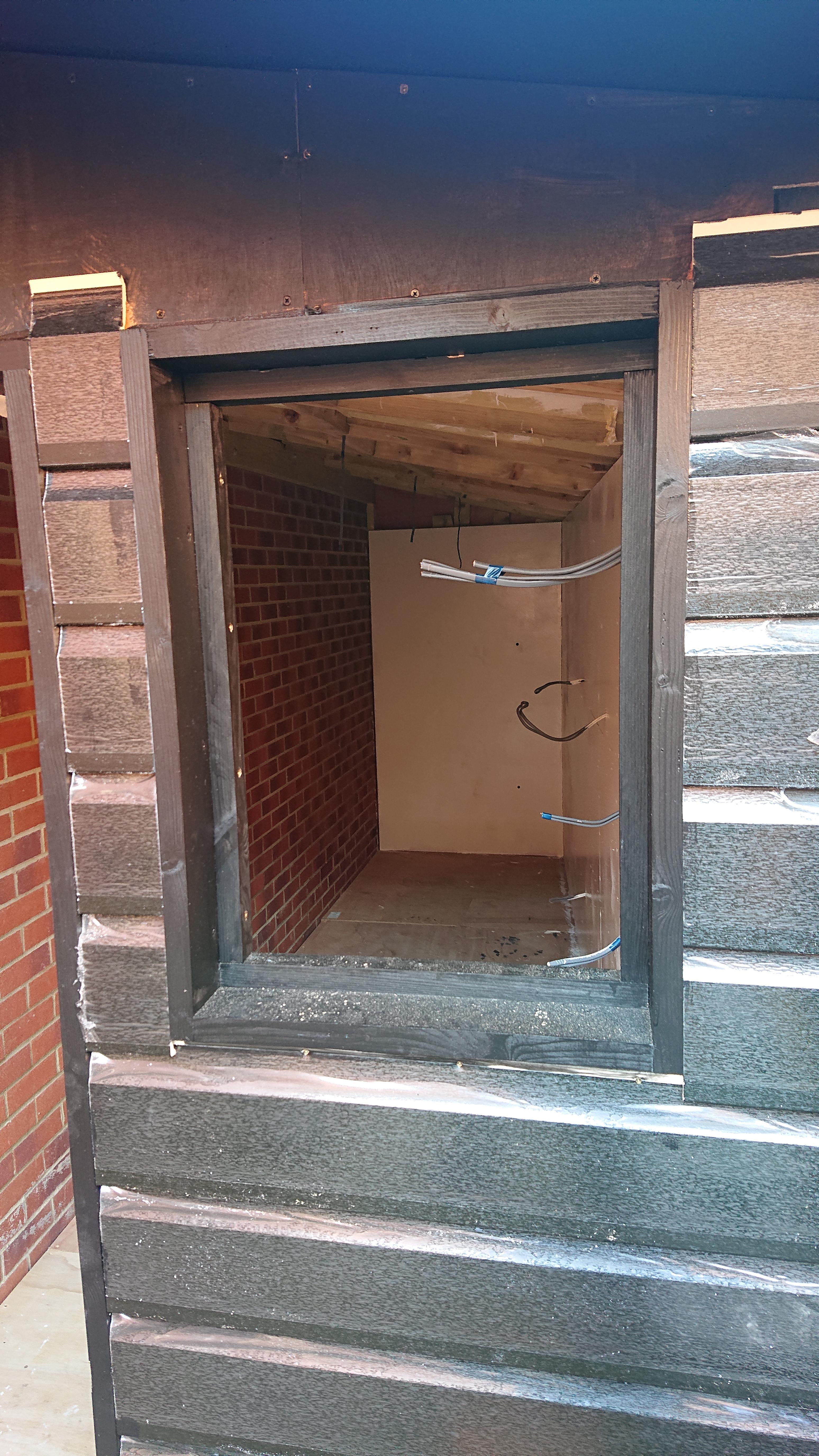

    As we progressed on with the project, I thought it would be nice to have a window right by the workbench, so I could see anyone coming into the garden if I were sat at the bench tinkering.
    We decided to make the window frame ourselves and just order the double glazed unit separately. This turned out to be really cost effective, coming in at £35 for the double glazed window and £40 for the other materials.
    alt text
    alt text
    alt text
    alt text
    Whilst the front was being worked on, I cracked on with putting the inner walls up and painting it. It's white to reflect as much light as possible, but will no doubt soon be black once I get cracking on with projects 😛
    alt text
    alt text
    alt text
    Chuffed to bits with how the window has worked out. Looks really smart!

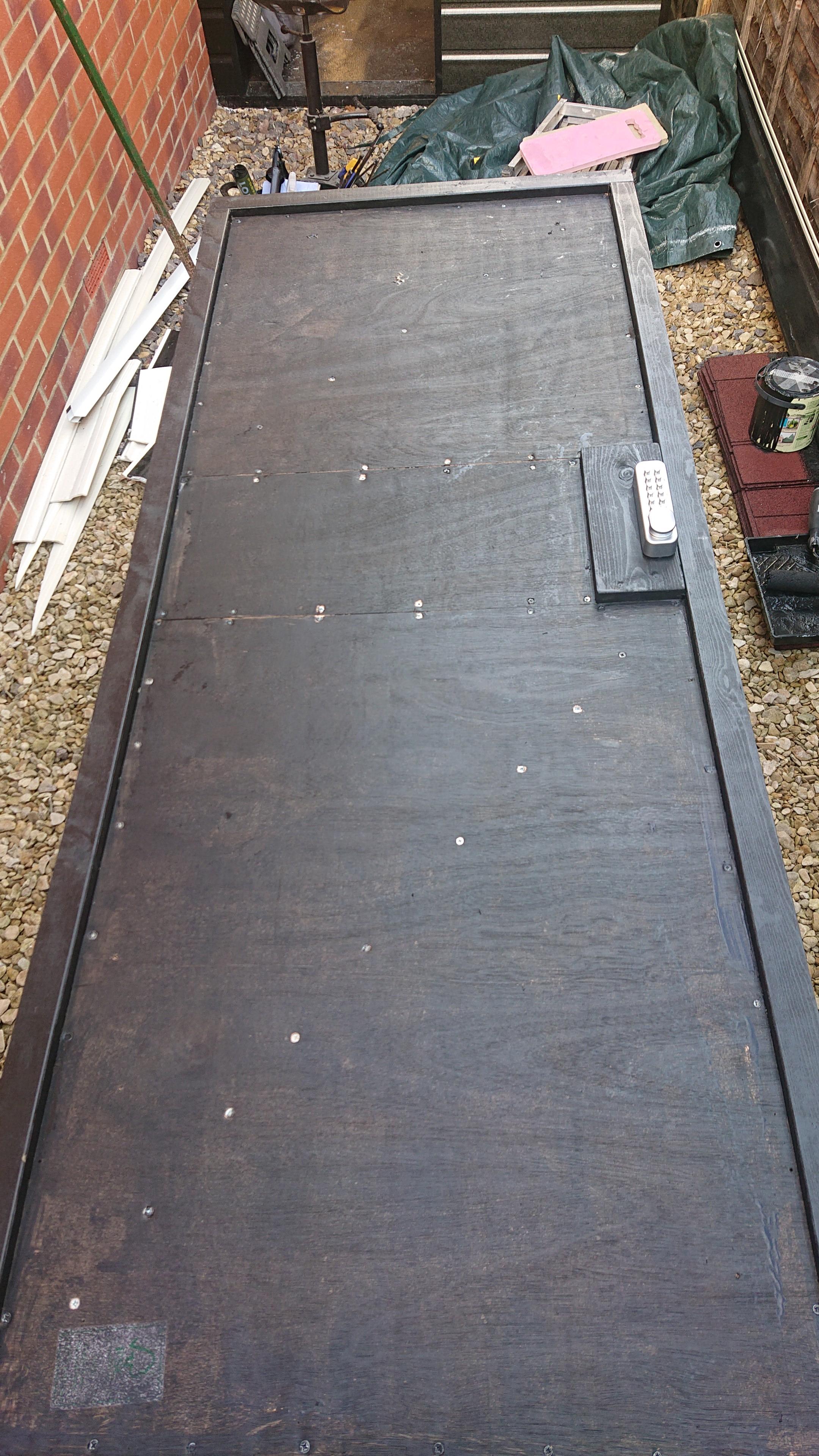

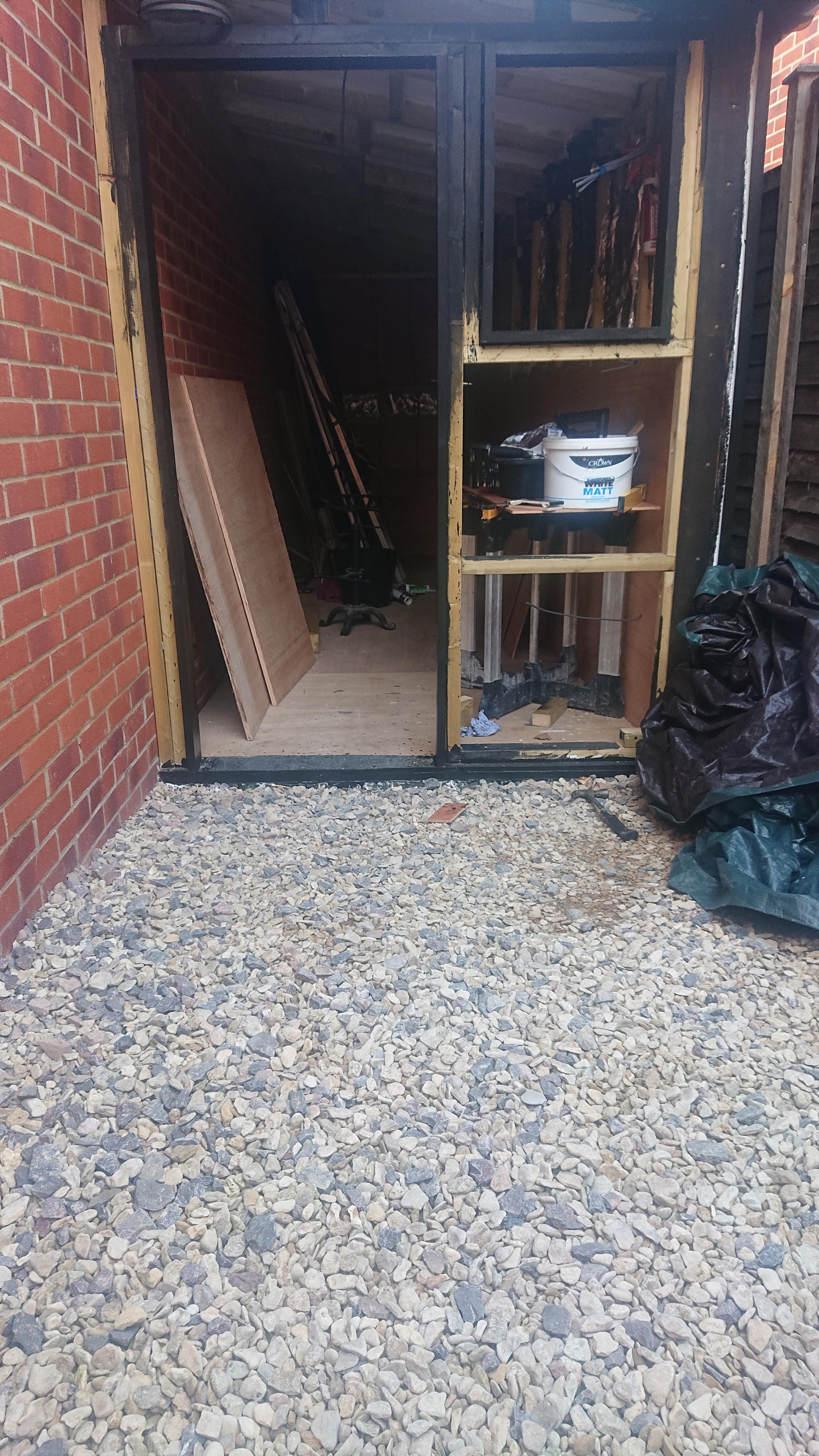

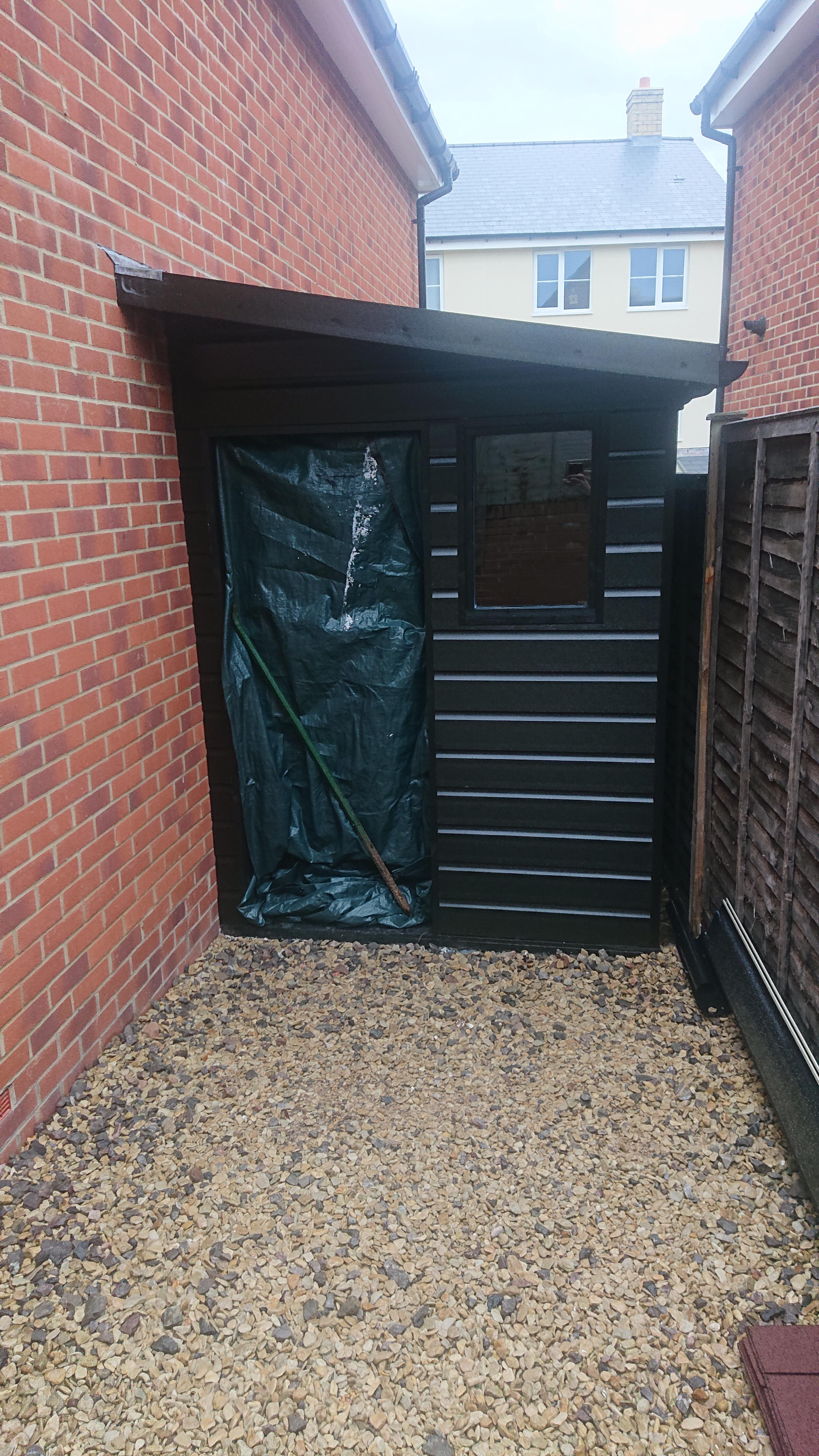

    All that's left to do to water tight the workshop is to build a door for it.
    alt text
    For this I wanted a combination punch lock for it so that I didn't need keys to get into it. I won't be storing anything valuable in there it's merely as a means to have somewhere to work on engines and what not.
    alt text
    It took a bit of head scratching and uhhmming and arring but we got there in the end and the end result is 👌 perfect!
    alt text
    I literally could not have asked for a more perfect build!

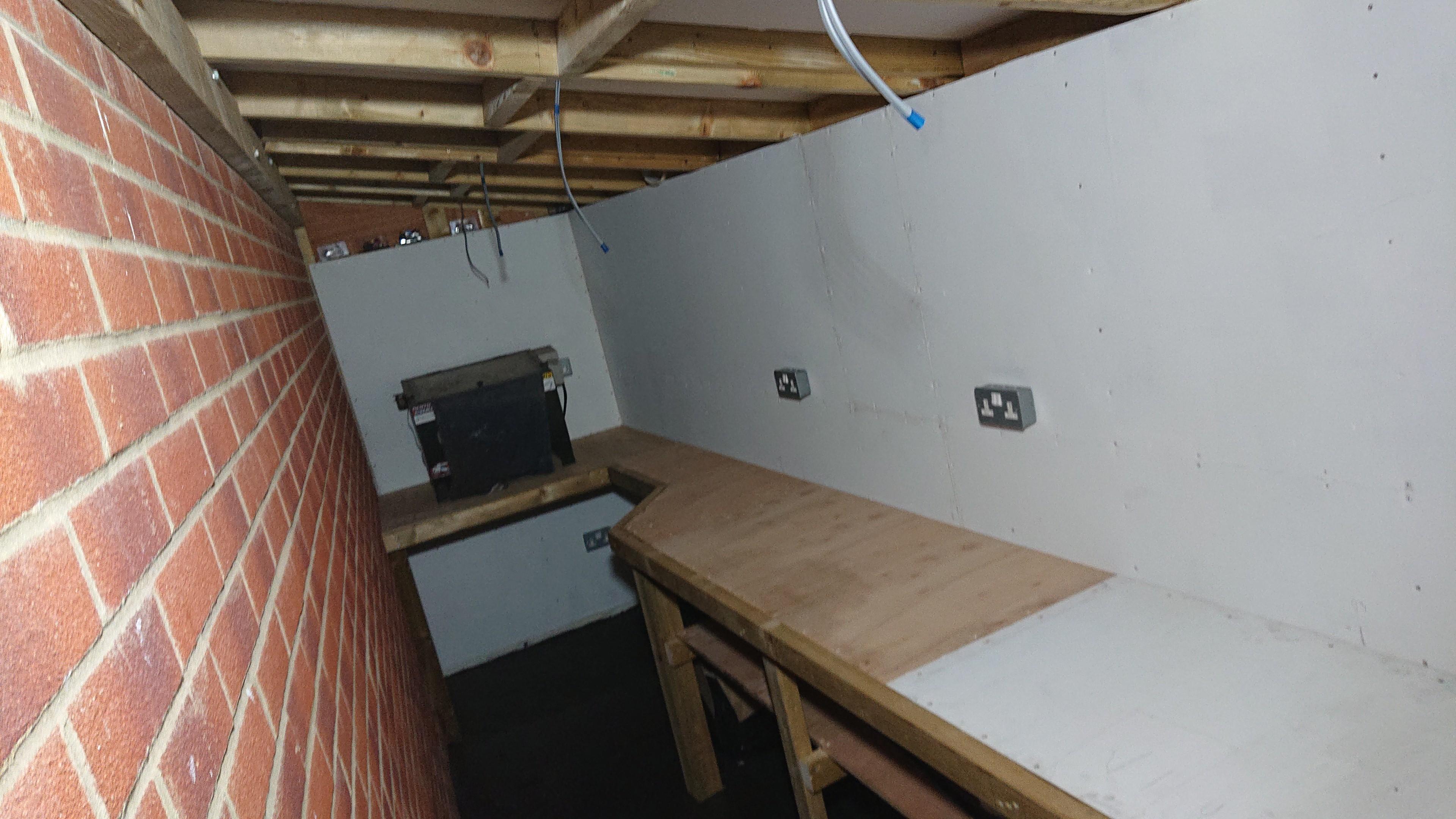

    Building The Workbench

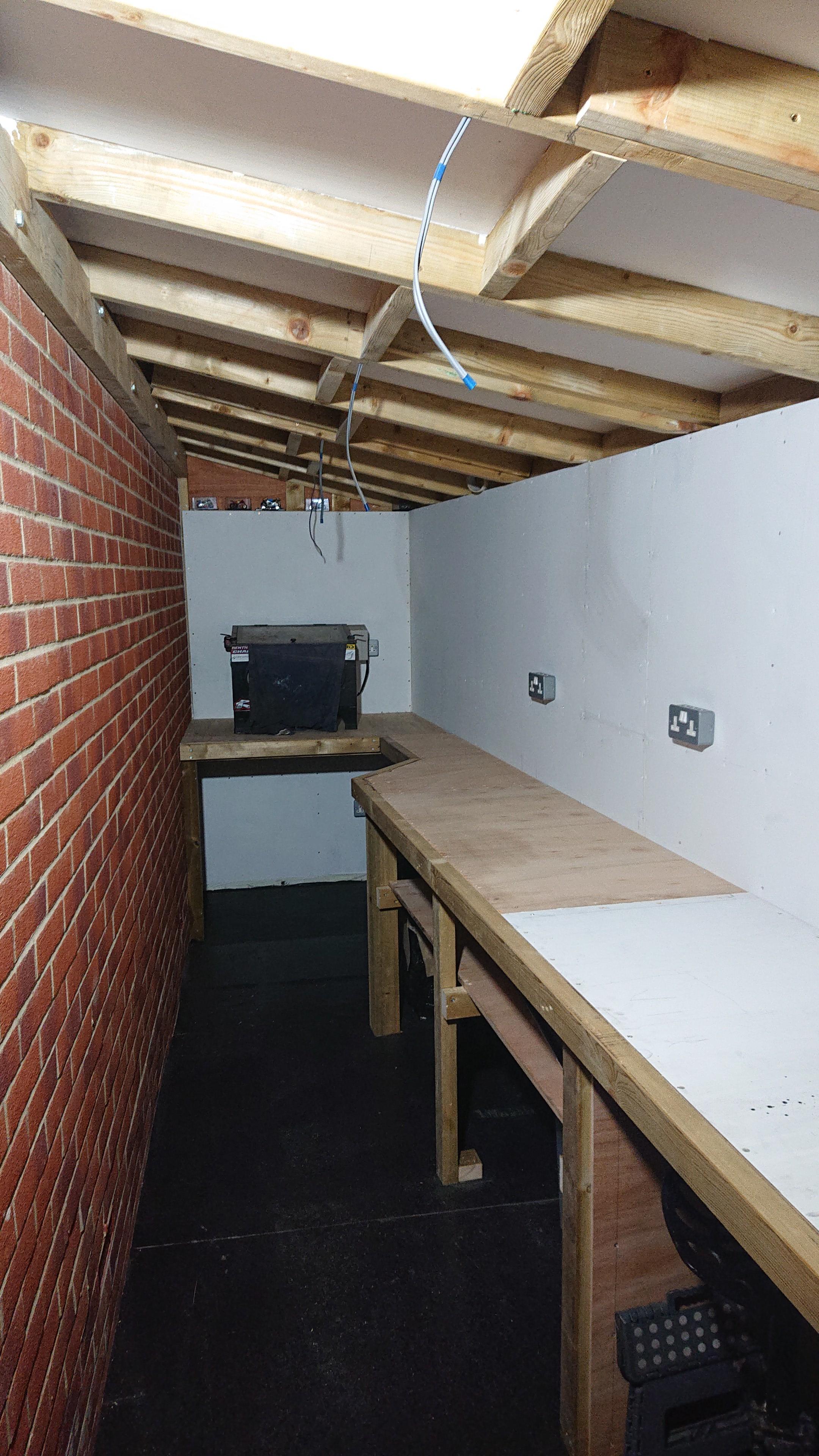

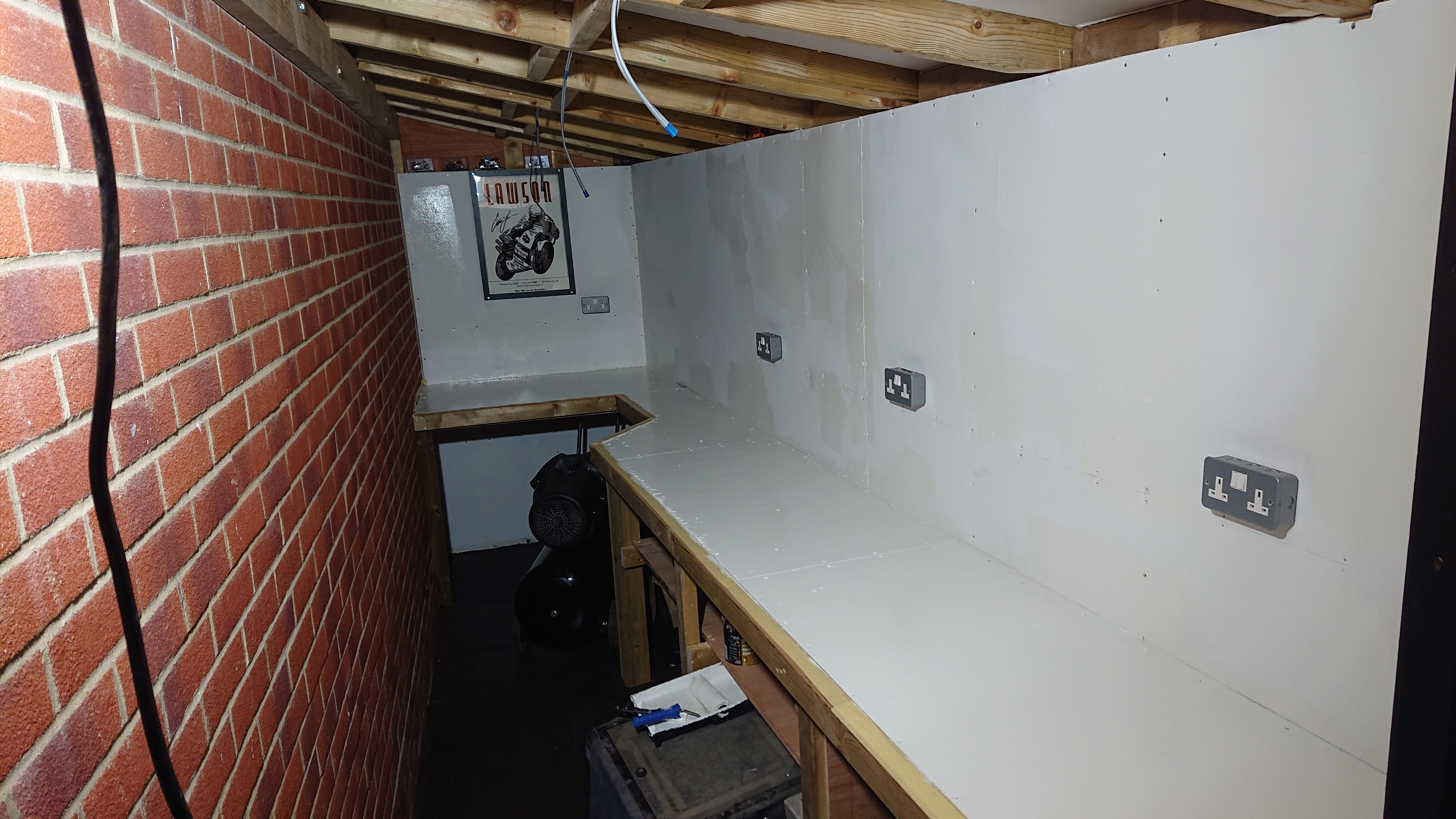

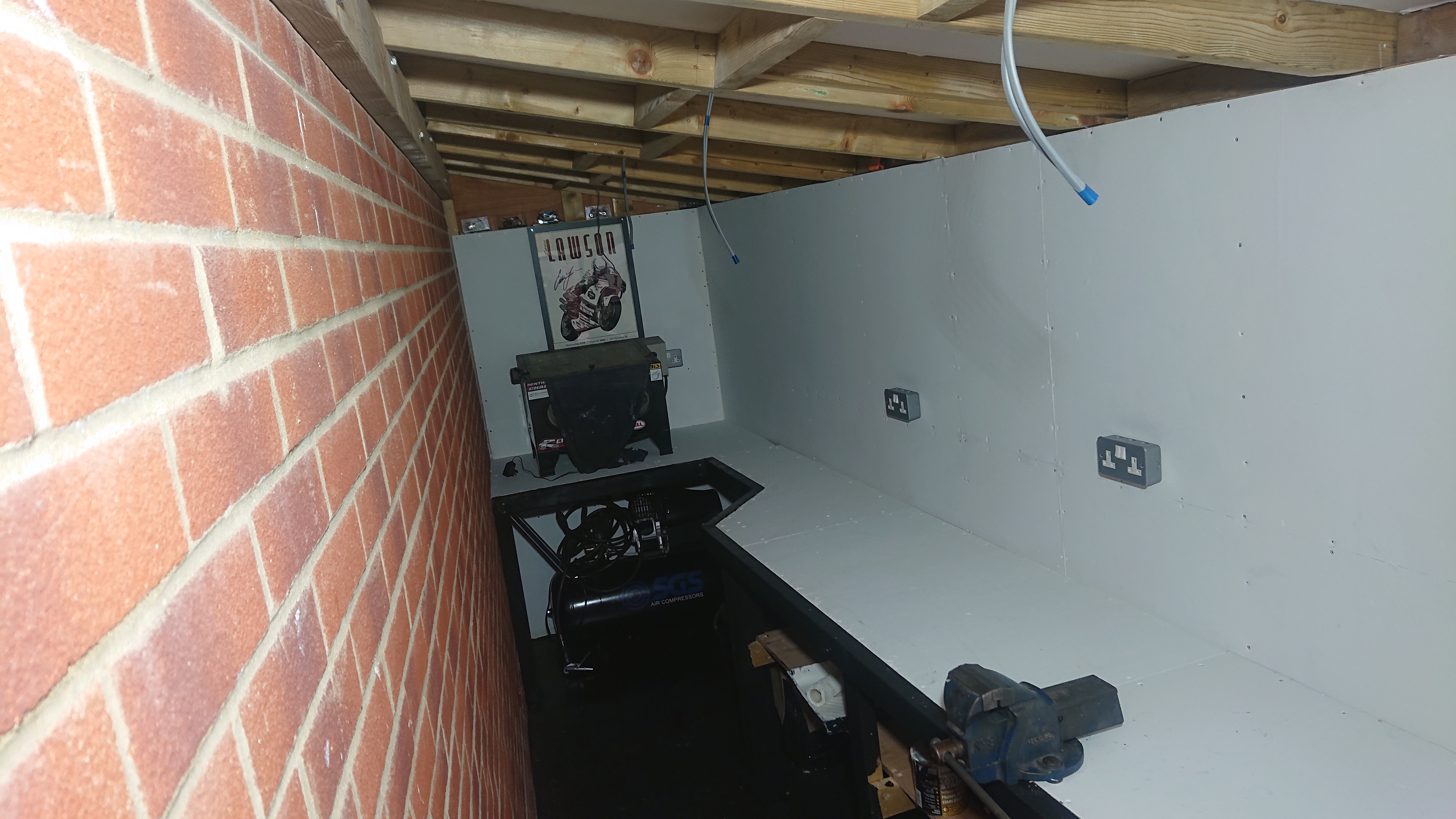

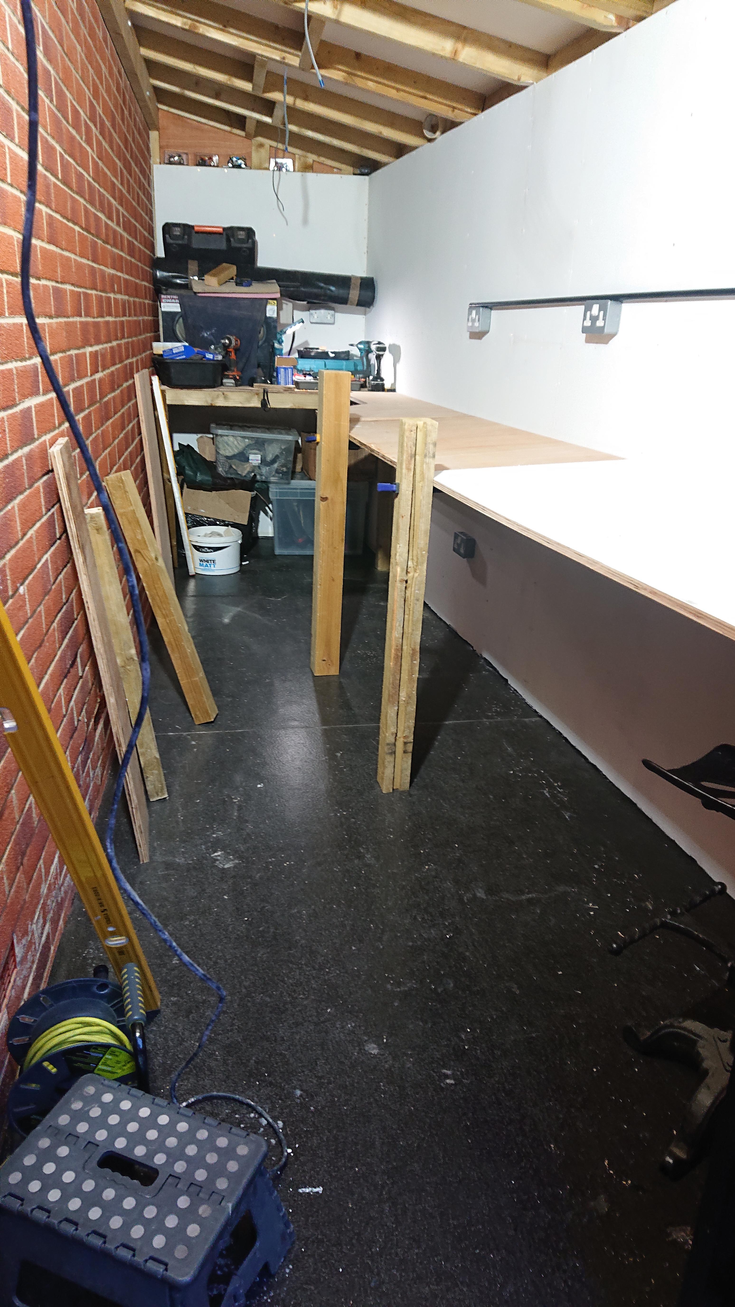

    Now due to the limitations of the workshop, the bench had to be thought about carefully. One of the main purposes of this workshop was to move the compressor and shot blasting cabinet into it. I felt like moving this into the narrow space at the end would work well since it's 1.2m tight in there anyhow.
    alt text
    So after laying down some vulcanised rubber flooring, and placing my toy two stroke bike collection, I set about making the first bench out of some offcuts I had left over from the roof.
    I decided to have a consistent 600mm workbench throughout the rest of the workshop, tapering it at the end giving plenty of space to operate the cabinet.
    alt text
    alt text
    With a little bit of body kit, some shelves and a seating area the bench was completed within an afternoon.

      Finally bought some AptX bluetooth speakers, fitted my inspection lamp and installed the compressor. I fitted the LED lights yesterday and am just awaiting the power to be installed.
      Conclusion
      I am over the moon with this workshop. It has been 4+ months of graft every weekend, meaning I've not been able to even remotely look at my ETX this year, it's currently dismantled sat in the garage awaiting painting. But honestly this workshop is absolutely essential for me to continue building bikes in the garage.
      All that is left, currently out of stock, is a 55" SGS Engineering Stainless Steel Roll Cab Tool Box for the garage and I can dismantle the remaining bench that resides there.
      The workshop cost around £6000 in total, I think I was just in bad luck trying to buy timber due to shortages. That being said, this would have cost a heck of a lot more if I paid someone to erect it so I'm very grateful to my Mums husband who made this entire project remotely possible. I wouldn't know the right end of a shovel if it wasn't for him so I'm eternally grateful!
      I am hoping this year to acquire one last bike, making 7 in total, and then I'll call it quits....honest 😉
