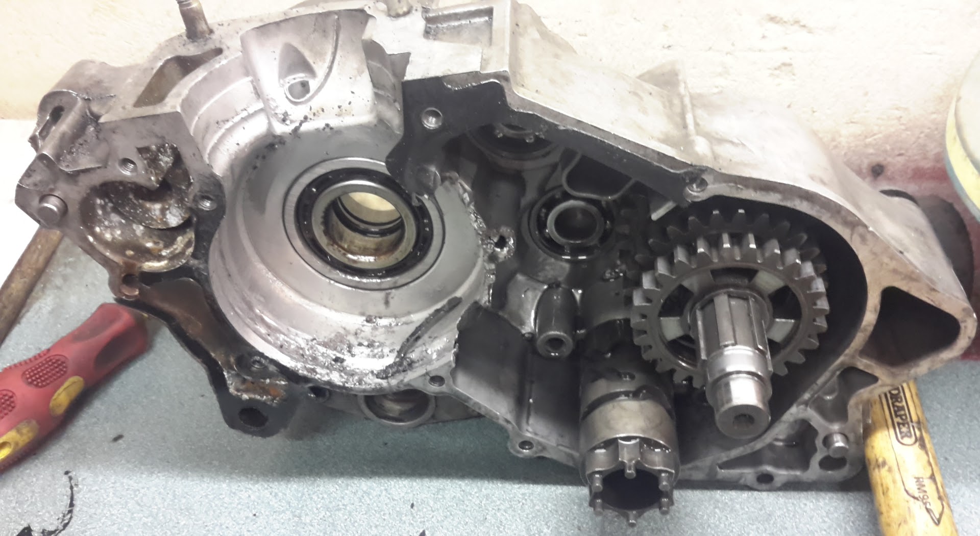

                @Stevie-Wonder Yeah, what I mean is, it's probably not "blown up". Either the crankcase seal has gone or you've blown the head gasket.
                I have had engines where the connecting rod has let go and gone straight into the gearbox, that my friend is ka put!
                Come to me when your engine has done that to you.

                  @Calum That looks pretty serious! Out of interest what make/model of engine is that please?

                      @HOTSHOT-III That's a Rotax 122 Kart Engine
                      Let go at 14k RPM (maybe higher) probably when it went over a bump and the engine rev'd its nuts off without a limiter...
