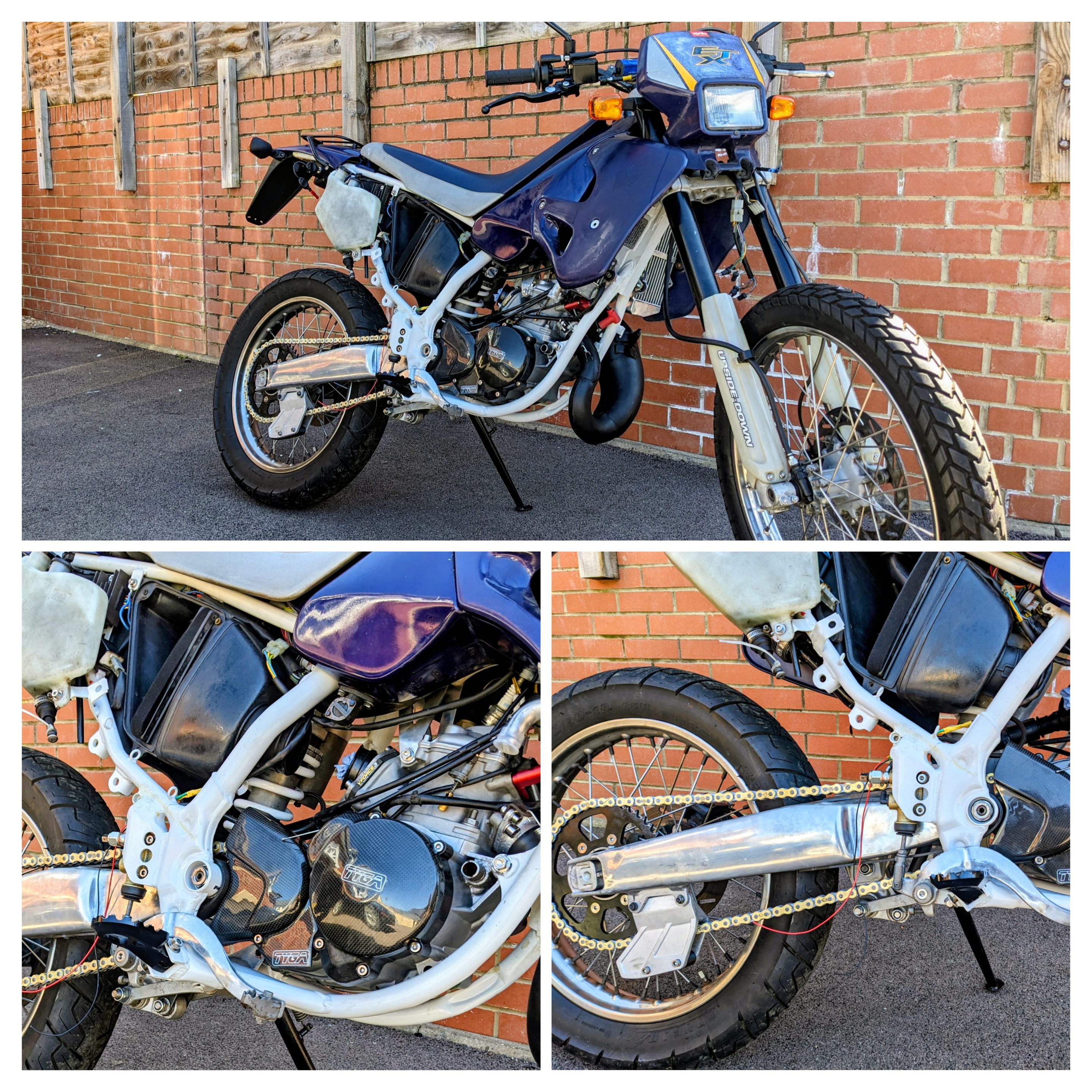

                #42
                🎆 YAY! 🎆
                What has been, three long years and the bike is finally on its own two wheels again.
                Trip down to the powdercoaters to pick up the suspension spring as it just didn't feel right to put the crusty one on there.
                I had it repainted the OEM colour for this bike, but fitted the RX/MX/SX shock absorber. It was refurbished to the best of my abilities.
                Sadly the bike isn't concourse and never will be.
                But it's starting to come together nicely now!
                And at least I can move it around the garage out the way of the other bikes finally!

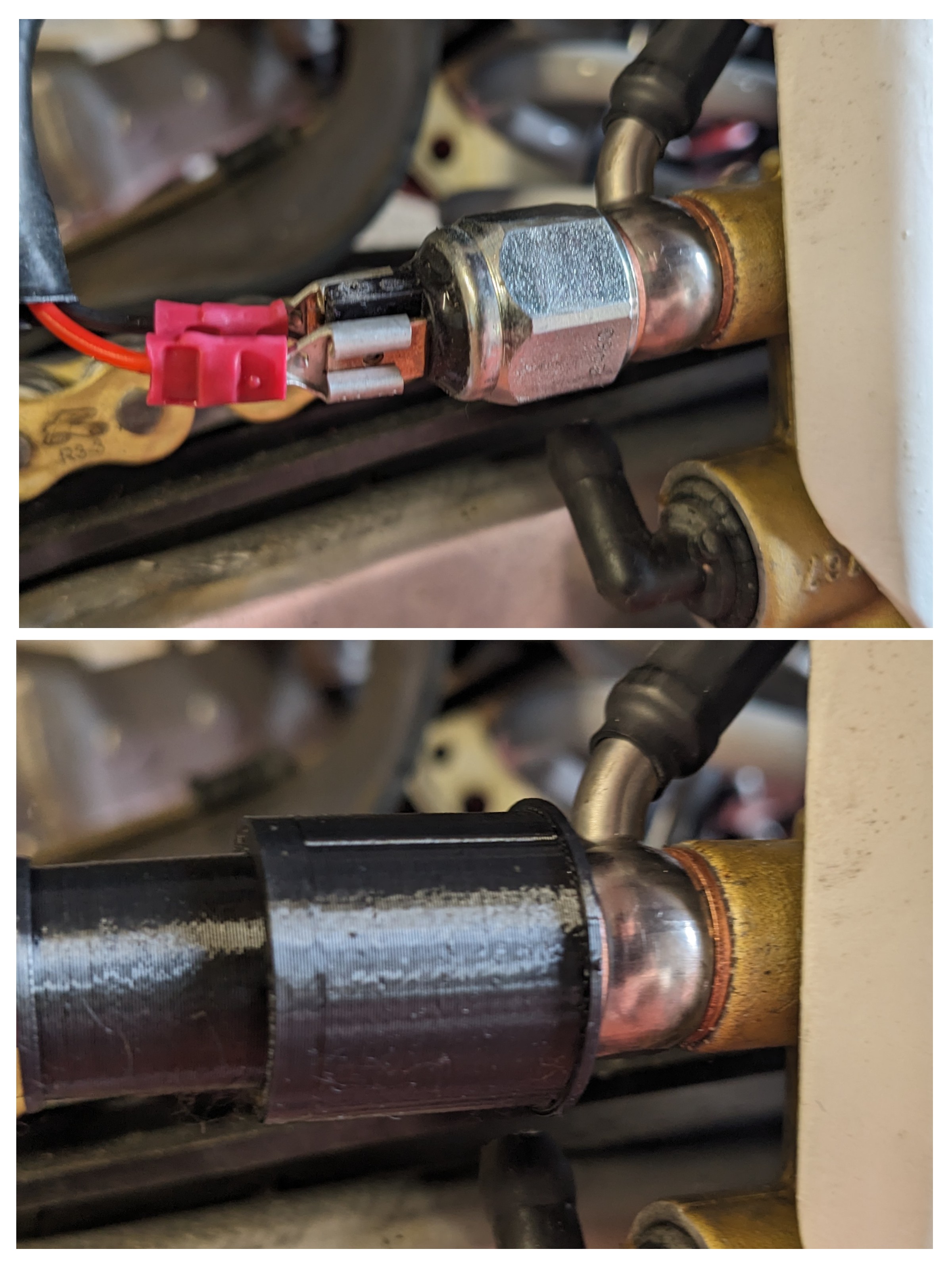

                      No surprises, but the original brake caliper was shot, completely seized solid.I managed to source another one, but one of the pistons was stuck. Once I addressed that, I found I was unable to pressurise the system, the master cylinder was shot.
                      These bikes share the same master cylinder as the Cagiva Planet, but I was unable to source one of those for a reasonable price. I ended up getting a KTM Duke 390 front master cylinder as the closest match I could find.
                      Front brake now bled and working. Bought lovely Hel lines front and back. The rear master cylinder's wiring loom was shot to buggery. The banjo switch was all snapped and the wires were merely soldered onto the bolt.
                      A new genuine bolt, wire harness restored, then I designed and 3D printed the cover to secure it all into place.
                      Need to reattach the rear brake master cylinder fluid reservoir and see what surprises are in store for me for the rear 😮
