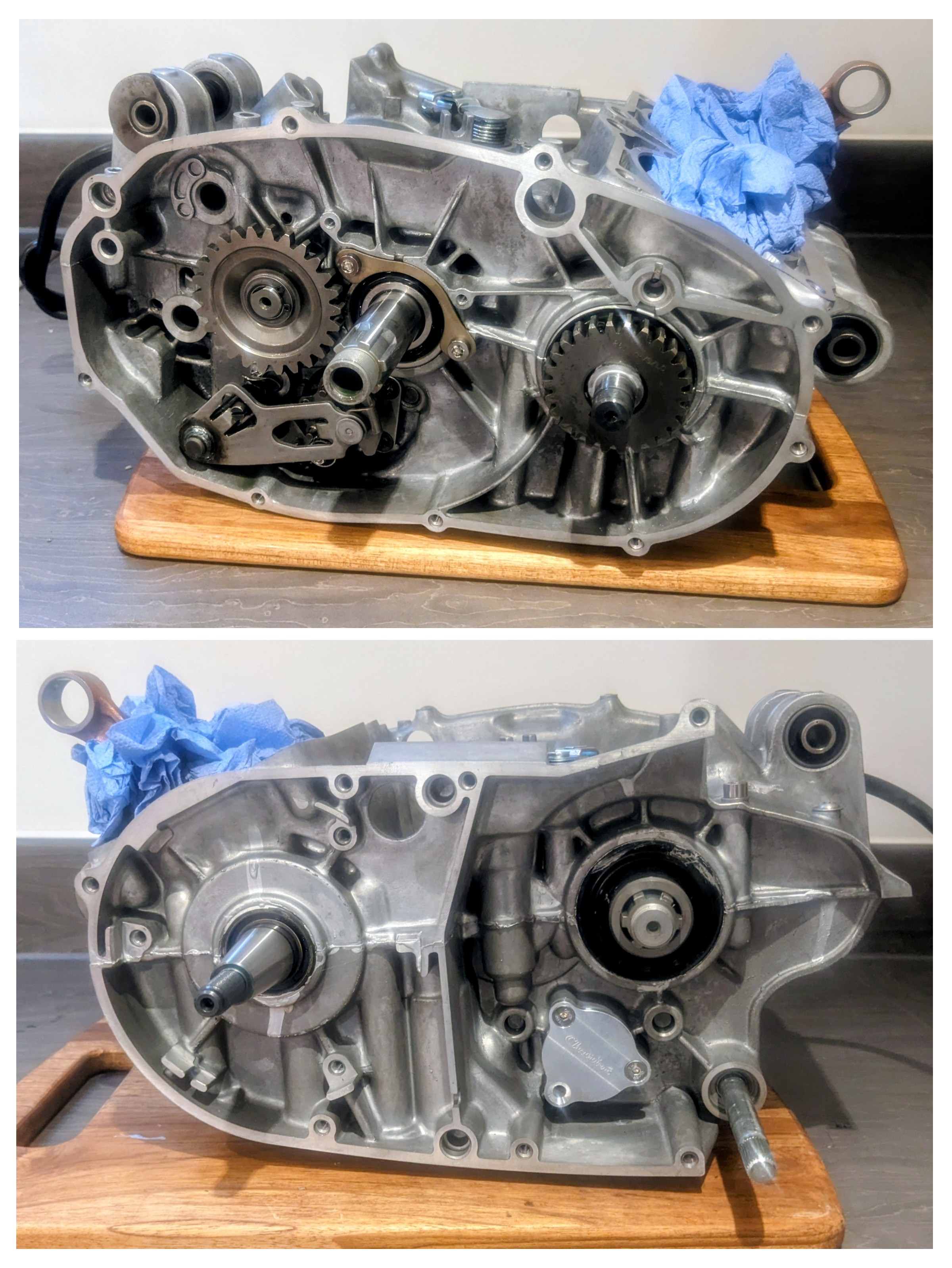

    • 1982 Yamaha RD 350 LC 4L1 crank cases.
    • The Yordi Reyna engine mount conversion kit
    It is here that I made my first critical mistake.
    YOU DON'T WANT THE 4L1/4L0 crankcases.
    Yes the engine will fit into the all models of RDs and the conversion kit is correct for it, but the crucial part here is the stud pattern on the crankcases are different, along with the internal spacing of both the crank and gearbox. They only did the LC for years 1980-1982 before they moved on to the far superior LC2 YPVS models.
    These cases were sourced at no small expense, but I may actually reuse them and drop them into my DTR some point in the very distant future.
    This is annoying, but is no dramas, I'm learning as I go and I was able to whisk this all off to the fabricators for the frame to be modified and the engine mounts welded in!

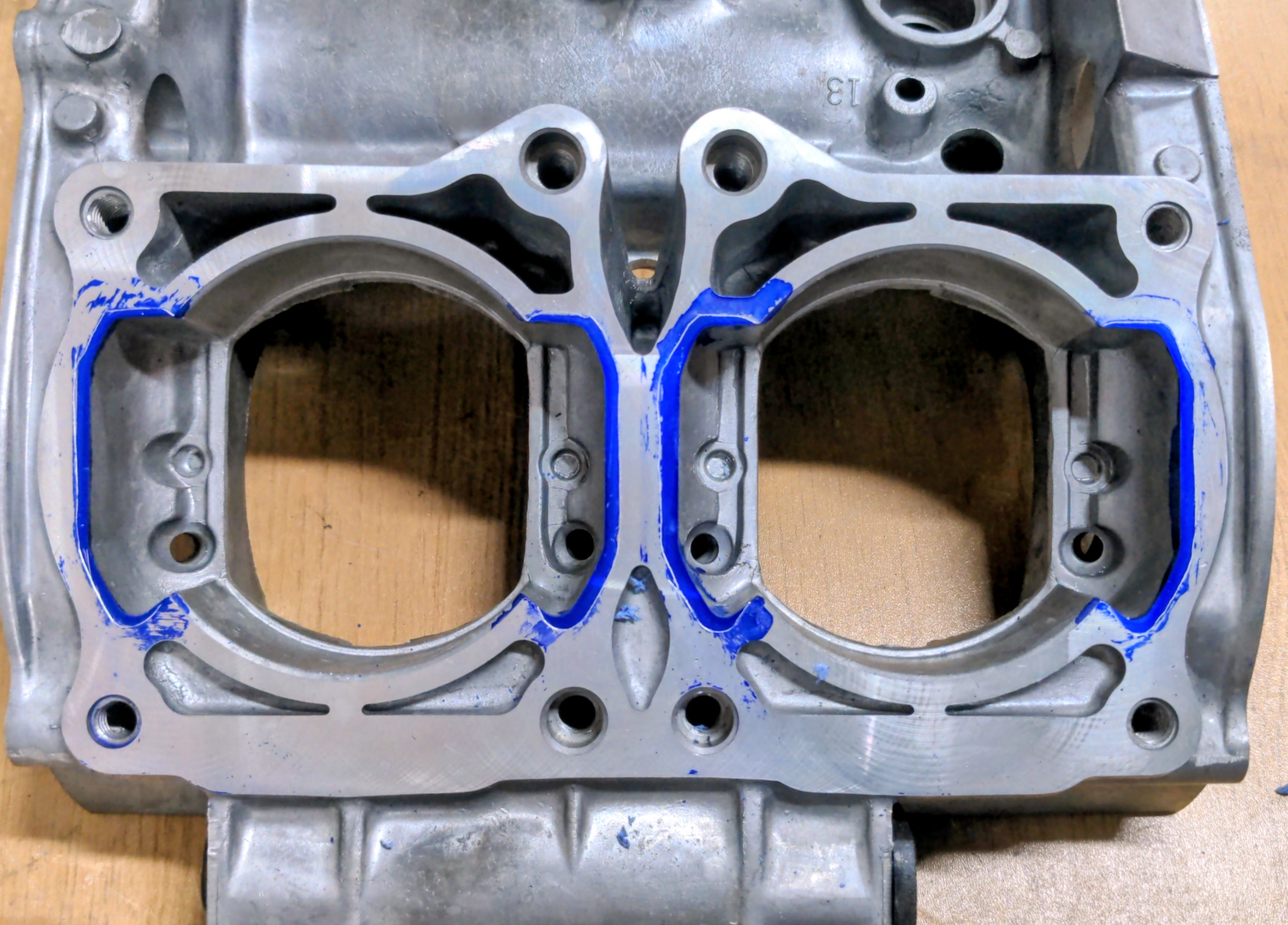

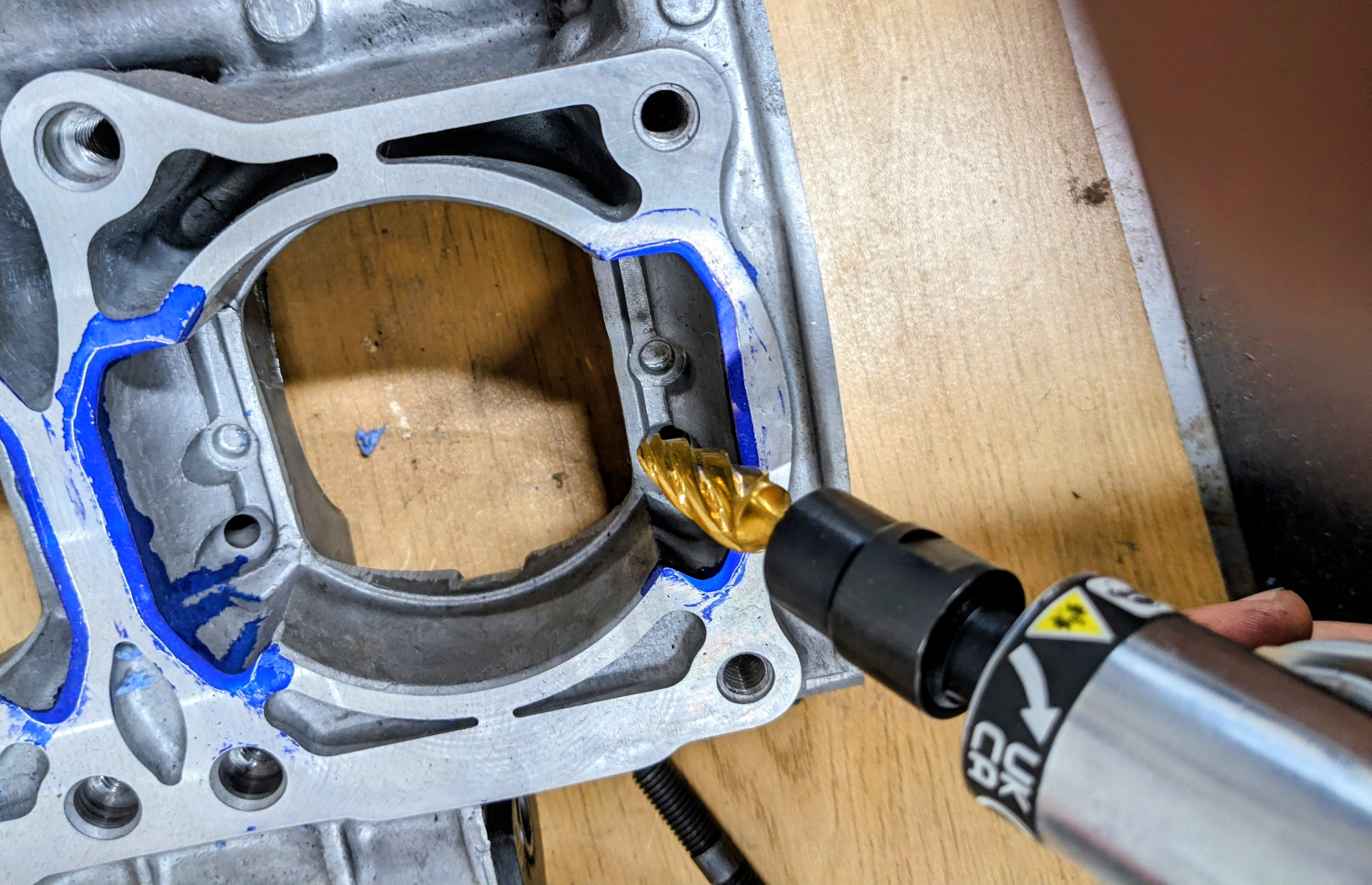

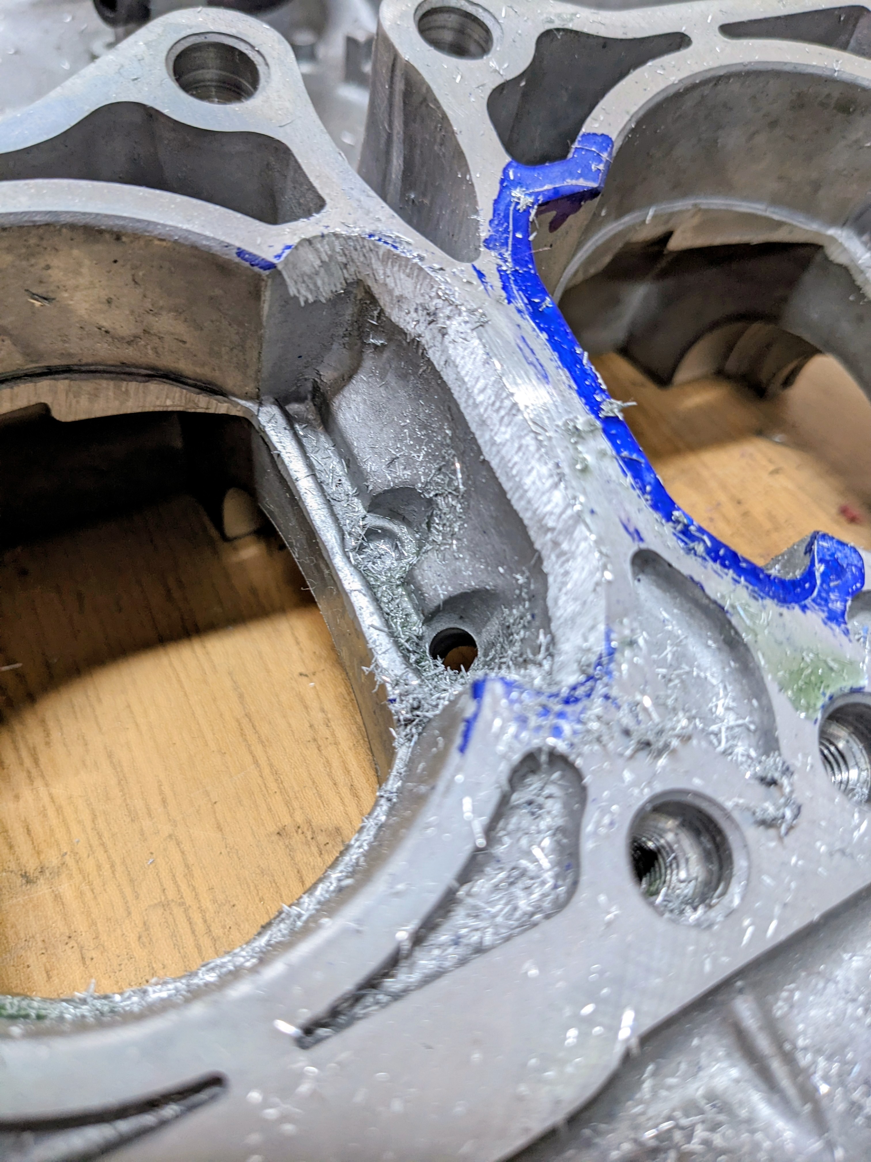

    The plan here is to run an RD 350 bottom end, stroked and bored to 421cc. I was unsure about how this was achieved, but JonW over at RDLCCrazyForum was able to talk me through the process. He basically ran the scene for these motors back in the UKs hayday, but his website has long gone and he recommended using the wayback machine to visit his site to figure out how this done. This to me was a bit faffy, instead I have rehosted (with Jon's permission), the portion of his website that deals with the big bore conversions on these engines.
    RZ350 RD350 Big Bore Primer
    ^^^^This is a MUST read for those looking to get the most out their big bore kit^^^
    Once I read this, I understand what steps I needed to do.
    • Banshee 350 Crankcases
    • Athena 392 Big Bore Kit
    • Hot Rods +4mm Crankshaft
    Results in 421cc of two stroke Godness!

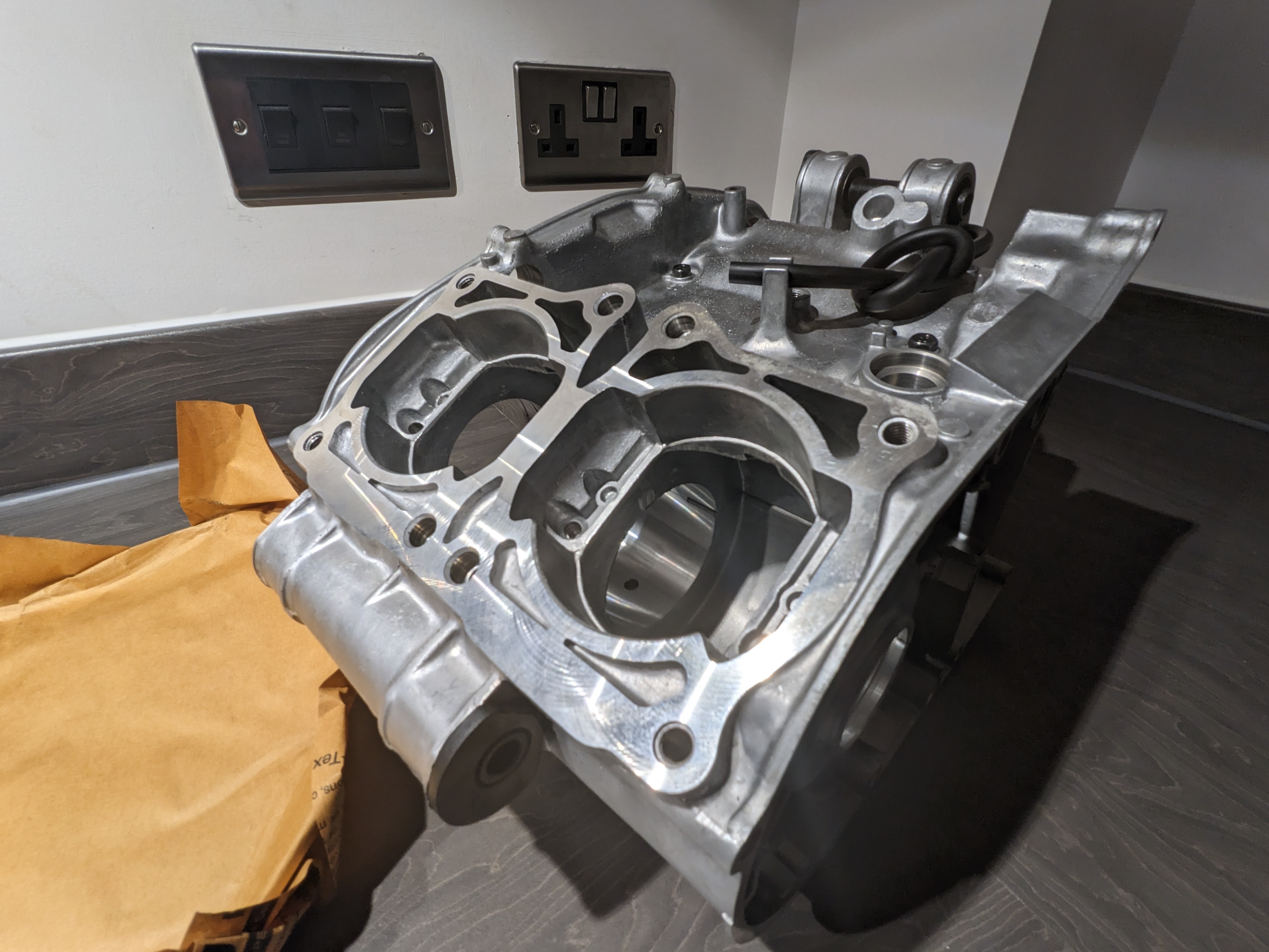

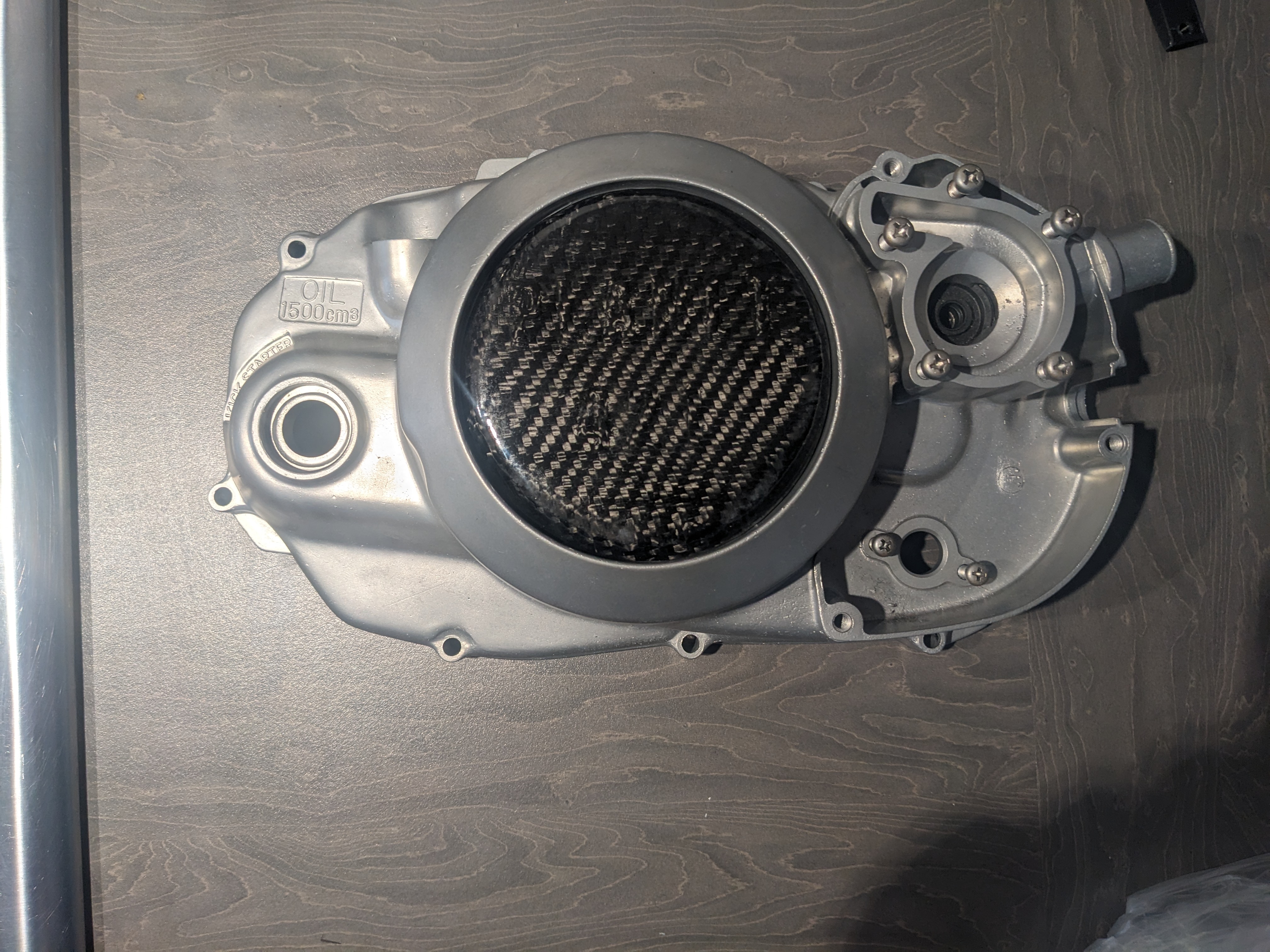

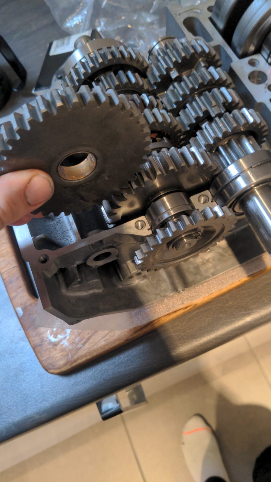

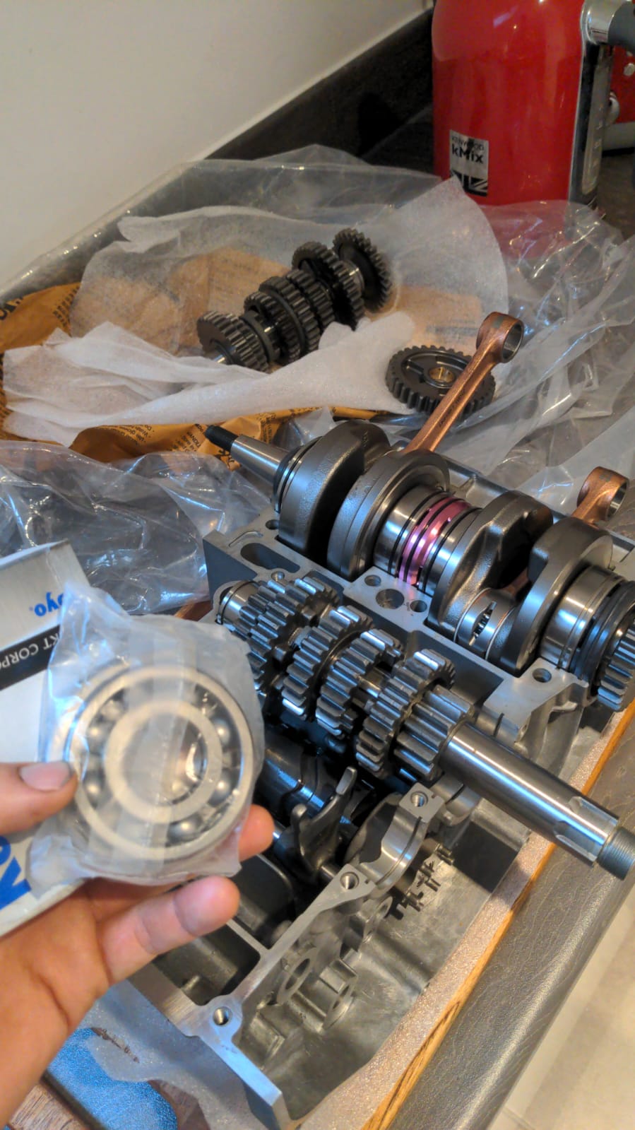

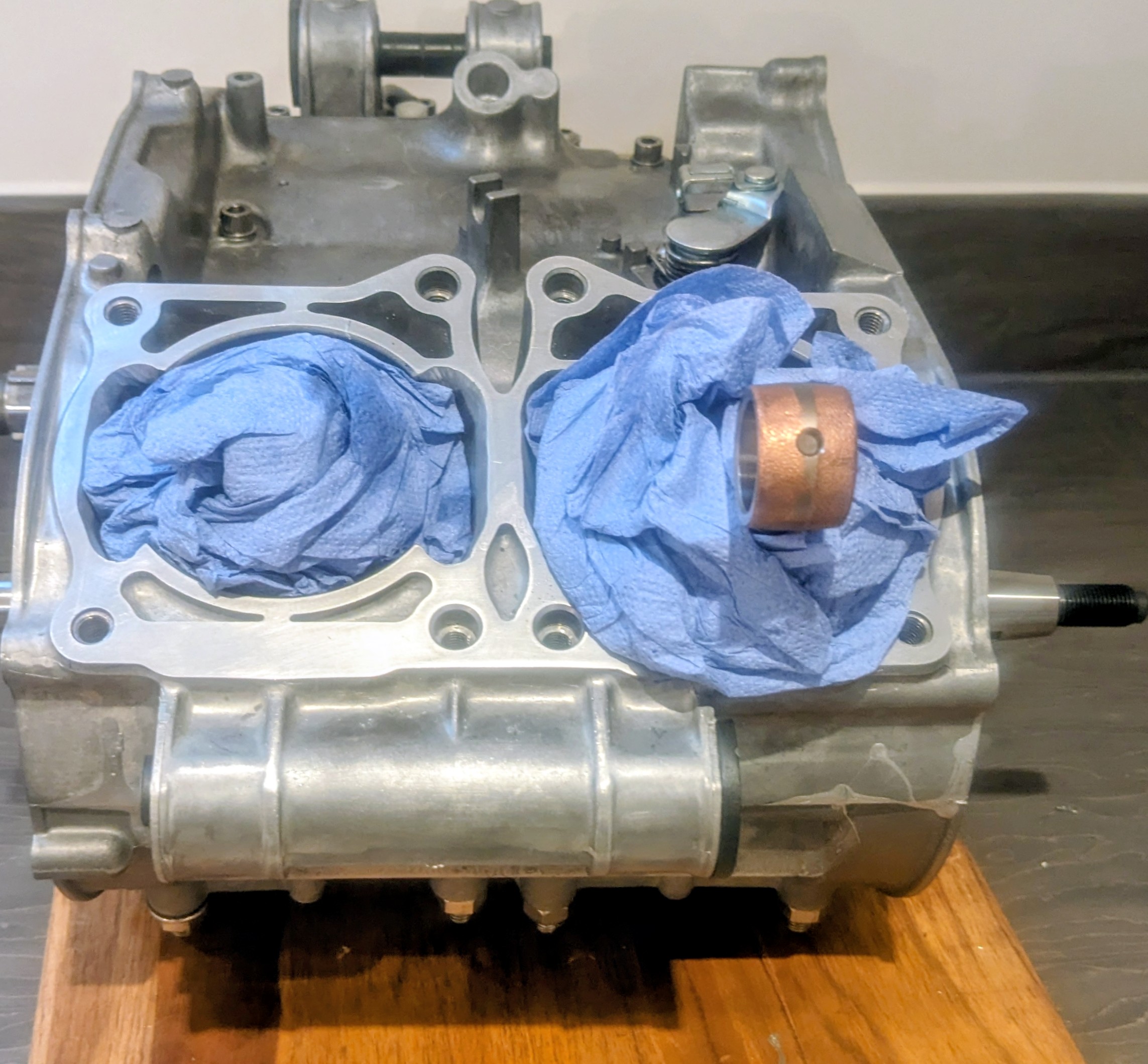

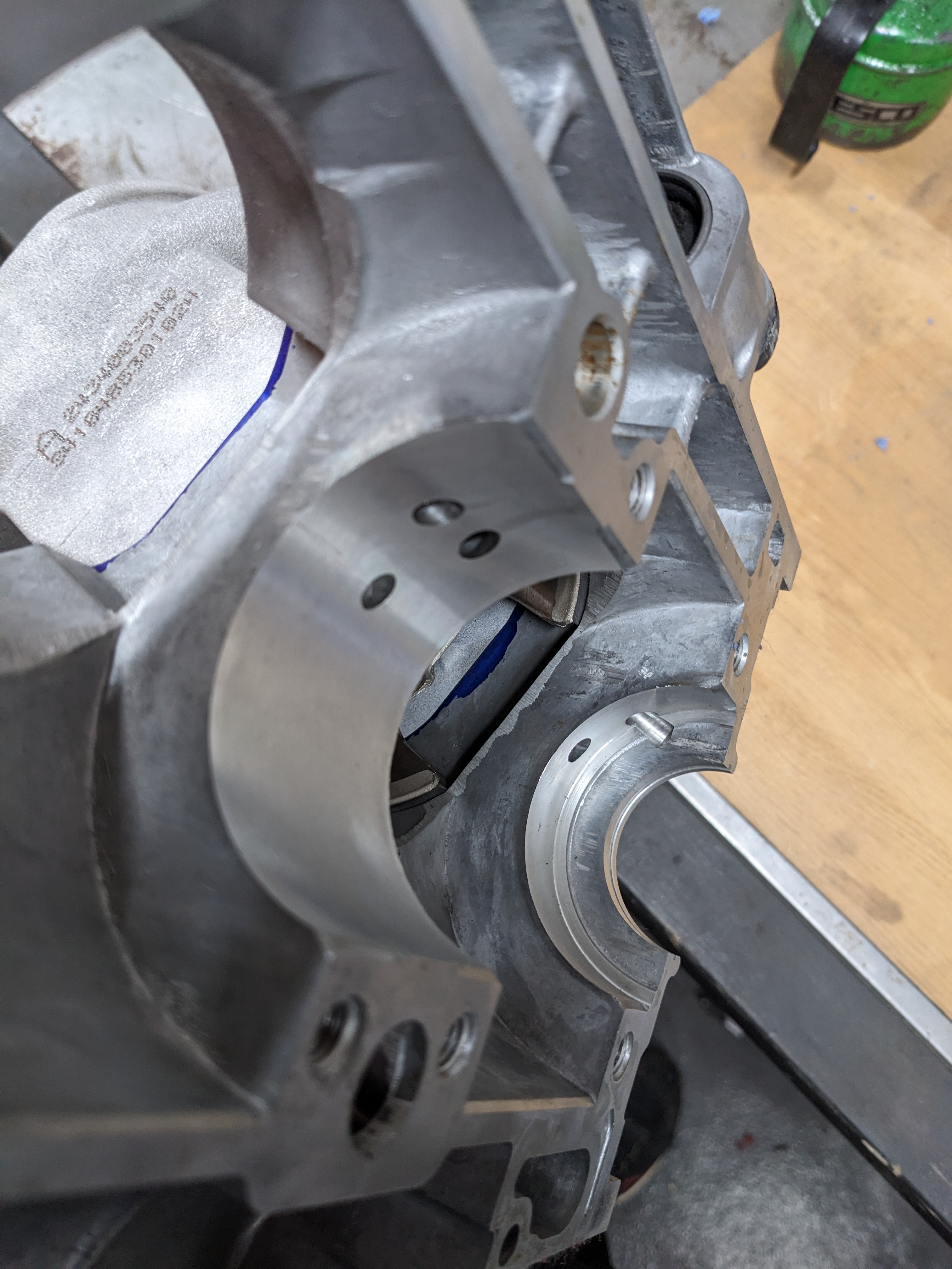

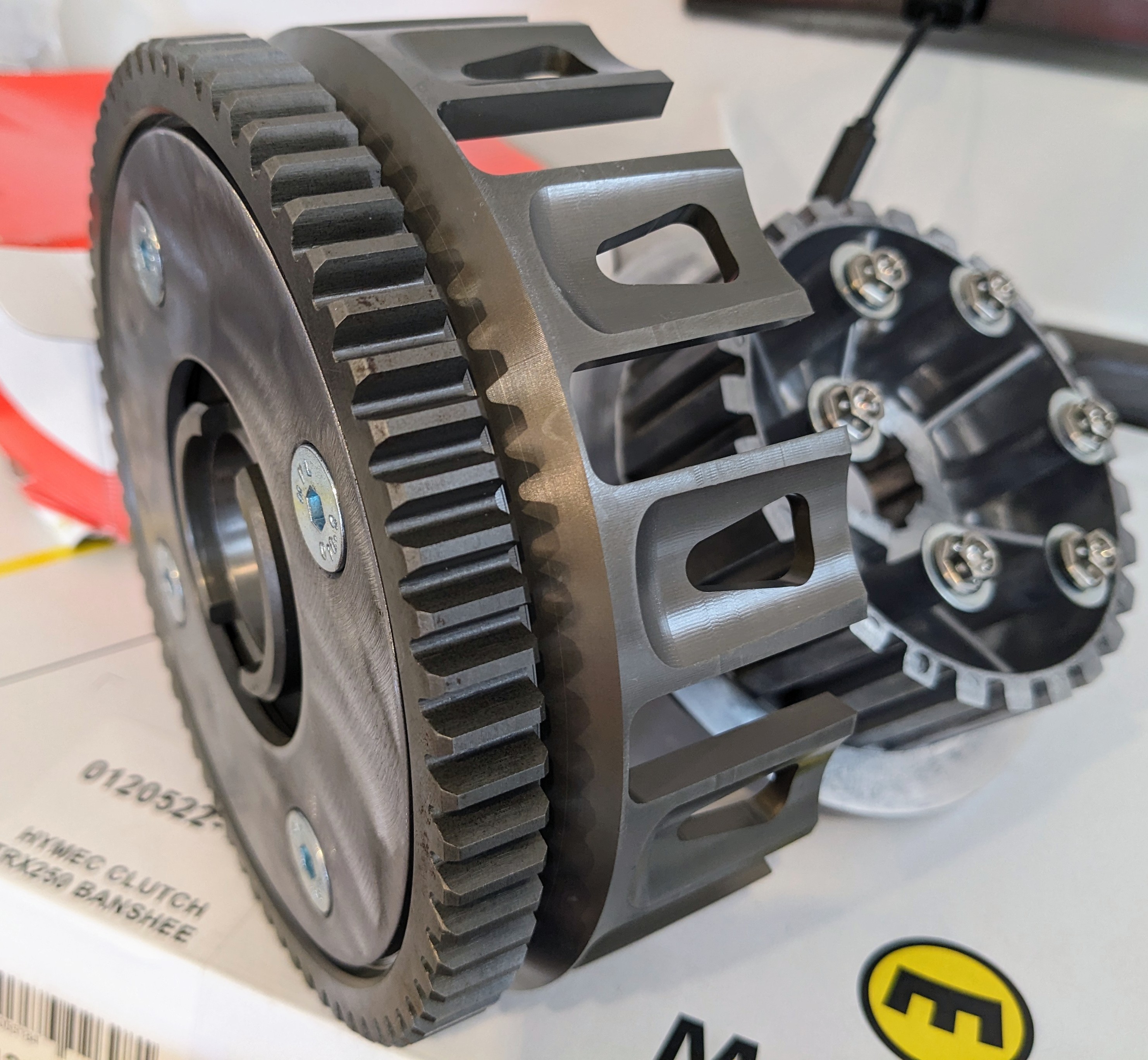

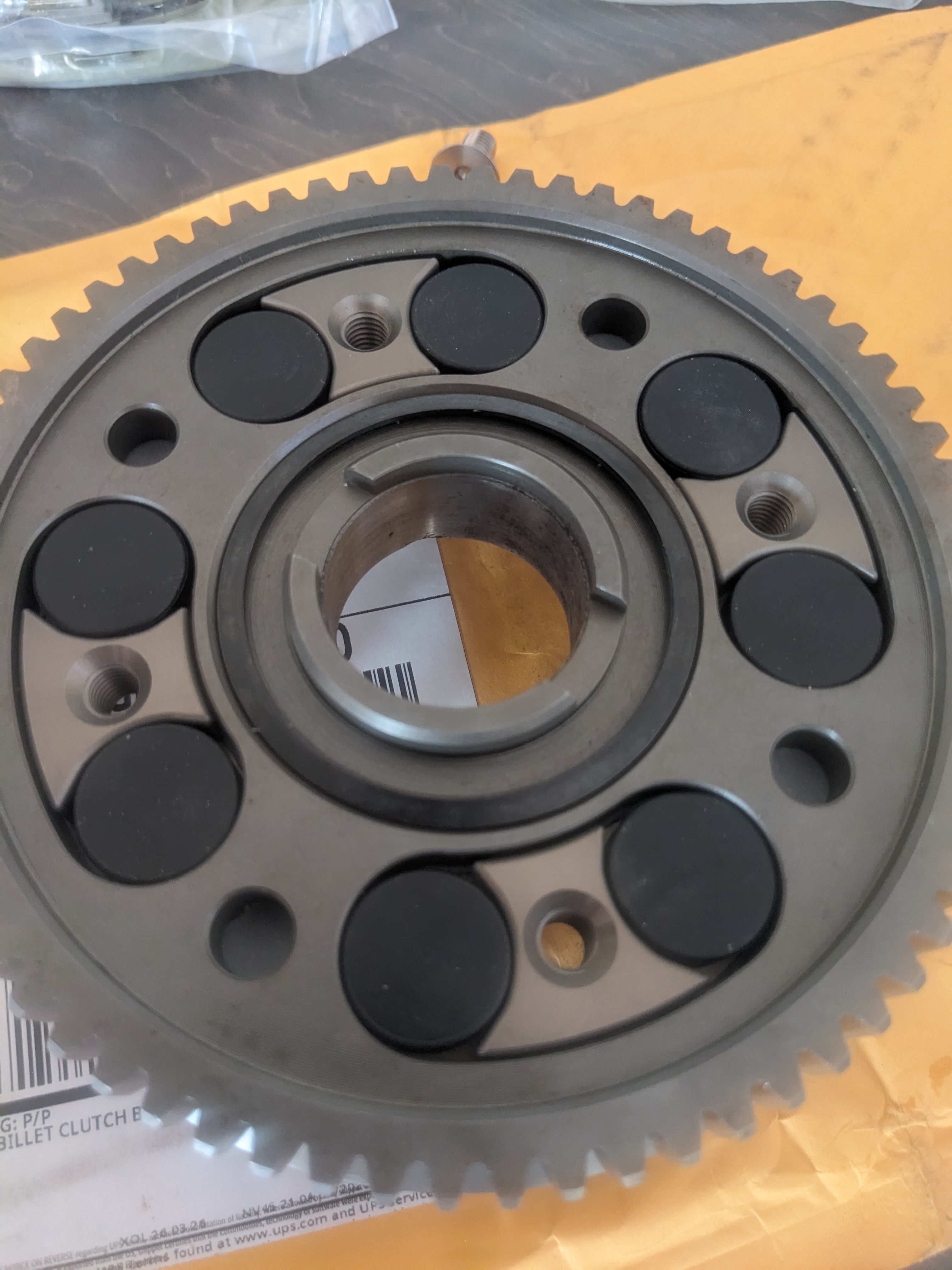

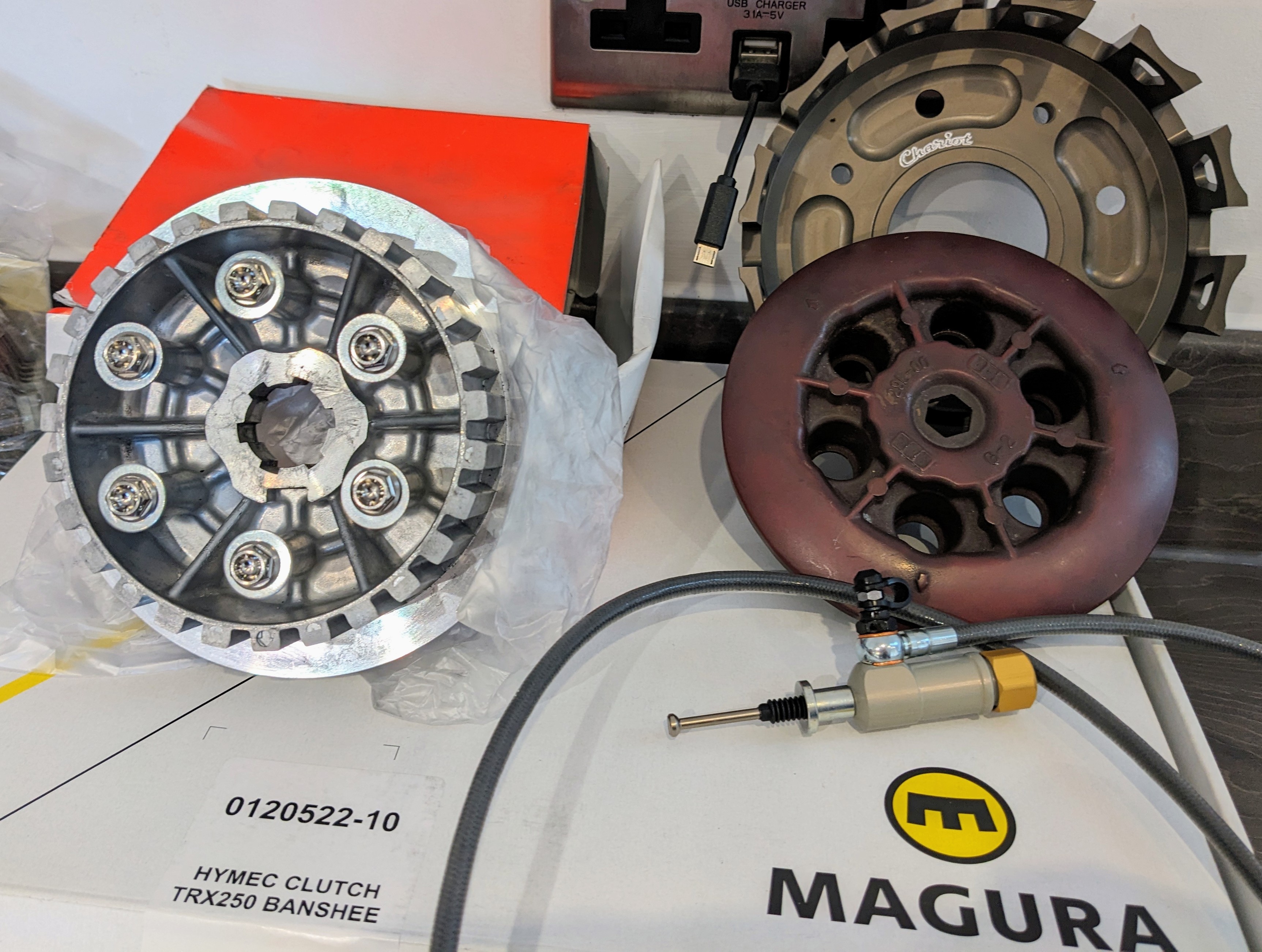

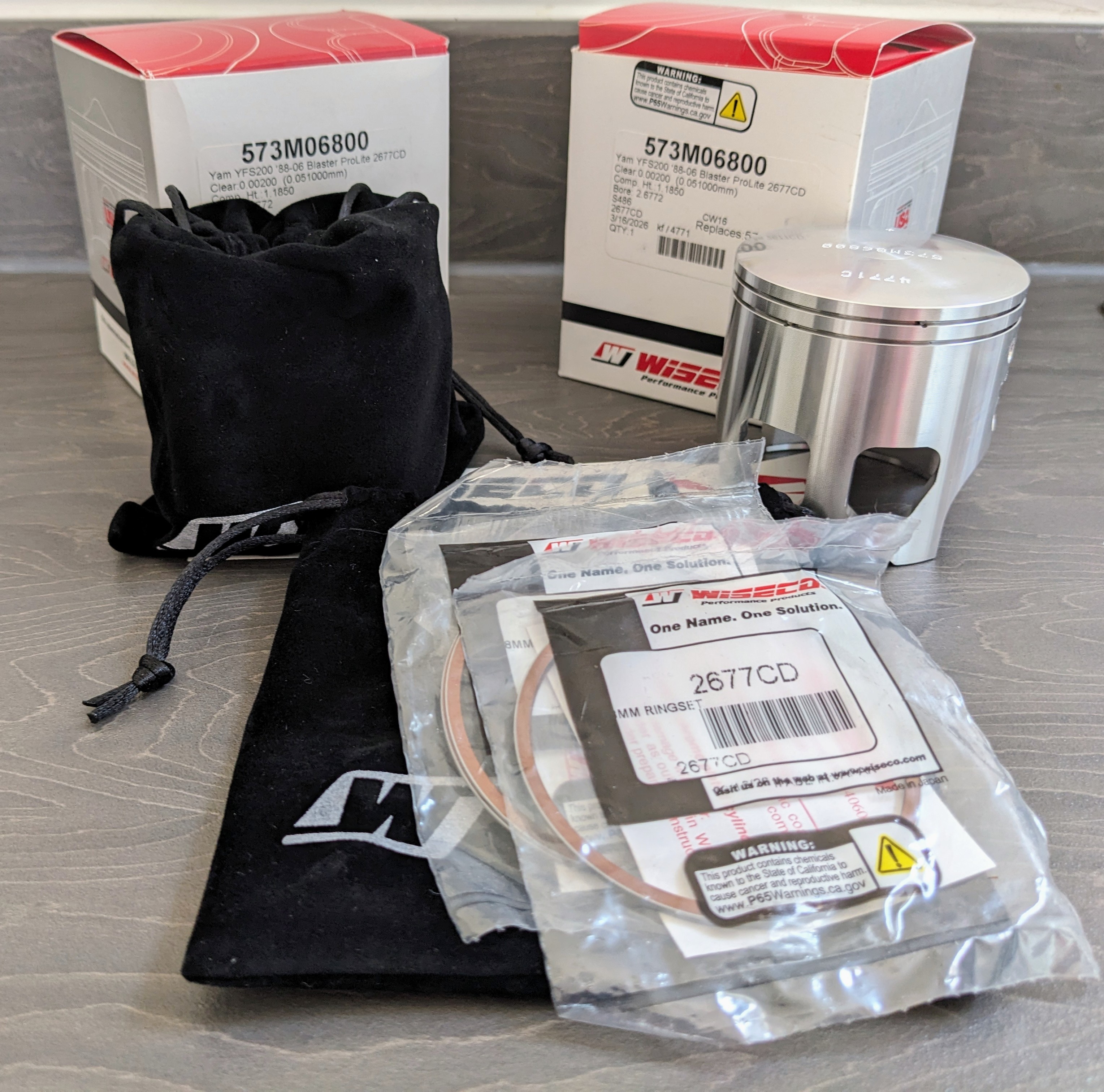

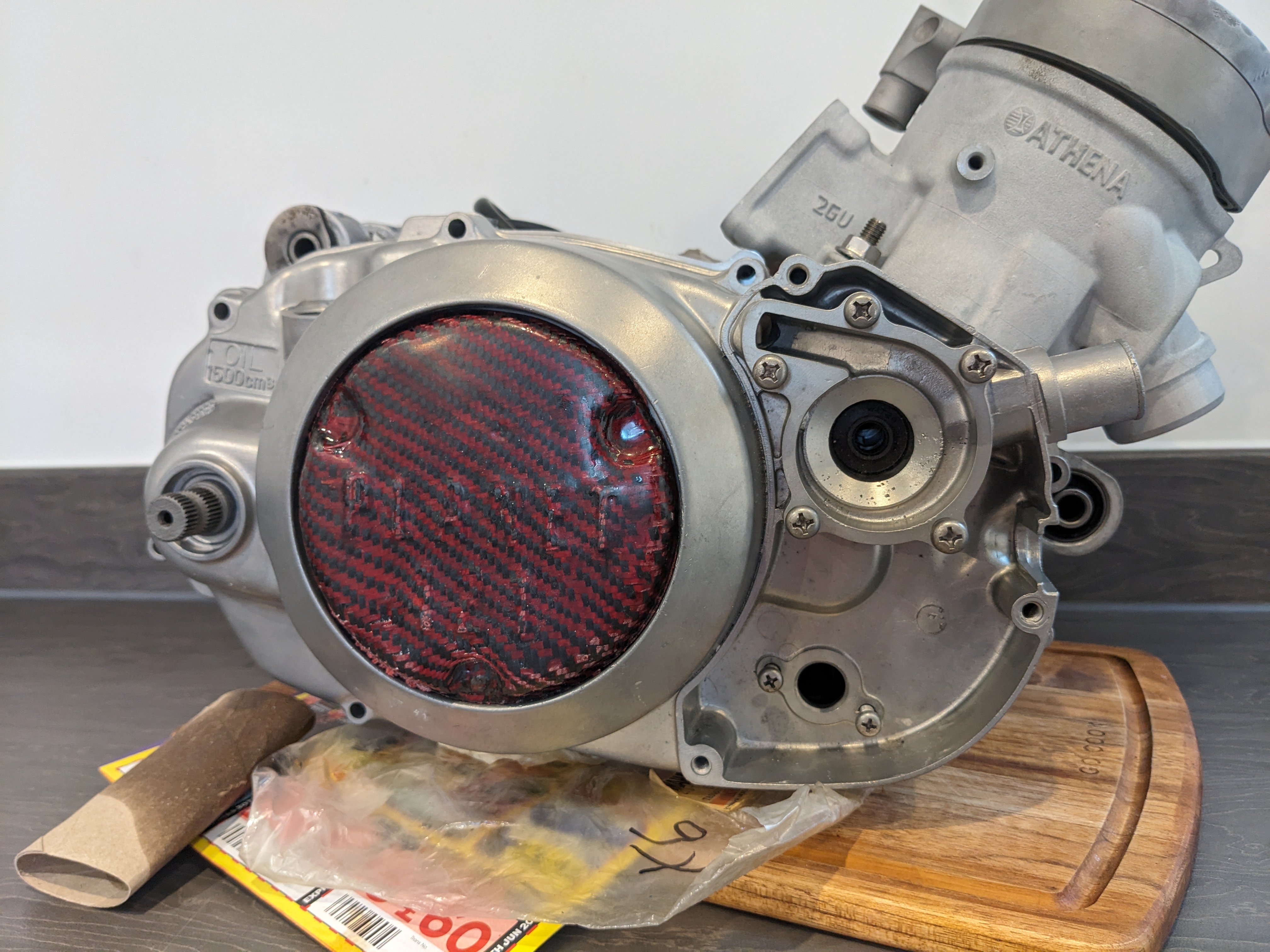

    Brand new in box direct from America from a company called Cascade Innovations, delivered in a matter of days, is my Yamaha Banshee 350 crankcase and what I will be using to build my power house with.
    I mean how cool is that! 😍
    Absolutely factory PHRESH, with a capital P!
    I was so excited to receive these as this is a major stepping stone to be building my dream motorcycle. So thanks again to Cascade Innovations for sending this over.

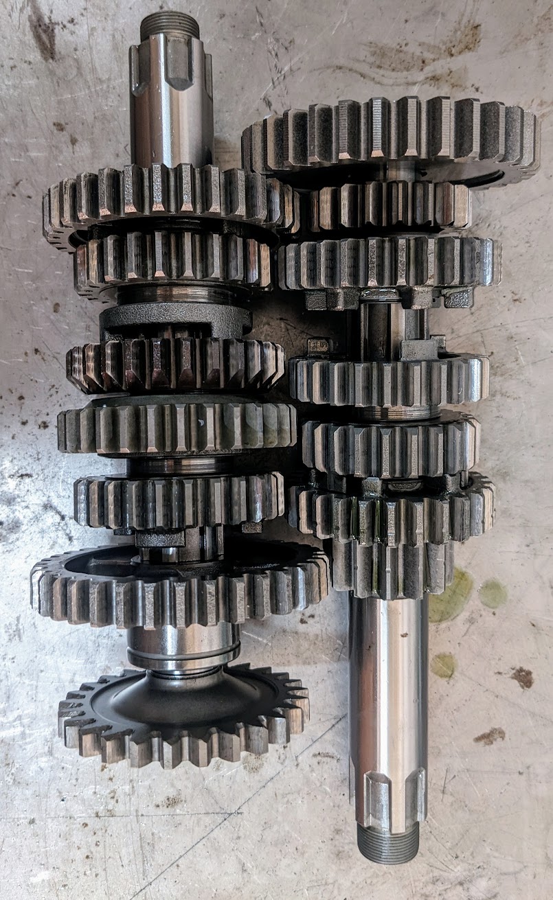

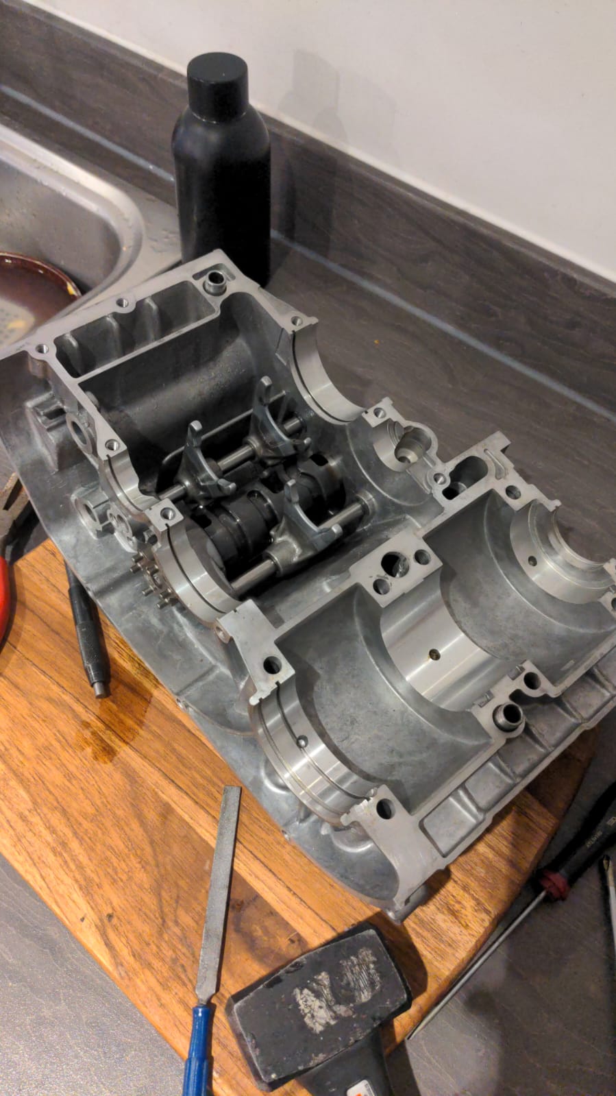

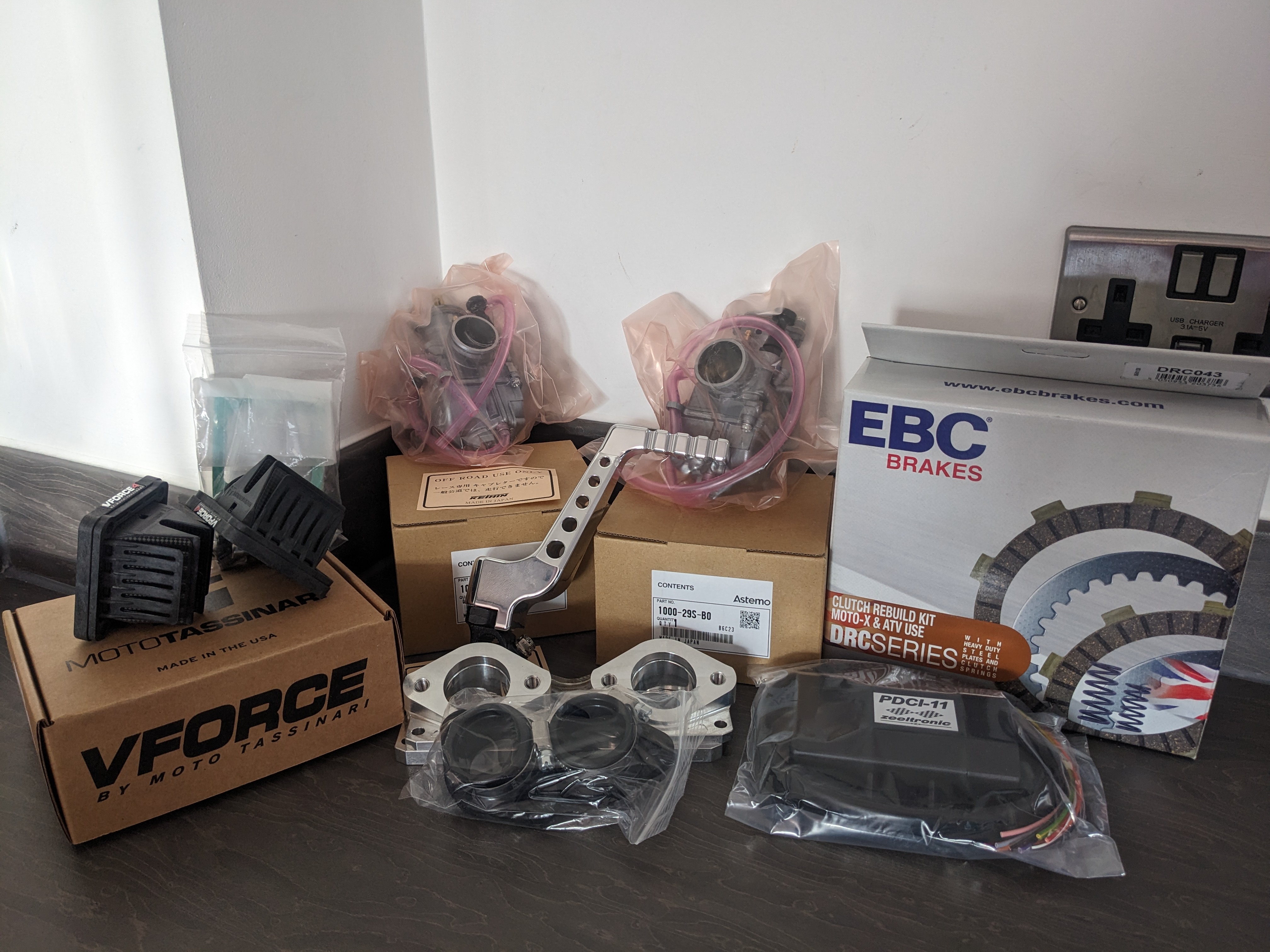

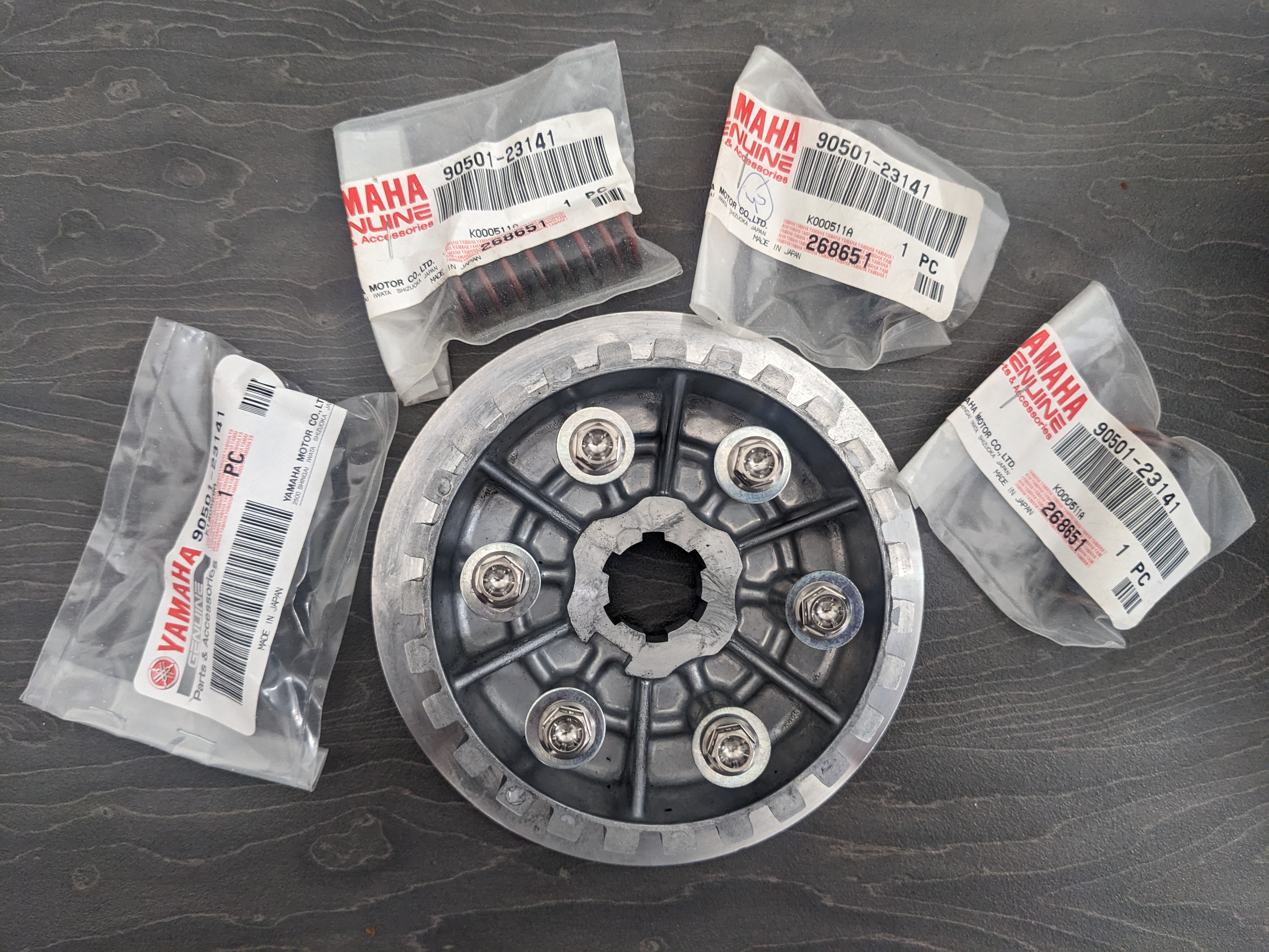

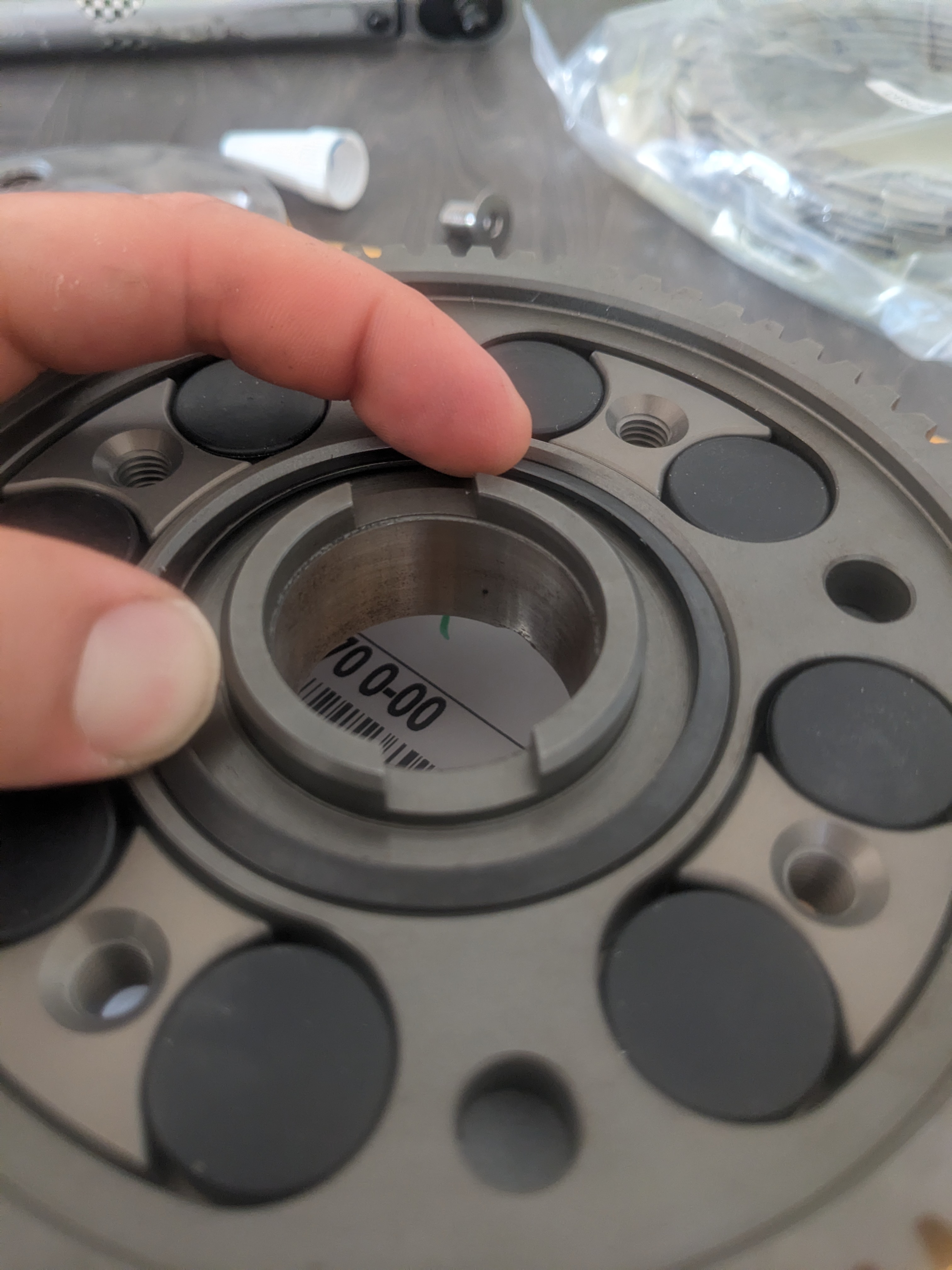

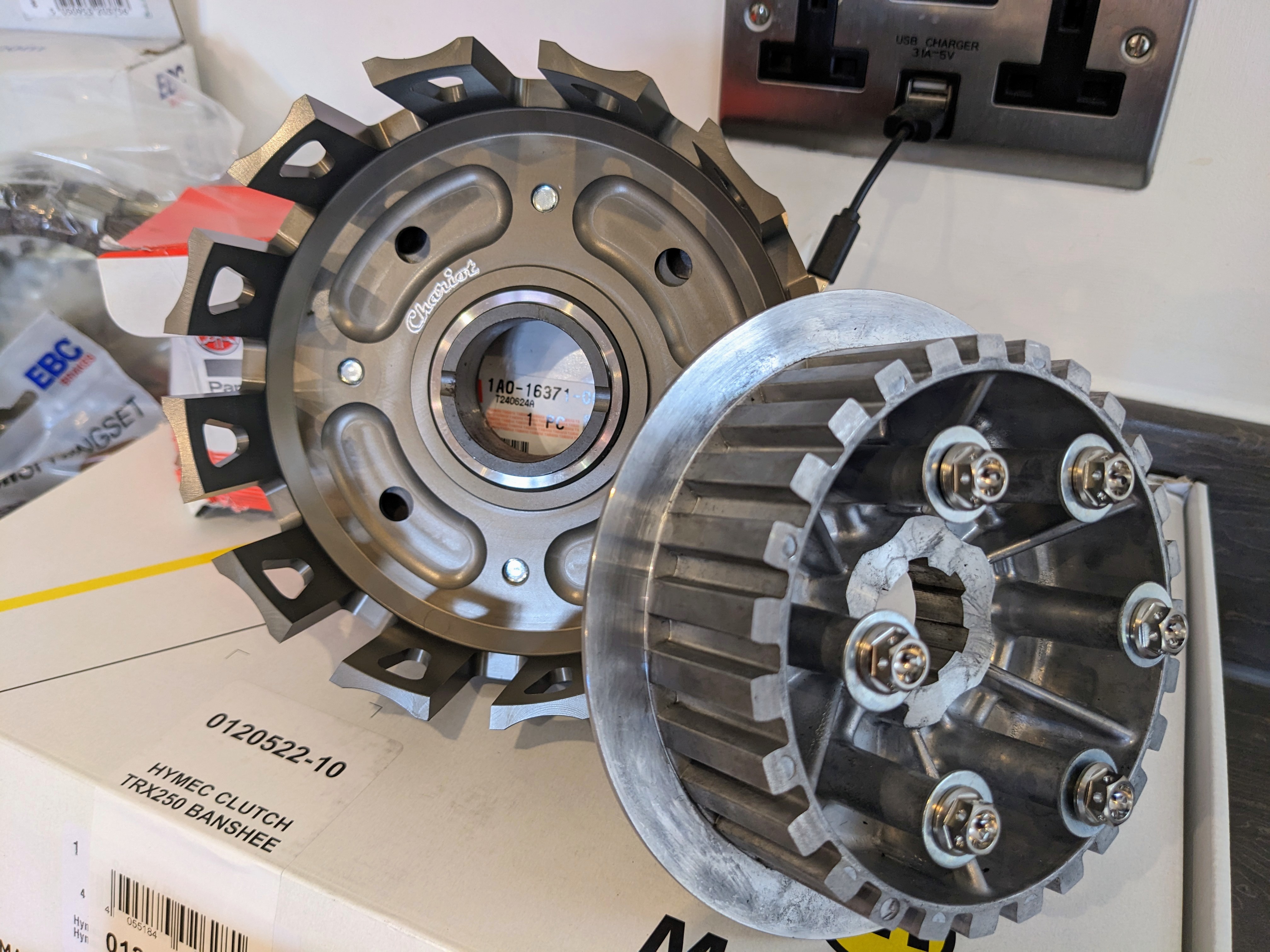

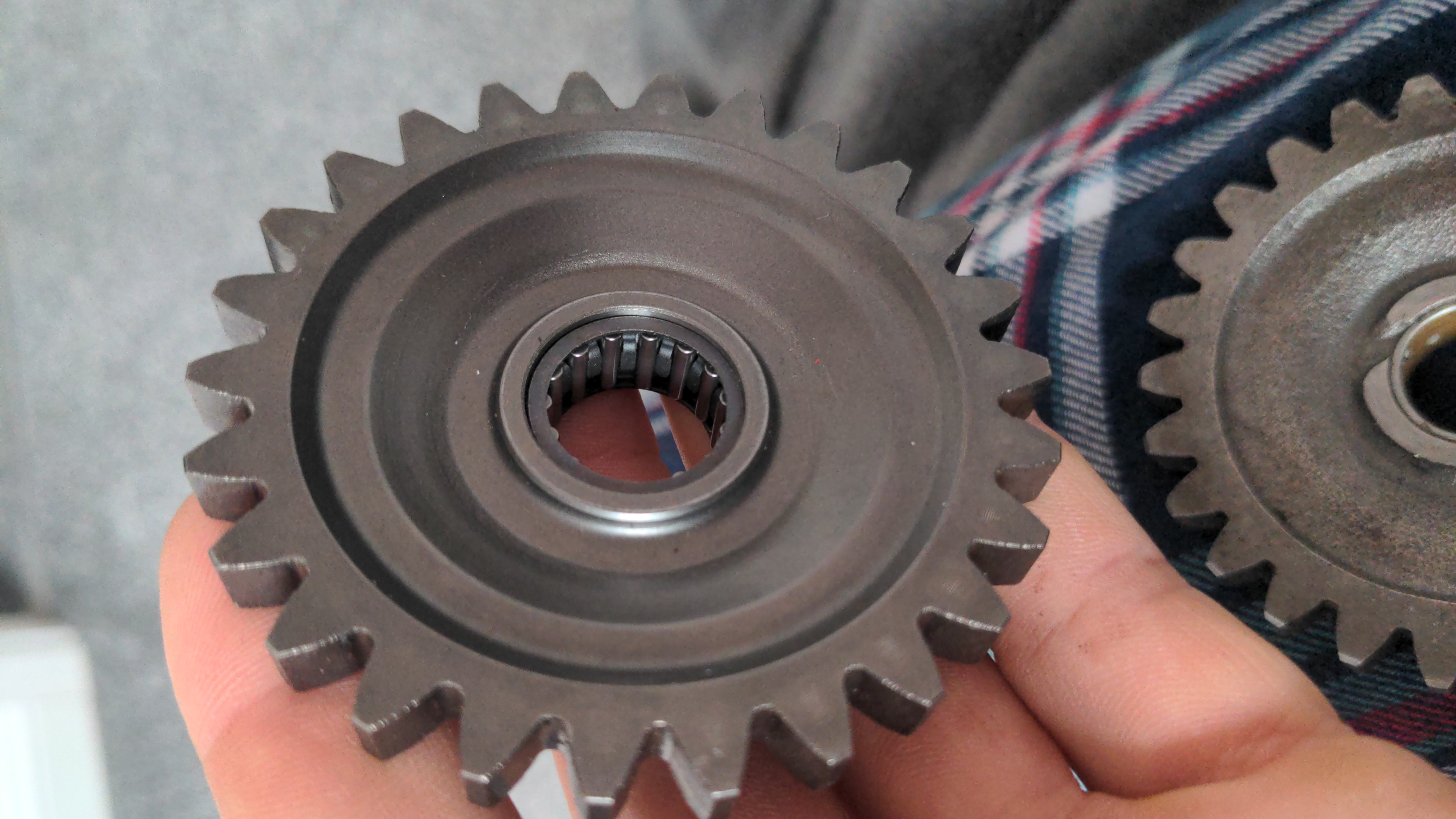

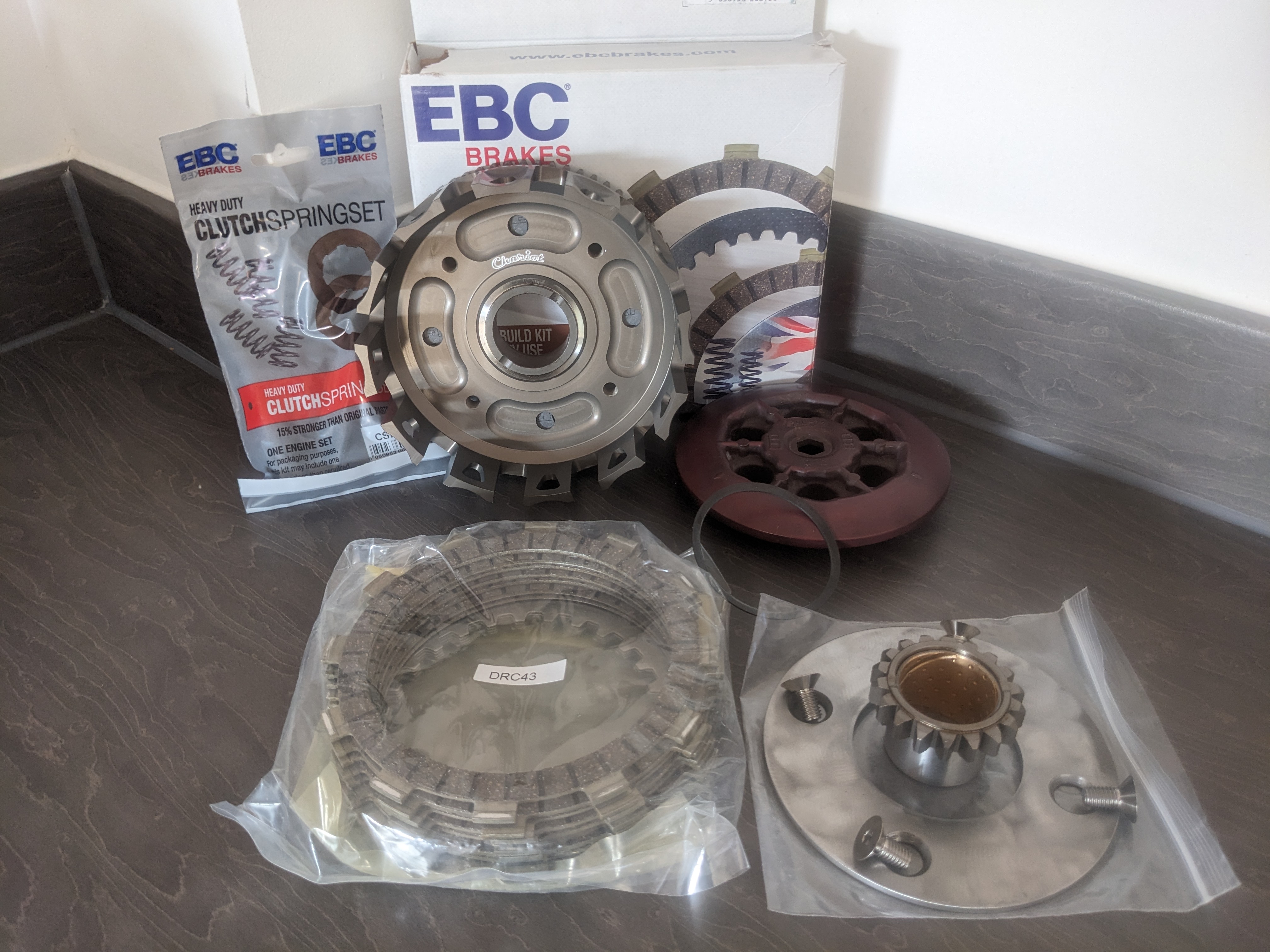

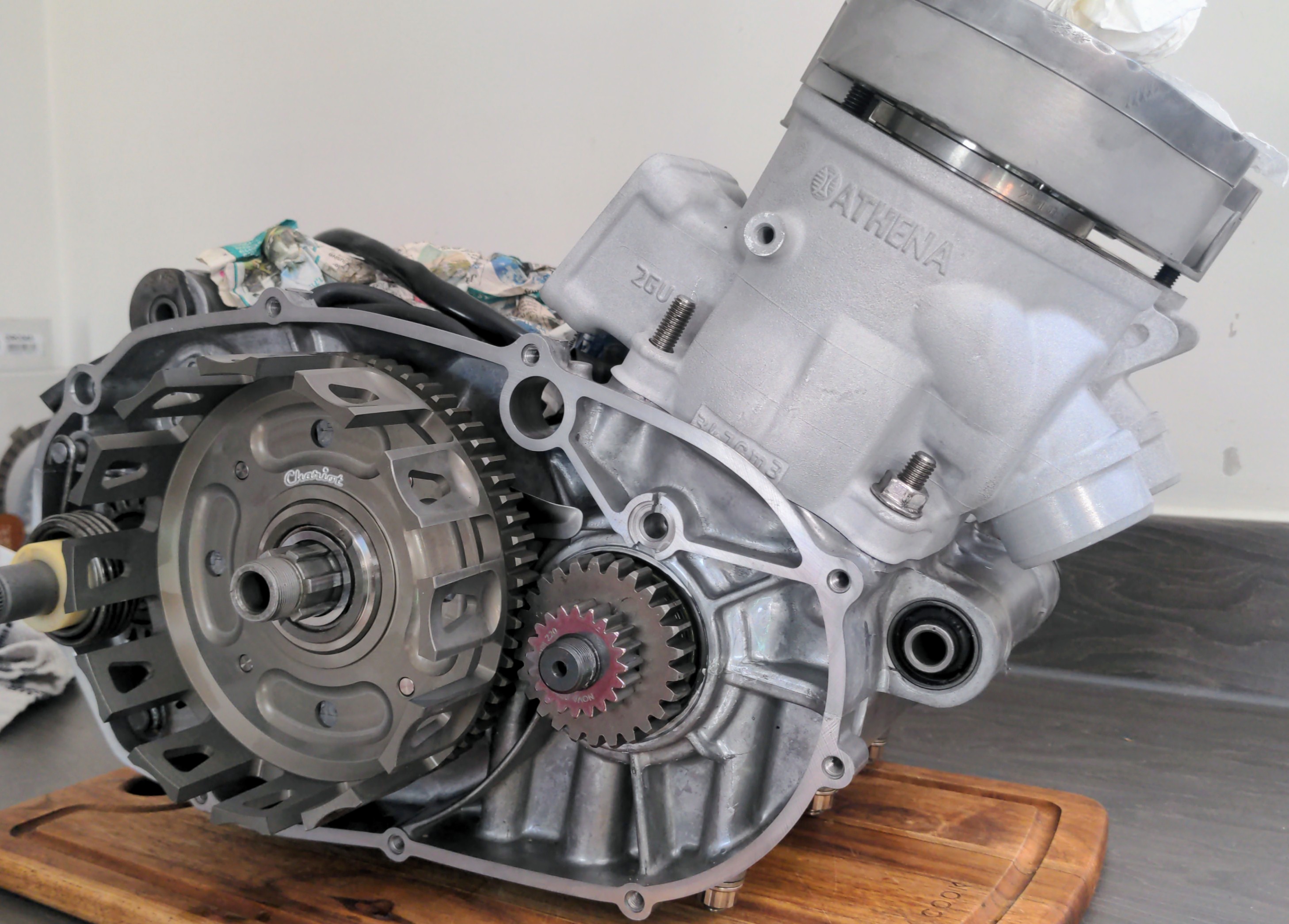

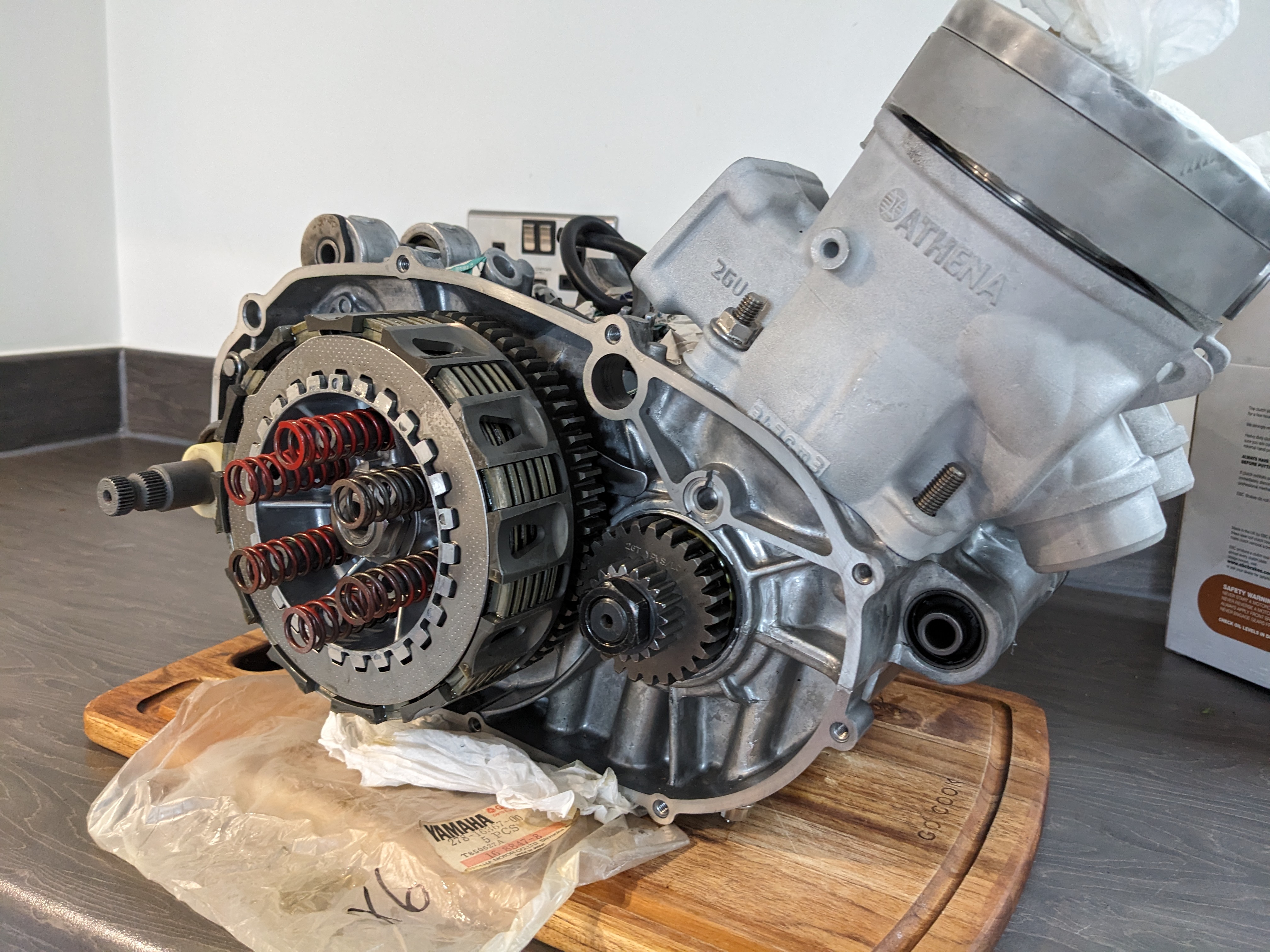

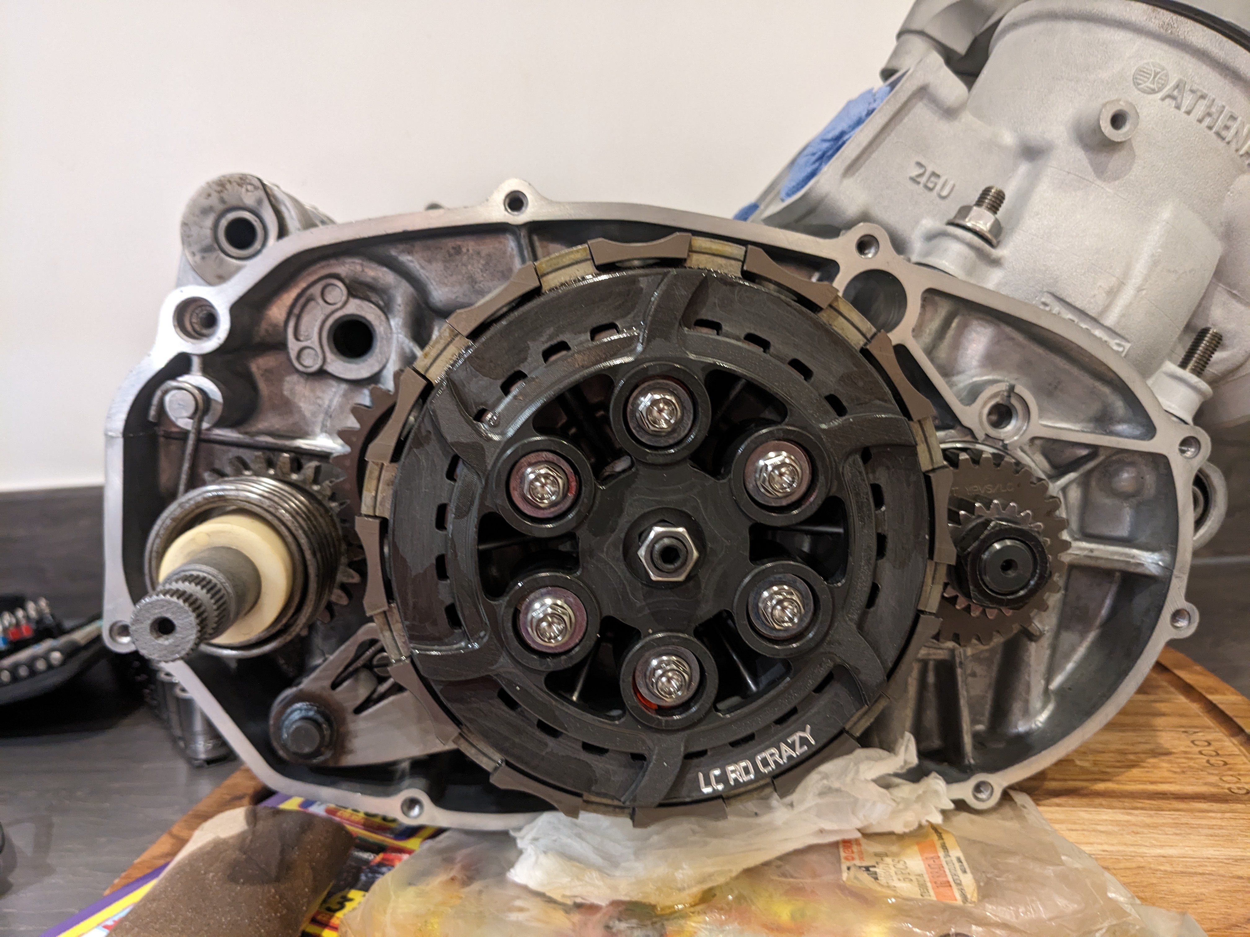

    Because I am an idiot, I decided early on, after discussing this over the RDLC Crazy Forums, that I was merely going to be building a brand new RD350 engine.

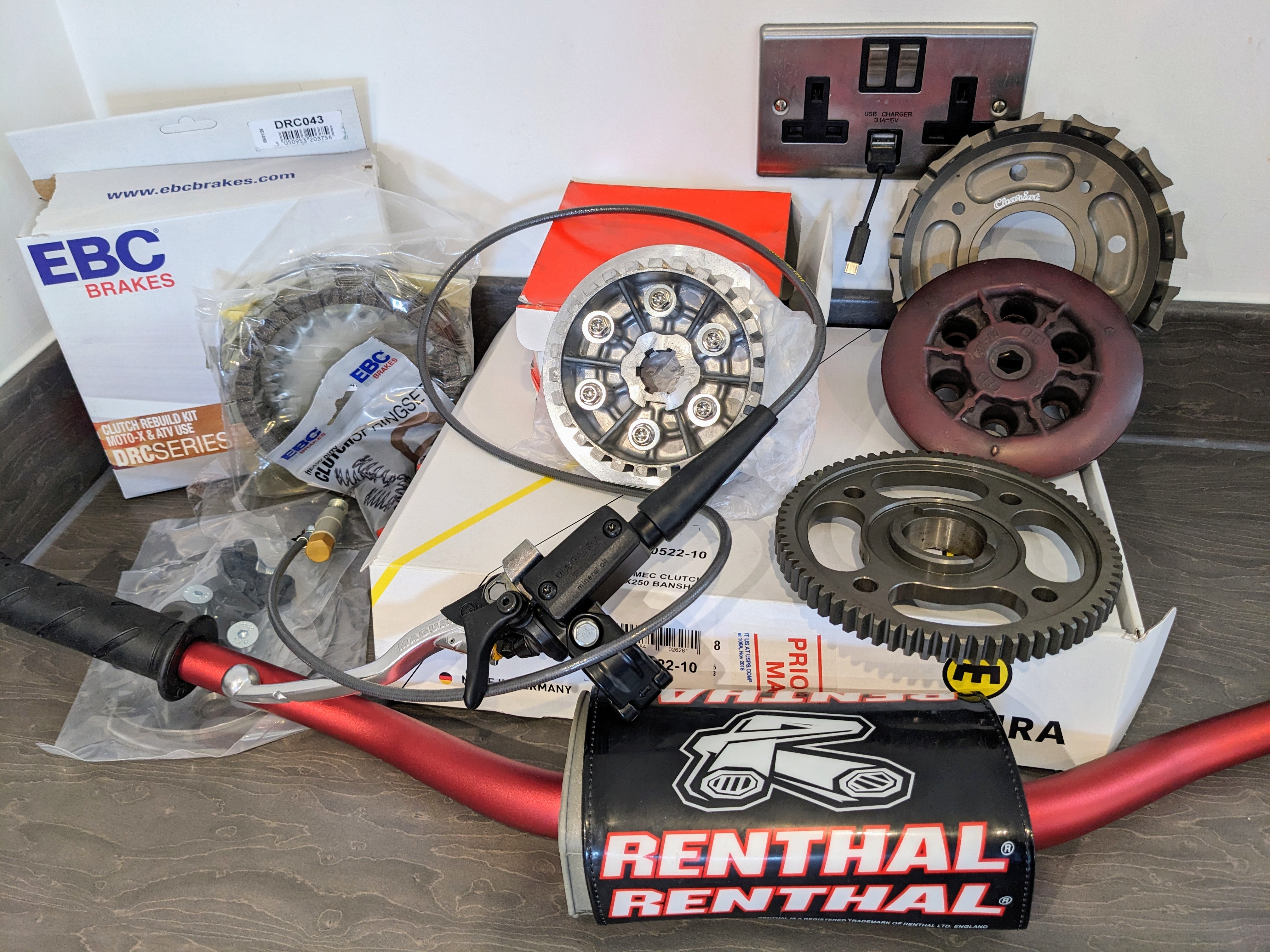

    So it's many trips to Fowlers later getting all the odds and sods for the internals.
    Farm and Sand Toys (F.A.S.T.) have you in mind if you want some trick bits...

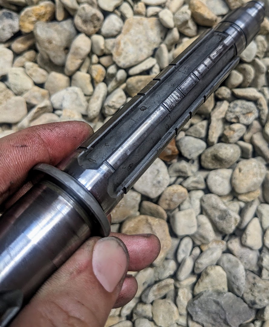

    This is their modified selector drum star, shifter gear and detent arm. Alongside the extended water pump cover and their billet neutral switch.
    Next was heading off to Mad Bike Designers to order the critical part of the build, the stroked crankshaft.
    I have various other bits, but no photos as of yet, these will come in time however.

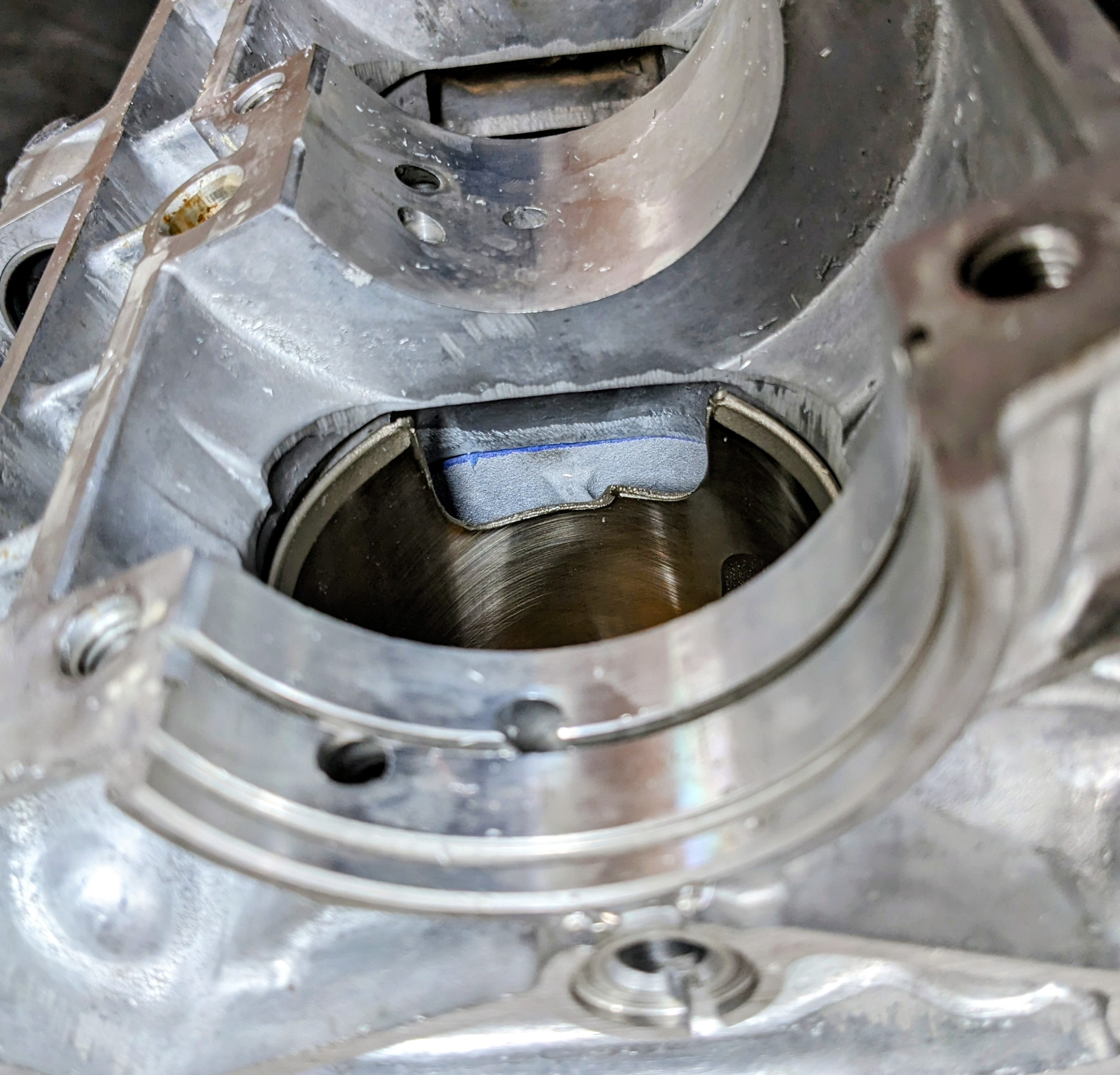

    This is not to be underestimated! I got there at 10:30 and I didn't leave till 17:00 and all we'd achieved were the preliminary tack welds.
    Unfortunately, the engine fouled the rear mount and we needed to make various modifications to the kit to get it all in there.
    I left the day feeling pretty happy with what we'd had achieved. Again this was a huge milestone in the project and by the time I had left I had an RD 350 fitted into the chassis of my Planet. Matt had only tack welded the parts in place and I left him to it for another days work of cutting and welding and general tidying up of the parts.

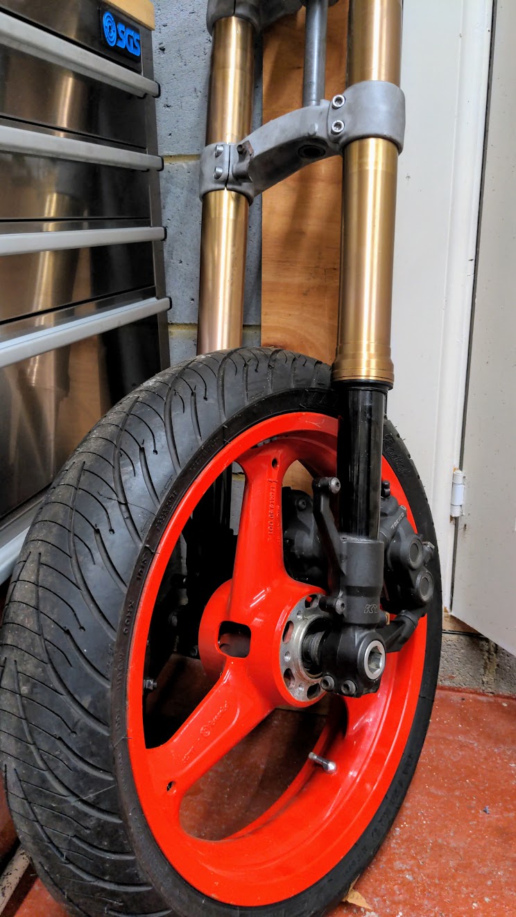

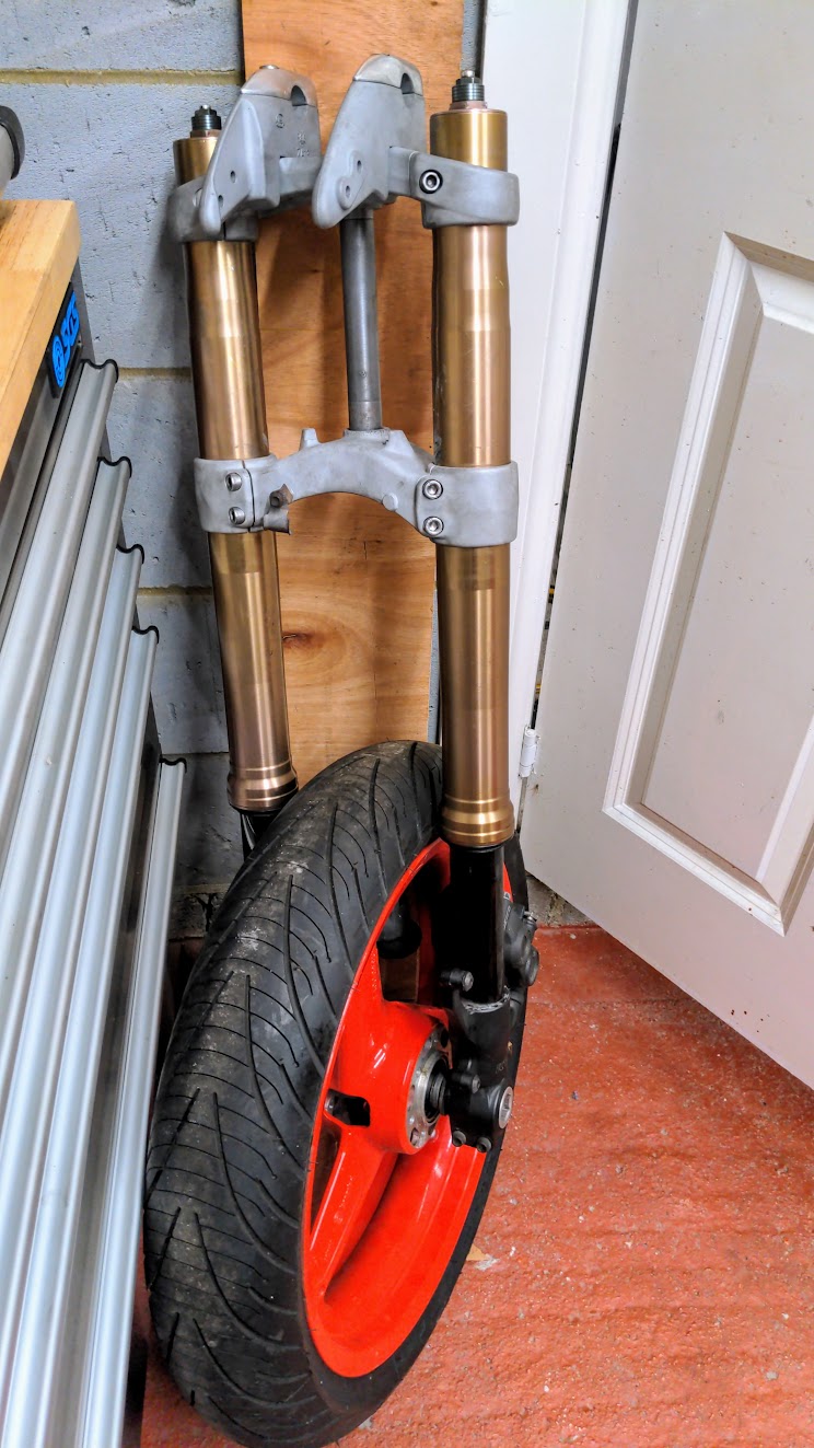

    Whilst Matt was busy modifying the frame, I turned my attention to the front suspension.
    For clarity, I have ridden my brothers Cagiva and I think it's absolutely fine. It handles fine and it stops fine. There are others on the WWW that disagree however. Others seem to think that the extra weight from the RD motor causes the front suspension to sag.
    From my perspective, swapping out the front with something with extra stopping power to match the increased power would do wonders for my project.
    With this in mind, I purchased a beefed up front end from a 2008 Kawasaki ZX10R to fit to my project, this comes back to what I was referring to a long while ago with regards to clocks.
    To itemise this for others I plan on running:
    • 2008 Kawasaki ZX10R Front Forks (Generation 3)
    • 2008 Kawasaki ZX10R Front Brakes (Generation 3)
    • ~2000 Era Ductai 916 Front 3 Spoke Wheel
    • Cagiva Raptor 125 Triple Clamps
    Verdict....
    It's tight...
    Very Tight...
    Like I may want to shave the back of the calipers tight...
    That said...it might work.
    But there are issues...
    2008 Kawasaki ZX10R Front End on Mito/Planet/Raptor Triple Clamps
    As mentioned earlier, the plan is to run a 2008 era, generation 3, Kawasaki ZX10R front forks/brakes in the original OEM triple clamps.
    The first problem I see is that the ZX10R triple clamps have a wider offset than the Mito setup. This means that the spindle protrudes the fork leg and that it is not possible to tighten up the front spindle.
    Secondly, there is simply not enough room to run the speedo drive.
    Finally, as mentioned, the brake calipers very nearly foul the wheel (yet to confirm without spacers).
    My plan here is to offset the spindle 15mm towards the edges which should allow me to tighten up the front wheel. However the spindle and the nut occupy the region on the fork leg which the legs clamp to, so I will need shims to back fill this to. I will then need a speedo delete spacer made up along side a normal spacer.

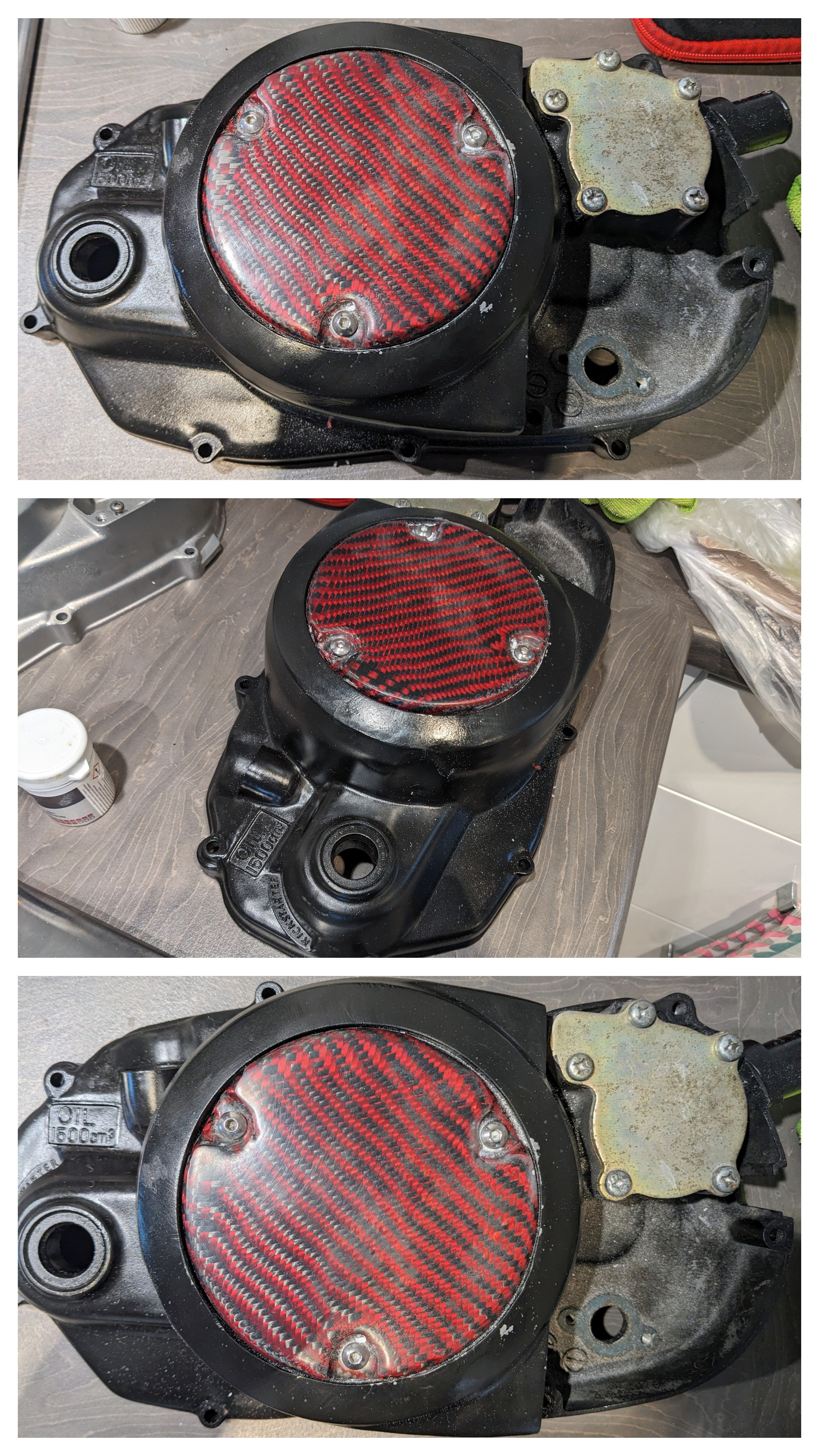

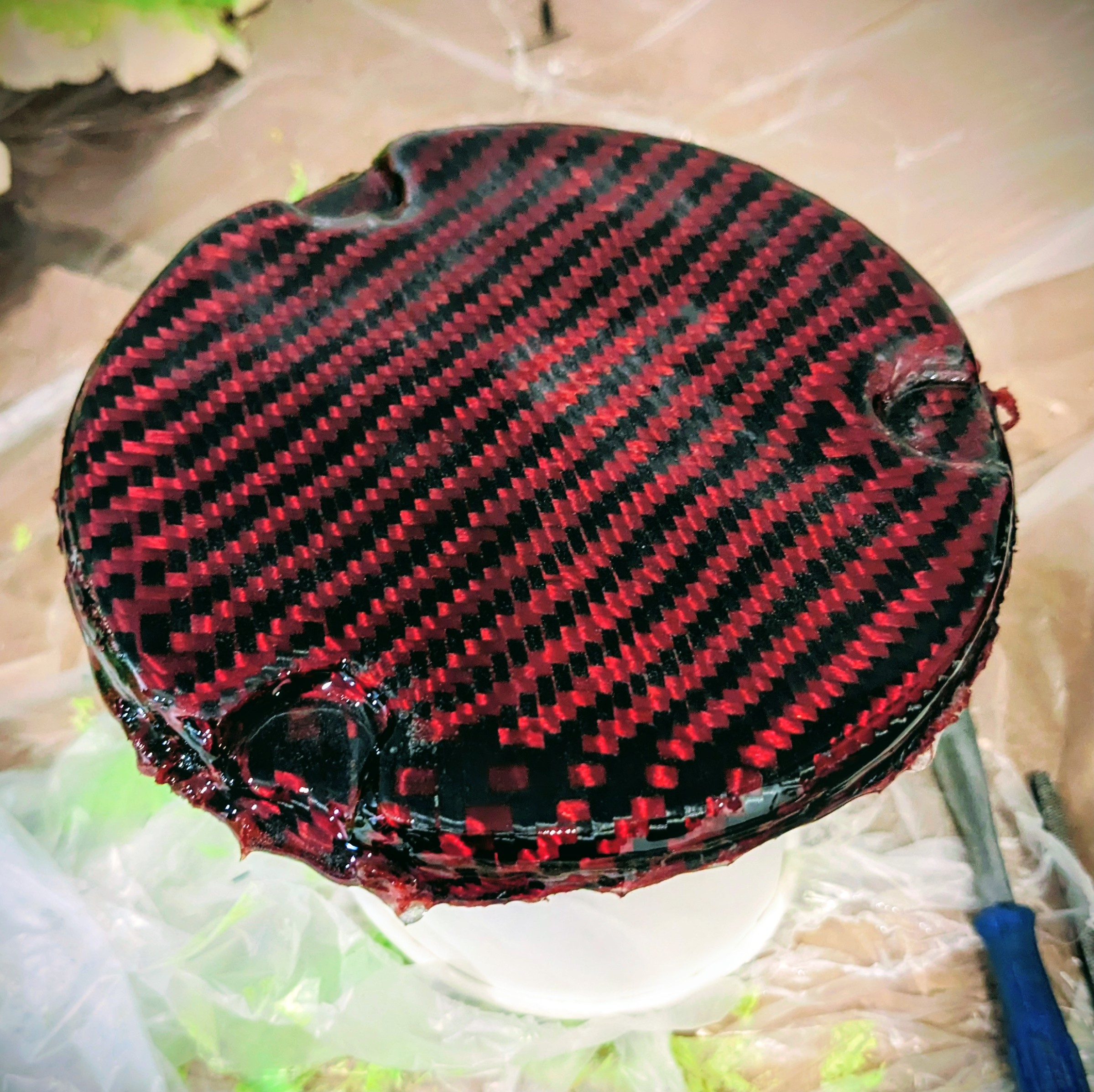

            My RD 350 clutch insert cover that I designed as arrived.
            It's a combination of the Yamaha Tuning Fork logo and the Cagiva Elephant logo all rolled into one.
            If nothing else, adds a unique piece of jewelry to my bike 😛

                Anyway, it was cheaper to buy these as an item of 5 as they have to set up the CNC machine, so figured I may as well get a few extras and float them on the forums see if anyone is interested...

                      Been saving for months to purchase this!
                      With Christmas and what not it was a difficult item to purchase.
                      Athena 392cc big bore, with the hot rods kit this will take this up to 421ccs.

                            Today felt like a good time to tackle the the gearbox rebuild.
                            Input shaft stripped ready to lay the gears onto the 1st gear conversion.
                            All rebuild, new bearings, shims and circlips.
                            So far, so successful.
                            Next tackling the output shaft.

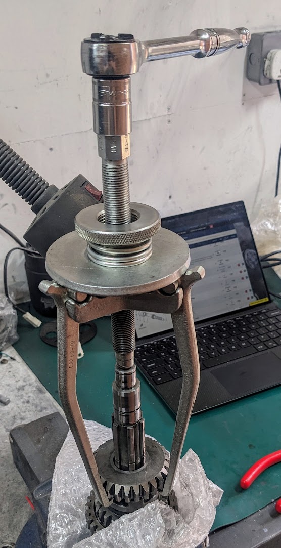

                            Was going extremely well...until it came to dismantle third.
                            This was not coming off and the prognosis wasn't good. Rough running third gear with swarf coming out of it.
                            The layshaft's damaged beyond repair and so was third gear.
                            Luckily the layshafts can be had brand new and I managed to find third gear.
                            So sadly that's the cost of a used gearbox, but then that tells me for scrimping on the gearbox.
                            The layshaft's coming from Japan so I'll have to park this rebuild for now.
                              Okay...so some overnight parts from Japan and CMSNL and some others from Australia 😢 I've finished the gearbox rebuild.....
                              Brand new genuine output shaft from Japan and a brand new genuine 3rd gear....
                              This completes the output shaft rebuild.
                              New genuine shims, circlips and bearings.
                              Fingers cross that's all back together correctly, I'll have to remember to select all gears and test BEFORE firing up the motor, else this will be £8000 down the drain if it destroys the motor.

                                Banshee/RD 350 Athena 421 Bottom End Assembly
                                With that all said, this month I took stock of my inventory and I came to realise that I had virtually all of what I needed to close the crankcases up on my Banshee 350 motor, in preparation of assembling the Athena 392 kit.

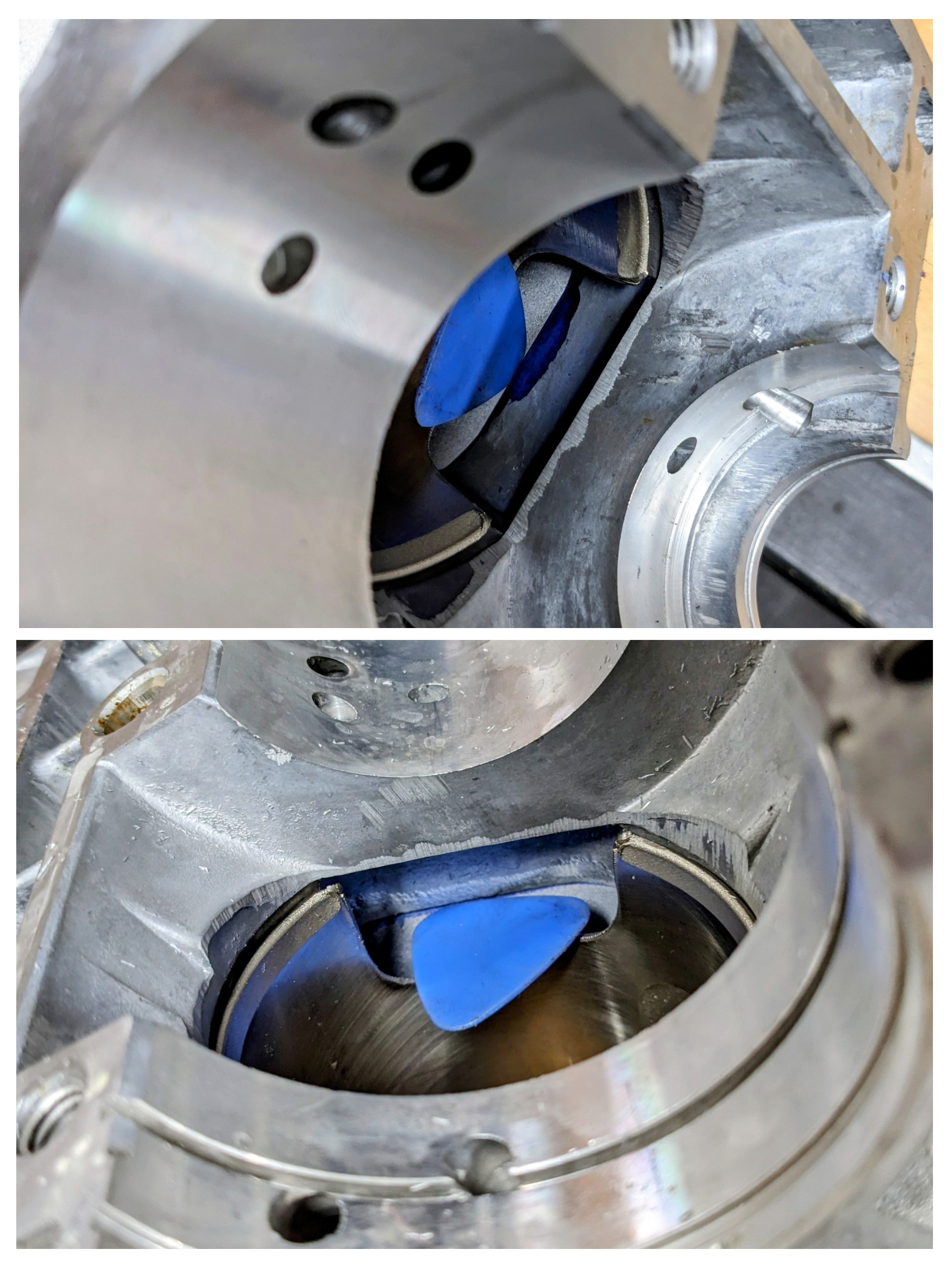

                                As some of you may know, there is free performance to be made if you port your crankcase's transfers to match the transfer ports on the cylinders. The Yamaha RD 350/Yamaha Banshee engines are notorious for leaving steps in between the transfers for the bottom end and the cylinders. Since I intend to run the Athena Big Bore Kit, this step is even more exacerbated.
                                In a nut shell, here I'll be marking out this discrepancy using some Dykem Blue engineering fluid, then scoring a visible outline using my Facom Scribe and then with my die grinder, porting the bottom end to match.
                                For reference again, the engine cases I bought were brand new direct from Yamaha. As such this gives a good example of how much, unmolested cases need to be grinded away.
                                You can get a rough idea of what needs to be cut by overlaying the gasket over the bottom end and marking out the material that needs cutting out.
                                In my cases, I painted on the Dykem Blue and assembled the cylinder to the bottom end. This squished out excess fluid and left a visible line of where the cases meet the cylinder.
                                Here I've placed a guitar pick into the location of what we need to cut. There is a visible step here that should be machined away using a die grinder.
                                To ease the cutting process, I've washed away any excess Dykem Blue fluid and scribed a distinct line for where I want to cut up to.
                                With all the appropriate markings made out, it's time to grab the die grinder and port the bottom end to match.
                                I'm using a Rounded Tree Shape gold coated carbide burr. It's coarse flute geometry and titanium nitrate coating prevent the flutes from becoming clogged up and essentially cut through the alumiunium like butter.
                                In only a matter of seconds I've roughly cut out the intended shape.
                                Care MUST be taken here that you don't go too deep into the trenches. The crankcase walls are pretty thin towards the bottom and therefore care must be taken to avoid porting straight through the cases.
                                I've taken a photo here to give you a clear indication of how deep you'll want to aim to go.
                                I've gone around and done a rough cut of the desired shape.
                                I can quickly overlay the gasket to ensure I'm along the right track.
                                Note: The gasket used here is only a basic indication, there are cases where the gasket protrudes into the transfer ports and as such the gaskets need trimming. Therefore the method described above is preferred to get the perfect shape. This is especially true for ported cylinders.
                                You can see here a Before/After photo and how now the pick is not being covered by the bottom end transfer ports and now correctly aligns to the cylinder transfers.
                                The cases need to be thoroughly cleaned throughout to ensure no swarf is left anywhere.
                                These cases can be ported to quite some degree, since this is only running a mild big bore kit, the extent of the transfers needn't be too significant.
                                With this out the way, I can now start to assemble the bottom end with all the trick bits I've bought.
                                Bottom End Assembly
                                Now that the porting work has been completed and the gearbox rebuilt with a taller first gear, it's finally time to assembly the crankcase halves.
                                Here the selector drum can be installed along with the dog ears. The selector drum has been modified to aid easier shifting and easier neutral detection. It's a common mod for these engines and involves grinding away at the shift star to make the ramps more pronounced.
                                The upper crankcase halves have been installed with lightweight titanium studs.
                                The 4mm Hot Rods crank can be installed, along with the straight cut primary gear. New seals throughout and I also acquired/installed new bearing clips that were allegedly tighter tolerances than the OEM ones. Although upon inspection they look much of the muchness to me.
                                The gearbox wouldn't be complete without all new bearings throughout, although my bearing was missing the much needed circlip. Luckily I have amassed enough spares in my workshop to salvage a bearing clip from another gearbox.
                                Here is the gear on the output shaft which was swapped for the 1st gear conversion.
                                Along with the shift star mod, I've also got a modified detent arm (with roller bearing) and shift lever with the cut outs widened to give greater movement to the shifter mechanism.
                                All the gears were tested/shifted to ensure correct alignment and engagement.
                                The shifter mechanism operates on a cam which needs to be aligned prior to sealing. A relatively simple job once you understand what you're looking for, but easy to overlook. Once the alignment has been done, the locking nut can be tightened.
                                Low profile grade 5 titanium bolts are used to affix the baffle plates and bearing retainer. Everything inside this engine is brand spanking new, since I have been building the engine from scratch.

                                Carbon Fibre Moulding

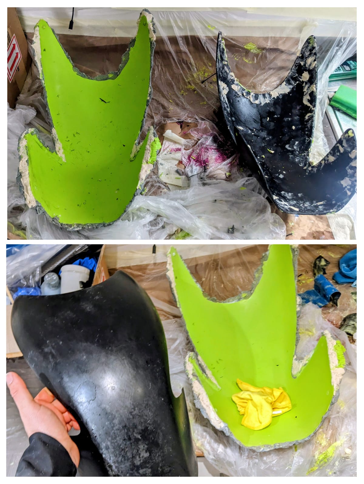

                                On a side project, for the panelling on this machine I want a Carbon Fibre tank guard. This really isn't an necessity and I've merely been messing around with various techniques to try get a feel for how hard it would be.
                                Initially I started off with a moulding kit, but I ordered an inappropriate amount, failed to fully do the prep work and rushed the process. The result was the mould cracked upon separating.
                                Next I instead opted to just do a simple design to better understand the technique. Here I designed a part I wanted for the clutch cover in CAD then 3D printed the part to make a mould from.
                                This too failed as I was unable to separate the mould from the part and as a result the whole thing was scrapped. I was starting to grow impatient and finally I decided I'd directly 3D print the mould and then make a carbon fibre part directly from the mould.
                                To my surprise, this actually worked out really well (given the low-budgetness of it all), however I was not getting the desired effect. I wanted the lettering to be really pronounced as it is on the original part. However the lettering is feint and is mainly made of the epoxy which fell into the mould and not the carbon fibre.
                                I refined the approach, this time creating a mould-press to help form the lettering. I wanted to use a red carbon weave to accent the bikes final "Black" colouring.
                                But this again was unsatisfactory and I decided to ditch the lettering and call it a day for that idea and just focus on making a singular part.
                                Although the weave got distorted, the part came out better than I expected.
                                Sadly, I don't love the result, it actually looks better when the light isn't shining directly on it.
                                I am happy with how the part has come out, it's done as a budget part and it has worked to a degree.
                                Undeterred, I've given the moulding process another shot to see if I can fair up better. This time making sure I do plenty of prep work and don't rush it.
                                Actually pleased to say the moulding has worked! So I now have something that I could potentially make a carbon fibre part from. I know you can get reasonable jobs from this type of setup, I am not looking for perfection here, just something to give the bike a bit of bling would be nice.
                                Sadly, I ran out of carbon fibre weave to actually progress with this and I'm not sold I want the red carbon/polyester weave, however I've seen you can get red pigments for the epoxy resin which I may give a go with this mould.

                                        Well this last month a disgusting amount of money was dropped on parts for this engine.
                                        • Two Keihin PWK 28mm Carbs
                                        • Two Vforce Reed Blocks
                                        • Billet Inlet manifold
                                        • EBC Clutch Kit + Heavy Duty Springs
                                        • 6 TZ750 Genuine Clutch Springs
                                        • Zeeltronic Ignition System
                                        • Billet Kick Starter Lever
                                        • Magura Hydraulic Clutch Lever
                                        • Chariot Performance Billet Clutch Basket
                                        • Wiseco Blaster 200 Piston (573M06800)
                                        • Modified Idle Gear with bearing
                                        These Wiseco pistons replace the stock Athena pistons due to the 115mm long rods I'm running and the +4mm stroked crank shaft. The head still needs to be machined to accommodate the longer stroke and the wrist pin on these pistons is different to accommodate the longer rod.
                                        This idle gear is lovely, totally unnecessary but was only £60 but seemingly not available to purchase anywhere I looked.
                                        The Magura wasn't cheap, but it's going to be necessary when running all 6 TZ750 clutch springs just to keep the power from slipping the clutch.
                                        (the other two springs are in the post I had to source elsewhere).
                                        Now that I have the basket, I can finally assemble the clutch basket with my straight cut primary gears.
                                        Basket is beautifully made, claimed to be the best on the market and I can see why. It was missing the Belleville washer that sits between the basket and the fastener plate, I bought a genuine basket to chop up and salvage but it wasn't on that basket (apparently they're fitted to 1986 models and later). I managed to find a company that sell them so ordered from them and fitted. Wasn't cheap but I'm glad it's in.

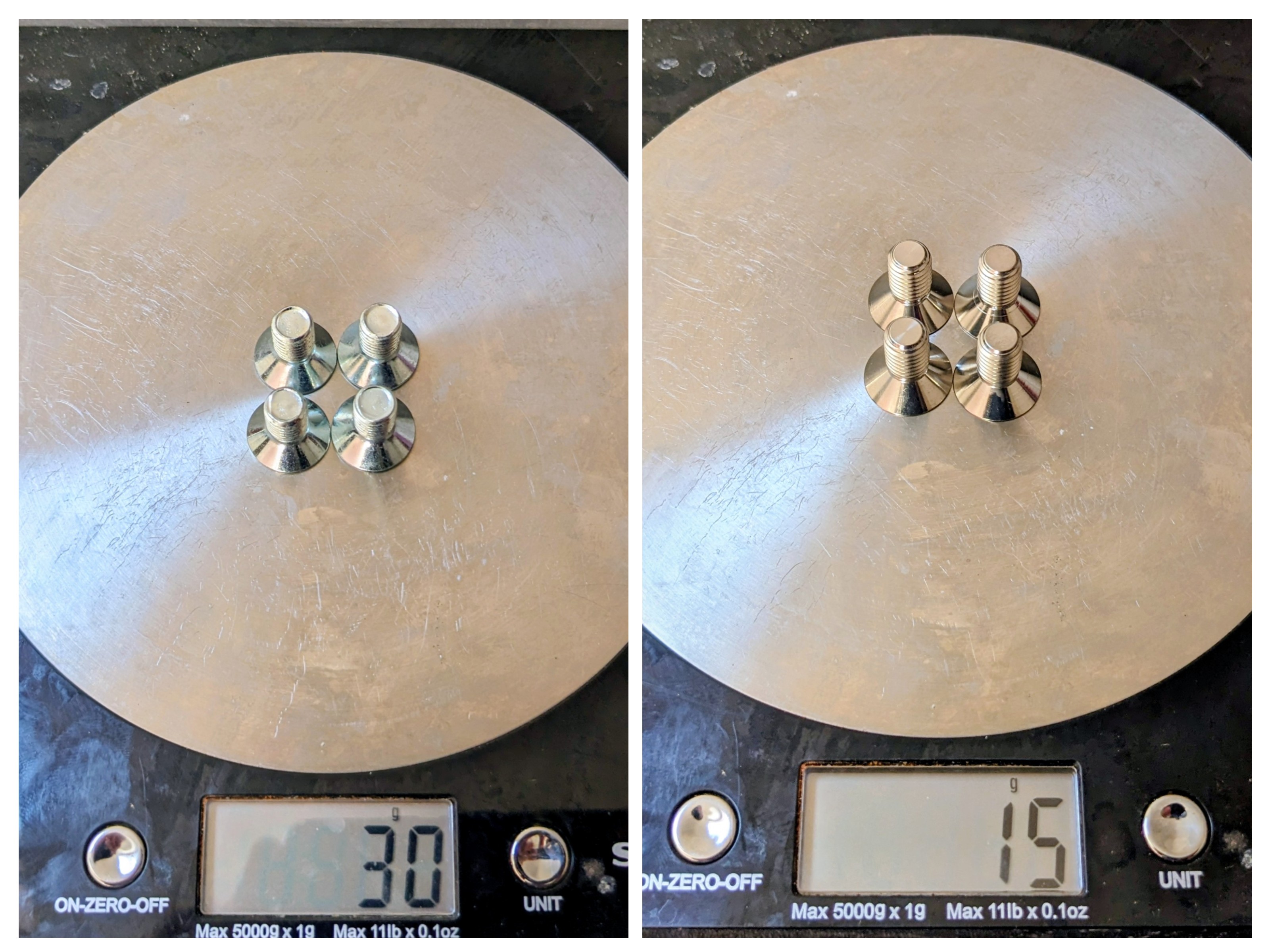

                                        I did replace the steel bolts with some lighter titanium ones (hopefully they withstand the abuse the basket is going to take!)
                                        About 50% of the weight, but hopefully not at the expense of strength!
                                        The washer is installed with the raised edge facing you. The fastener plate will clamp down onto this edge.
                                        Engine is coming together nicely now though.
                                          Okay, a few more NOS parts ordered and now the primary drive gear, clutch basket and generator nut all torqued to spec!
                                          All 6 TZ750 clutch springs fitted with brand new clutch plates and NOS OEM damper rings installed.
                                          I also replaced the factory pressure plate with a gorgeous billet RDLC Crazy pressure plate.
                                          It's said to have better oil flow and looks to have a fair amount machined out of it, but I was surprised to see it's slightly heavier than the factory setup.
                                          This milestone marks the completion of the bottom end 🎆 There's just the matter of the water pump to install, I was really hoping to get a Chariot Performance uprated one, but they're no longer manufacturing them. And then there is a company that makes a stunning carbon fibre generator cover/chain guard. I did have my eye on a Chariot Performance one, but again they seem to no longer be making them sadly.
                                          The cylinders are booked in with Mick Abbey for some mild porting work, then the heads need to be sent off for machining.
                                          But once that's done it will mark the engine work completed for this project and I will turn my attention to the frame.
                                          The frame has now been moved into the garage and I'm just trying to figure out how/where the steering damper should be fitted!
