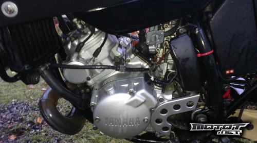

        @SpookDog @Calum Thanks again for the suggestions but let's go in parts, Jack said, I made sure the air filter was clean, then maybe I expressed myself wrong or it was the translator's fault, but I repeat, I didn't remove the yeis. I removed the black bottle that is bolted to the frame on the side and fits into the rubber that connects the air filter housing to the carburetor. That is, imagine the air entering in excess when opening that inlet and very little through the air filter box. The logical thing would be to think that it would work worse but it was when the bike worked better at least in wot and it did not have the damn failure despite the large excessive air intake, which makes me think that perhaps I still have an electrical fault that I have not yet detected and that would make a weak spark at high revolutions that is not powerful enough to burn the fuel in wot. I even tried with everything connected without the snorkel and although it improved it was still a little rich so imagine.

          @facundo-duarte Yes that's correct.
          On later models Yamaha fitted two YEIS bottles.
          One to the inlet manifold, and then one to the carburetor boot. You've removed the one fitted to the carburetor boot.
          It sounds like not enough air flow to me.
          If you remove the air filter/carburetor boot altogether you can see if your problem goes away and that tells you it's the airbox.
