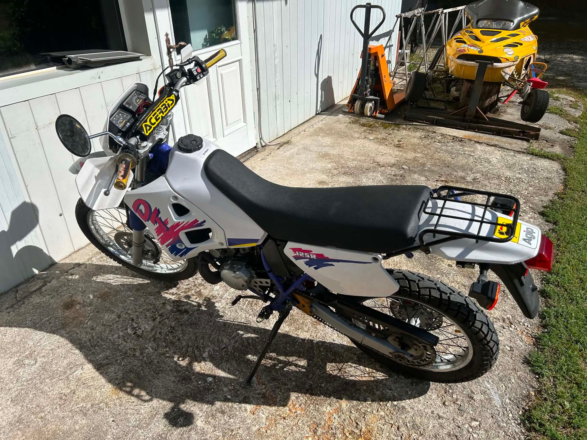

    Hello everyone!
    Planning to buy a DTR125 1996. Has around 33k km, unopened engine. Has new tires, brakes, general service. What should I be checking for when looking at it?
    Thanks for the help!

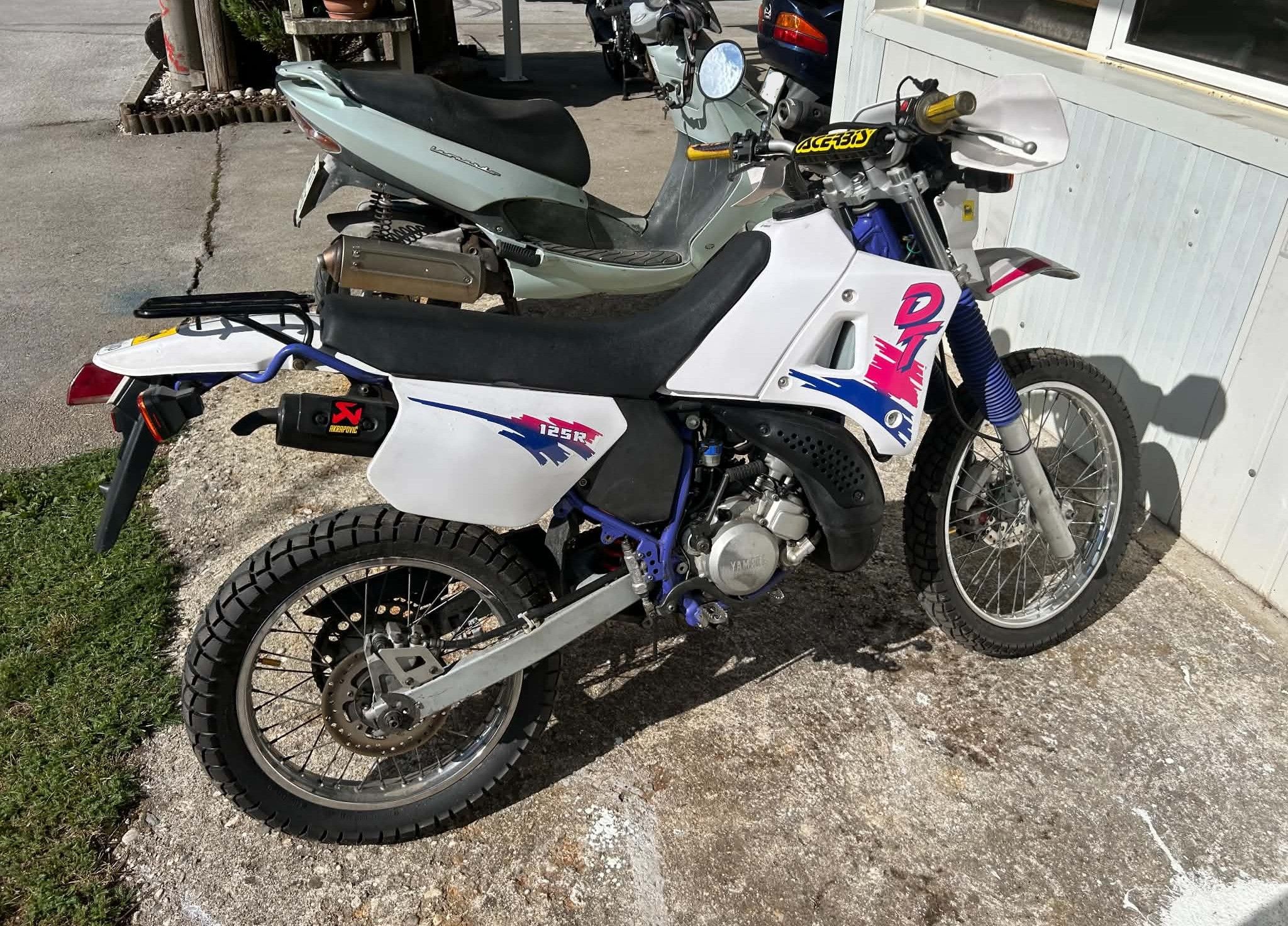

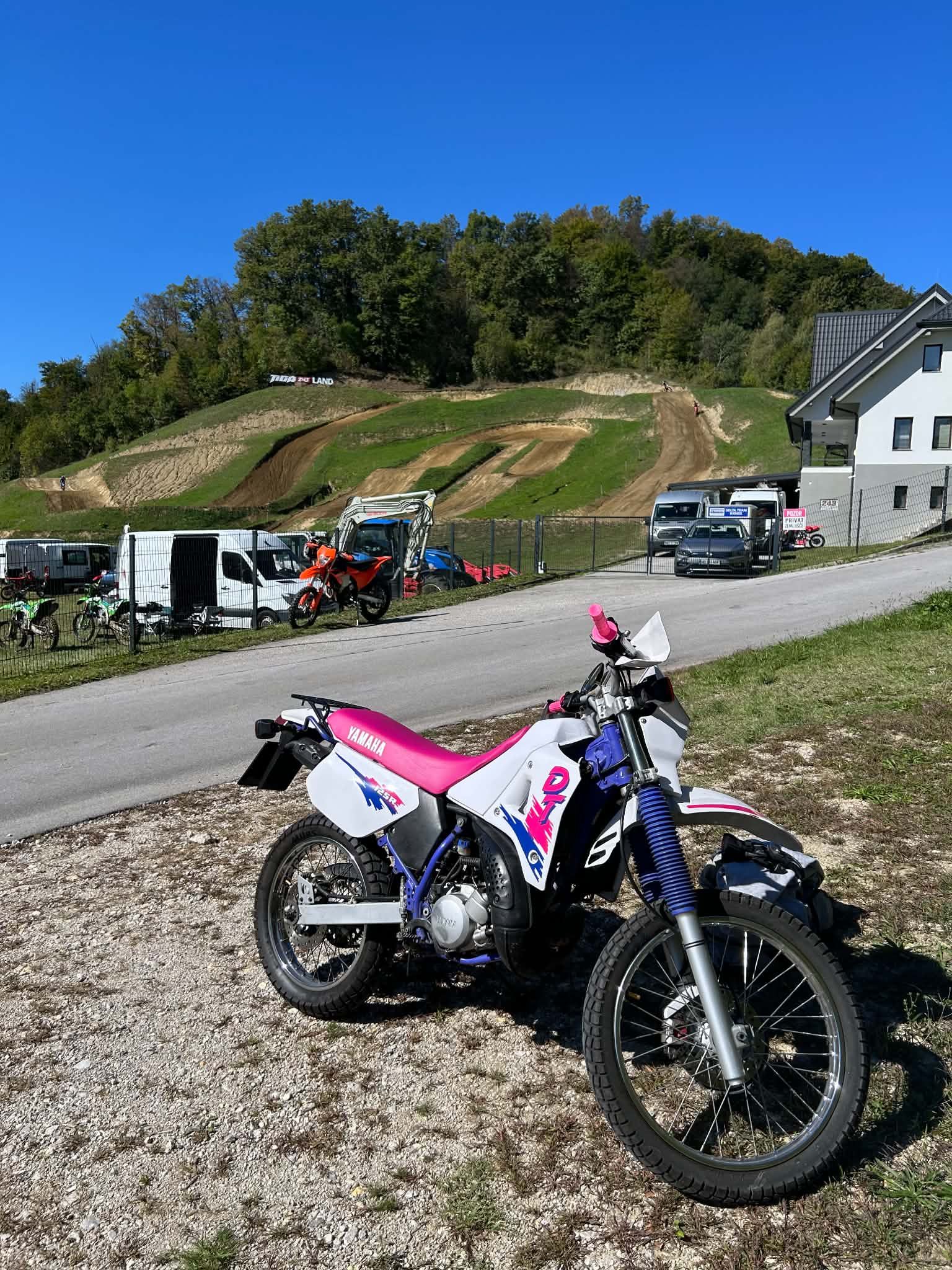

        Hello! Well I bought it! It pulls good, starts cold in just a few turns of a starter. Bike does not look 30 years old at all. Everything on the bike works, including the YPVS. Sounds coming from the engine sound normal to me, i will attach a cold start clip of the engine sound below. Previous owner had it for normal cruising on the street to the bar and so on.
        I do wonder, there is different information, does the cylinder have a nikasil coating? If so, all the bike needs is a new piston thats it?
        What is some general maintenance I should do before riding it? How can i refresh the YPVS so it keeps working, same with autolube?
