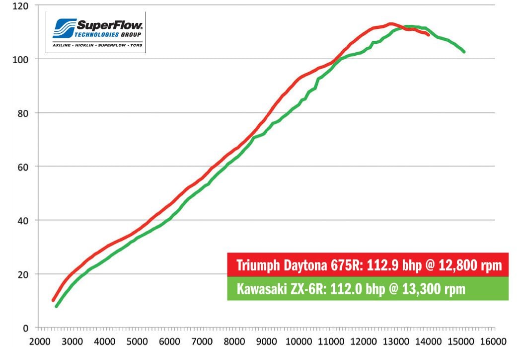

        Uuuhhmmm, two strokes aren't linear power. I think you've misphrased that.
        A lot of road going four strokes I've ridden are gutless and you have to wring their necks to actually make them fast. I don't see that as being akin to a two stroke.
        ZX6R
        Where as an RD350LC, or two stroke will have a much more erratic explosive powerband.
        Bear in mind on the RD, you're talking about something which makes DTR power just above idle. So they are very rideable, but the real fun/power is up at those higher RPMs.
        You really need to be up there (750cc+) on four strokes for them to actually be fast IMO.
          That’s exactly what I mean, I’m not talking about the literal powerband but the way the bike feels and is ridden. That revvy in-line four akin to the DT is begging to have its necks wrung because you literally double the amount of power high up in the revs and like said that’s how you make them fast

            @Stevie-Wonder Yeah, I see what you're saying. With a bigger 4 stroke it's not like that so much. I haven't yet ridden a super bike however.

                @Calum when I rode a CBR900rr fire blade it still produces that same style of power but was no where near as revvy as the fazer.
                The fazer wanted to be ridden past 8k everywhere, by all means you could ride it under but it just didn’t feel like you was using it properly
