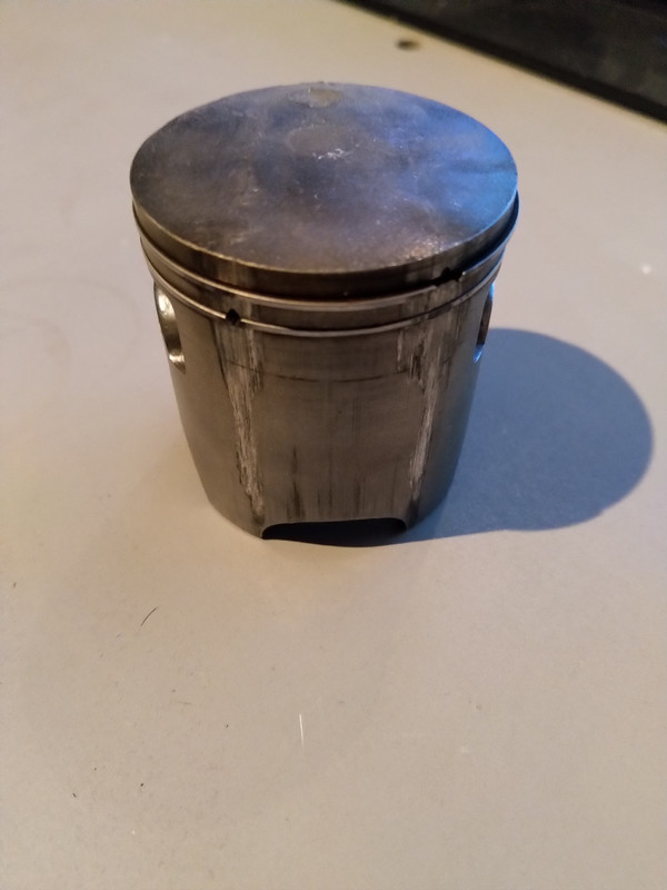

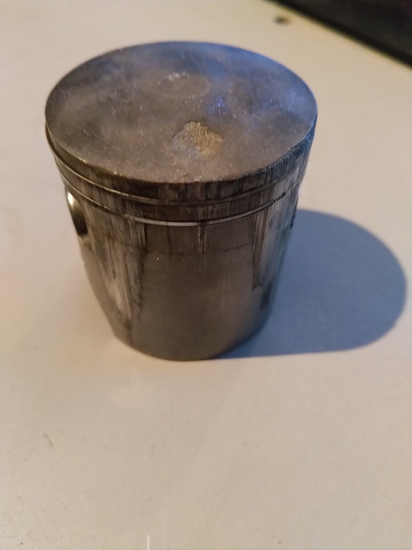

            So i started opening her up. Everything looks fine gearbox wise this far. I'll split the case asap but I have to wait for a flywheel puller or ask my local Yamaha dealer to pull it for me.
            Pulled the Athena 170 cilinder and head, both are already damaged. No clue why. Bottom ring is completly stuck, also explains why it had very good compression (full weight to kick it over) after the first testrun +- 10min it was 10 times easier to kick over.

              This looks like an overheating issue? But shouldn't the damaged be at the exhaust side

                @llldennis I was going to say overheating as it happens. Could have been inadequate lubrication

                  If it was only one side I'd say bent rod, what was the little end bearing like? And what does the plating look like near the transfer ports?

                      @spookdog that's not a 4 point heat seizure from running lean though. The side of piston above the gudgeon pin see's very little load. Only time I've seen damage to the side of a piston similar, was when a gudgeon pin clip had come loose.

                        I donโ€™t know, Iโ€™m not an expert. But it looks like an โ€˜aggressiveโ€™ heat seizure, whether mixture or lube, to me...
                        Then again Iโ€™ve only ever seen other peopleโ€™s work. I had a near seizure once but caught it in time when the engine โ€˜noteโ€™ changed. So it never smeared the piston.

                          Pictures of a dt piston that heat seized due to lean mixture, from the base gasket blowing. You can see the classic 4 point seize and a little detonation damage to the piston crown nearest the exhaust port. Believe it or not, pistons aren't perfectly round, And are normally narrower along the line of the gudgeon pin, so it would be very unlikely to get a heat seizure at that point on the piston.
                            @DTR-NSR See that death ash on the top as well.

                              @calum yeah it certainly wasn't a happy piston, also was a dark heat spot on the underside of the crown.
                              • T Offline
                                T Offline
                                theportingmaster
                                @lllDennis Two-stroke piston seizures are either thermal-related or lubrication-failure-related. That one appears to me to be lubrication in nature. Could be overly rich jetting that allowed liquid fuel to wash oil off of the piston skirt as the fuel comes through the transfer ports, causing a lubrication failure.
