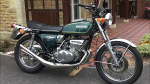

            alt text I decided to concentrate on my other project today, feeling a bit fed up with the water cooled ungrateful Yamaha

              @mcludd
              Before my time 🫤 RD 250?…
              Edit: 200?
              I met a bloke who put an RD 200 twin engine in a dtr125 frame! He was trying to make a 2>1 exhaust the last time I saw him. I didn’t know about 2T expansion chambers at the time! I’ll have to stop by and see what’s what next time the weathers good and I feel any kinda sociable…
                #46
                Very nice 😄
