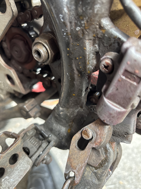

                  Hi again, so after trying a new cap it hasn’t seamed to fix it but I am 95% sure I found the source of the leak (see image ) is this hole ment to be used as an overflow and does anyone have a full Coolant system diagram

                    • CalumC Online
                      CalumC Online
                      Why would it be the waterpump? That's on the other side of the engine/bike. It's no where near the stand?

                          The only reason for the expansion tank to be full and overflowing is if the head gasket has blown and is pressuring the coolant system, which results in loss of coolant through the expansion tank.
                          P.S. yes the expansion tank is connected to that part of the frame by a small rubber tube. it lives up behind the side panel above the rear wheel. there's a min & max level about halfway up the tank. Check it out to see if it's full to the top...
