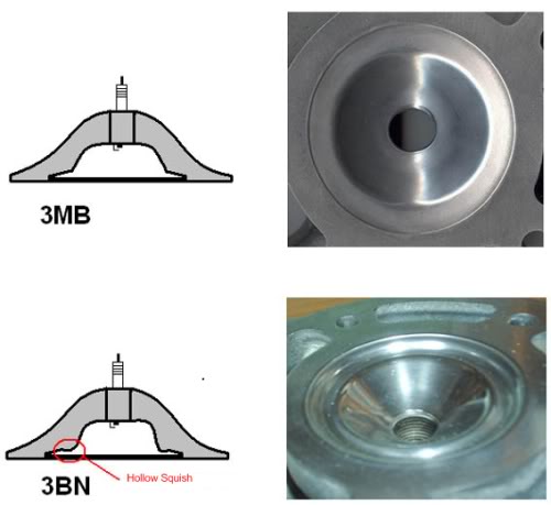

                            What head are you running? The earlier ones ran the restrict 3BN head. And having that changed will make a difference. 3MB heads came factory fitted to the later models, but are getting hard to come across these days. Having the restriction removed would cost less than finding a decent 3MB head. Talking £35 to have the head modified.

                                  @Calum how is the head supposed to be modified?
                                    There is a combustion ring on the 3bn head. That needs removing.
