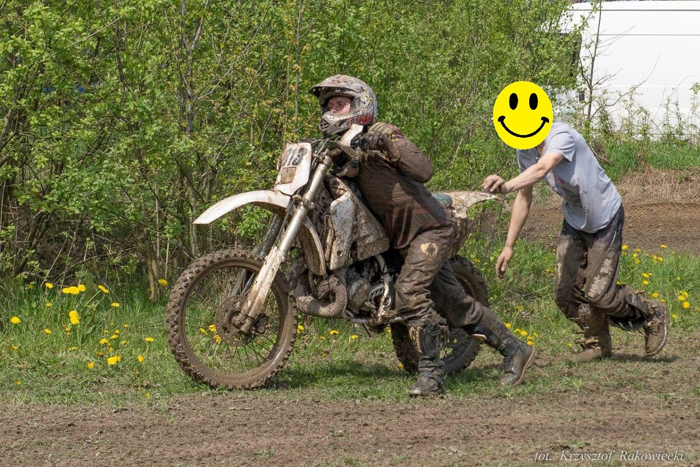

    I took care of the basic stuff and took part in the amateur cross-country championships in '16 and '17. I was 3rd both times in the "Junior" class (max driver age 21). Only the 2-stroke 250s were faster. The second event was very muddy and the WR got really beaten up. Clutch was totally gone about 100m before the finish line but thanks to help of my friend I was able to push the bike thru and finish the race. After that the WR got a complete rebuild and was ridden casually around the local terrains. Last year I took her apart partially once again to do the things I didnt do before, that was shock rebuilt, removing the dents from the FMF pipe, installing a slightly ported cylinder with a new sleeve and a Wossner piston and many smaller things. Today I fired her up for the first time but she needs adjustments, especially finding out the main jet setting. Generally I want to keep her looking as close to the original as possible, only modifications are: handlebars, exhaust, front springs from a '89 YZ250 and Boyesen reeds. Im kind of the oem-look freak and I love buying NOS parts, so she will stay this way. Now its time for the pics:
    Thats how she looked in the ad
    First ride
    With her older sister
    2016 Cross country amateur championships
    2017 Cross-country amateur championship

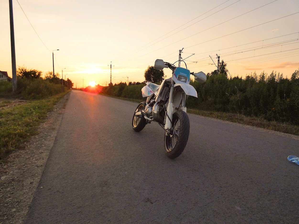

                                      I totally love this bike
                                      I have the front 17 wheel done:
                                      And I will be using rear wheel from WR125X that fits bolt-on. Now Im saving money for the tires 😛
                                      3
